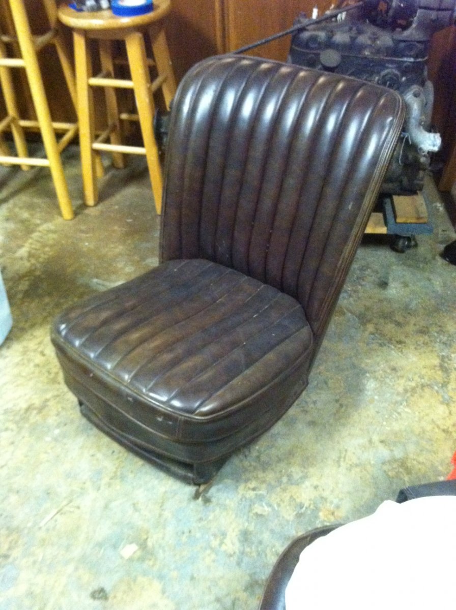

    Front seat was way too high...coinsidently made a perfect rear seat bottom.

    33 Austin seats will arrive from Kauai tomorrow!
