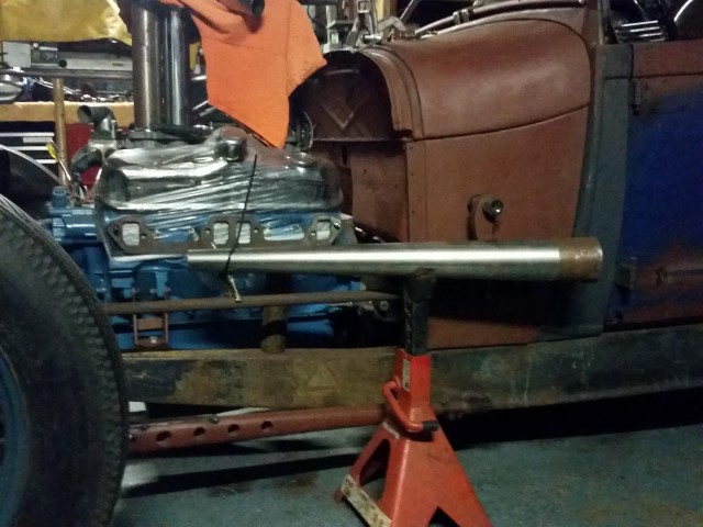

    My first plan was to twist the lenses 90° and bolt'em through the radiator shell.
    45° plan B

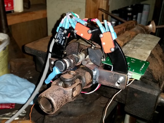

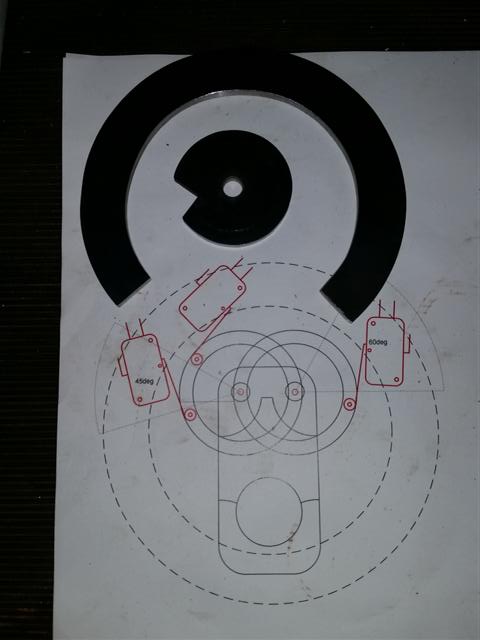

    Model A Blinker (Ign. Advance) & Windshield Wiper (Throttle) On/Off Speed Controls.
    (Not much of a windshield but it is one of 8 Requirements for Street Rod Registered Cars in Hawaii)
    5/16 locking collars welded to cams.
    Trying to figure out how to keep them "at rest" with a spring....?
    AndersF likes this.

    it's mounted this way in the car....I think it'll still be "Lucky"
    Threaded holes for switches....
    Transfer Punch Set = Must Have Tool for fabbing stuff!
    Dannerr likes this.

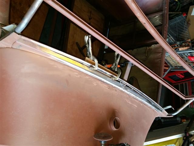

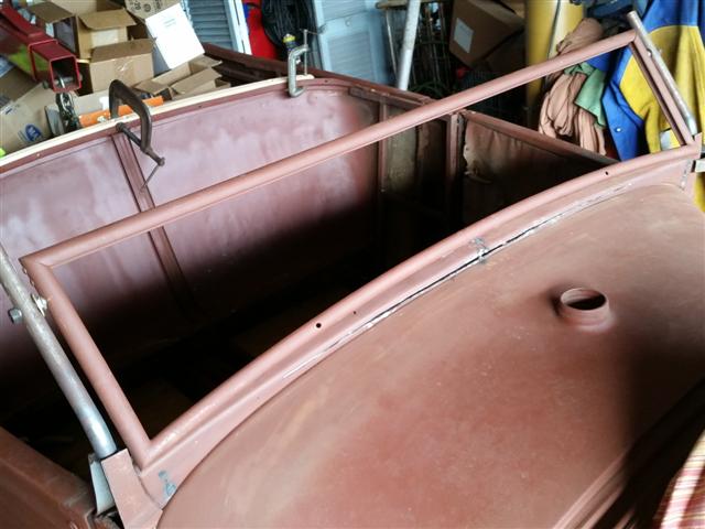

    Time to make the sloped windshield fit...(2nd.time!)

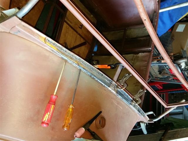

    Easy Cut & Weld...
    NOT! The metal moves like crazy...Lotso fun keeping it in place while welding...NOT!
    Luckily I just made these tabs to make the center section & side posts removable.

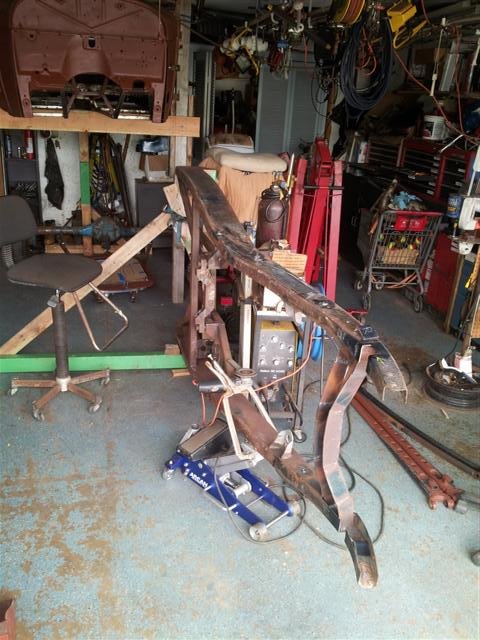

    Now Poor Mans Rotisserie on Wheels.
    Almost done welding the frame...(all the spots I missed earlier!)
    Can't get to all nooks and crannies by the front and rear cross members...
    Have any one used a sealer (Maybe Seam Sealer?) for areas like this?
    PAINT! Watcha Guys used on your frames?...
    There was an article here on HAMB that said POR 15 goes on better on surface rust...?..
    If so I'm ready to go after a de-grease pressure wash...

    Finished welded the front bonez...
    Reinforced + they really needed a last Puka (hole) Didn't have the right size pipe B4.
    Added 2 more body mounts.
    When i got the shavings out I even managed to get the illusive "lost nut" out of the rail...
    Frame is clean...welded up ~30 holes in the bottom of each rail...
    Time to get some Paint!
