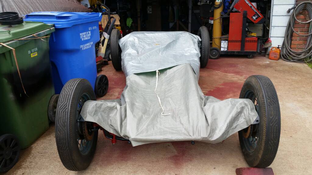

  23. verde742
    Joined: Aug 11, 2010
    Posts: 6,591
    verde742
    the ONLY ONE at the end of the driveway in the rain.... maybe this will help....?

  26. 340HilbornDuster
    Joined: Nov 14, 2011
    Posts: 2,076
    340HilbornDuster
    1468472783762.jpg Did some welding on the sub frame today. Still lots of finish work to do. Just don't want it to rust two minutes after I put it on my fresh ch***is...
