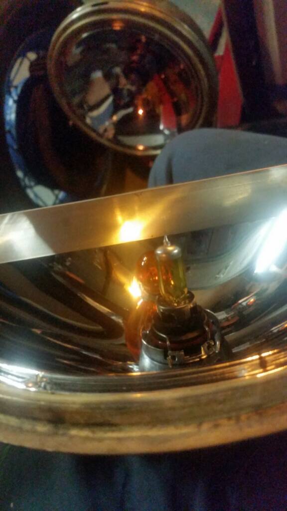

    The "replacement lenses" are so shallow that,
    Even though there slightly recessed in the bucket
    the bulbs still stick out past the Gl*** Lens!
    32 Packard Gl*** lenses are Straight!
  17. 340HilbornDuster
    Joined: Nov 14, 2011
    Posts: 2,113
    340HilbornDuster
    Trying to find SHORT 9007 Halogen Bulbs...
    ANY IDEAS?
    Not too keen on LED's (they're shorter ~1/2")
    may be the only solution....FOR NOW?
    - Not sure i can use 'em? - LED lights not listed...!

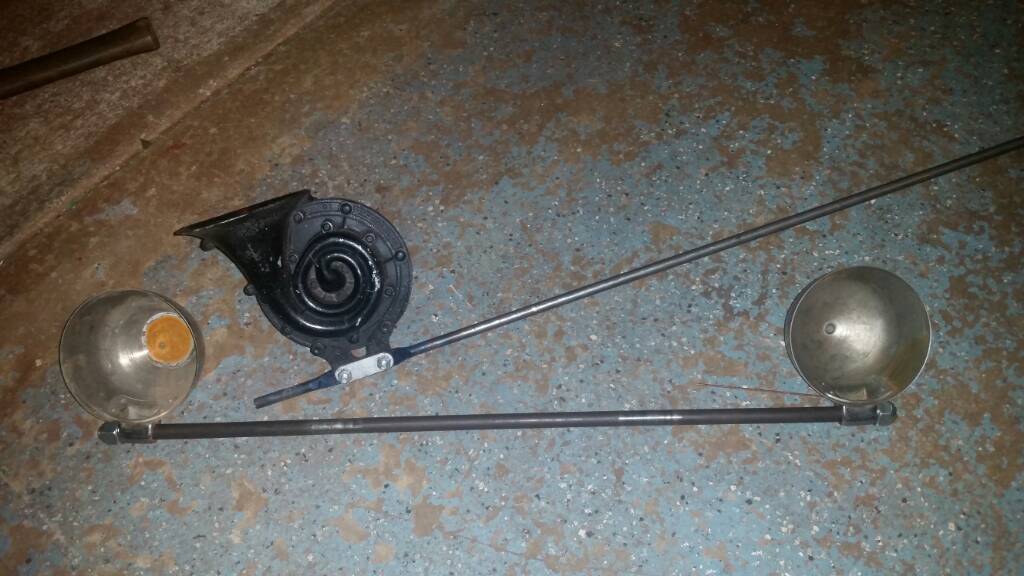

    Ran out of Acetylene at the last bend!! Phew!
    Biggest problem is to get it all aligned, level, straight, flush.... 20171013_194334 (Medium).jpg All tacked in place... 20171013_205159 (Medium).jpg
    May have to stick "a sock" in the horns if it's raining...
    Soldered new wires to to the bulb centers.
    Found Amber W97's on the web!! All yellow will look good!

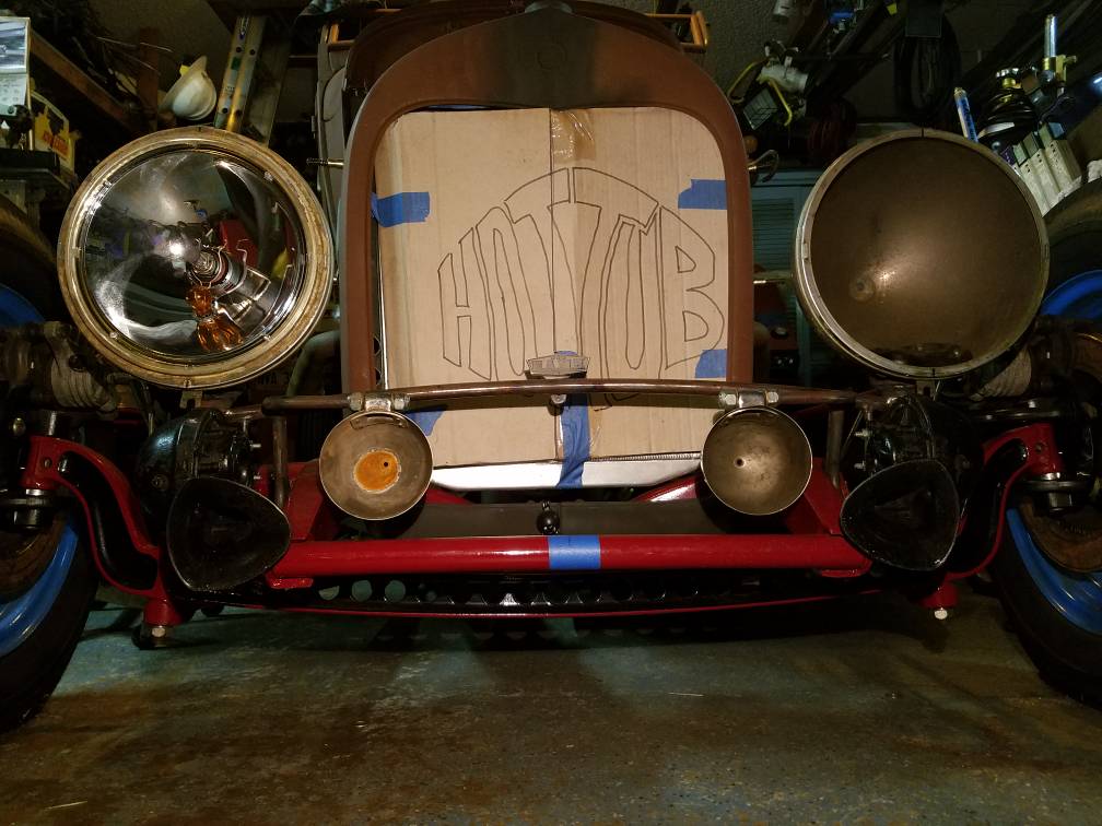

    If these lights were perfect...couldn't do all this **** to 'em...and couldn't afford 'em...perfect!
    Headlights Not aligned yet -
    Just gotta paint the horns and put'em on.
