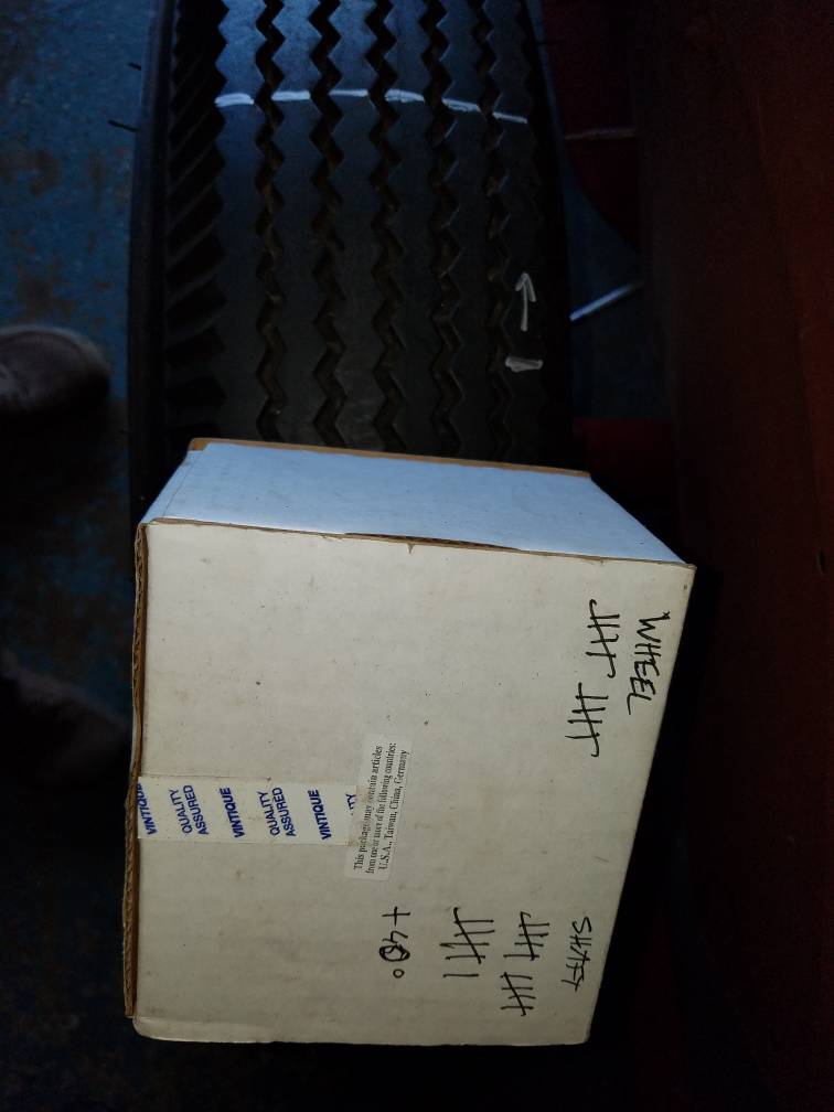

    8 and 3/4 gear ratio?
    Rear is from 1960 with huge rear drums (emergency / Taxi) drums & tapered keyway ends)
    Spun rear tire 10 times with the other tire locked. ( are there tire goes backwards when up in the air)
    Drive shaft rotated 16 times + 40 degrees.
    1:61 ????
    Am I doing something wrong or is it for real?
    Keep 'em for Bonneville [emoji6]
    1st. Really Sunny day in weeks...!
    Sent from my SM-G930T using The H.A.M.B. mobile app

  21. Dean Lowe
    Joined: May 20, 2008
    Posts: 22,043
    Dean Lowe
    Put a chalk mark on one of your rear tires, and a mark on the driveshaft. Turn the driveshaft by hand. Count how many turns it takes on the driveshaft to one revolution of the tire. 3 turns + 3:1. 3 1/2 turns + 3.5:1, and so on. Not rocket science. ;)

  23. 340HilbornDuster
    Joined: Nov 14, 2011
    Posts: 2,076
    340HilbornDuster
    Thank's Stogy.....
    Dean....i'm OFF the fence!..
    - yes 1 tire revolution = drive shaft spins less than 2 times....~1.6.
    that's why I did 10 turns...
    2.76 is the lowest gear set I've seen for 8-3/4...?
    ..Mahalo Guys!

  25. '52 F-3
    Joined: Sep 30, 2007
    Posts: 961
    '52 F-3
    from Central PA
    lots of great work, I really like the military connectors and wire covering your using. great attention to detail....
    Have you figured out the gear ration? Do you have a posi or limited slip rear?
    Posi: Jack both wheels off the ground. Turn one wheel 1 complete turn and count the turns on the drive shaft.
    Non-posi: Jack one wheel off the ground. Turn the wheel 2 complete turns and count the turns on the drive shaft.
  26. 340HilbornDuster
    Posts: 2,076
    340HilbornDuster
    Hi Gregg
    Mahalo Dude!
    & Thanks for saving my Brain!
    It makes perfect sense!
    ...So I have a 3.23
