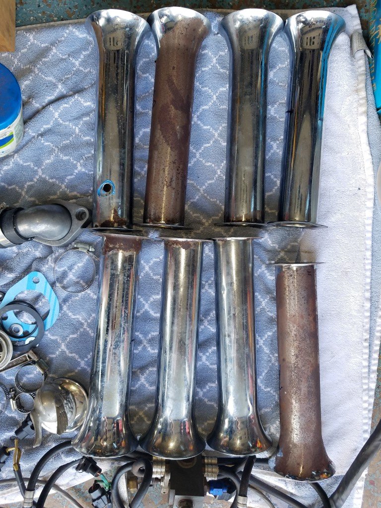

    GOOD:
    New Injector hoses Shipped out yesterday from Hilborn!
    SAD:
    The Stacks look Kinda sad....Too Ratty!
    I just can't bolt'em on like this!
    1. ~$1000 to have them chromed...
    2. Afraid I'll never see'em again if I send to Chrome...(Hilborn don't make these anymore!)
    Any Chrome Shop Recommendations?
    Options?
    3. Half the Chrome peeled off...How do I get the rest off?...Muriatic Acid? ..Or Probably lots o' grinding?
    4. Paint or Maybe I can find one of those Chrome Paint Guys on the Island...Any Good?

    If there is any chance you're going to have them rechromed, I think you should not grind on them. Most of the cost of chrome plating , is the polishing. If they have to polish out grinding scratches, it will cost more. Having the chrome shop remove the old chrome may be the most efficient option.
    No more heat than those will see, you can get away with some kind of powder coating or paint that may be close enough to chrome. I don't know how close they can get these days.

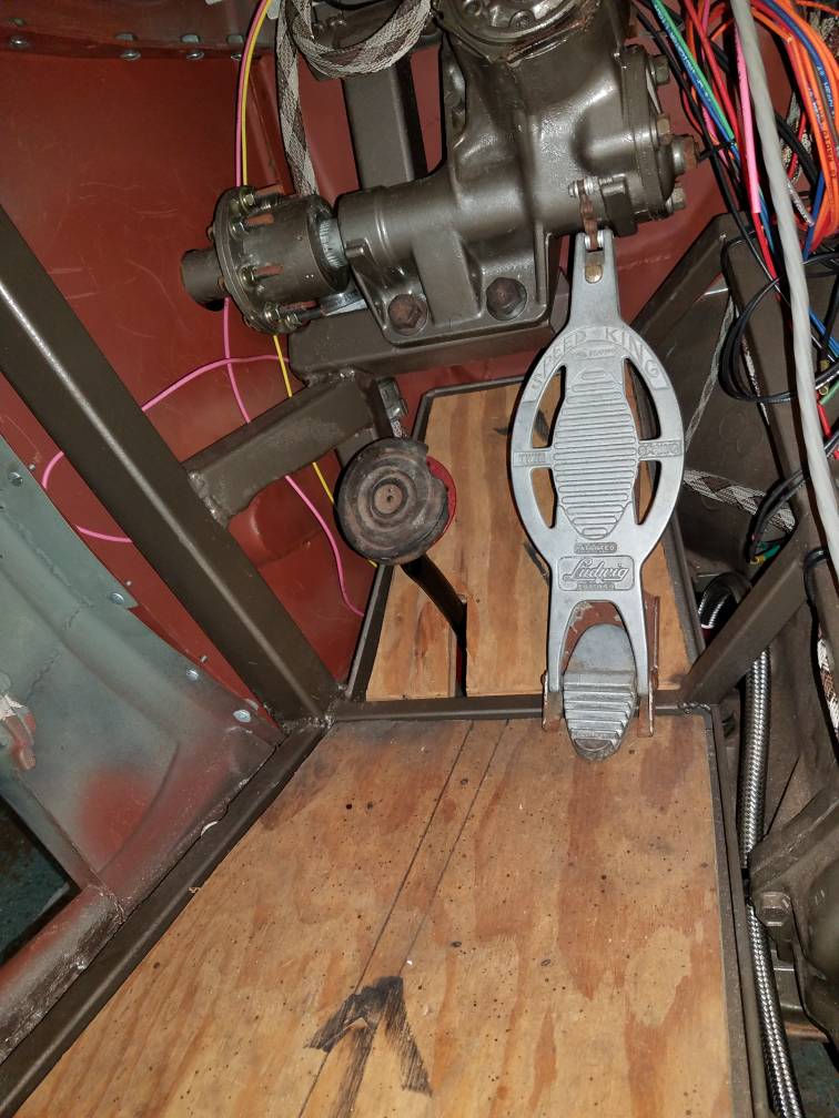

    Kindo painted myself in the corner here....
    Think i have an idea with brake or copoer tubing bent around the steering box w. a wire....? 20180801_194020.jpeg 20180801_194437.jpeg

    Tough call but very little on these things don't tug on the wallet.
    340 heres an old thread and it says that was an inexpensive part of the process however zoom to 2018 and I'm sure it is more...how much maybe very little. Maybe you can get it stripped, then polish, and clearcoat/gibbs...

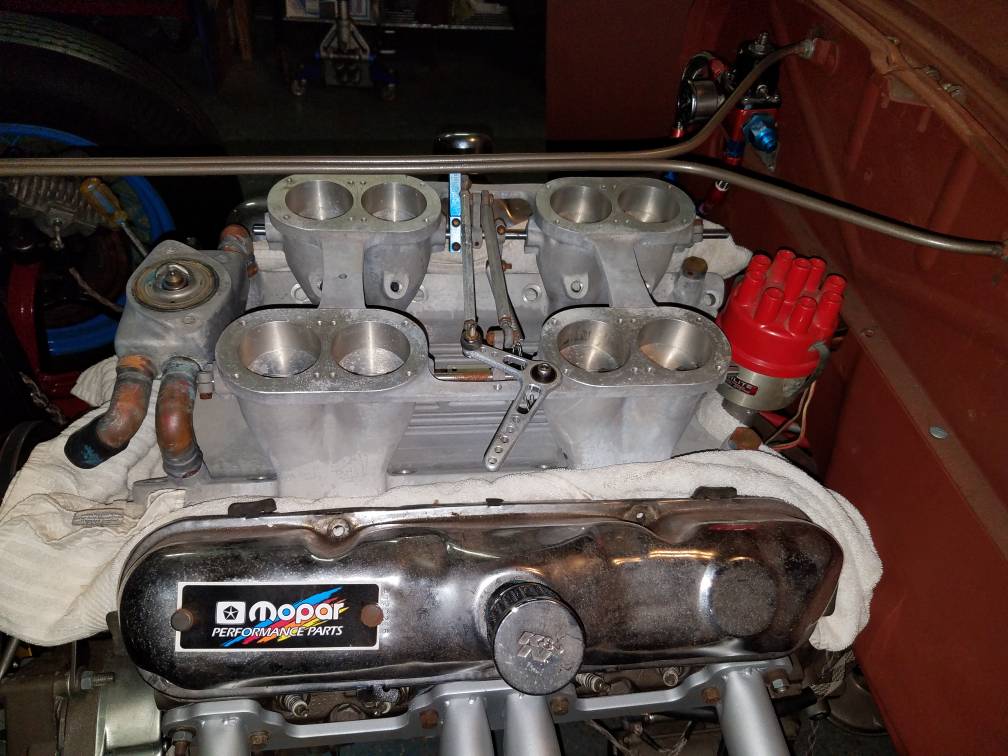

    Injector setup.
    Converters in....just waiting for new o-rings for the injectors.
    Would be sacrelidge to paint the intake so I just WD-40'd it.

    I know a guy that does chrome or nickel plating under the table. I'm going to show him the picture of your stacks, and ask for a price. (what saves me a lot of $$$ is doing ALL the prep myself, the he just dips)
