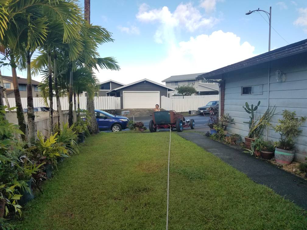

    Sent from my SM-G930T using The H.A.M.B. mobile app

  3. 1-SHOT
    Joined: Sep 23, 2014
    Posts: 2,946
    1-SHOT
    from Denton
    Looks like you used a chain saw to cut the wires.
    Stogy and loudbang like this.
  4. 340HilbornDuster
    Joined: Nov 14, 2011
    Posts: 2,113
    340HilbornDuster
    (Spider) Hairy Picture!...forgot I posted that!....Chainsaw?...Pretty much...
    2 center pins (9 & 10) was soldered together...Needed all 19 circuits!
    Lesson learned again = Use a Soldering gun with a fine point and Lots of Heat...
    I had to heat the tip with a Propane torch...
    Stogy, loudbang and AndersF like this.
