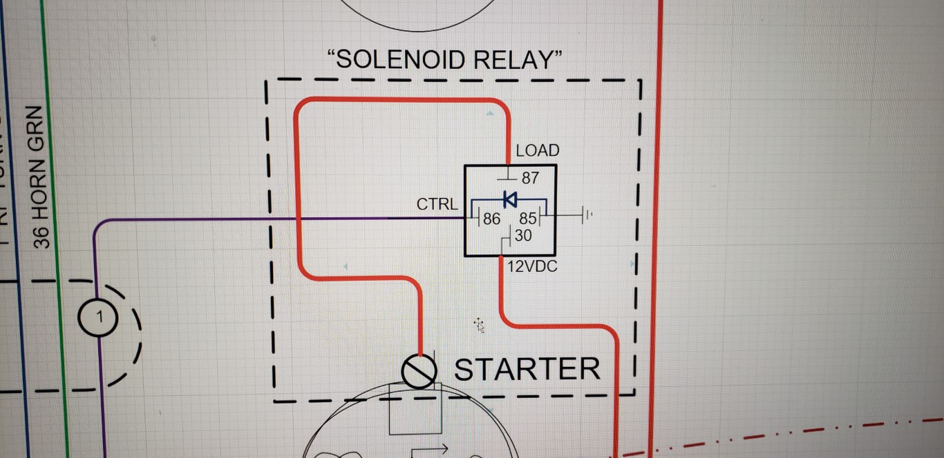

    ELECTRICAL GREMLINS...?...
    - All that **** in that small space with a Computer next to it...TROUBLE?...Yup!
    ECU kept re-booting...when starting.
    1. changed power source to the "starter Solenoid"
    2. Shielded the Coil Wire.
    3. Tried Moving the ignition away from the ECU.
    4. Damaged pin on MSD...
    5. MSD Dead...(Nothing looks Fried?) Got new one from Orealy's...Now I have Spark...
    Still have some weird interference...
    6. Batteries (2ea. 6Volts) putting out 11.65 Volts fully charged...(probably been sitting too long)
    Took the battery out of the Truck...Try again this weekend.

    looks like your old MSD had a pin pushed back in the socket
  17. Stogy
    Joined: Feb 10, 2007
    Posts: 27,523
    Stogy
    needle nose, grip pull fwd to lock in position test...maybe...
    brady1929 and loudbang like this.
  18. 340HilbornDuster
    Joined: Nov 14, 2011
    Posts: 2,113
    340HilbornDuster
    Yup MSD Pin was pushed in...Good Eye!...fixed That!
    Box still Dead....look at the picture nothing looks bad / replaceable?
    I need to fix
    1. voltage drop at Ignition circuit. - At rest ~1V - Start 3 to 5V
    2. Noise - Move the ECU inside a steel box.

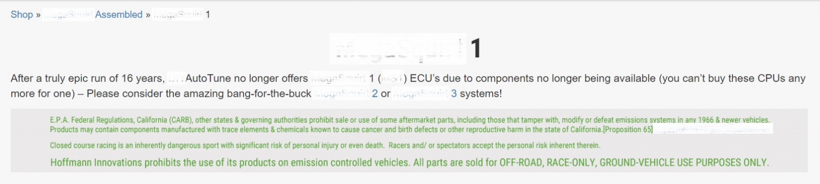

    3. Found this on the inter web...I only have 2 CPU's left...Fried 2...
    I removed any traces of brand name...
    I think it's Time to upgrade to a -2 (invisible ink)
    loudbang and Stogy like this.

  22. 340HilbornDuster
    Posts: 2,113
    340HilbornDuster
    Stogy...Howzit?
    Rain Drops?...All the Engine Connectors are New "Water Proof" type...
    Dirt t...Good Point!
    Suppression Spark Plug Wires?...After I fix the Voltage drop problem I'm going to pull the wires of the truck and try!
    Points Distributor?... Mallory Unilite Electronic.
    2Blue2...Mahalo Sir!
    Update - Messed up my Neck & Shoulder - Pinched nerves and stuff - Getting better though!
    o_O Later!
    2Blue2, brEad and loudbang like this.

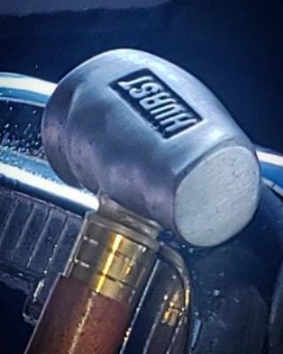

    Crushed my Heel Bone - day before New Years...

    Hilborn...healing thoughts your way...you had a double whammy...:oops:
    I'm always glad to see you back up...heal my friend and I hope you're finding ways of tackling the 29...you're really honing in on big milestones.
    Love the cane...there's some special power in that...and I'm sure it'll have a spot nearby when you turn that key even if it's for a hat rest or hood prop...;)

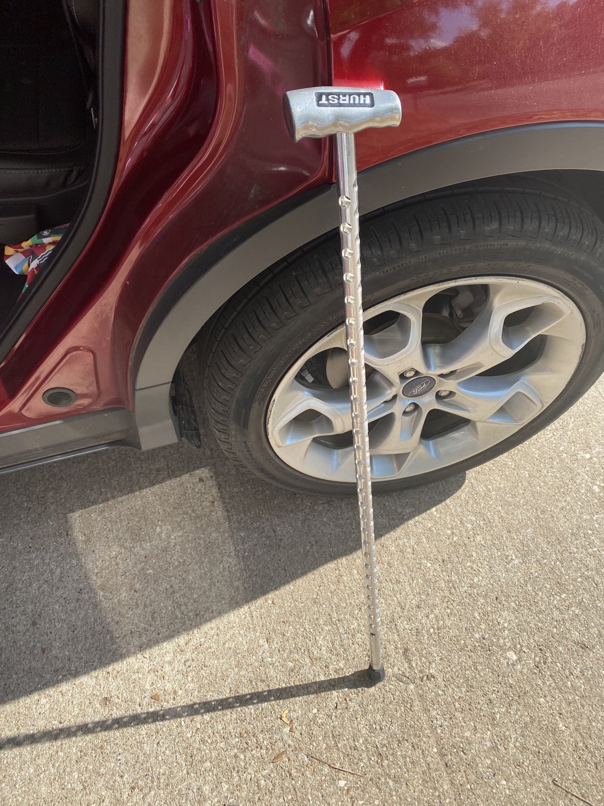

    IMG_5589.jpeg I like the T Handle on your cain, I have one on mine

    Wifey helped me put the "new one in"...****oned everything up. OK Let's GO!
    Car won't start!? %#^*#() the F@(#...
    what could be wrong all of a sudden?
    Found a blown fuse - AHA replaced is - POPPED AGAIN!
    - Now the TUTTSFITT (aka Ol' Smokey) was Dead! (explanation in earlier thread).
    - Fuel Pump wouldn't run!
    1. Alternator wire broke off when starter removed.
    2. Diode fried in dash board switch - Removed it.
    ...things looking up again...
    Engine starts - Super Rich! - started tuning - Neighbor MAD at me!
    Then Noticed - NO OIL PRESSURE! - Bad Gauge...
    See Next Post - If it works?
