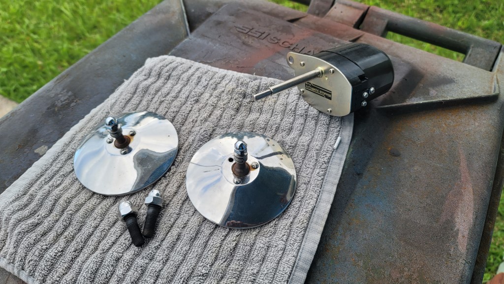

    Windshield Wiper - 1 of 8 Requirements for Hot Rod Registration!
    20230905_193159 (Custom).jpg 20230907_190445 (Custom).jpg 20230907_190455 (Custom).jpg 20230910_141840 (Custom).jpg
    Tacked on (looks silly) - will be replace with cable driven wiper later.
    Seat Belts are another...Done!
    Rear view mirror - Not a requirement but a Good idea to see Anything behind that ****.

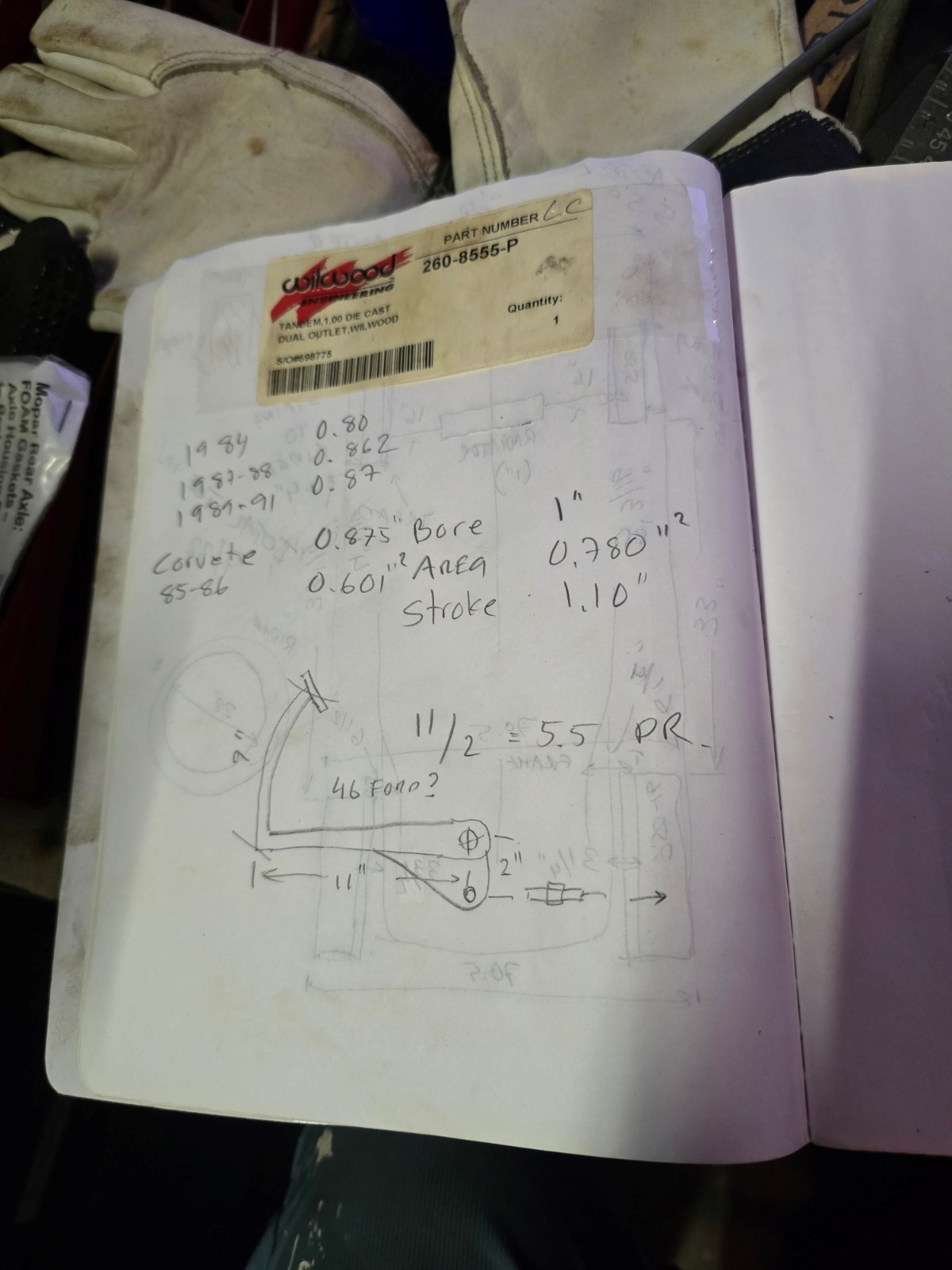

    1. Dragging front brakes...(noticed on longer drives)
    Held the engine back - trying to base tune...
    Made a foot rest for my left foot!
    Bleeding & Fine tuning the Break Rod length.......
    I might change to a smaller 15/16 or 7/8 master? for some more power.ooik

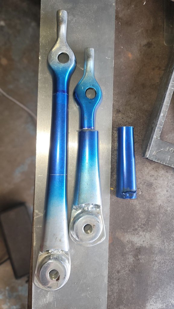

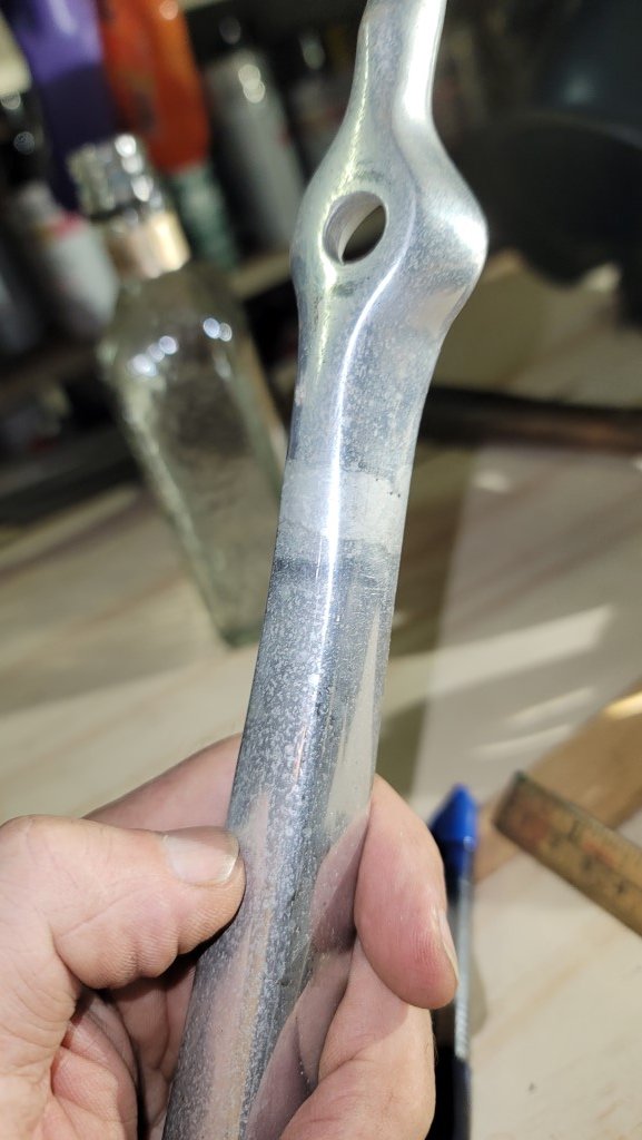

    2 Death Wobble
    Front Cross leaf with no shocks = death wobble!
    (Add dragging front brakes to it)
    Finished the Shocks!
    They don't make Shorty / Same Side Dog Bones.
    Cut / Flipped / Welded
    Shackle brackets from two Old Break Pedals

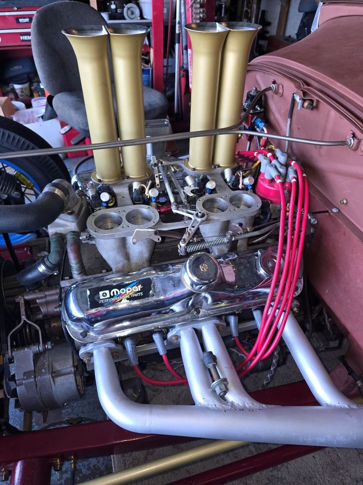

    Calibrating the Hilborn Stacks.
    The Throttle Blade Screws came right off,
    Easy to adjust.
    after "a Couple of" Testing / Adjustments...right on!
    Still running lean when getting hot.
    (Hot starting problem in the duster)
    Idiot mounts the "thermometer" that adjusts the Carburetor on fire wall...
    Fixed!
