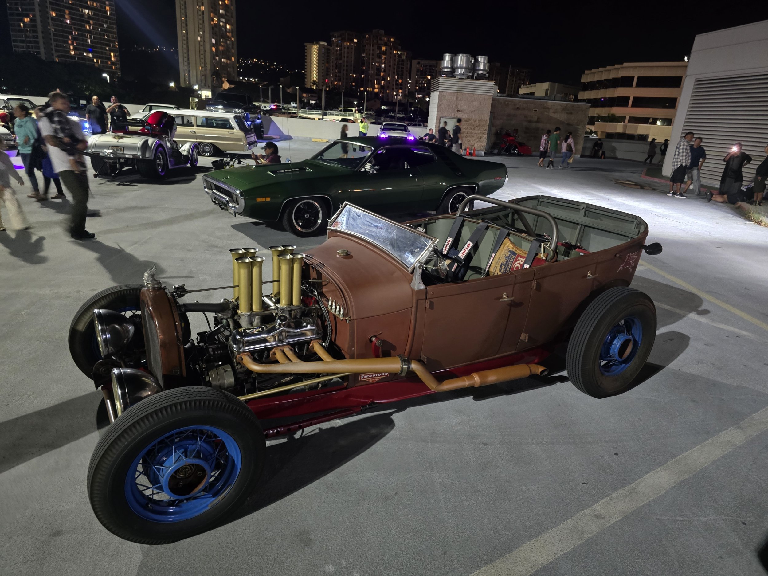

    Finally legal - time for a good bath.
    20241003_101355.jpg 20241003_092245.jpg 20241002_110313.jpg 20241002_102745.jpg
    Stogy, Xman, USMercUte and 8 others like this.

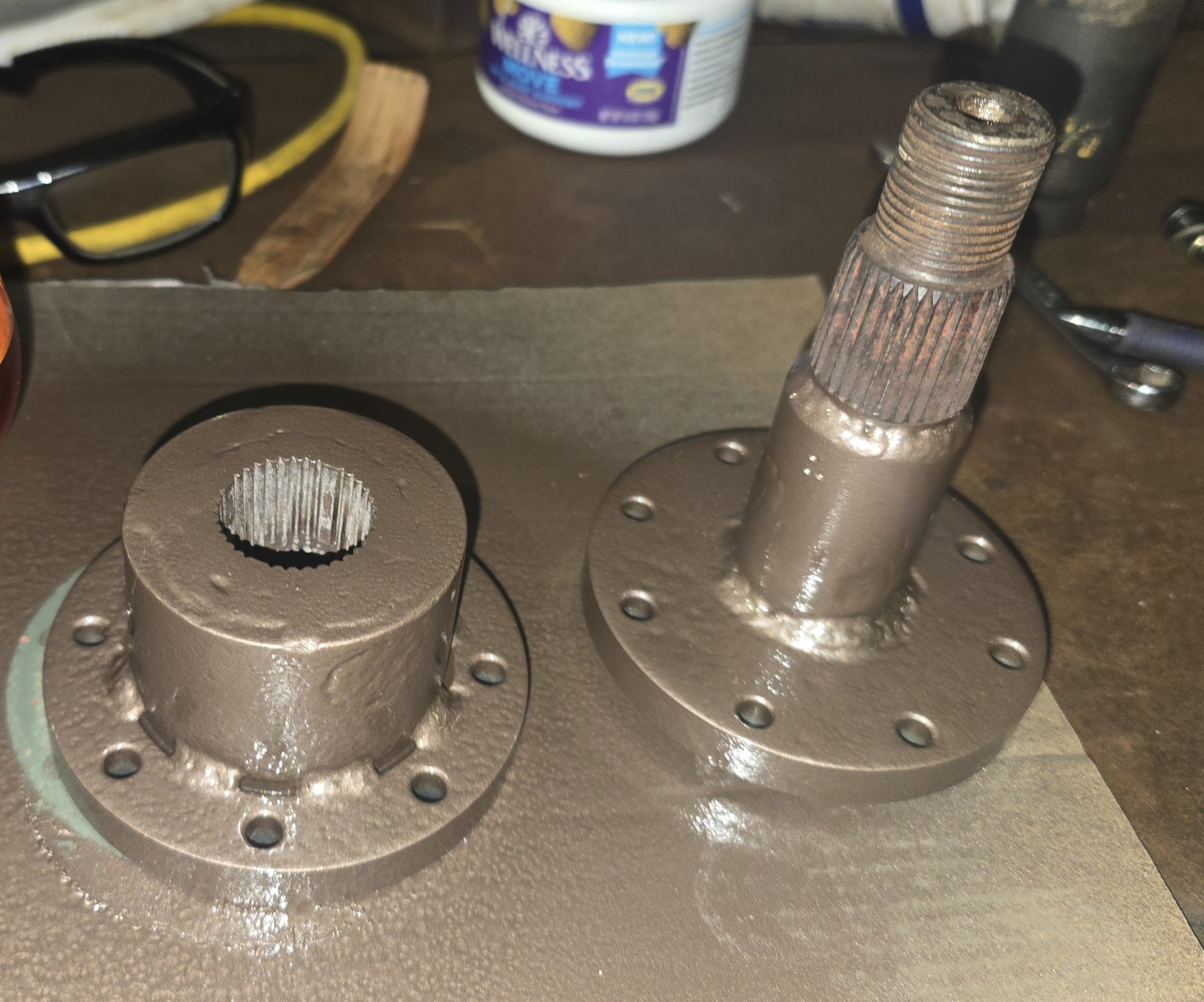

    Upgraded the steering coupler.
    Original had 3/8 flanges...
    New ones a bit beafier... 20250113_172956.jpg 20250119_215352.jpg 20250122_191957.jpg 20250124_174205.jpg 20250124_202144.jpg 20250124_211257.jpg

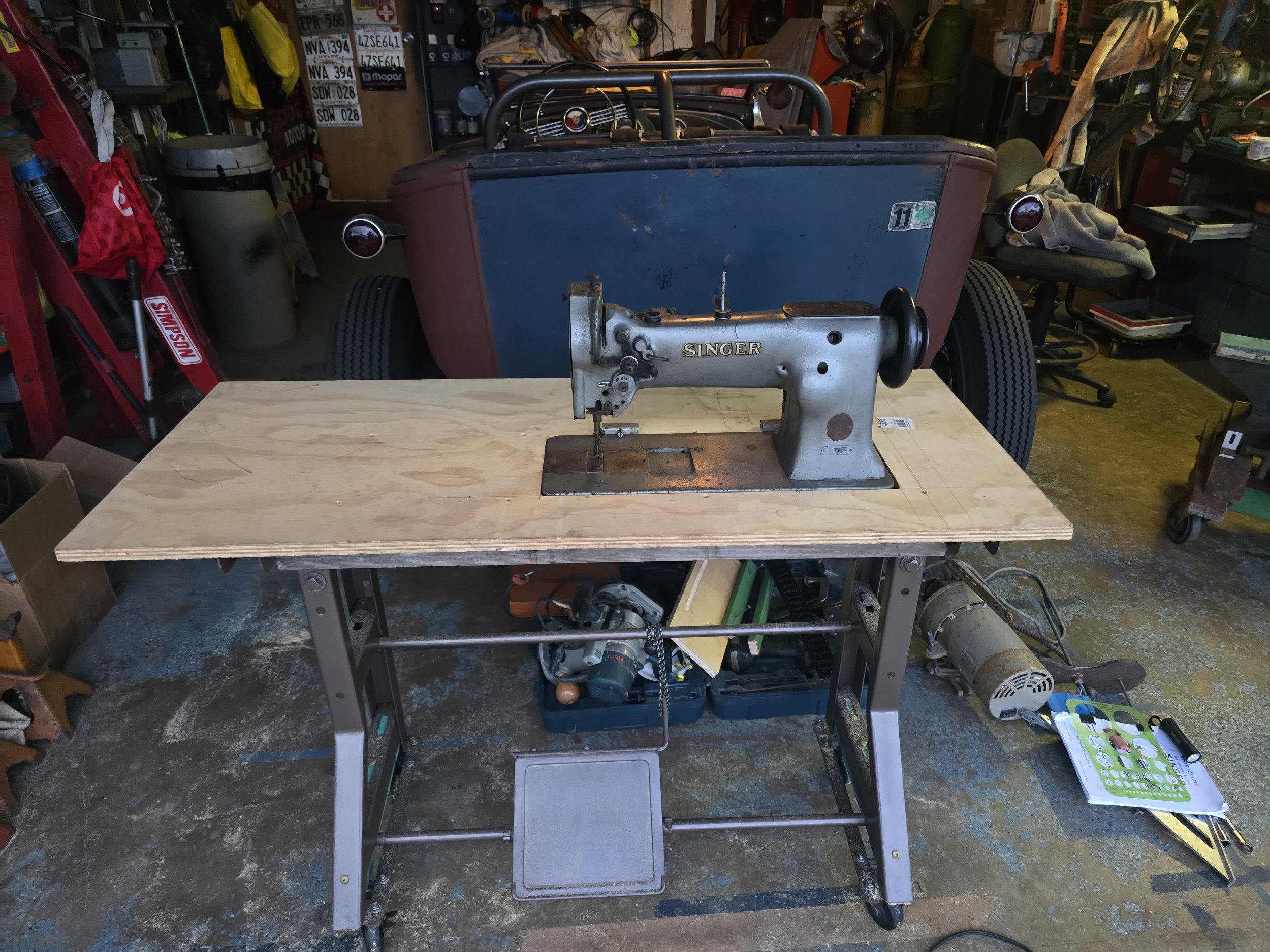

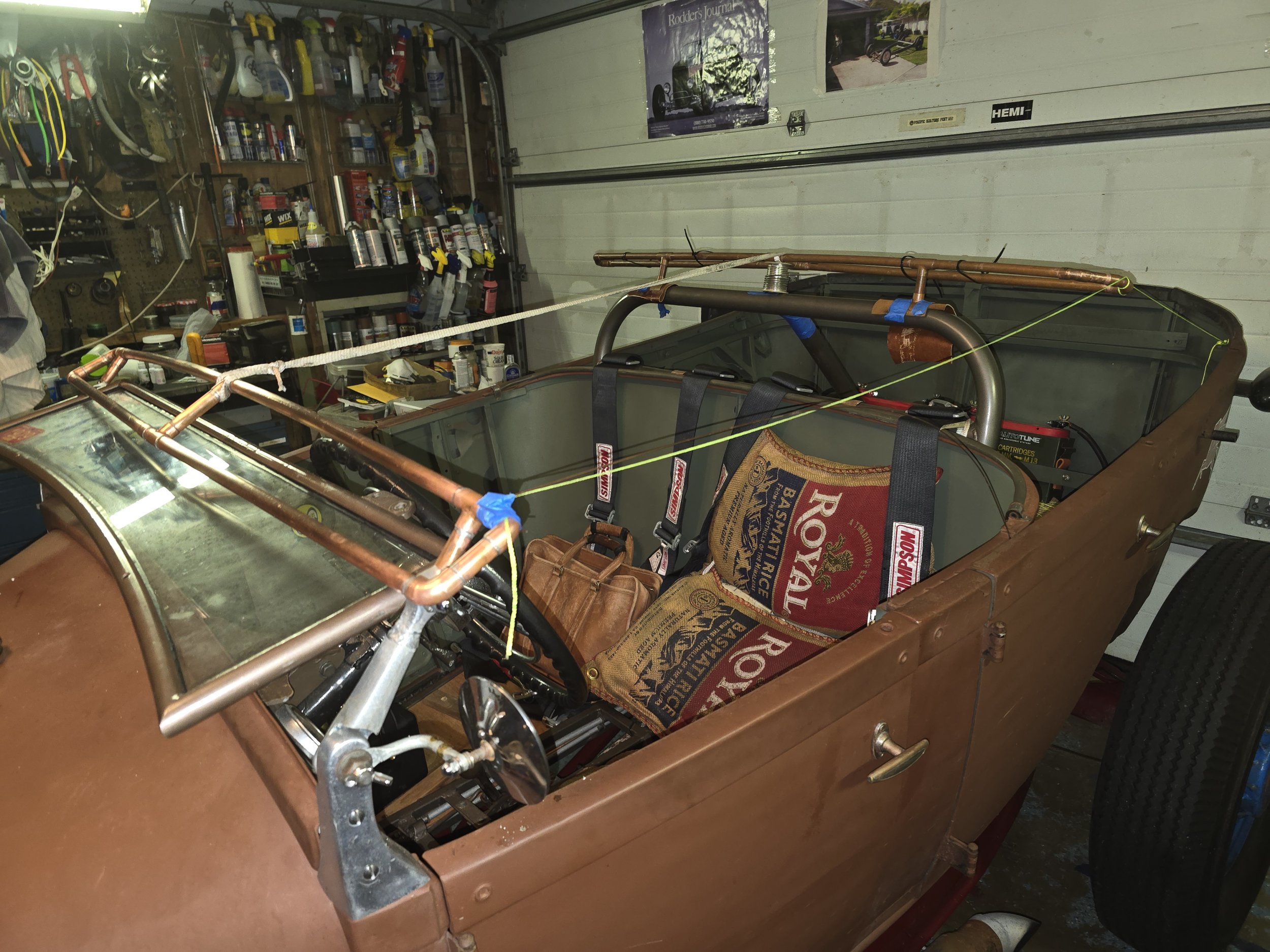

    Fixing up a Singer 111w153
    To hopefully make leather seats / interior aide panels + a fabric cover & top. 20250415_185401.jpg 20250206_194546.jpg
    New copper top *bows*
    Tim, brEad, '52 F-3 and 1 other person like this.

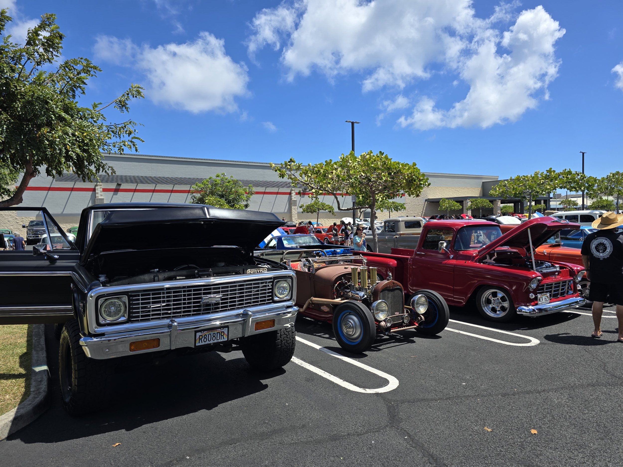

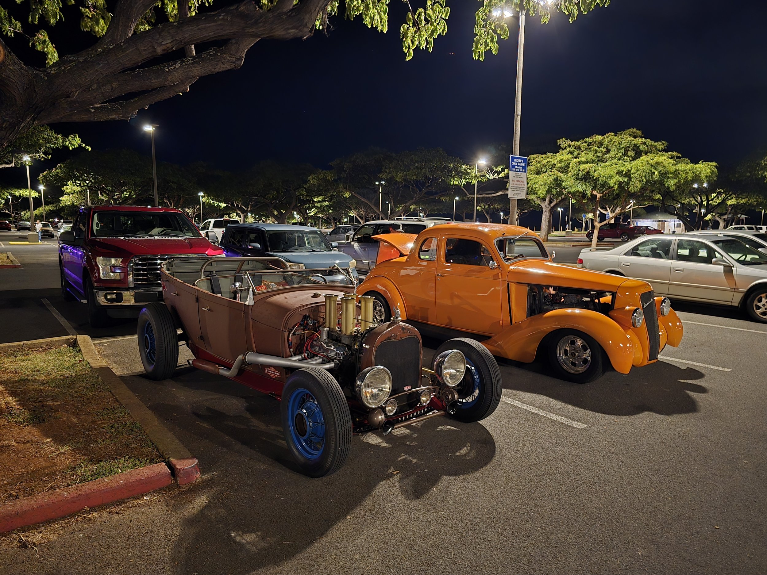

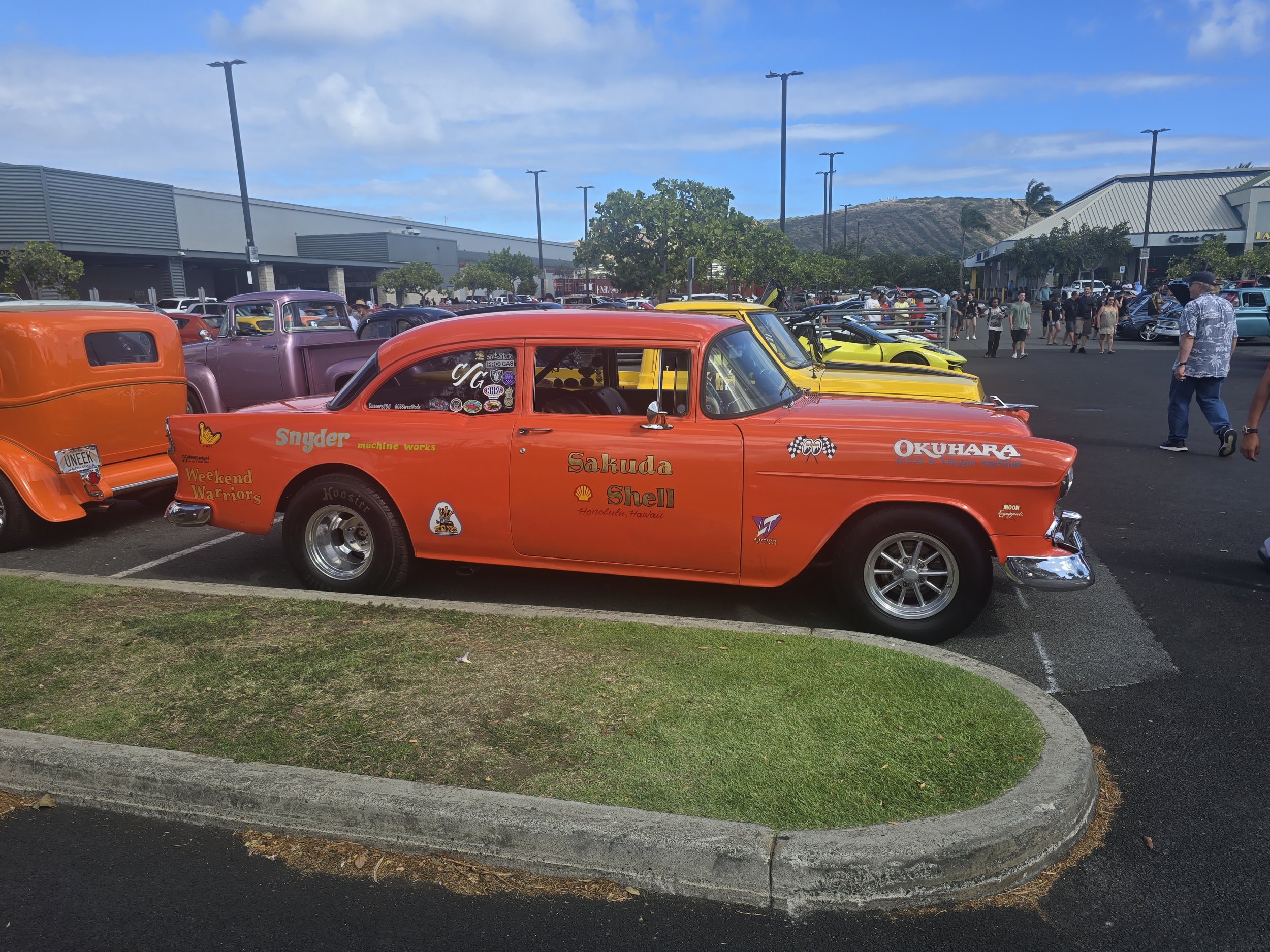

    Memorial Day Car Show - Awesome Day.
    20250526_130446.jpg 20250526_141311.jpg 20250526_142050.jpg 20250526_142433.jpg 20250526_142526.jpg 20250526_145215.jpg 20250526_155601.jpg 20250526_160040.jpg 20250526_172017.jpg 20250526_174716.jpg

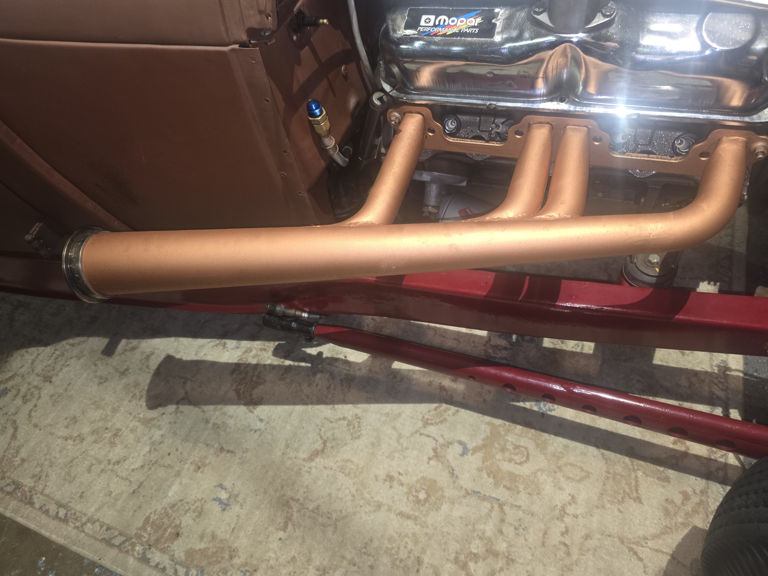

    20251013_173826.jpg New header paint.
    Cool color...not dog poop brown.
    2000°F...not 1200.
    We'll see how long it lasts?
    Stayed sticky...So i sprayed w. Water (YouTube tip)
    Actually worked!
