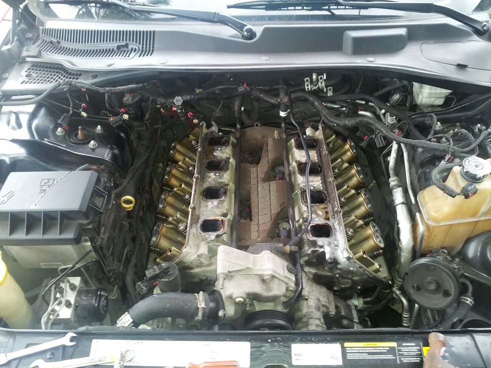

    Then a new project....
    Hemi overheated and the valve seats "fell out"
    New **** cars....I wanna see the valve seats fall out of a 392.

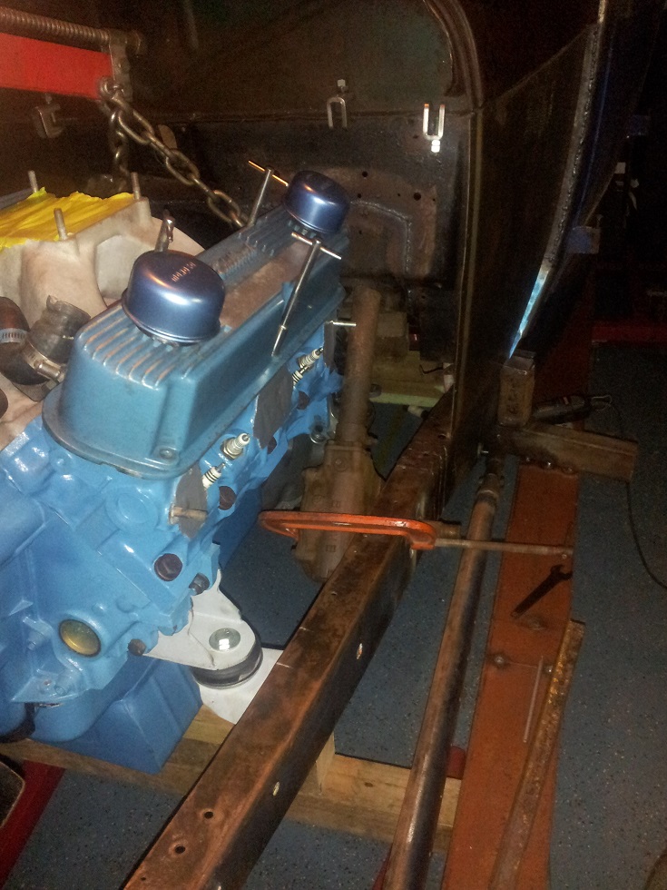

    fr1.JPG fr2.JPG fr3.JPG fr4.JPG side1.JPG I guess the engine's staying:
    I shackled the new (real! Made in USA!) front spring, to the bone perches.
    Now the cross member moved back about an inch to get the right geometry for the spring movement.
    Not worth moving the engine half inch!
    These Stainless "Beam Clamps" come in handy all the time...
    Lifted it up tight against the frame rails for final welding...(got some cleaning to do first!)

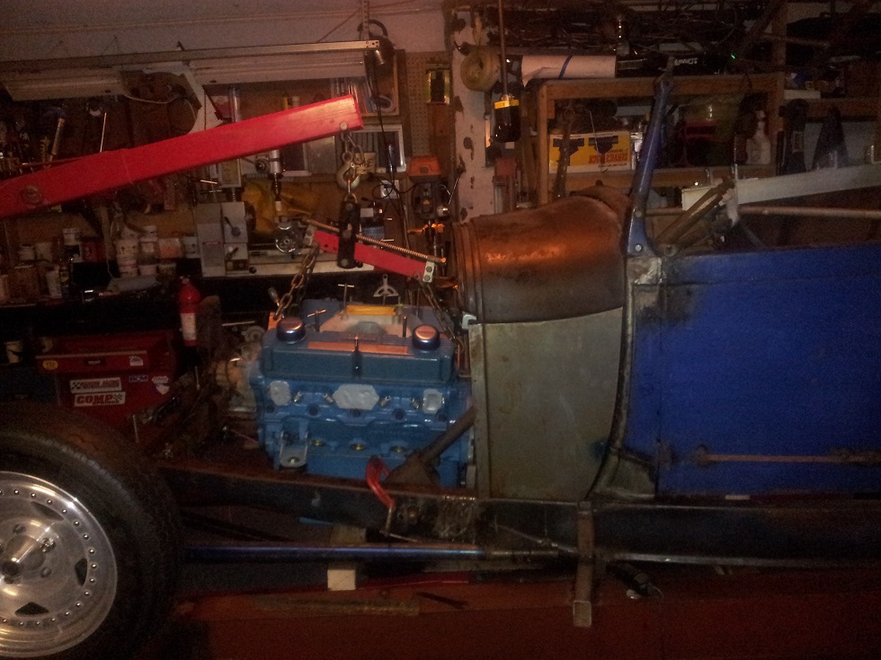

    BHG-1.JPG grl1.JPG grl2.JPG grl3.JPG grl4.JPG grl5.JPG grl6.JPG Only time to wrench is after work....
    1st.
    Trying to get all the proportions to line up...
    Front end looked really good earlier but didn't line up
    with the main body line...
    just keep moving the tape and walk around looking..
    2nd.
    weird how much less than an inch "does" sometimes...
    yellow compaired to blue.
    3rd.
    I got the stance I'm looking for but i'll try raising the radeater shell
    up 1 or 2 inches.

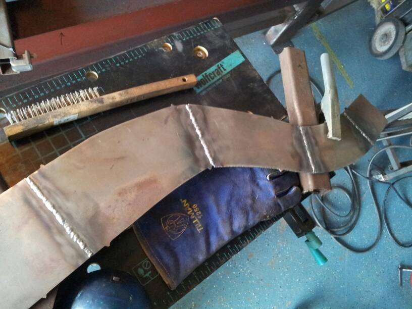

    1st. I had to get the bushings out of the spring..
    Made a driver in the Lathe....Still No way they're moving.
    Got 3/4 inch drill bit from the local ****y Mill $26....
    Done!..All the bronze cam out without damaging the spring.
    Then I had to make a Spring Spreader for a model A Spring...
    Should be fairly easy with some leftover stuff...?
    Made it out of Rigid Conduit 1" & 3/4"..
    ...It started binding under load...
    So I had to finish the surface and Hone the inside.
    Home made Socket Hone...
    ...Now I can start mounting stuff!

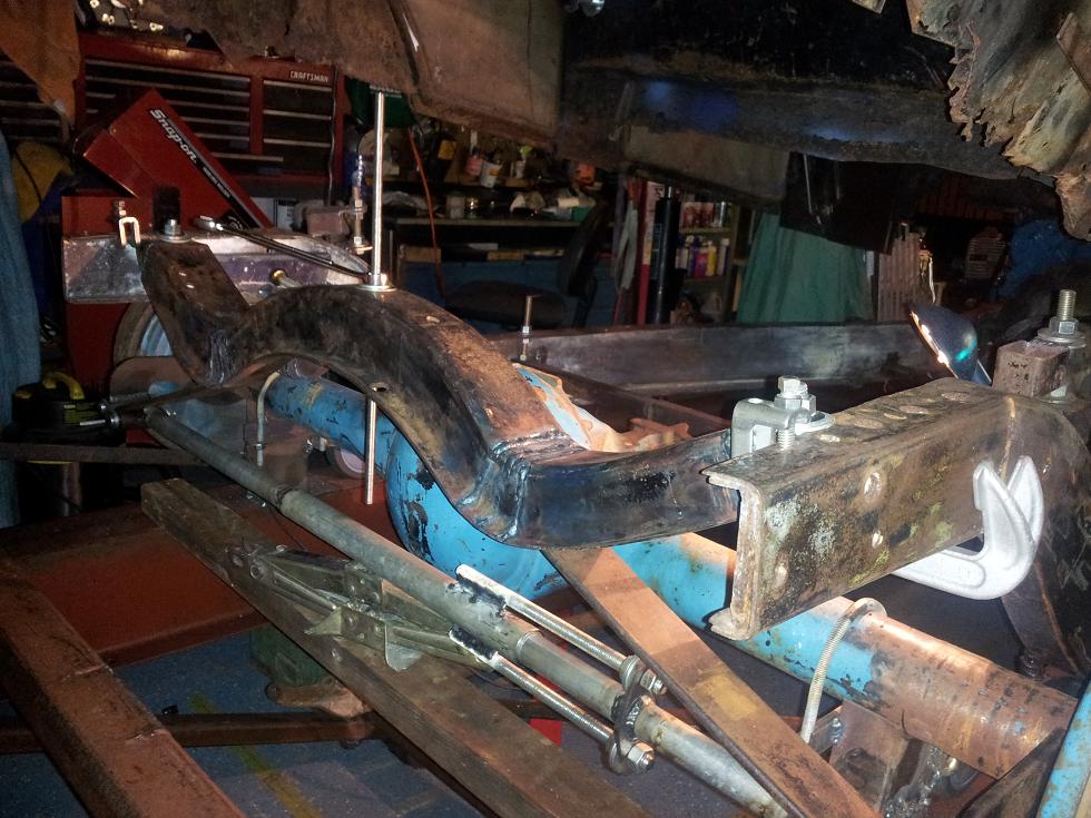

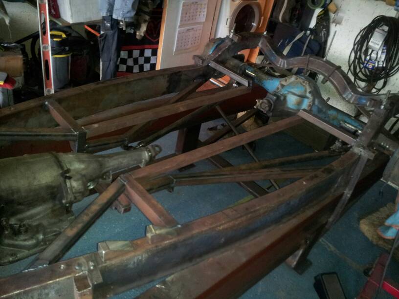

    Rear X1.JPG Rear X2.JPG Rear X3.JPG Rear X4.JPG Rear X5.JPG Cross Member:
    Got the idea for the rear cross member from the "Swedish Dry Lake Car" (this is the Model A Version)
    Ol Fart:
    Messed up my back last weekend. so the rear axle got some wheels...(like a wheel barrow).
    I moved it 1 3/4 inches backwards.
    Keep Going:
    Today my buddy will be over after work to help me restle in the spring package. There's not too much room in the back of the car..(I wish I had a bigger garage)
    T

    ra00.JPG ra0.JPG ra2.JPG ra2b.JPG ra1.JPG ra3.JPG ra4.JPG Made some gussets for the inside of the spring mounts.
    I think I'll use the Kit brackets on the top or maybe modify them to fit between the drum and the bracket...They're suppose to be mounted on the outside to take the "spreading load"
    Rear Cross Member is tacked in place...
    Actually the whole ch***is is tacked...
    LOTSO WELDING!
    Finally time to start cleaning all the weld areas, Weld up all the holes in the frame, install body mount nuts and welding in / modifying the boxing plates to fit the frame.
    Note to self - Get another tank of Argon!

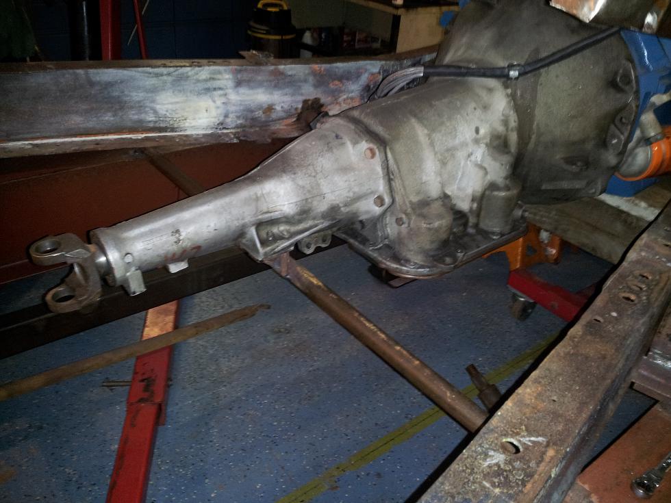

    fra2.JPG fra4.JPG fra5.JPG Lotso space for a rear seat...
    Transmission mount is welded to the table so I can box the rails without it being in the way...make a cross member with a removable bracket for it.
    Engine out...

    1929 Ford "Wheel Barrow"...Got the body on wheels so I can work on the frame..
    Nice to have the Garage "wide open" ............until I roll all the stuff back in again.
    Front section done - ready for boxing plates.
    Fish plates welded in (I won't be posting these in the "incredible welds" section)
    On the floor, between the rails, under the body, upside down, gas pedal between the knees...yadi yada.

    Almost bought me a plasma cutter on E-Hay...
    Got $(R#VV#) by thethreeonthemoon...they finally canceled my purchase after some threats and stuff..
    Anywho, making these would probably have taken an hour or two with a plasma...
    instead, oxy torch, (ran out of O2) grinding, band saw & s'more grinding.
    But who's in a rush?

    R&C / SSR Article:
    I found the (the last?) Rod & Custom August 2014 in the store yesterday.
    They had a cool story about a 32 ch***is built by Scandinavian Street Rods in Huntington Beach.
    Pinched (for a 29 Roadster), with a wedge cut kick up in the back...
    Similar to my frame but a bit more Professionally made!
    It made me think about my engine location in the ch***is...
    I never had it on the ground ... I think the 340 has to come up a few clicks... we'll see?
    Fishing:
    All the "fish plates" are welded in and the frame's dressed up.
    Boxing Day:
    The 3 piece 32 Boxing plates are finally going in...Sorry, I forgot where I bought them but they're really nice. (those little triangular tabs really helps holding it in place!)
    I have to modify front and back kicks to fit...
    MIG / TIG?
    Thanks to watching a video by Steve Szymanski @ Industrial Ch***is Inc and some s**** practice.
    I decided to MIG weld the perimeter of the plates. (It would take me forever to TIG it..)
    Lotso good little tricks in there!
    Thanks Steve!...& That's what HAMB is all about...You can learn / improve your skills on pretty much anything here.
    (Inspiration pic)...Back to work!

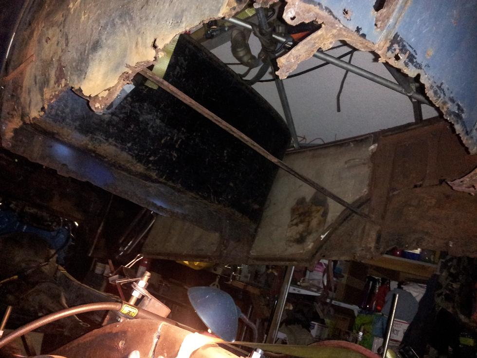

    1403764213916.jpg 1403764277807.jpg 1403764333130.jpg 1403764366456.jpg Wow...boing plates finally fitted & tacked.
    Body mount bolts welded in.
    I bunch of holes filled.
    & I finally got my MIG running real good.
    New spool of wire...old one's bad...?

    X is almost in.
    Transmission mount bushings made from suspension bushings i found at Aiea Auto Swap meet last Saturday...Grade 8 bolts from ****y Mill.
    Soon it's off the table, flip it and grind / touch up the bottom of the frame. X1.JPG X2.JPG X3.JPG
    "Rolling" Ch***is...finally!
    Little more than an X.
    Extended the top part for floor support.
    Gotta use the steel i have as much as possible.
    Tomorrow (after F1) it's off the table!
