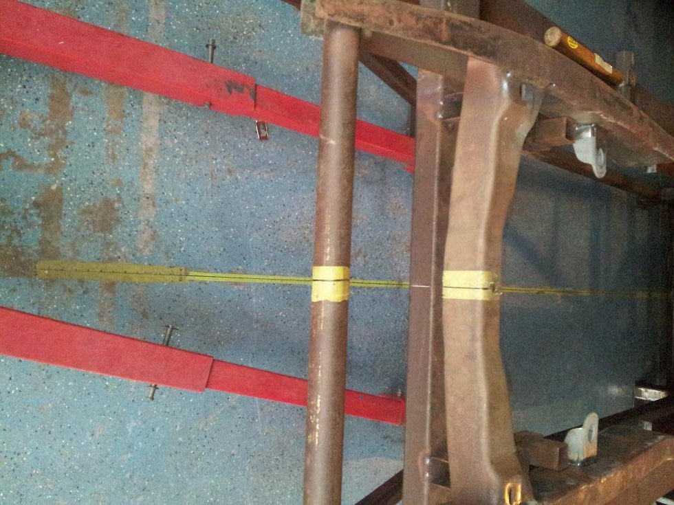

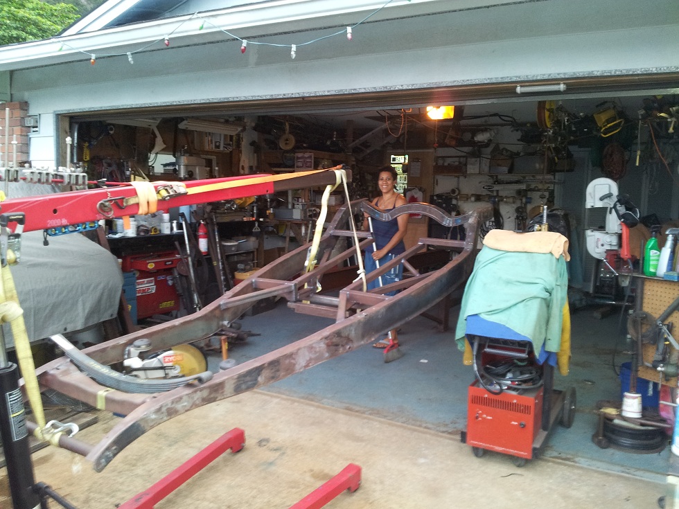

    Uppside Down!

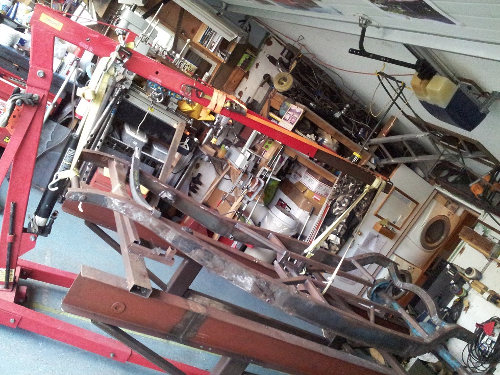

    Welded up..
    Haven't hooked up the water cooled torch yet...no pump/cooler.
    The torch's so hot I had to use my MIG gloves..

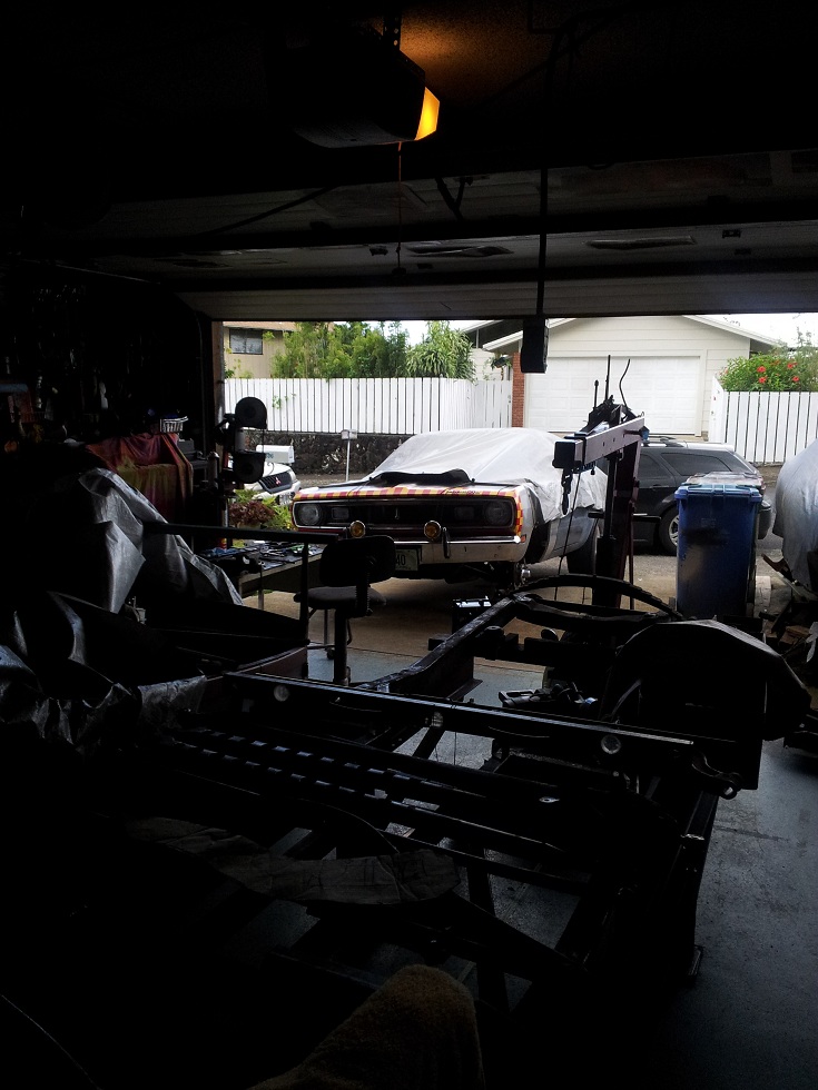

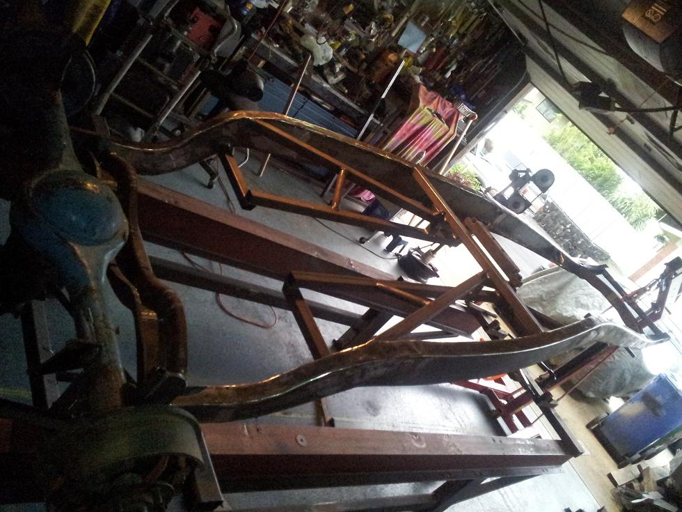

    Ch***is is DONE. Flipped it over twice to finish all the welding....It's still centered, straight & level!
    NEXT - Get the table out of here and start bolting on some suspension parts.

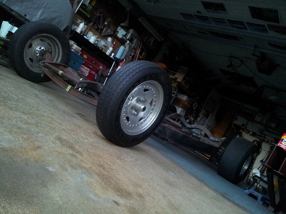

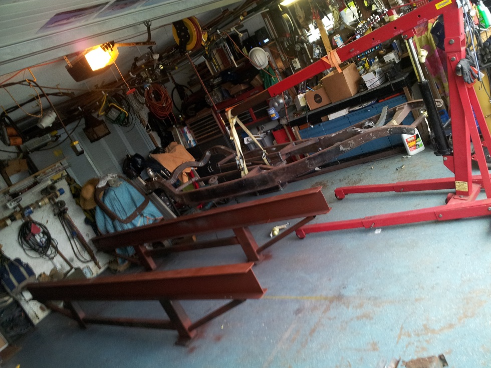

    Frame Table cleaned up / painted , ready for another ch***is...Bob?
    It's finally on the ground!
    I'm Stoked! Right where I wanted it!
    Kinda ****py pistures...
    I'll try roll it out in the Sun tomorrow... (If it isn't raining?)
    T

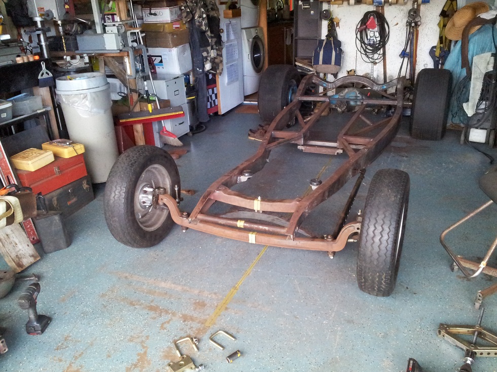

    Better pictures...
    The front suspension is a little low...
    This is where I want it to sit "fully loaded"

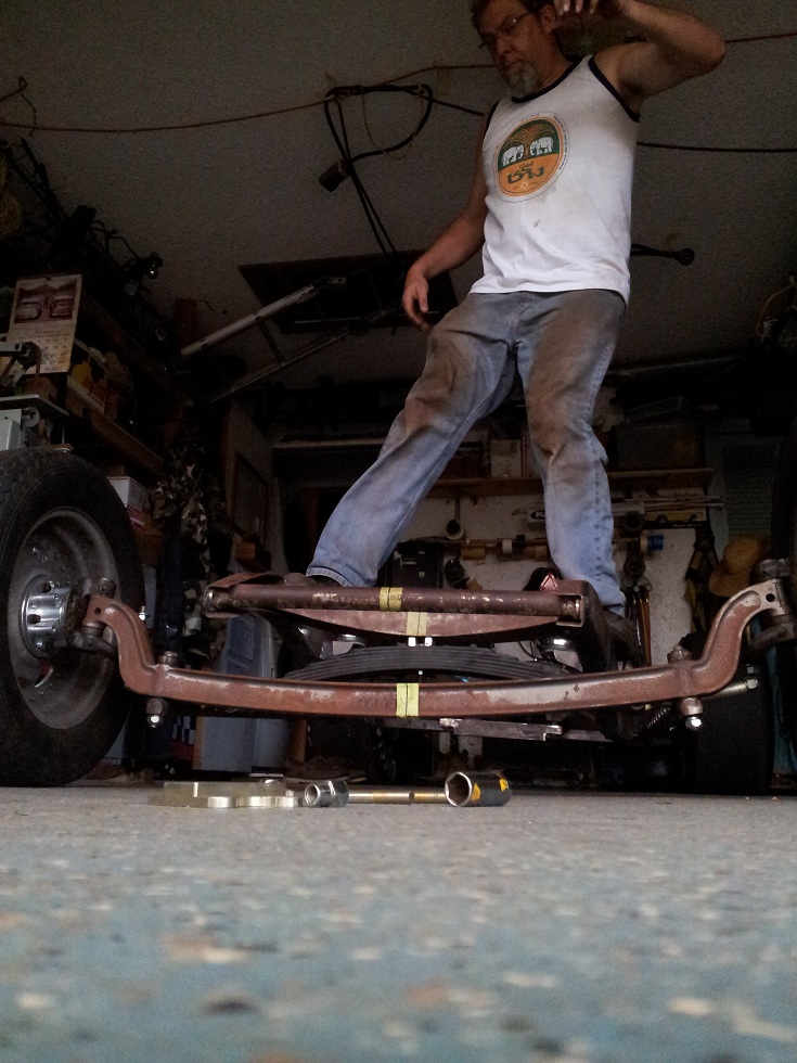

    option 1 - alter the "lowered" front x-member.
    option 2 - "regular" eye front spring.
    I'll see where it ends up with all the weight on it.
    ...........I really like the horns...easy to weld back on again later...

    It's looking great Tommy. That frame
    Sweep really put it on the ground.
    Option#4. - undropped axle?
    I'm with you... Get it all together and see what it looks like.

    metal man
    Is your concern that the axle is too close to the frame, or that the belly is too close to the ground? It's hard to tell how much space is between the axle and frame in the pictures.
    I like the frame horns too, and I think if removed, the frame needs tucked in flush with the grill shell to look right.

    Height - belly to the ground - is perfect!
    The axle is ~2.5 inches from the frame.
    That`s where i want it to be when all the weight is on...
    If i put the engine in right now the frame would touch the axle.
    Frame horns:
    Thinking about it, there`s no real reason to cut them off...
    I`m going to put a temporary "spacer" betwen the spring and x member...put the engine and ballast to se how much i need to alter the cross member?
    May have to move the engine up a touch (put a regular oil pan on it)

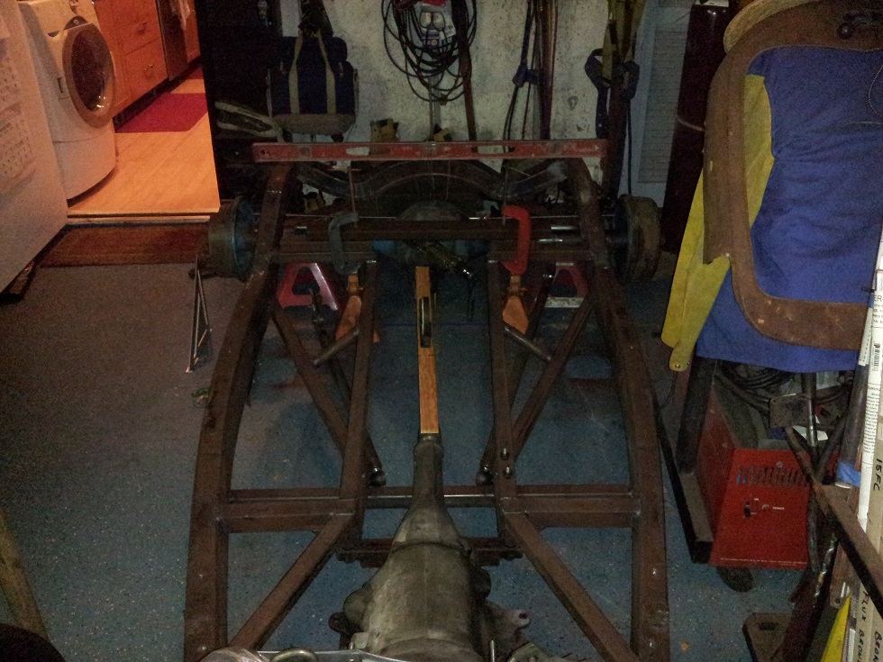

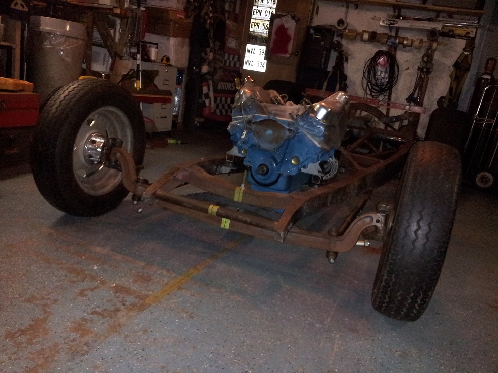

    Engine ended up a tad too low...
    So I added some 1 3/4" temporary spacers (uni strut) s3.jpg and the stock oil pan will do the trick.
    Adjusted the front spring down +1"
    A stock front x member would be perfect ... Oh well.
    The rear will come down 3-4 inches...
    Getting ready to attach the rear axle...
    Started measuring and... all reference points / angles gone with the frame table...
    Aligned the frame to THE LINE on the floor / leveled the frame
    Now the engine/trans is at 0 deg so i set the rear axle the same.
    The drive shaft will be at 3 deg or more at load...+ it is angled sideways...
    Time to pack up the garage for the night!

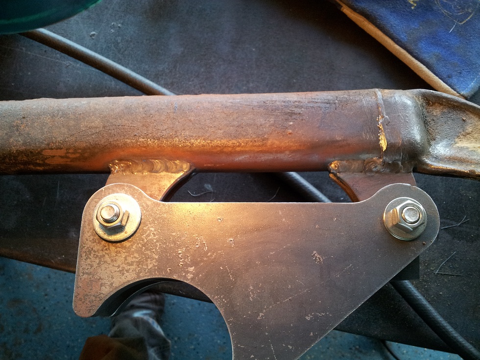

    The Brackets felt a little skinny so I beefed them up a bit...

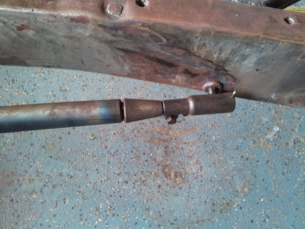

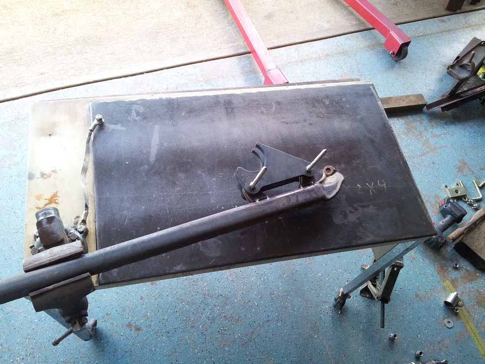

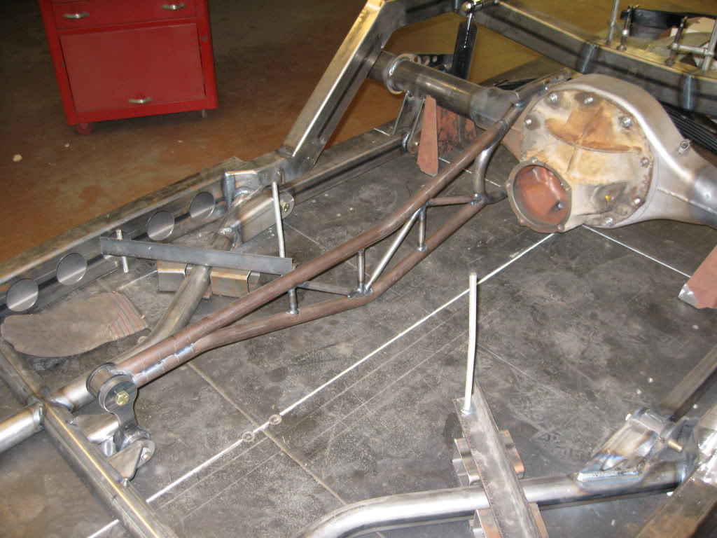

    My "torque arm"...need to by some tubing tomorrow...
    I tried to use a model A rear arm...didn't work out.

    Posts: 2,113
    340HilbornDuster
    Final arm...might put a brace in the bend..? 20140814_193119.jpg 20140814_193131.jpg

    metal man
    That's coming along nicely. What diameter and alloy are the torque arm? It looks like it may be a large enough diameter to go without a brace. Hard to say from the pictures.
  30. 340HilbornDuster
    Joined: Nov 14, 2011
    Posts: 2,113
    340HilbornDuster
    It's a 1" schedule 40 mild steel...I think it's beefy enough...?
    I might just brace it anyhow..?
