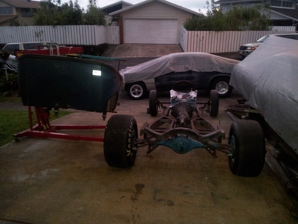

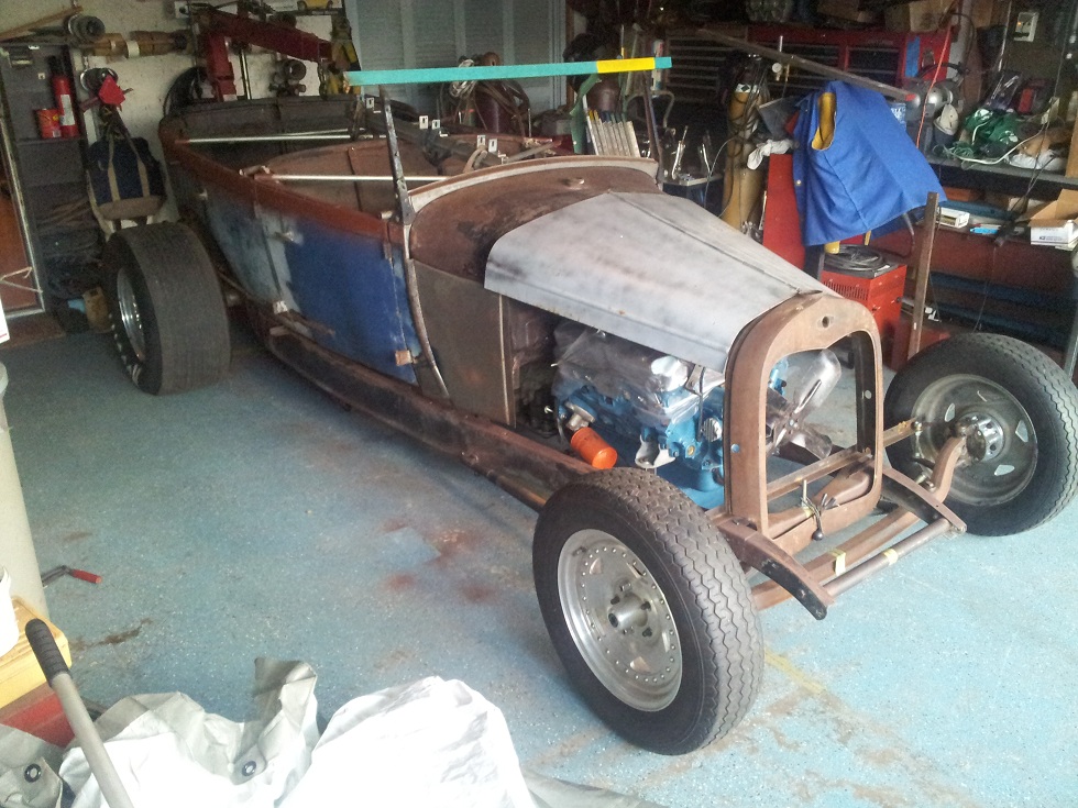

    Body storage on the frame...need to get it out of the Garage for a while...
    The Body sits ~ 2 " to high, riding on bolts and "wheel bracket"
    Hood (from my sedan) obviously doesn't fit ... but it gives an idea of what it'll look like.

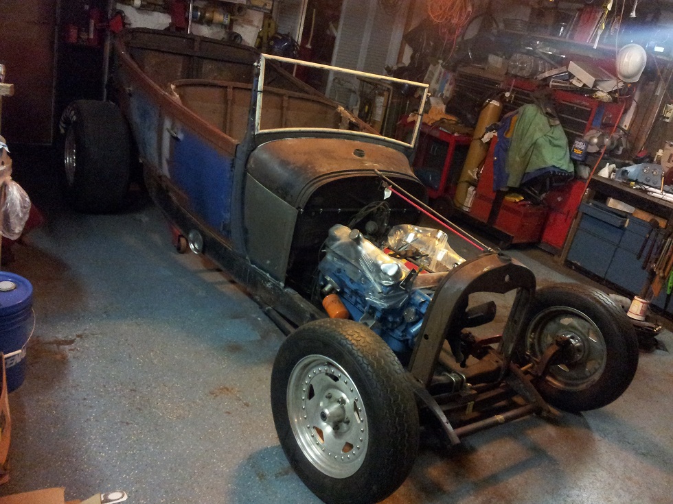

    Me and Wifey used the 30 Tow Truck & and a 2X4" to push it in the side Garage.
    Grabbed a cold one and sat down and looked at it.....It sits perfect...?
    I'll try to get another 1/2 to 1 inch in the front......................................................................................of course Down!

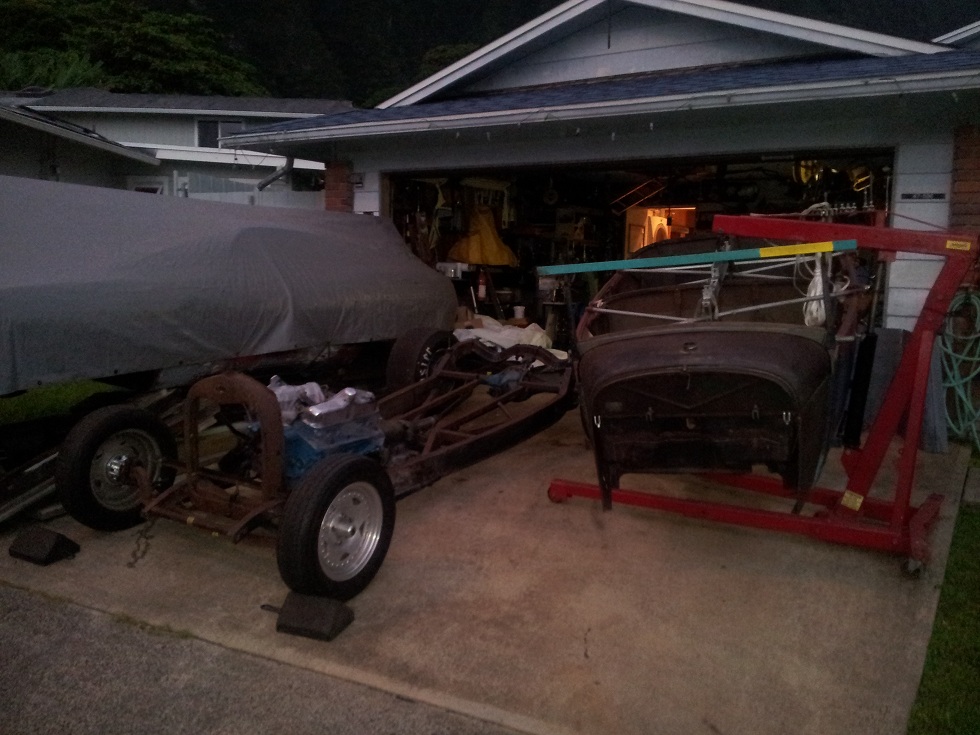

    Time to start working on the body...
    (Still have some ch***is work to finish but I want to see what the final "product"
    looks like before finalizing the ride height in the front.)
    i.e. construct a floor system and connect whats left of the bottom of the body to it.
    positive side: The Model A body doesn't fit a 32 ch***is anyways, so it would have had to be redone.
    The Cherry picker works great as a body holder...
    body1.jpg body2.jpg body3.jpg I'll cut the tank out to make room for the dash etc.
    body4.jpg 'sgonna need a lot of m***aging to fit nice.

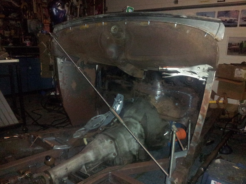

    Got the fire wall cut for the trans.
    Ordered a windshield form Snyder's..that'll be cut down to size...
    Had it on the car and it's way to tall!
    Found some 32 foldable stanchions at the swap meet...to get the rake...

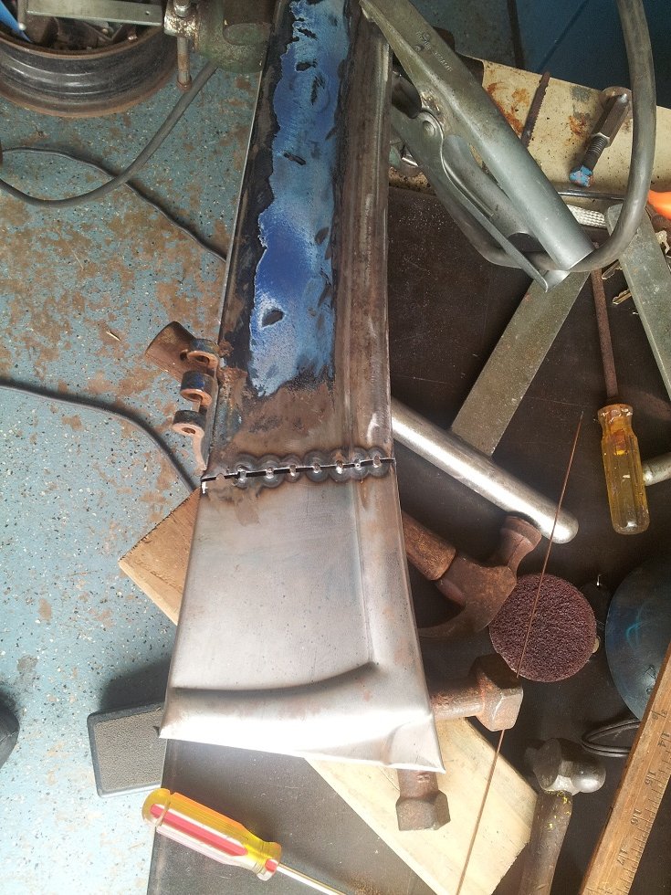

    Some how the lower cowl/door post patch piece was stamped wrong...
    The bottom angle was off by almost 1/2 inch in the back...
    Had to bite the bullet and by another one...32 bucks.
    Welded up s'more rust.

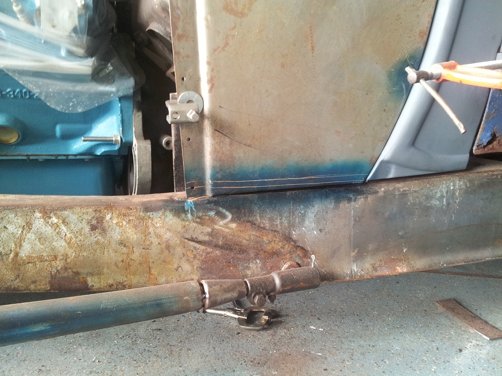

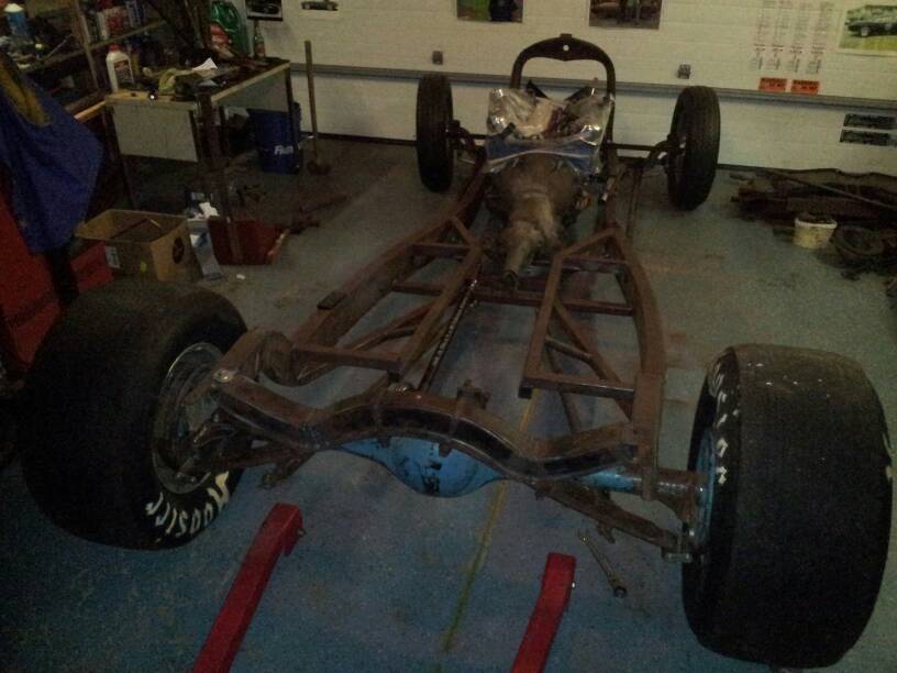

    Once I got everything lined up with the frame...it's obvious that my cowl was spreading too much...
    Need to bring it together almost 3/4 inches...
    Trying to make the attachments slide so I can keep it hanging....we'll see?
    The frame curve is following the body nicely!

    Cut down the Cowl sides to fit the frame...
    Lotso trial and error to make it fit nice...everything rounded and it's hard to find a reference point...
    the missing 1/8" on one side is finally fixed. cowl1.jpg cowl2.jpg cowl3.jpg
    Both sides done...Phone died and I ran out of Argon...tacked with MIG and final TIG weld tomorrow.

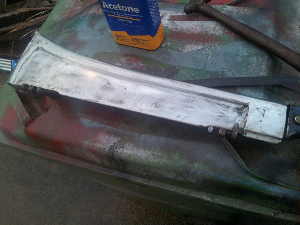

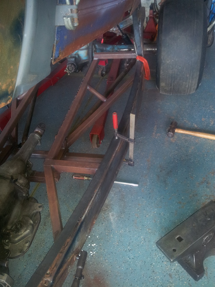

    Started work on the floor.
    1.5 x 1/8 inch cold rolled steel...
    Sledge Hammer and an (Bobby, thanks for lending me the) Anvil to shape the curve!
    Made this little transfer punch out of a Stainless Steel P.V. Roof Bolt from f2.jpg work...
    SS is harder...holds up better.
    First one almost done...Should be able to wrap it up today...?

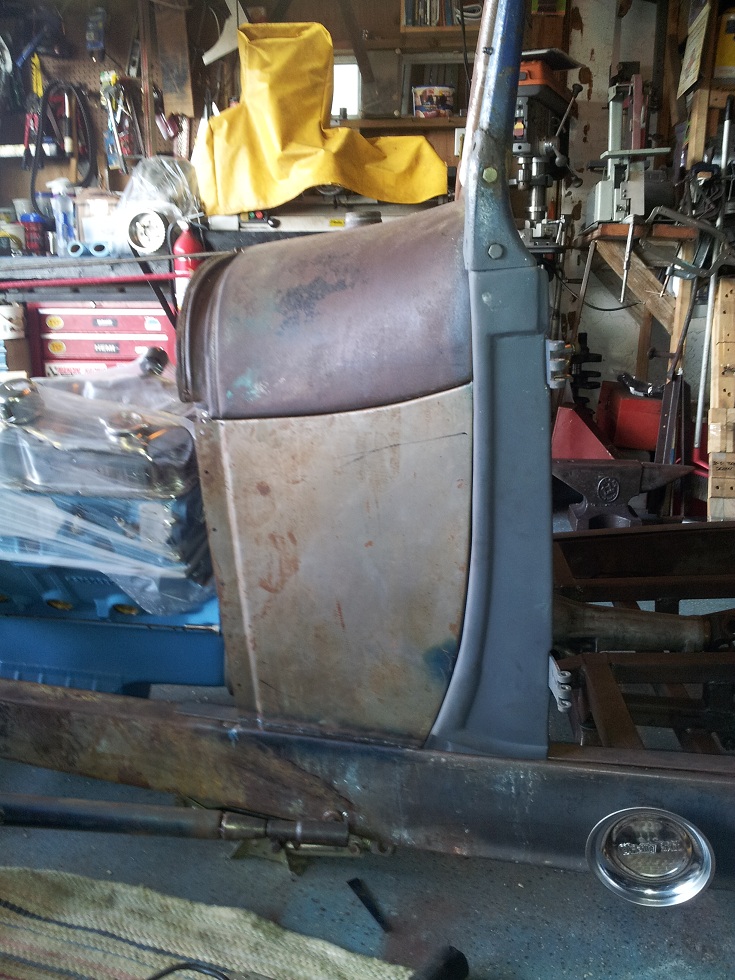

    Got the cowl section aligned / bolted down.
    And the rear wheel wells cut out...It's gonna need some surgery outside the patch panels...
    (don't know why i got those patch panels...? they're just flat with a fold and a hump)
    The dash follows the tank contour really nicely!

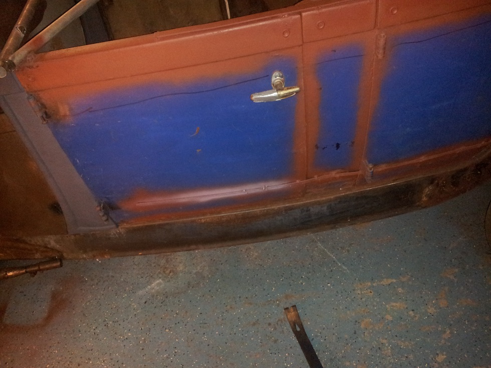

    Got both wheel wells hammered in to shape (top curve)
    Replaced some rotted metal where the two panels overlap.

    There still some (a bunch) rust areas...want to make the body "structurally sound" before i fix it,,,
