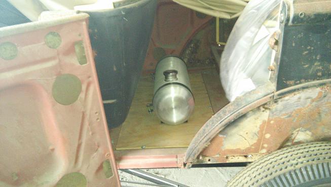

    Here's my buddy's 31 Phaeton with a Moon Tank.
    I will Probably mount mine right up against the seat pan, and put a 45 deg foot rest / plank over it.

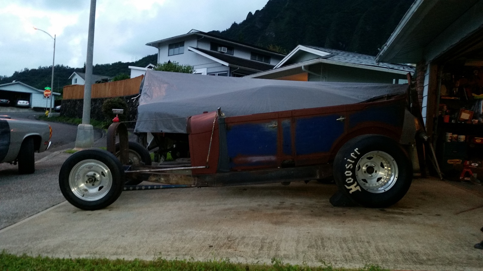

    Fixed a leak - drilled from inside through the body....and... (Old Dry slicks just on for size...i'm gonna go with wire wheels - i'll probably go 32 18" in the back and 16, 18 or skinny 19's in the front...?)
    Patches for firewall made out of $10/pair swap meet 30-31 cowl light brackets (according to the guy who sold them)...
    The other side of the bracket will be used on the inside as floor support.
    Haven't seen any on-line.
    If they're rare...then they're even more rare now!
    NEXT - Weld / patch holes in the firewall, bolt it in so i can take the tank out and gut it. bend and weld in a cowl support hoop.
    The Tie rod will have to go through the bone.& cross steer is not an option anymore.

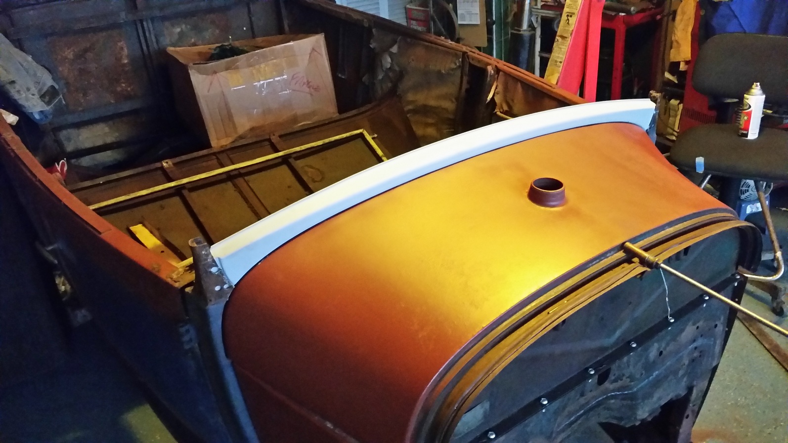

    Stripped the paint off the firewall B4 TIG.
    Cut out the Gas Tank...Next make Cowl / sterring support hoops!

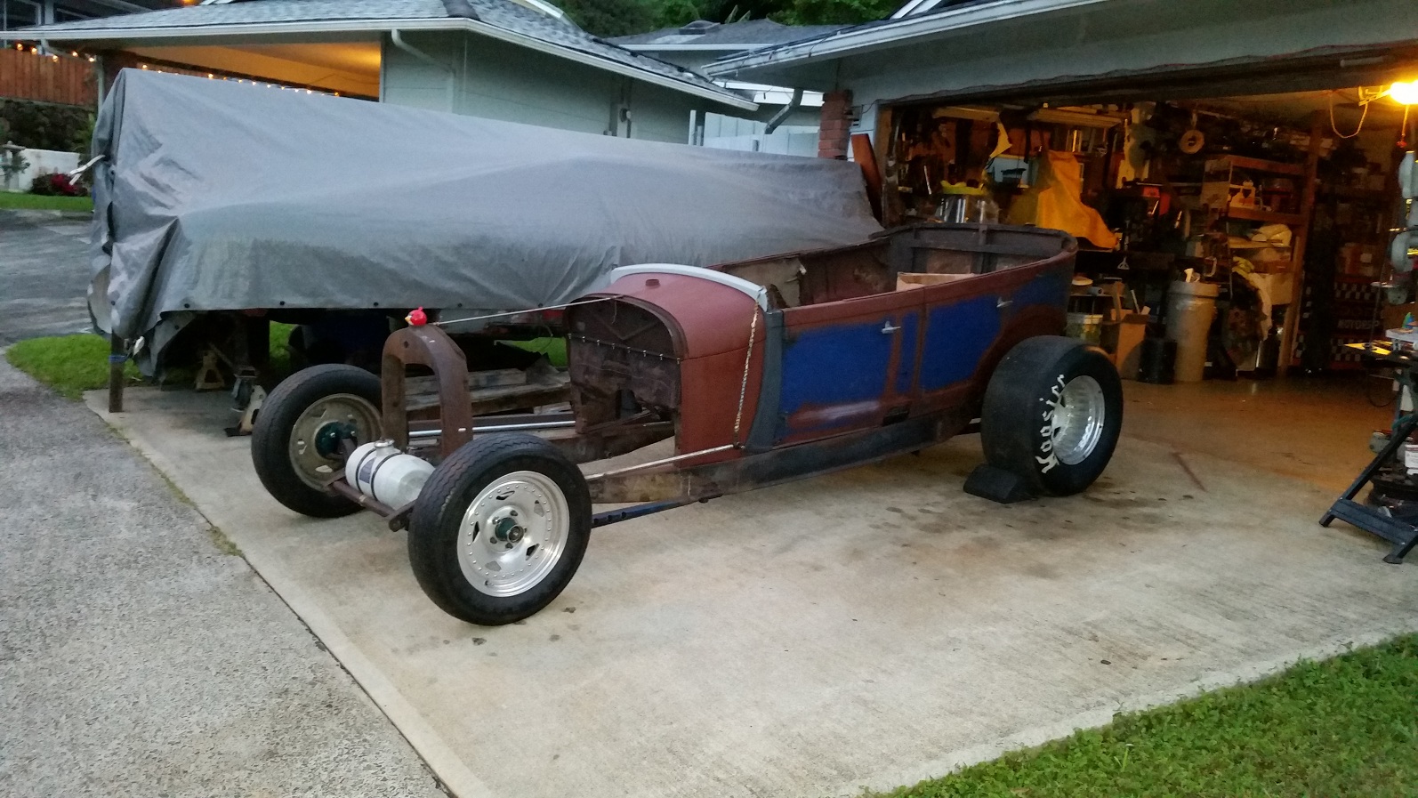

    Found another Rod with a Similar Stance....That I'm going for....Perfect for A Tub.
    Schweeeet Ride....Any Info?
    Front's coming down s'more with engine in.
    Now I just need to find a Mopar 66 - 76 Manual Aluminum Steering box!?

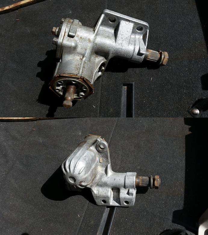

    Mopar Steering:
    Put a wanted ad on Craigslist yesterday morning...
    Got a call from one of the guys in the Old MoparsHawaii Club same day!...Me Happy Happy!
