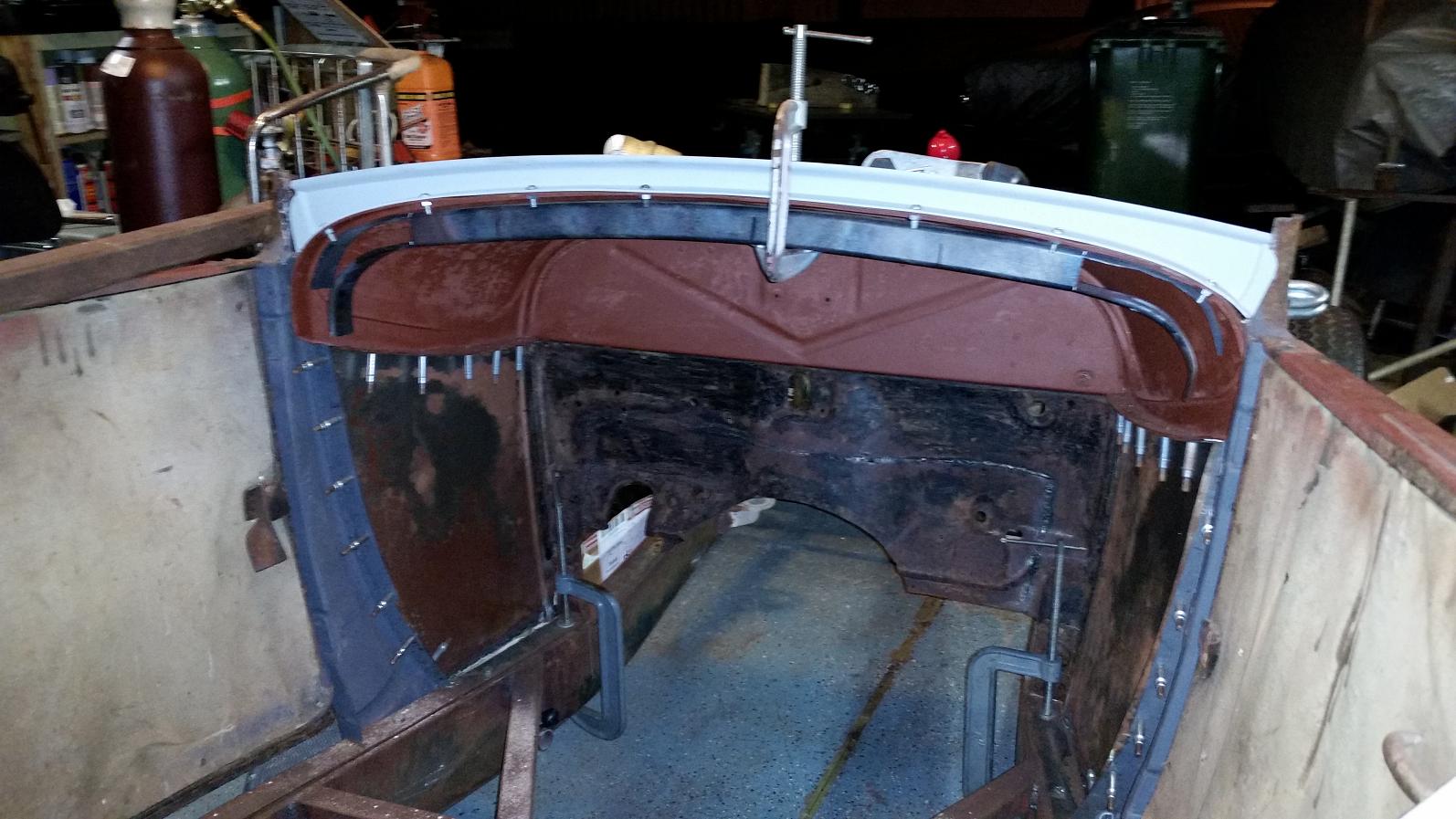

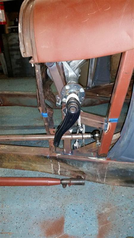

    Got all the panels aligned and Cleeko'd...Enlarge the holes for bolts later....could have welded the panels together but it's got to be able to take 'em apart later.
    Tacked the spring hangers better...cut the bolts off..was hitting the steering arms.
    Adjusted the tie rod holes in the bones (The longer the steering arms the more they move up and down when steering.) ~ 1/2 inch
    Loosen the steering arm, to be able to get the tie rod end off, unscrew one tie rod end, pull out tie rod, grind off material...Reverse procedure to see if the tie rod touches the bone...REPEAT ABOUT 10-15 times.
    Made sleeves to TIG weld in later...
    R - fitting..Not cut yet!
    L - Cut to length...Now I just have to find the holes i cut in the bones to cover the back.

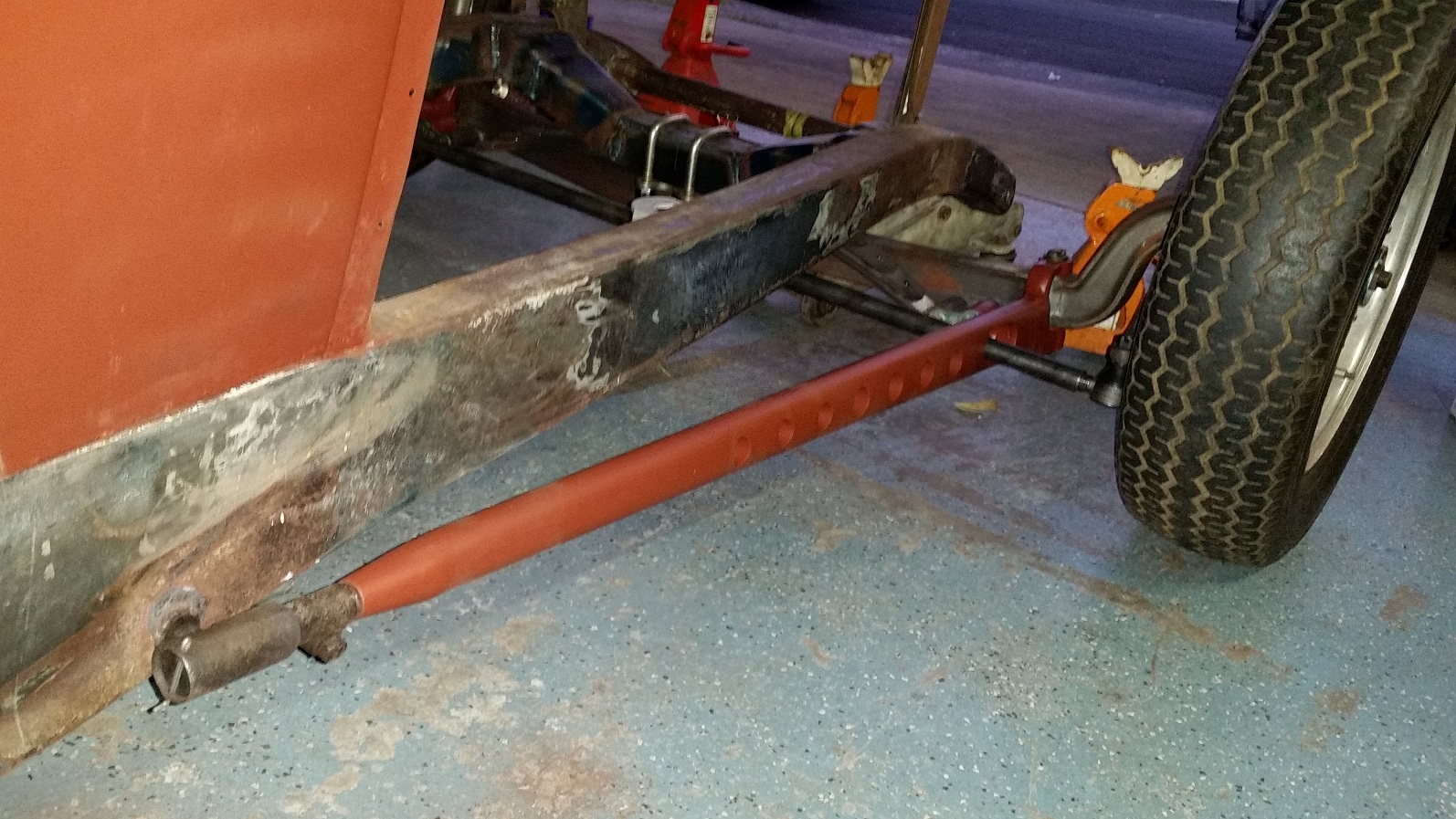

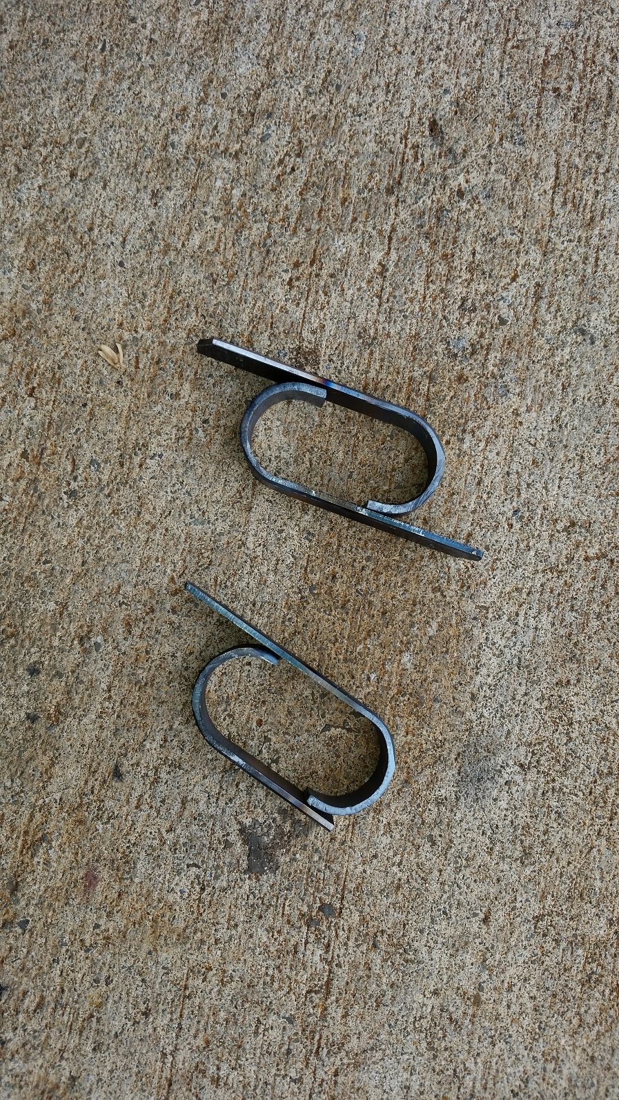

    Thin Wall Chrome Molly in the small holes...That's what my "Neighbor" had in stock...!..wasn't as bad to weld as I thought.
    Paint? Just to keep it from rusting.
    Looks thin on top...? It's Solid!...& There's hardly any weight on it...
    Look at a hairpin setup.
    (May or may not weld on a peace on top...we'll see?)
