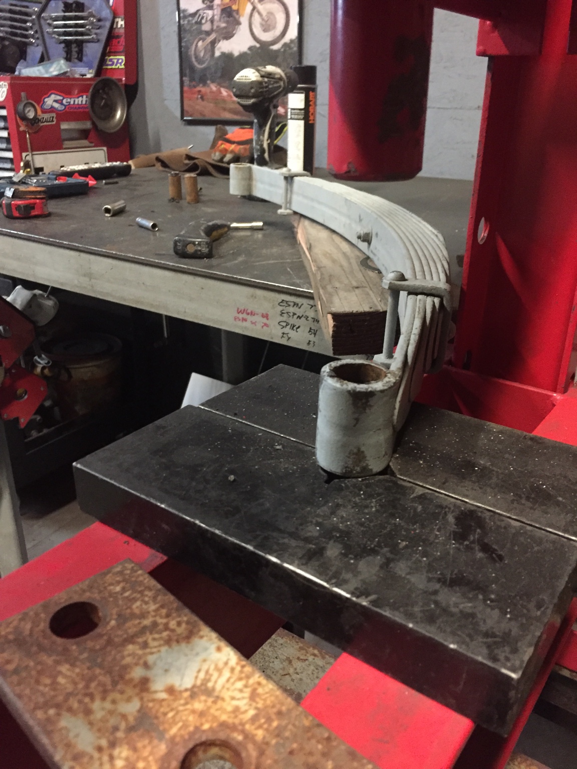

Got some garage time as a Christmas gift for myself today. The kiddos left around noon to head to their moms. I finally got the old bushings pressed out of the front spring perches and spring. Separated the spring and reversed the eyes. I removed two leafs but may reinstall just to get things together and make adjustments after I get it on the ground. Next is to order new bushings to get my front end put together. Whipped up a stand with some random things for my drill press too while I had some time. Sent from my iPhone using The H.A.M.B. mobile app
Thanks Ron, i was told it was an old Mordrop that someone had plated at one point. Cleaned up good though. So glad to have finally got those damn bushings out. Ordered what I needed today to get the shackles in and keep moving forward. Sent from my iPad using The H.A.M.B. mobile app
It's hard to get the new ones IN, too! I made a tool to fit them and hardened it so I could wail on it. They sell the tool at some shops. Looks great! Sent from my iPad using The H.A.M.B. mobile app
Oh man ... I can't wait. I'll be figuring something out as soon as they show up. Thank you !! Sent from my iPhone using The H.A.M.B. mobile app

Spent a little bit of time in the garage over the weekend. Decided on running the 40 Ford rear axle. I broke it down to get ready for a rebuild. Found out by the numbers it's a 39 with 3:78 gears. (VERY HAPPY ABOUT THAT) not 4:11. Removed the rear step for the A axle and fabbed up a new rear step with 2X3X1/8 wall box tube for the 40 axle added the A rear crossmember, then reversed the eyes on the A spring. After I box the frame with I'll fish plate the step and it should be good to go. I had to walk away after 2 hours of running this thing in and out of the press. I always hope to get more done each day but I feel I made some good progress even though I went back a few steps with the rear. Sent from my iPhone using The H.A.M.B. mobile app
I have over 2 hours into it now. I started by removing the arch that starts 9" from the center bolt on either side to the ends. Then started working on the 16" center arch I'm now working on the end arches again. I'm sure I'll have another hour to go. It's getting there. Sent from my iPhone using The H.A.M.B. mobile app
