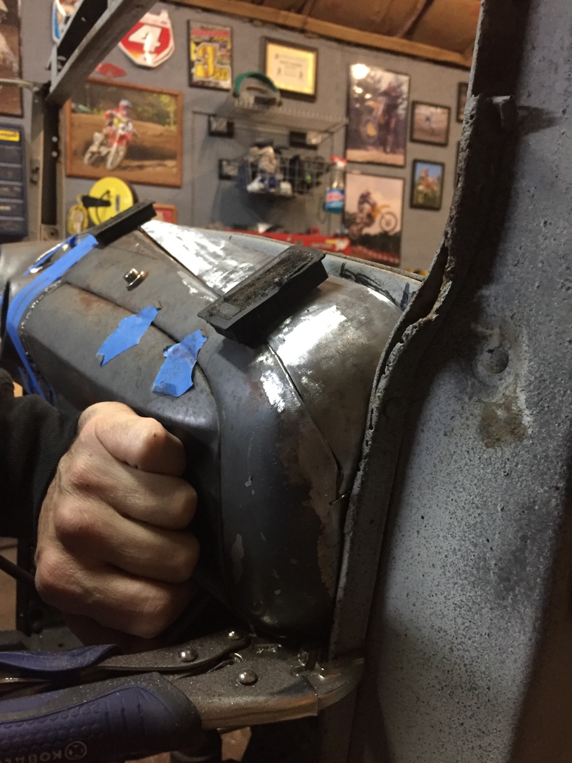

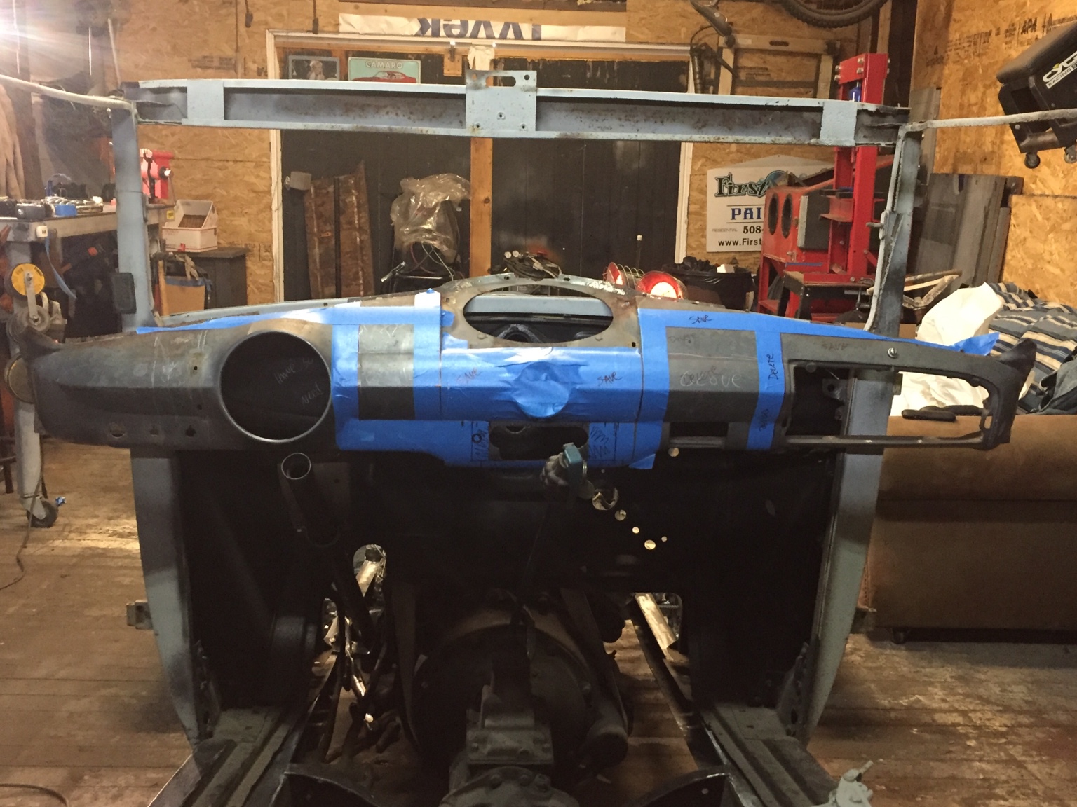

    This is where I stopped for the night. Needs some fillers at the A pillars and a flange across the front to mount it to the cowl. I was able to retain the original mounts on the lower portion of the dash and they tuck in perfectly. I just need to fabricate some mounting tabs on the cowl so I can use them.
    Wasn't sure which way to go with the ash tray and radio section of the dash.
    [​IMG][​IMG]
    The lower dash dropped down to allow for them but I wasn't sure I wanted to keep that look. The reason being was it was offset from the clock and looked unbalanced.
    I ended up deleting it and using the metal from the deleted portion of the dash where I moved the glovebox to. Took some time because there's a lot going on there ...[​IMG]
    I tried so hard to make sure I had equal measurements from the points of the ends of the dash detail. All the while making sure the clock remained centered.
    It took all afternoon but I'm really happy with my finished product so far.
    [​IMG] this is the first time I've ever tackled any type of sheet metal work
    9hrs later.

    Time well spent. It's the details like this that will make it YOUR car. I don't think I've seen a dash like that before in a hot rod ( which doesn't mean too much!), but I think it looks PISSAH!
    If you haven't already, don't forget to beef it up for your column drop, and for added strength in general.
    Lookin' good, Pardner.

    There is a support that runs the inside length of the dash on the underside of it. I was planning on running a piece of flat stock inside it (it's a shallow channel) to add some integrity back to it. The mounts for the column drop are still there also so hopefully I can retain those as well.

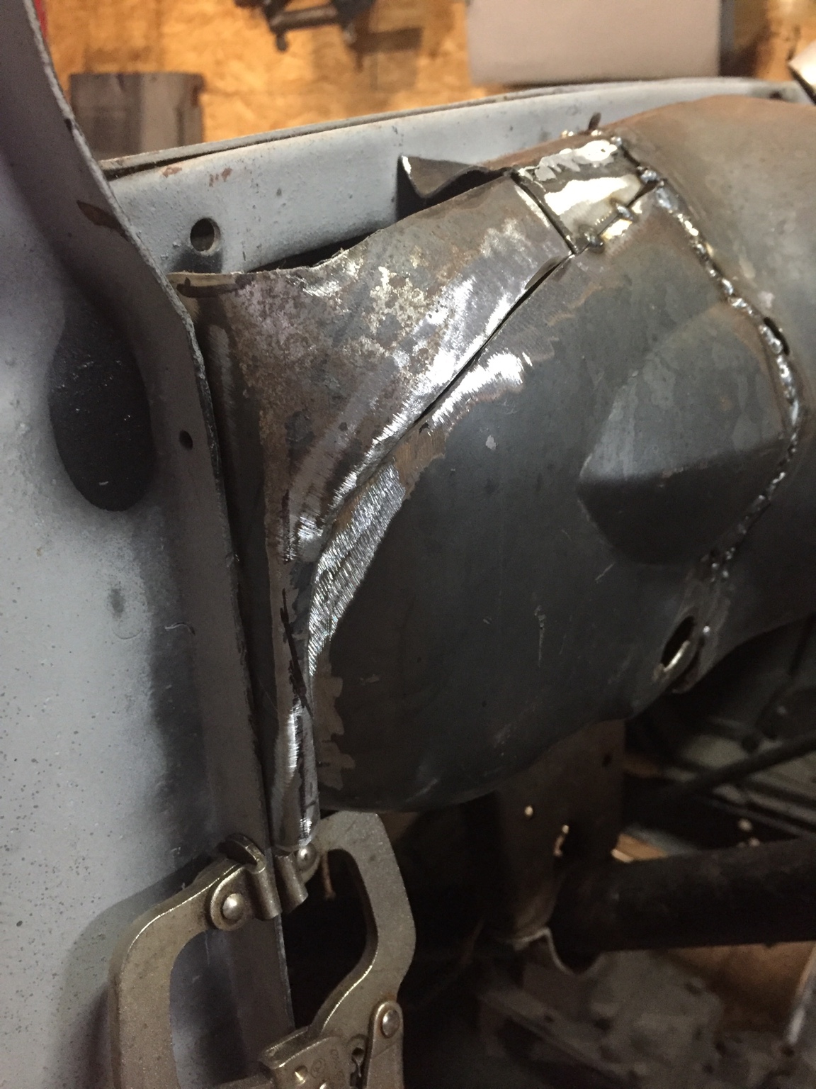

    Spent some time filling in the ends of the dash yesterday.
    I don't have any fancy tools. Just a few hammers and a piece of railroad track.
    They get the job done...
    Got the drivers side "done" and kinda ran out of pieces left from sectioning the dash. So I'm saving the passenger side for another day.

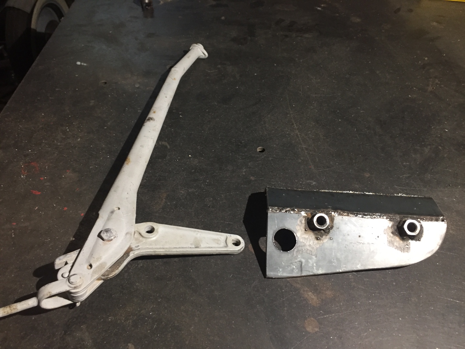

    Worked on the mount for the handbrake after that. I looked around and figured mounting off the transmission would be the best way to go.
    This is what I came up with.
    [​IMG][​IMG][​IMG][​IMG][​IMG][​IMG]

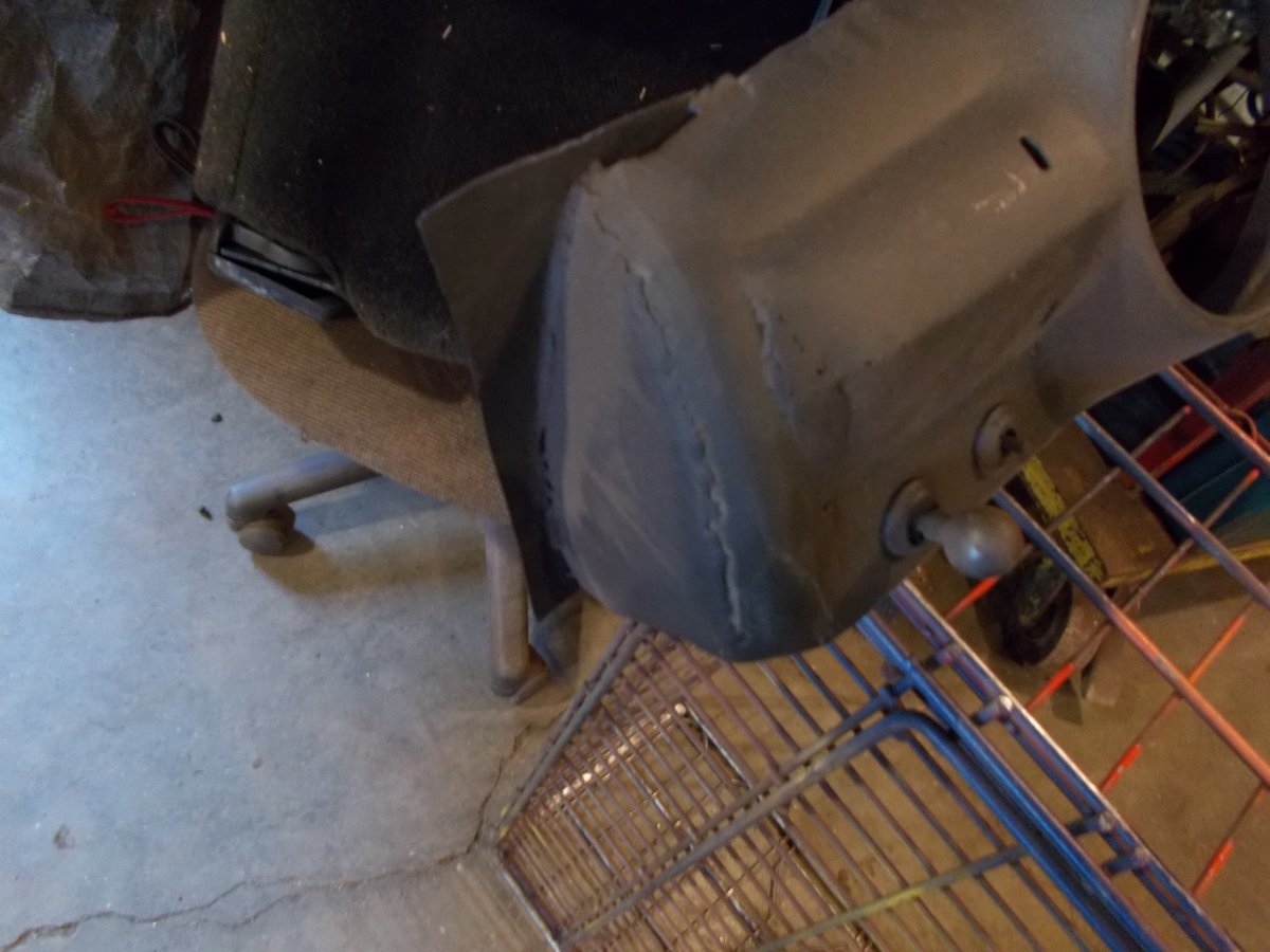

    Nice job Mike! they take a lot of thought and welding and finish work, ask me how I know! Here is a pic of the one I did................great minds often run in the same circles....:D:D
    I am putting everything except the ign key in the glove box. made a metal glove box to mount the gm fuse panel, light switch and charger port.

  28. vtwhead
    Joined: Oct 20, 2008
    Posts: 5,296
    vtwhead
    Mike thanks for the compliment. Never did one before, was a little bit of a challenge. Now I am thinking of finding a small tach to insert in the clock opening. I should have cut the bottom off mine for a smoother look. Like yours, the way it flows.

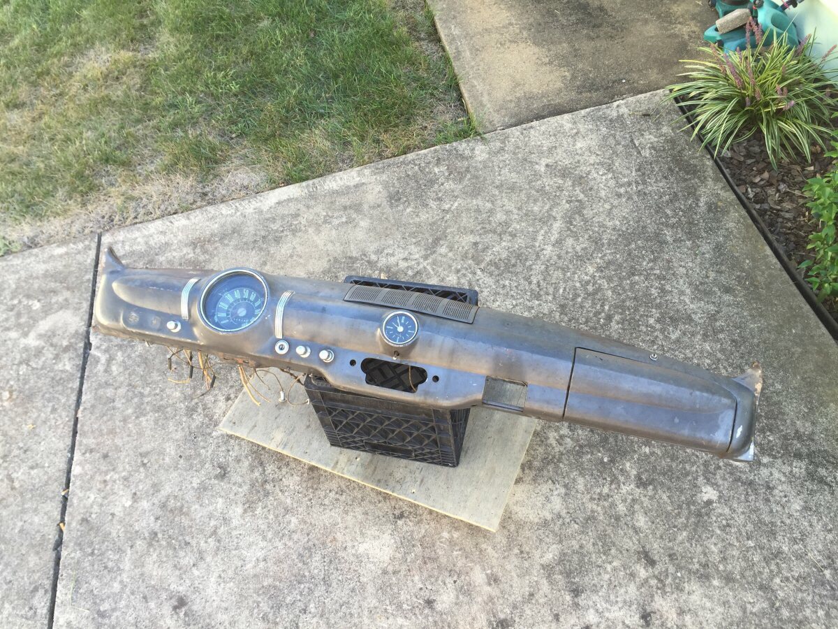

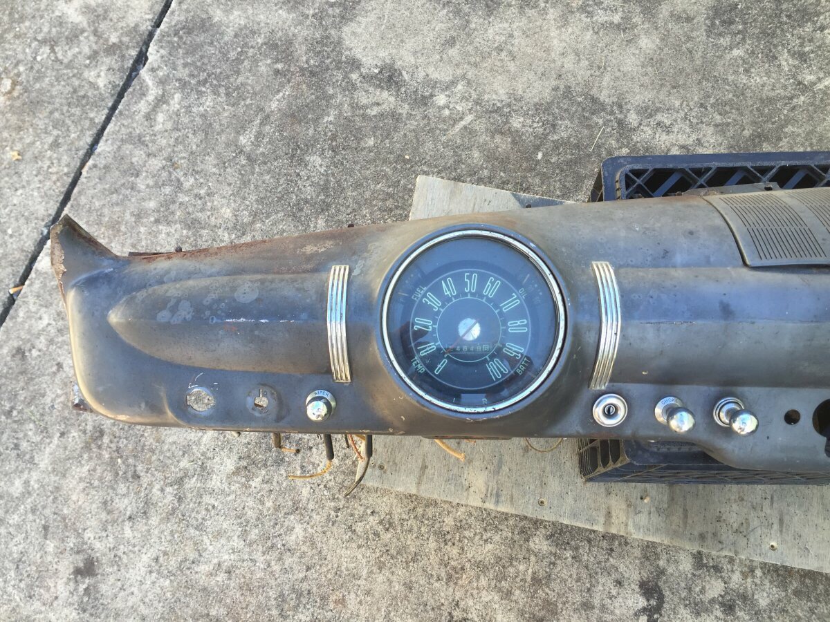

  29. sloppy jalopies
    Joined: Jun 29, 2015
    Posts: 5,256
    sloppy jalopies
    dig it, looks factory, keep those how-to's coming "buck n' a half"...
    .... vtw... great finished dash...
    i bought a crashed $25.00 '50 dash...driver's side crushed...
    but i trimmed mine so the speedo ended up too close to the w/s... dash kinda points upward more than i liked...
    now hanging on a nail in the garage...
    ... FREE as a PICK UP ONLY if you can use it...

    I think what you have there is "Garage art"
    I'd put a clock in the speedo hole and call it a day.
    I don't have clue where my final seat position will be so I'm hoping I didn't remove more than necessary from the leading edge of my dash.
    I feel confident it will be okay
