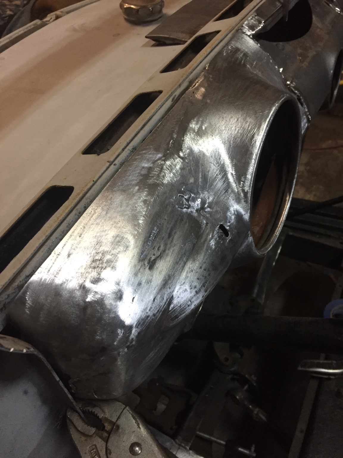

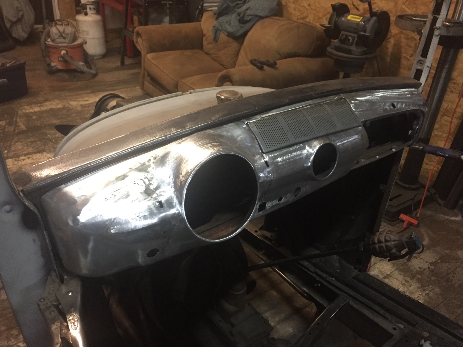

    After I added the filler to the passenger side of the dash yesterday, I wasn't really pleased with my first attempt at "metal work" on the drivers side. So I cut it out and rebuilt it.
    I wanted it to look similar to the passenger side...much happier with the way it looks now. Don't think I'll be cutting it apart again.
    It flows much better with the curve of the dash.

    Nice work Mike. Lots of grinding but in the end it will look sharp.

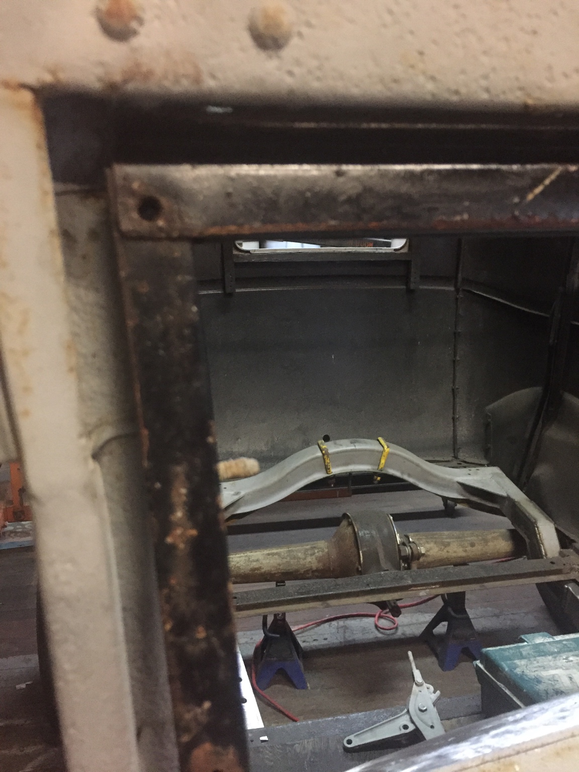

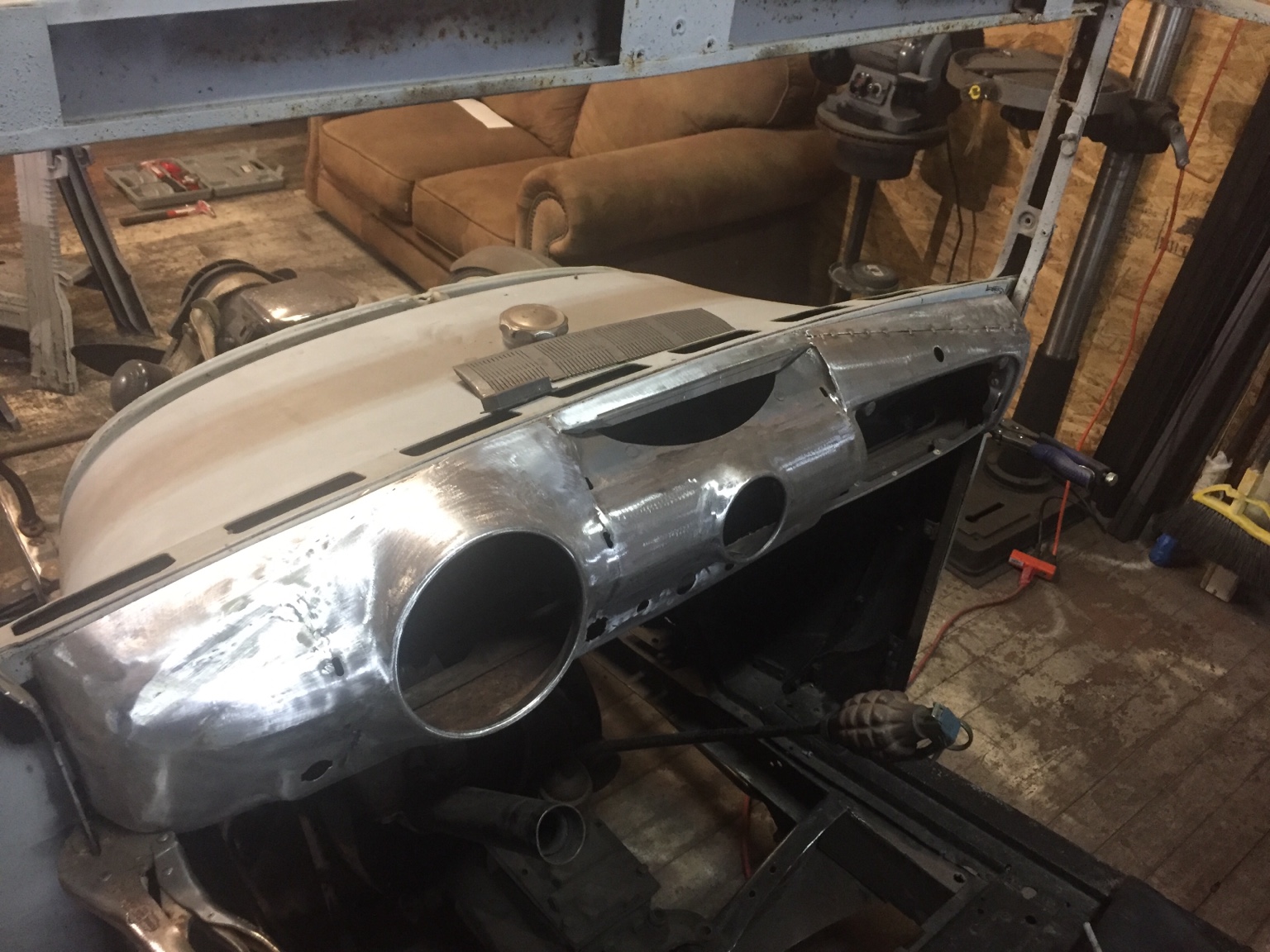

    Spent a little bit of time Saturday evening working on the dash. Welding everything up.... epoxy primer/sealer and metal to metal is on its way in the next few days. Like to get it sealed up soon. [​IMG][​IMG]
    Question for y'all
    What goes here ? [​IMG]
    Or should I ask this ... Is this the correct windshield for my sedan ?
    None of the mounting holes fit the windshield header.
    Thought if I centered it on the middle hole in the header I'd get some to fit.
    Nope. Not one, not even the center hole. It's off an 1".
    The frame measures 44" on the top and 42-3/4" on the bottom.
    Any help is appreciated

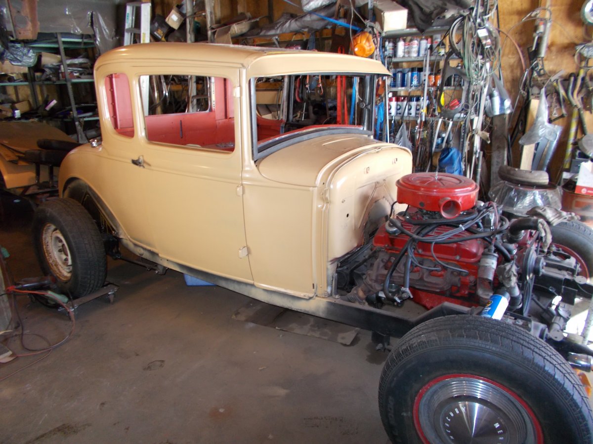

    I'm only familiar with '30/31 windshield frames- they have mitered corners, and 2 small screws on both sides at the top to take the header piece and hinge off to replace or install glass.
    I wouldn't think they'd change as much from the one you pictured but who knows? ( ya, ya the Phantom, I get ya)
    '28/29 - #1 My friend Ricks
    '30/31 #2 ( what a gorgeous car!!)
    I don't have a good shot of the '28/29 windshield, but maybe this will help. If not ,I'll go sulk a while..................

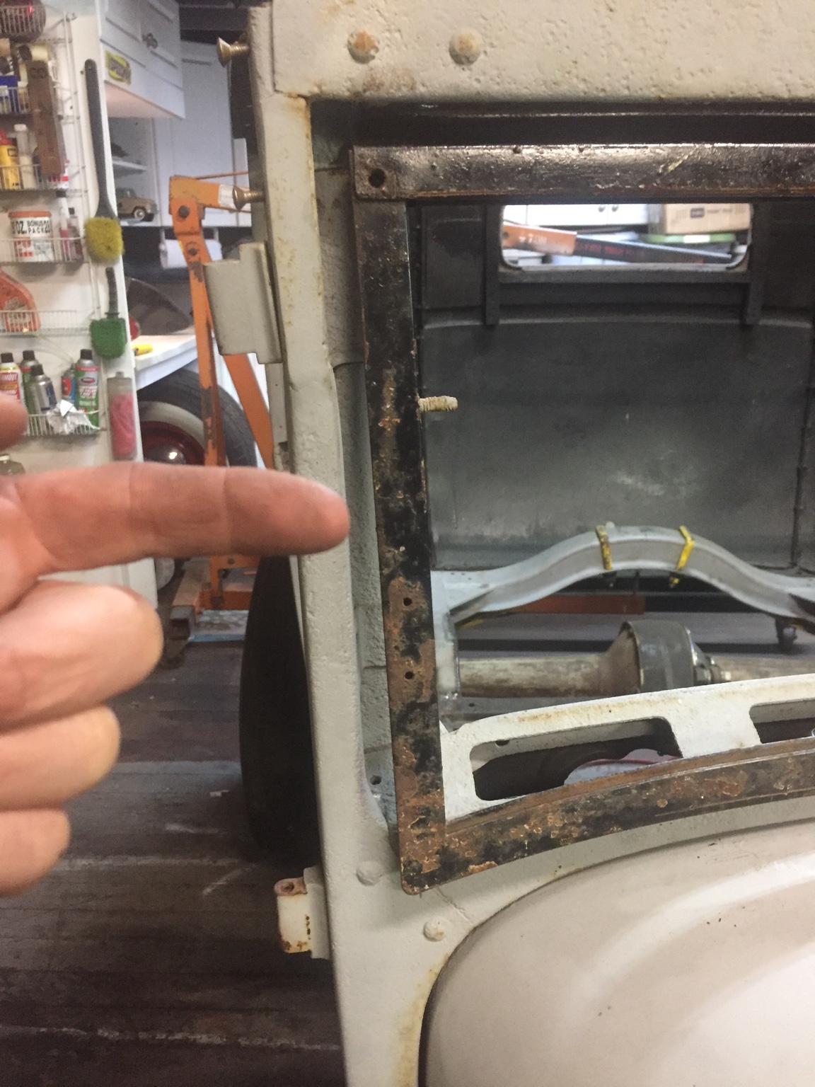

    You have eliminated the 30-31 frame. It's not that. No mitered corners. More just 90's the vertical pieces slide into with the brass bolts holding it together. I'll post up some better pictures.

    Mike on the picture of Ricks 28/29 there's weatherstripping. I can see that, so that would help me close up some of the gap. There's nothing on the actual w/s frame ? Like a garnish molding or anything ?the measurement on my frame doesn't match anything online I've found.
    On that "gorgeous car" you have there is (chrome trim) over the w/s frame or is that the actual frame ?

    No one raised their hand in class and said I was missing the Dash Rail ...
    [emoji53]
    That looks a little better.
