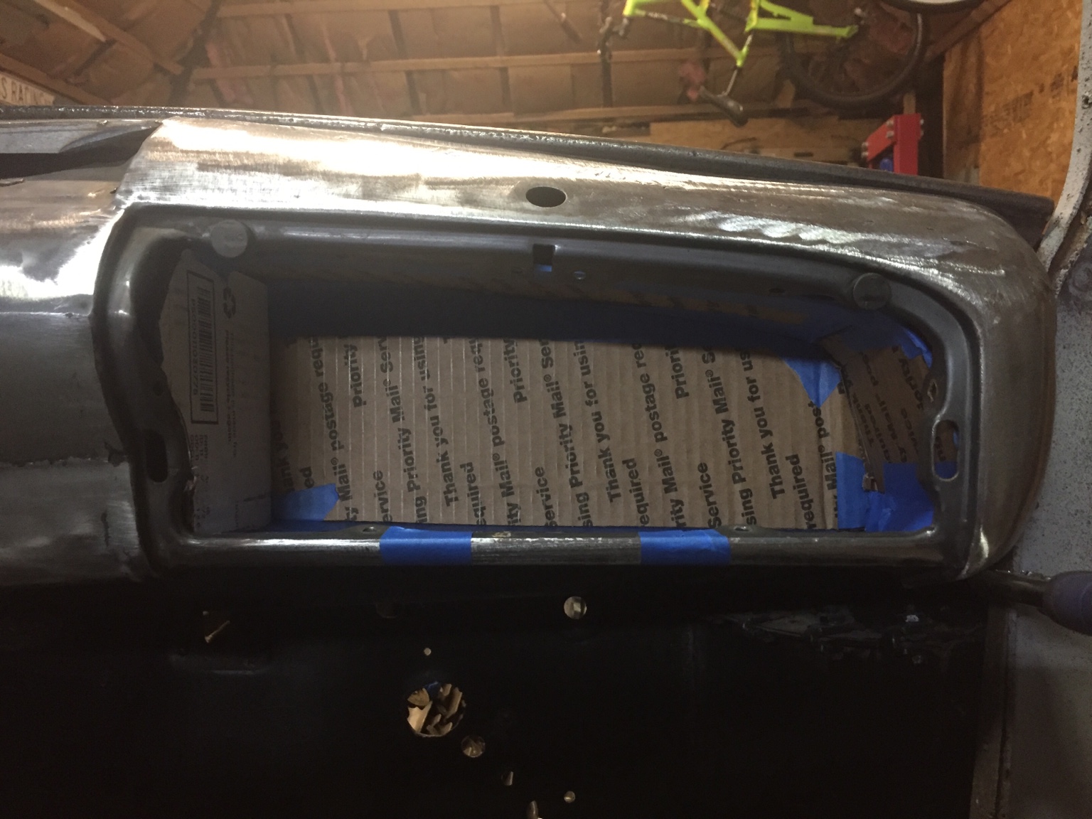

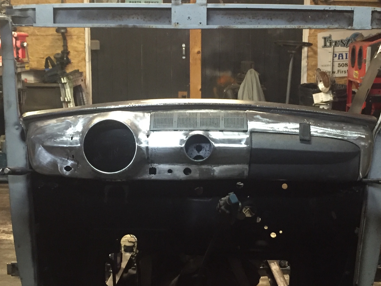

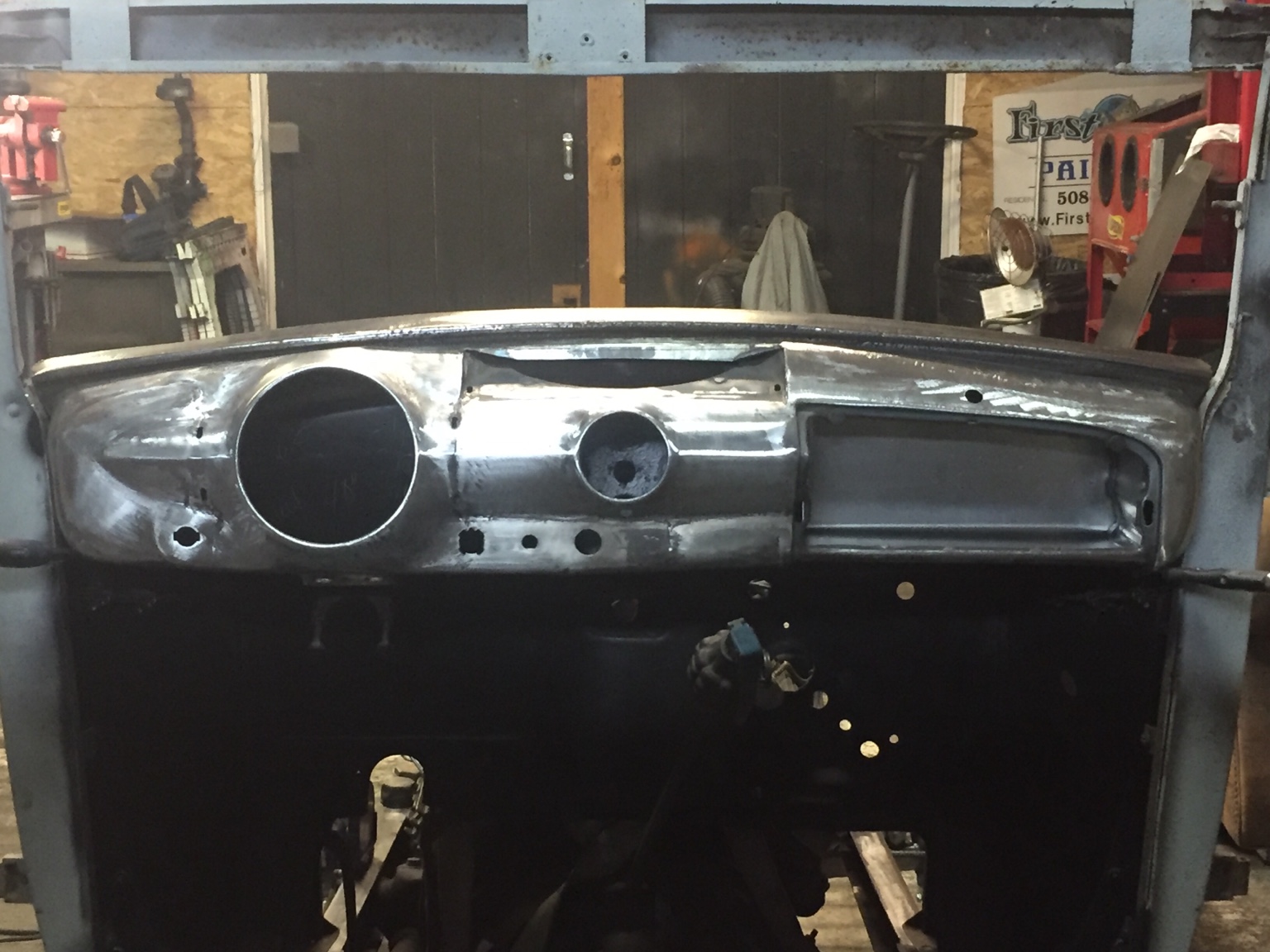

    Took better part of the afternoon but I got the glove box built and installed into the dash. Used 20ga and mounted it with the original ford screws that came in the dash.
    [​IMG] USPS donated cardboard for the template
    [​IMG][​IMG]stopped at HF yesterday and picked this up. $35 with a coupon. Did the trick
    [​IMG] never used a break before. So much easier for sure. [​IMG]mounted in the dash
    [​IMG][​IMG][​IMG] [​IMG] I must have at least 40 hours into the dash. Just need to secure it to the dashrail and A pillars and it's good to skim coat and seal.

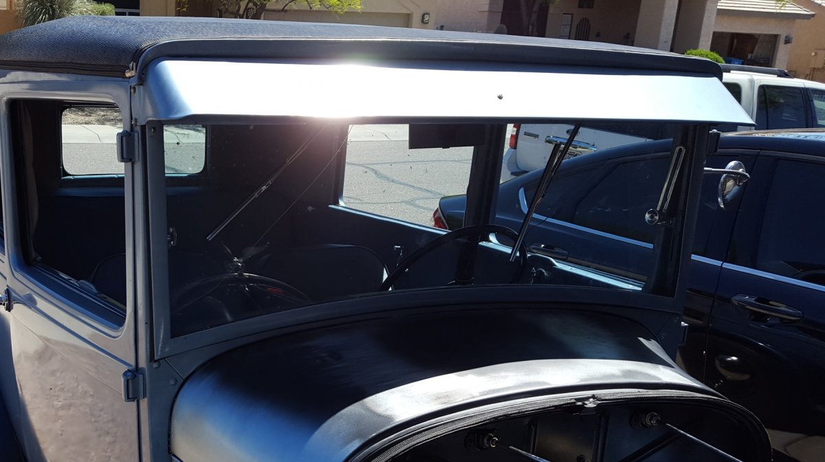

    Not sure if you ever got this answered. Here is a pic of my front window. 20170402_134556.jpg
    biggeorge and Mikel50 like this.
  12. mike bowling
    Joined: Jan 1, 2013
    Posts: 3,559
    mike bowling
    MITERD CORNERS!
    and the weatherstrip fits into a channel on the sides and bottom of the frame- it moves with the frame, and when you pull the windshield shut, hits the posts and across the little bottom filler piece. That's what gives you a "water tight" seal that leaks like hell if you're driving in the rain ( works great in the garage).You can see it sticking out about 1/4 inch in the above photo of the '28/29 coupe ( the one with the mitered cornered windshield) HaHa
