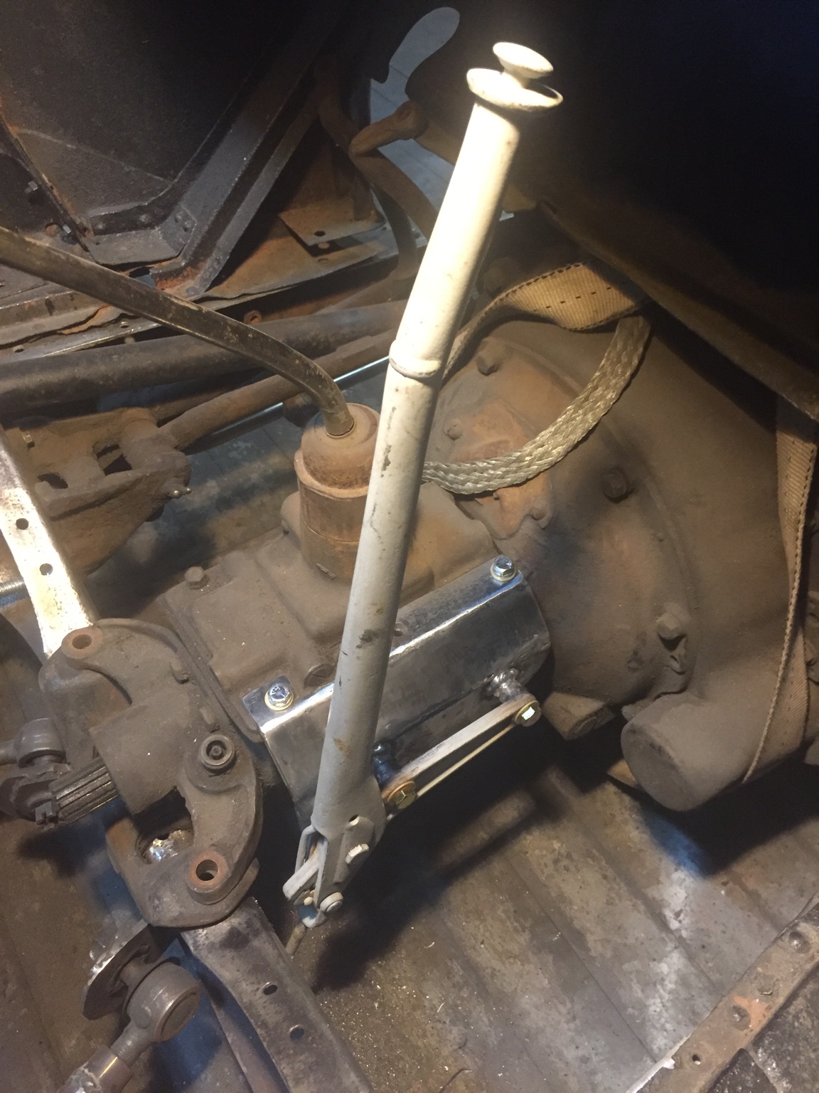

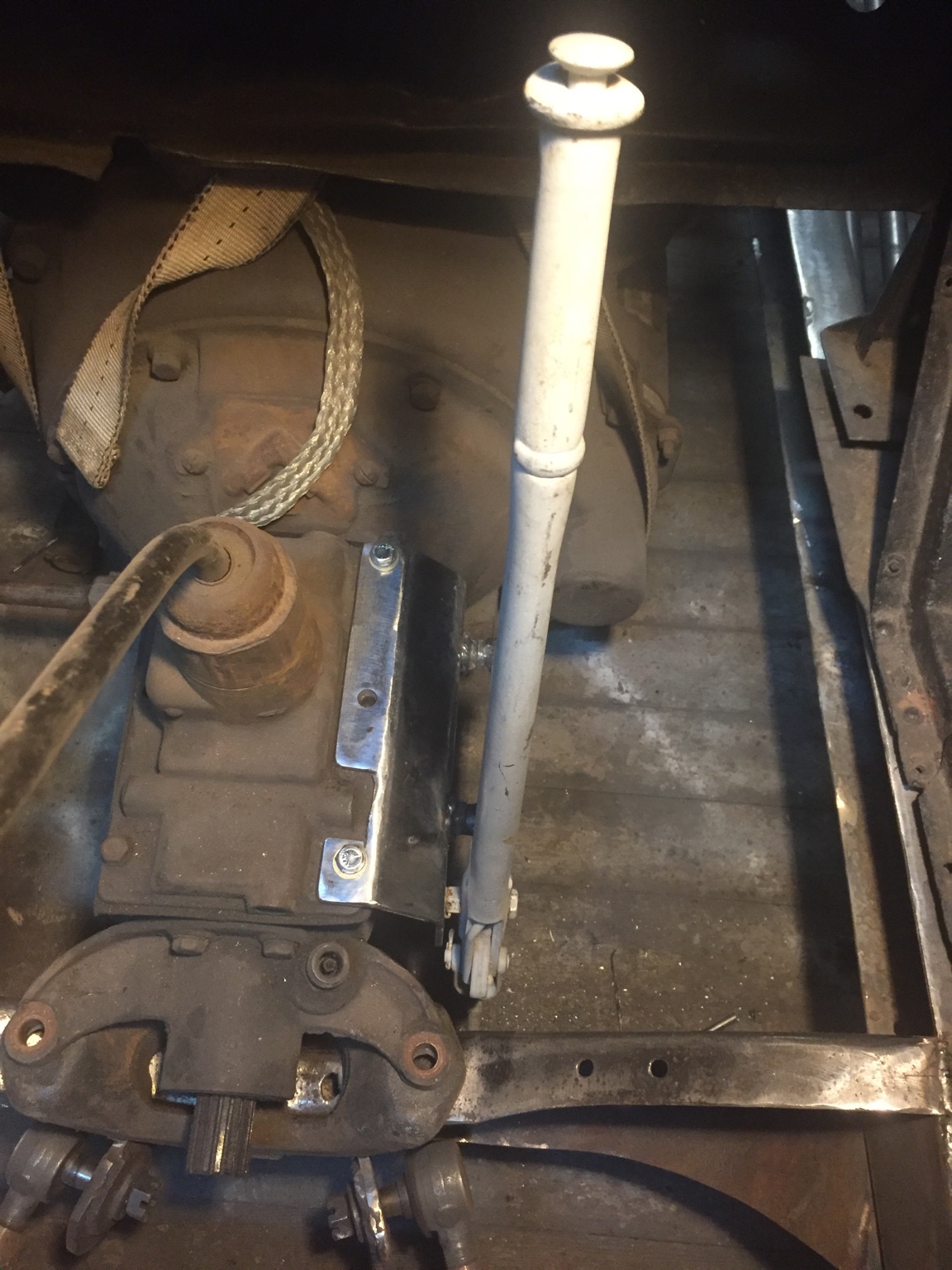

    Made my Hand brake mounting bracket a few months ago but never got it mounted. Had to add some spacers (nuts ground smooth) to the backside of the handle mount to get it off the mount I made. [​IMG] once I did that it fit great. Drilled a hole through the crossmember for the cable and bolted it on. Feels good to be picking things off the list once again.
    Thanks guys for all the talk on here over the weekend. I looked forward to getting back to it.

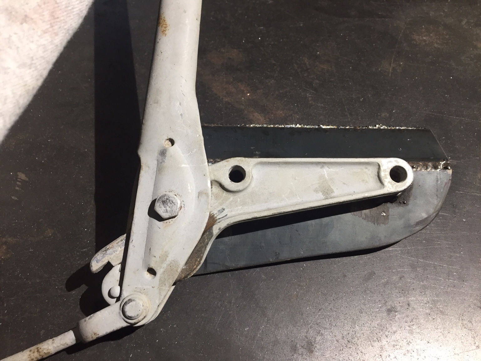

    Mikel50
    Hey Ron,
    Here's what I had in my phone. I had made it with nuts welded to the orig mount but it still wasn't quite far enough off for the handle to clear freely. I had added 3/8" thick spacers on the handle mount itself the other day to have the arm clear the mount I made.
    Hope this helps.
    [​IMG][​IMG][​IMG]

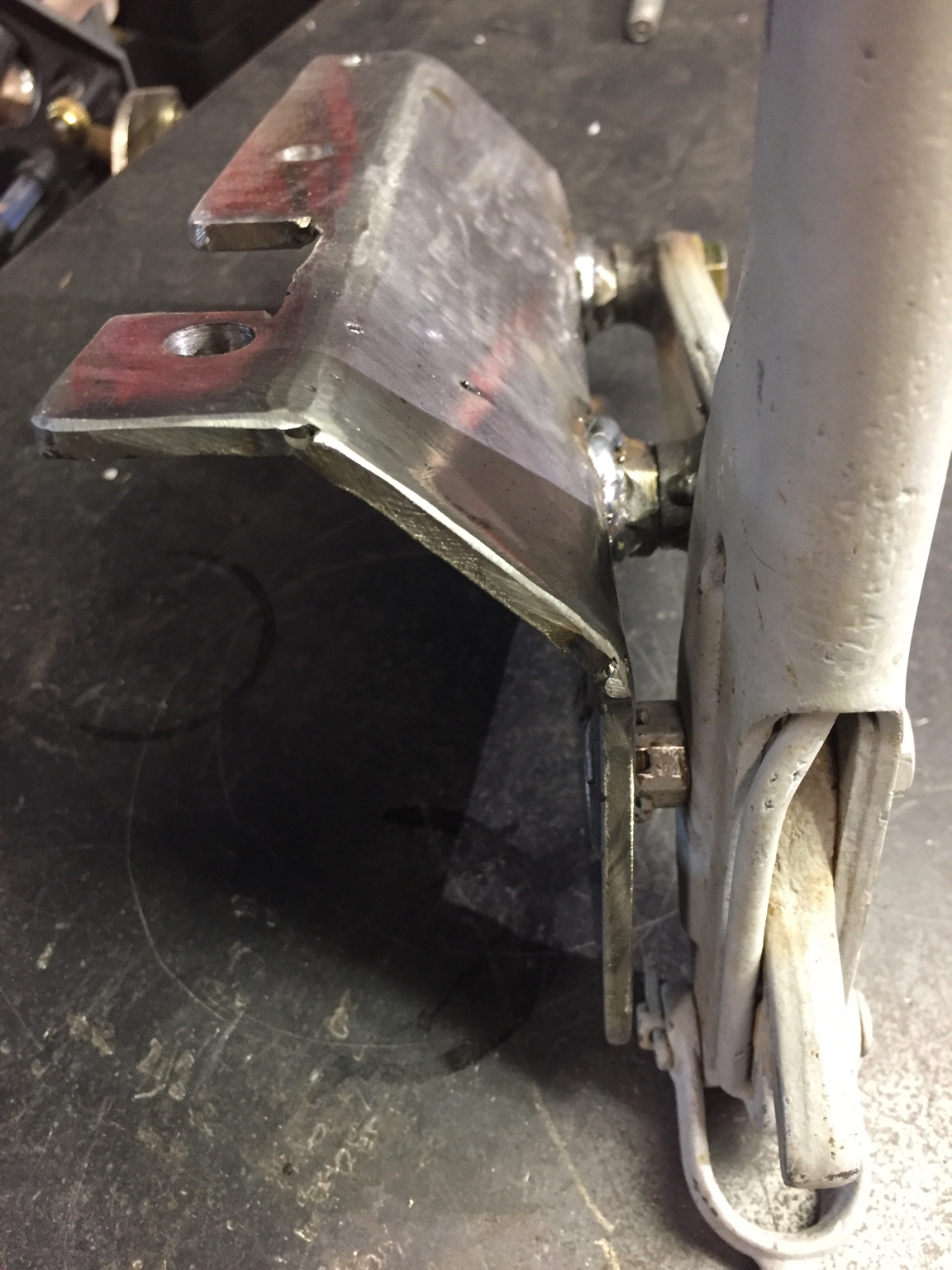

    [​IMG][​IMG][​IMG]
    You'll need 5/16-18X1-1/4" bolts for the mount to attach to the trans
    I used flat and lock washers with that length.
    Also going to need 3/8-16X2" bolts to mount the handbrake to the mount.
    Also enough room for flat and lock washers.
    There ya go bud.

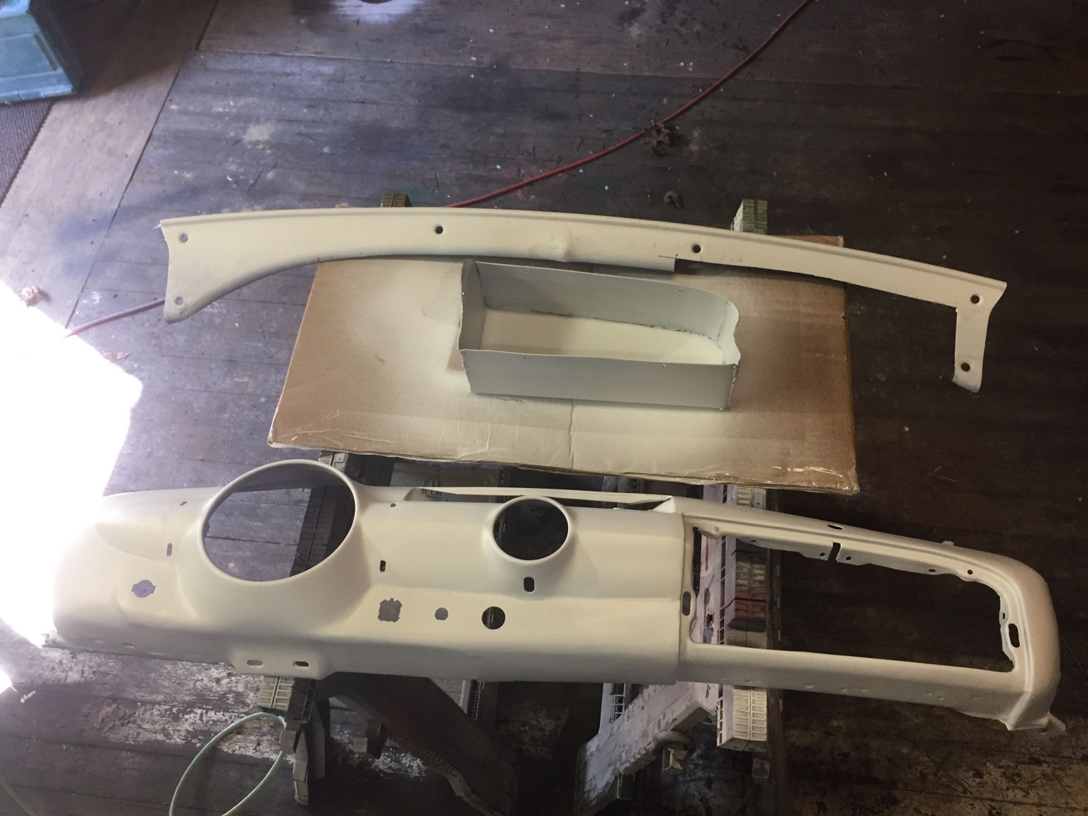

    Didn't have much time this weekend between kids and yard work so I got up early and got a few coats of epoxy on the dash parts. Hoping to have some time this week to get to work on my pedals and M/C.
    I pieced it together to see how it was going to look. [​IMG]

    I know I'm being picky, but you have your nuts on upside down on the 3/8's bolts on your hand brake bracket. Those little indentations on the nut you see, are there to lock in the lock washer, to allow the lock washer do it's job.
