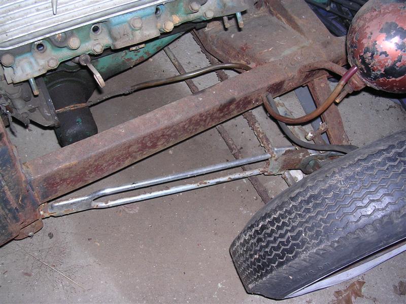

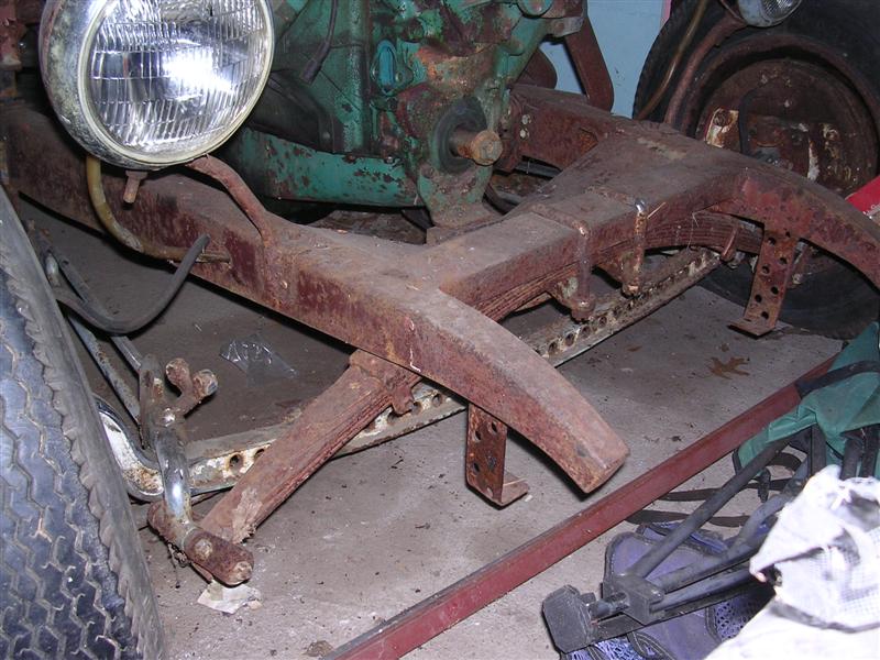

    Here is a 30 Chevy chop/channel roadster pickup built in 59/60 in the Boston area of M***...
    The kid worked in the navy shipyard and knew how to weld :) ...and knew where to get some steel. he,he He did a super nice job of boxing the front frame and front frame horns IMO.
    He used the 37-41 spring ahead to get it low, but it is very unusual to see a spring ahead with a "dropped axle", to get even lower.
    He left the original Chevy front crossmember, but used a piece of heavy wall channel for the spring mount, then used steel plates to blend the channel to the chevy crossmember.
    another unusual feature is that he made hairpins grafted to the 37/41 bone yokes. Can't recall ever seeing that before on old rods. Also running cross steer which is also unusual.

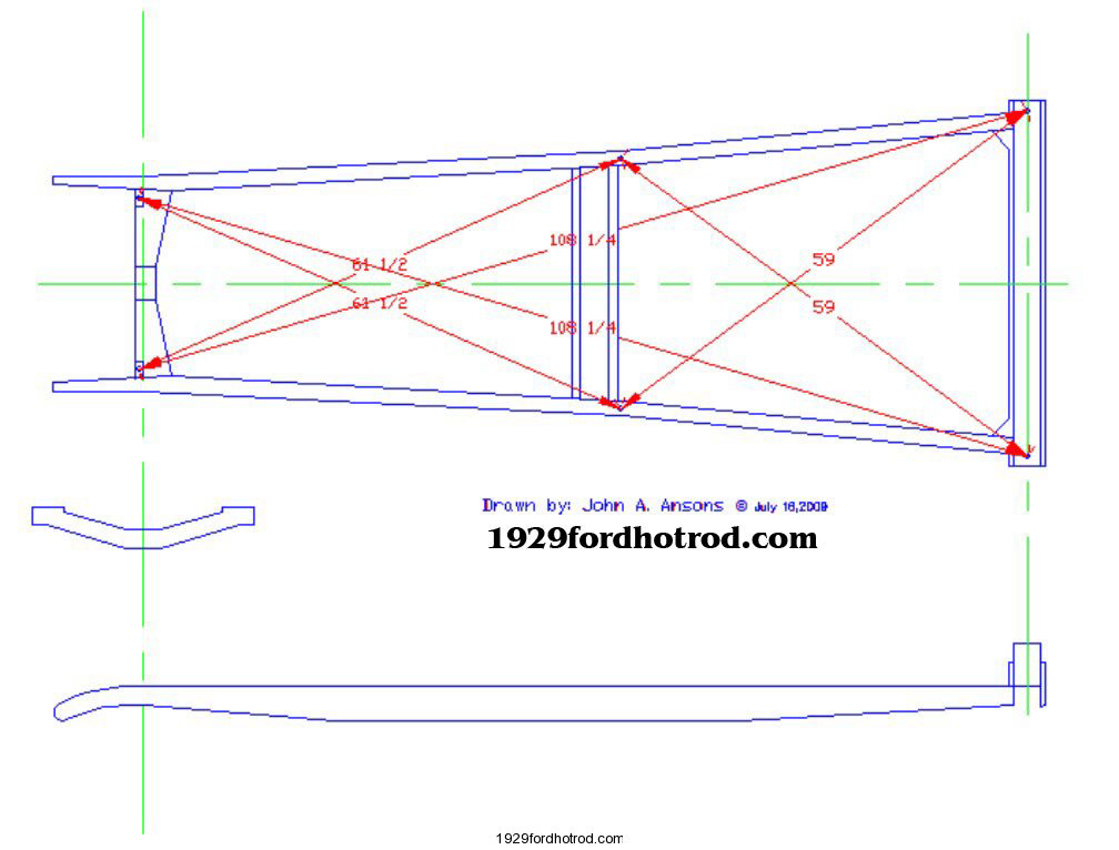

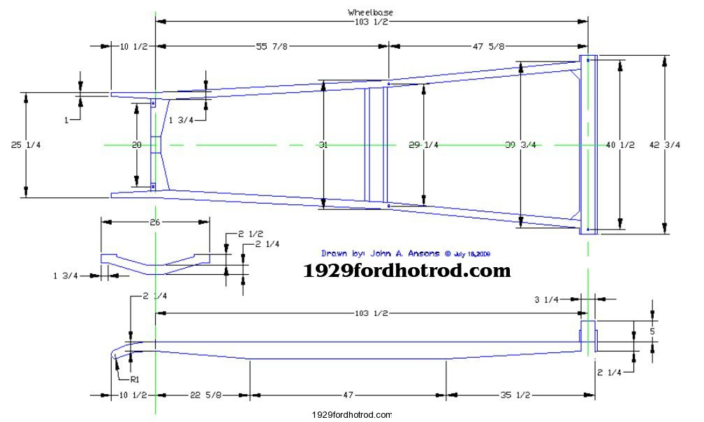

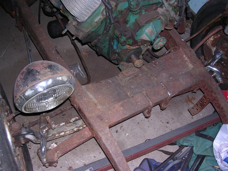

    I measured the frame yesterday and at the X member measuring across the top of the frame is 30"
    Measuring across the bottom of the frame at the X member at the same point it's 31.25"
    So the top of the frame rails are squeezed in.
    I think if I cut the welds at the outside ends of the two top plates that were added to the X member, I might get lucky and be able to spread the top of the rails back out to square and re weld when they're plumb.

    I think you scored an old Hot Rod frame. The welds are ugly because stick welds often are and that's what was likely used. Thy look OLD and if you don't see evidence of cracks, they're probably fine and have good penetration, so don't be afraid of them. I'd be inclined to leave most of it alone.
    What you should be measuring for is square. Have you taken diagonal measurements yet?
    Don't go cutting until you have a solid and complete plan. Measure twice. Read the Tardel book entirely before you get into making changes. That frame was probably run exactly how it is at some point.
    That said, as interesting as that late crossmember up front is, You might be better off adding box tube like @F&J is showing you or a T-Bucket type perch off the stock crossmember if you're keeping the spring ahead you've already got (which I would). The alternative would be to get different perch pins and go spring-over (I wouldn't).

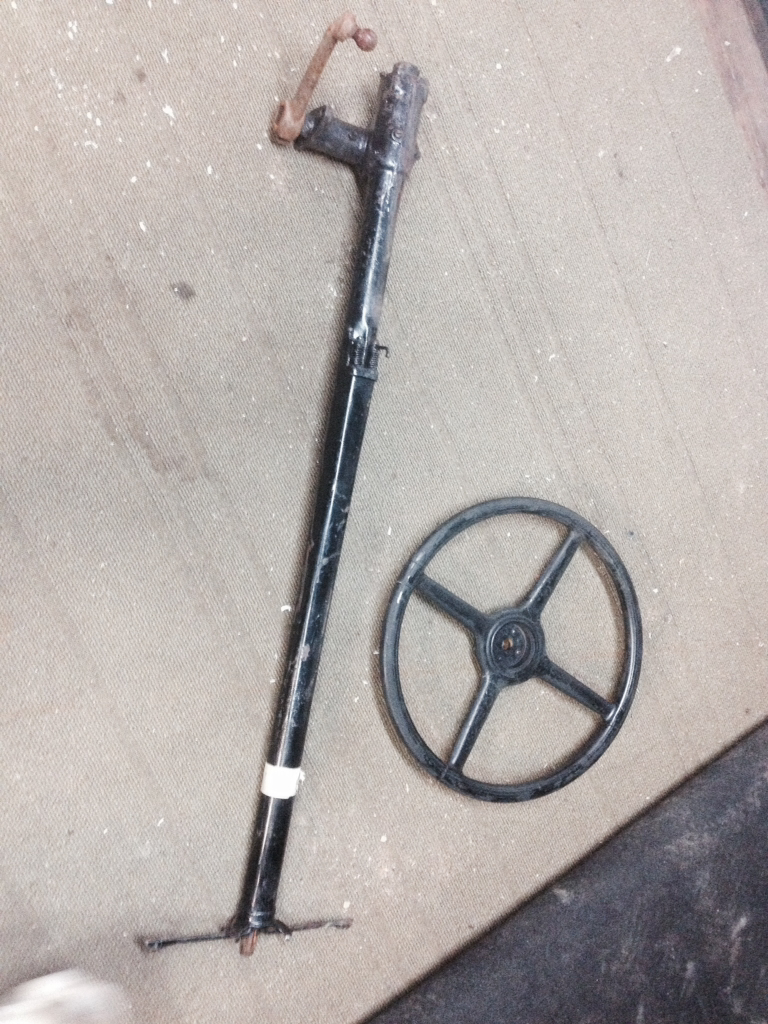

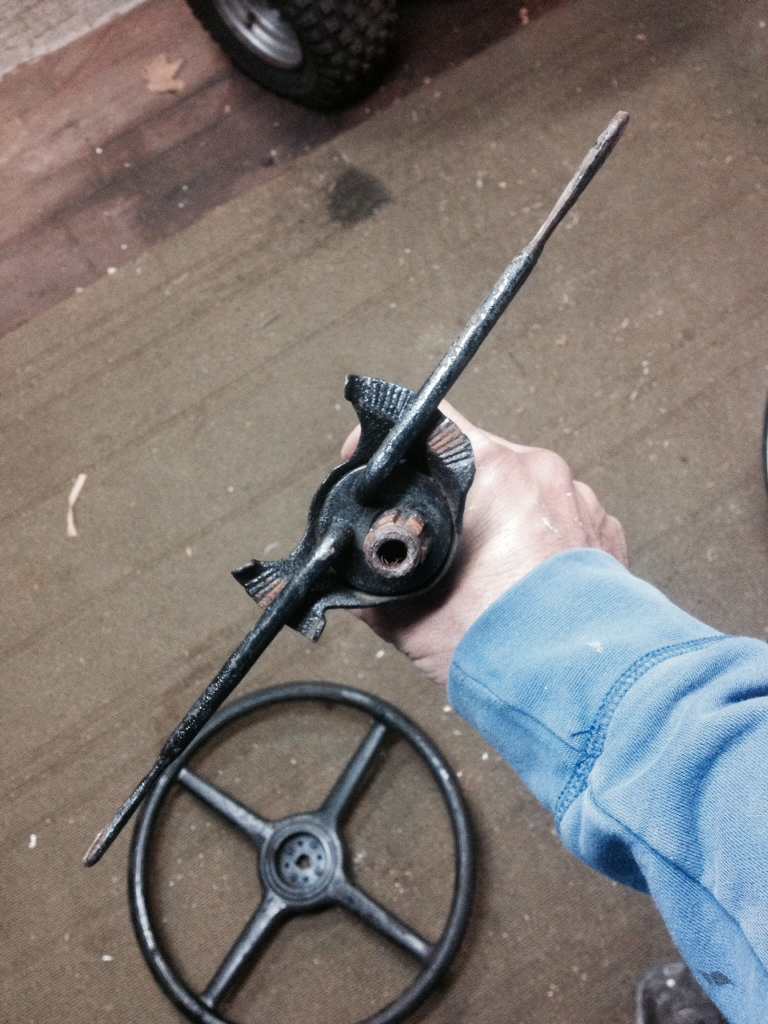

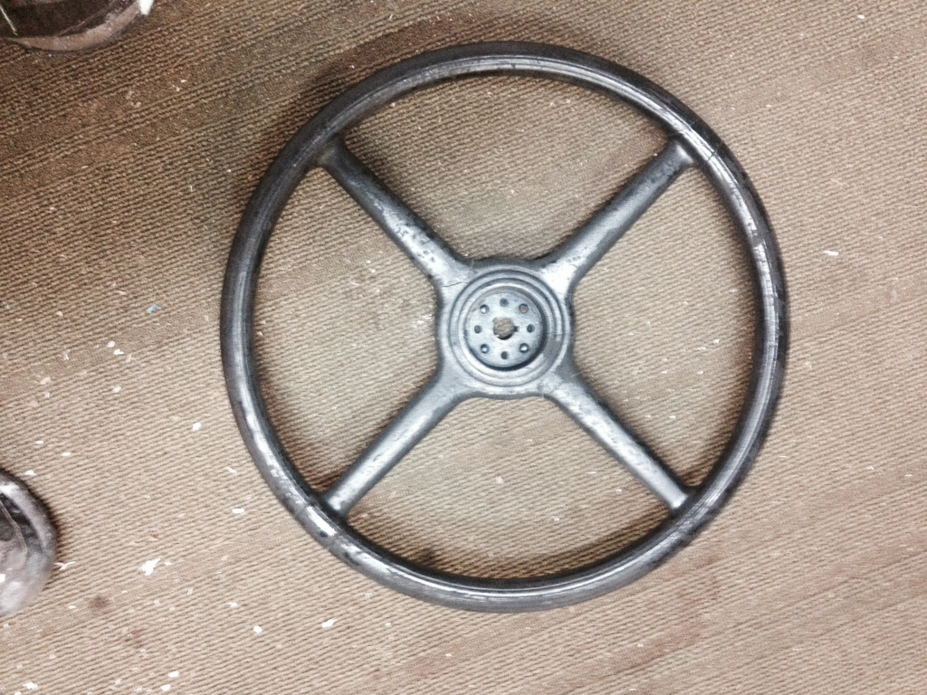

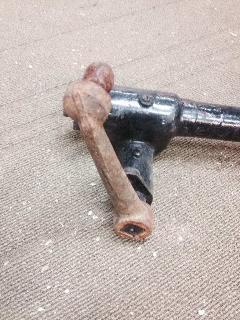

    Here are a few pics of the column and wheel.
    It appears it's a 17" 4 spoke wheel but it's a two keyed shaft and the column has a spline on it so clearly they're not of the same make or model.
    I'd like to run wheel so it looks as if I'm going to be looking for a column if I can't mate the two.

    If you will use the original front crossmember for the spring, then you can't use the later wide front spring that you have now. Go back to post 46 for info on springs..and note that you will have to have your axle dropped.
    The column looks like stock Model A to me

    Don't get too carried away removing stuff just yet. Every time you remove something, re-measure the frame to check if it's still square; that matters more to the car than how it looks!
    Show us some updated pictures of the frame and tell us what the measurements you took were. What's "not perfect" mean in this case? Are you coming up 1/16" off or a half?
    I think you're down near @general gow territory down that way.
    How many springs or how few? You're getting into the territory of redesigning your front suspension entirely now. If you keep the spring you've got, it has to be in front like it is (too long to go over the axle). If you put the spring in the stock xmember, you move your axle back behind the crossmember which means you gotta move the wishbone mounts back too. You also then have to make sure your axle stays clear of the engine under peak load. This will shorten the wheelbase and push the nose out beyond the centerline of the wheels, which was a look presented by some East Coast rods, but there's a lot of mixed opinions on the look and it can be tougher to get your proportions just right IMO.
    To keep the wheelbase intact, you will need a new, shorter, spring, perches, possibly wishbones, and maybe even be better off with a different axle. If you want to run it with what you've got, I strongly recommend just doing @F&J showed you. Otherwise you've got a lot of parts and work ahead of you instead of just a piece of box tube.

    So my confusion towards the front crossmember is this.
    I posted up pics originally and a few people said ditch the added crossmember and use the orig one.
    I completely understand now that you've broken it down for me.
    I do want to keep the spring ahead but was under the ***umption I could just move it back to the orig crossmember.
    Thank you for explaining it to me.
    I guess it really doesn't make much sense to remove it and replace it with square tube if ultimately I'm going to end up with the same thing.
    If prefer to retain the crossmember as it is, due to the fact it's how they built it back in the day.
    It was simply due to a few guys saying ditch it I thought I could.
    Thanks for reposting the pic because I didn't see the square tube crossmember the first time.
    I honestly didn't know what I was looking for, now I do.
