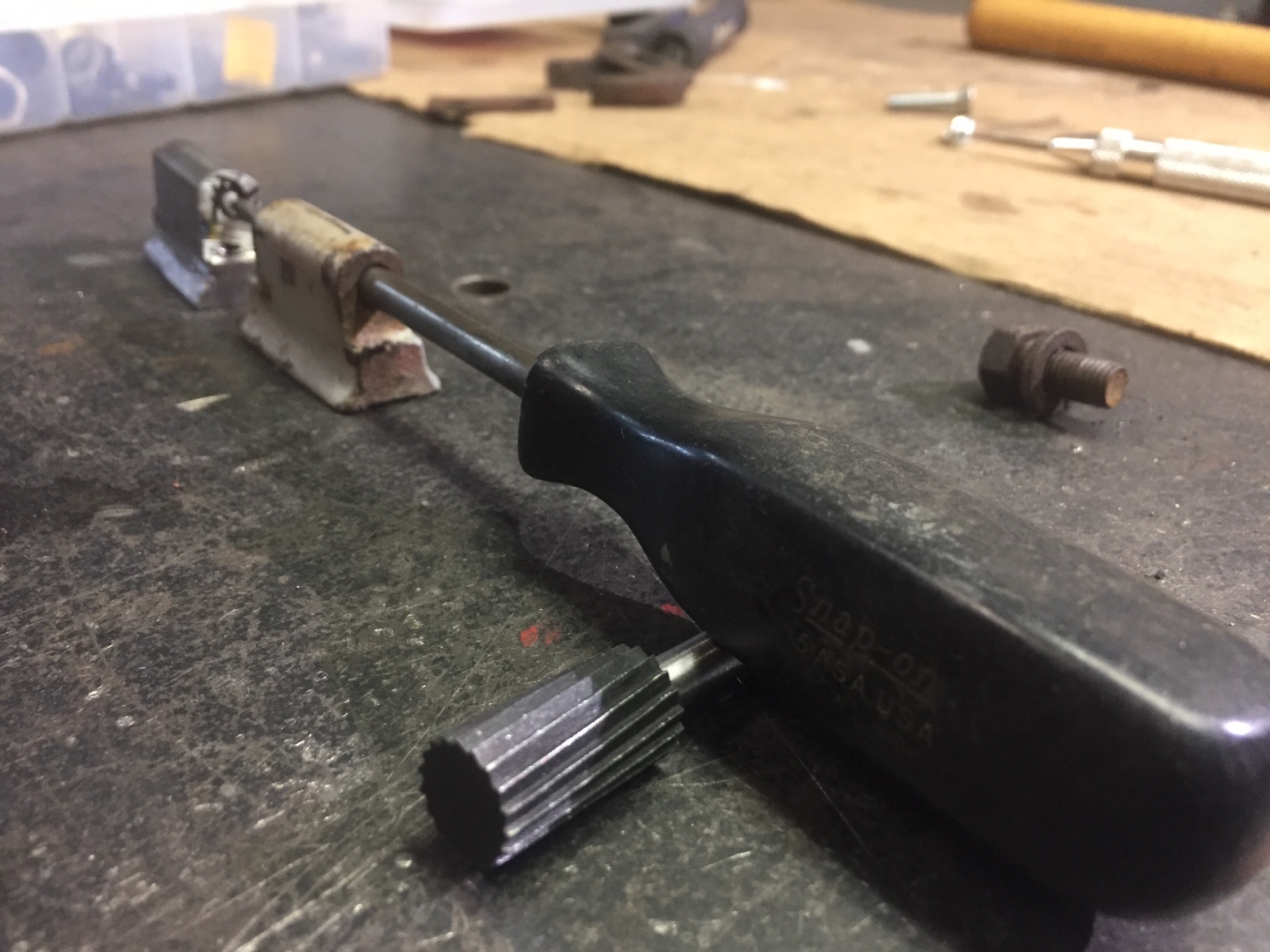

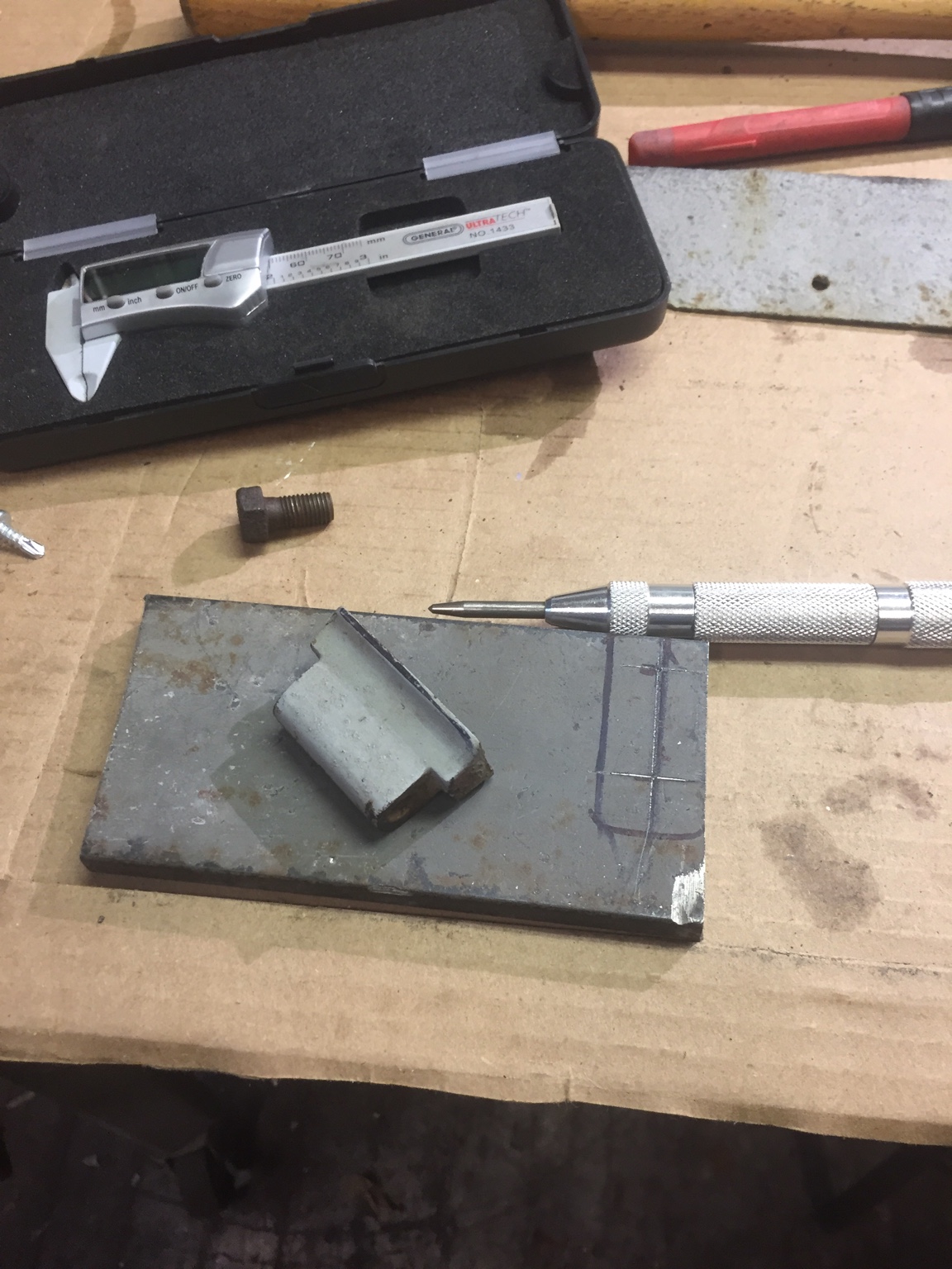

    I found a hinge ...well kinda. I decided to try to make one.
    So now I have 5 Henry hinges and 1 Mike hinge
    [​IMG][​IMG][​IMG][​IMG][​IMG]
    Had to fill a few small spots on the weld seam but broke my sanding belt on my finger sander.
    So I need to find the spare I have to finish sand it.
    But it should finish up good.

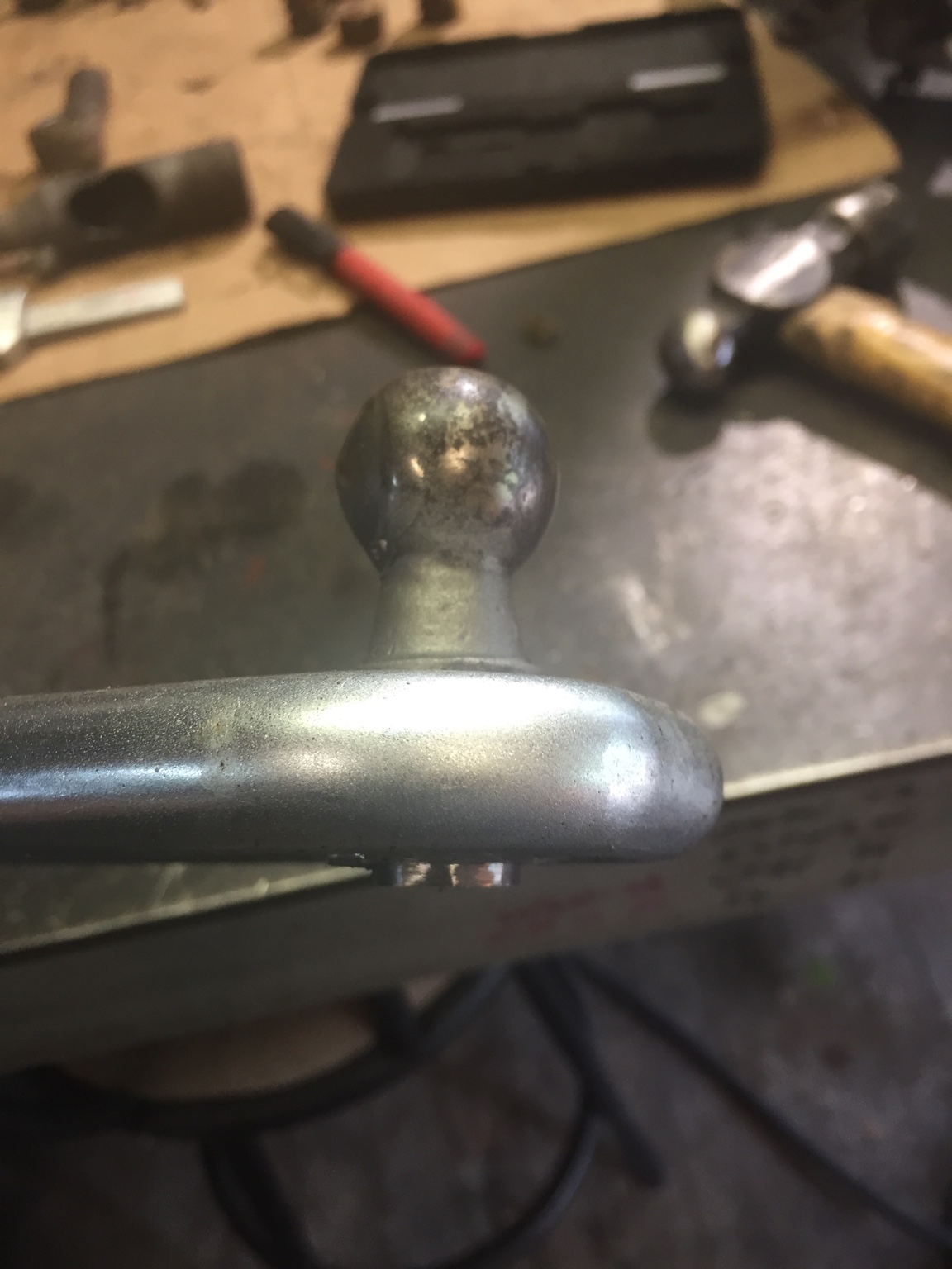

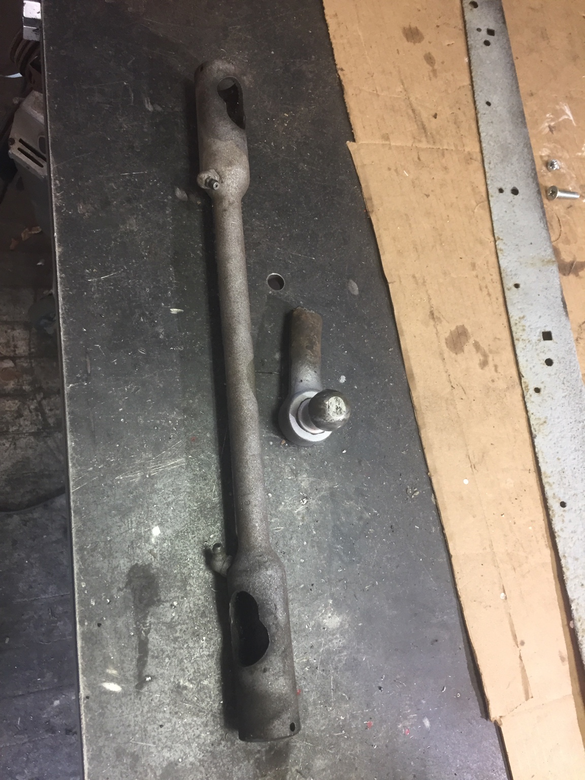

    I also decided to get a handle on the steering and sandblasted some parts ...went digging through boxes and found part of an F3 steering arm and also a drag link I picked up at some point.
    Pressed out the steering ball and tapered it to fit into my steering hoop after boring the hole to 5/8" on my drill press.
    Fit like a glove and somehow I had a drag link that appears to be the correct length for my set up.
    Pretty pumped about that ...[​IMG][​IMG][​IMG][​IMG][​IMG]
    I welded the bottom of the steering ball post afterwards.
    Nice when things go smooth

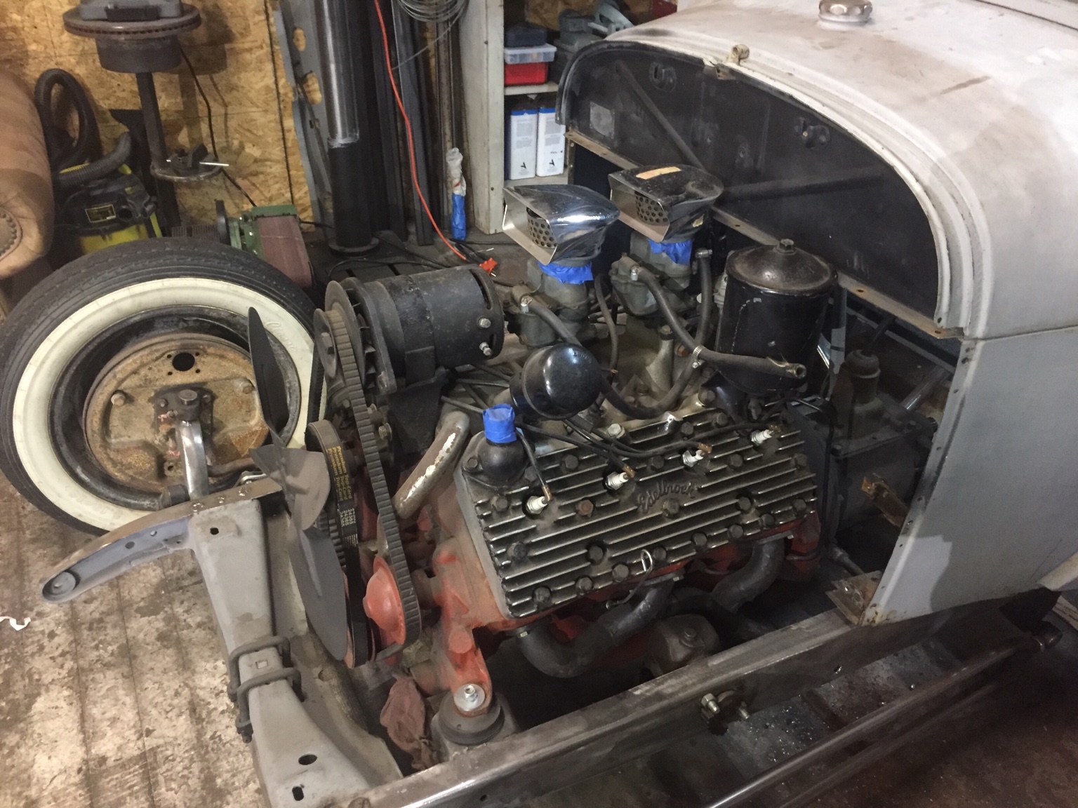

    Because of the step in the rear frame and running the 40 rear w the spring behind I needed to remove the rear portion of the subrail.
    I know I will need to rebuild some type of support for the back.
    I needed to get the body on blocks and where it would mount to the frame.
    Then removed the firewall and things fit perfect.
    [​IMG][​IMG][​IMG]
    Plans are to get the body sured up as straight as I can then lift it off the frame. Cut out the subrails and plan/start the channel.
    Unchartered territory as usual.

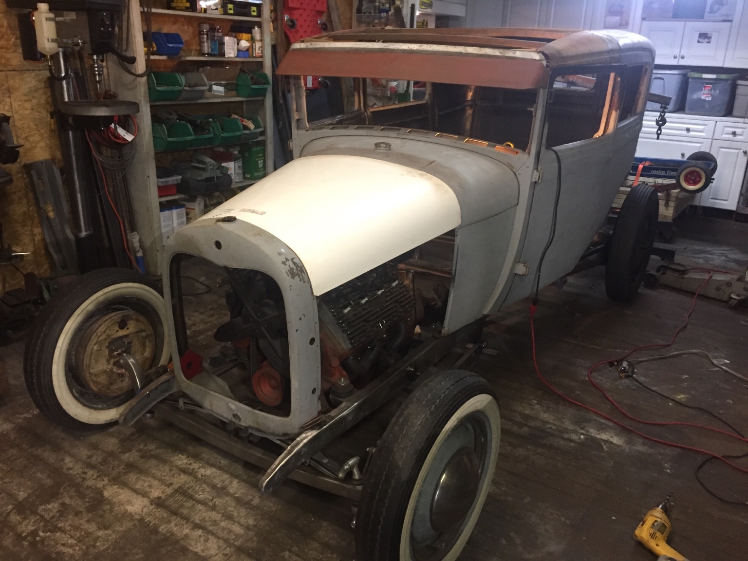

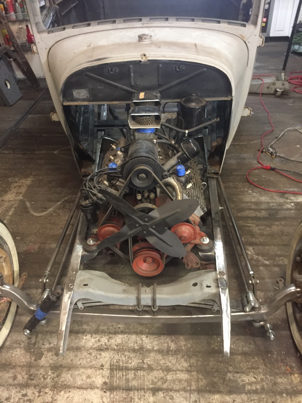

    Set the old grill shell and fibergl*** hood (came with the car) on to see how everything fit and looked.
    JOYFLEA, biggeorge, brEad and 4 others like this.

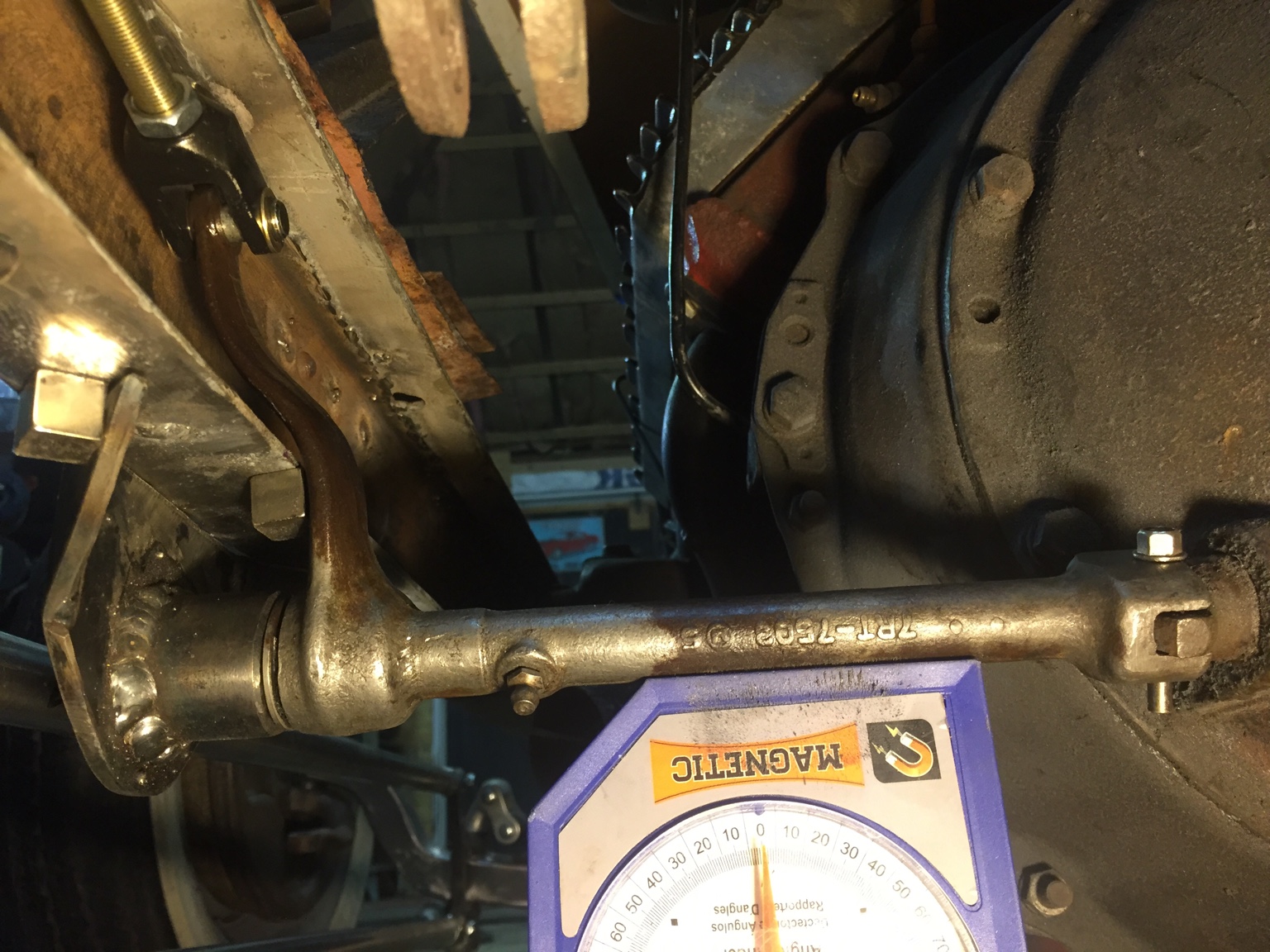

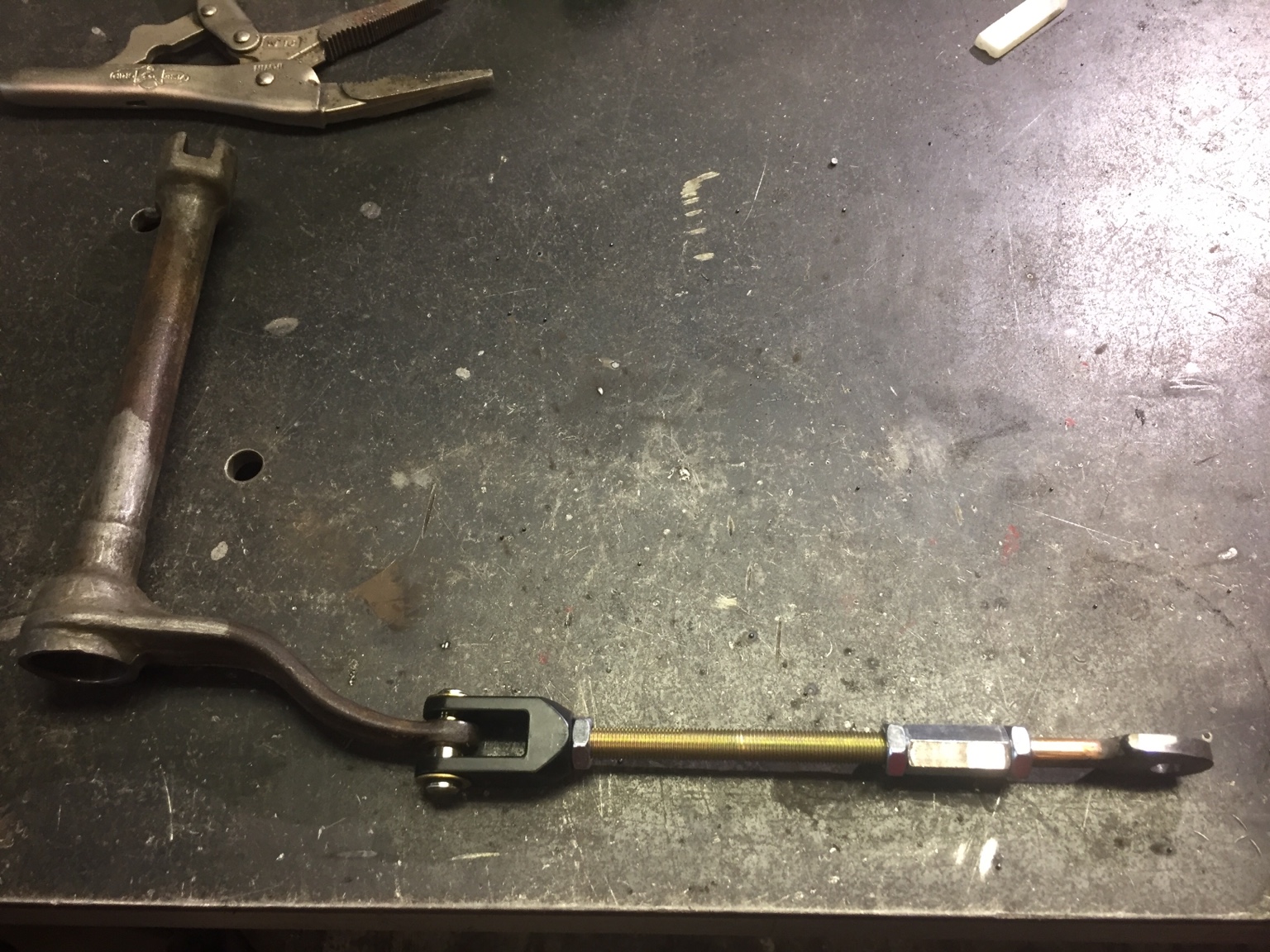

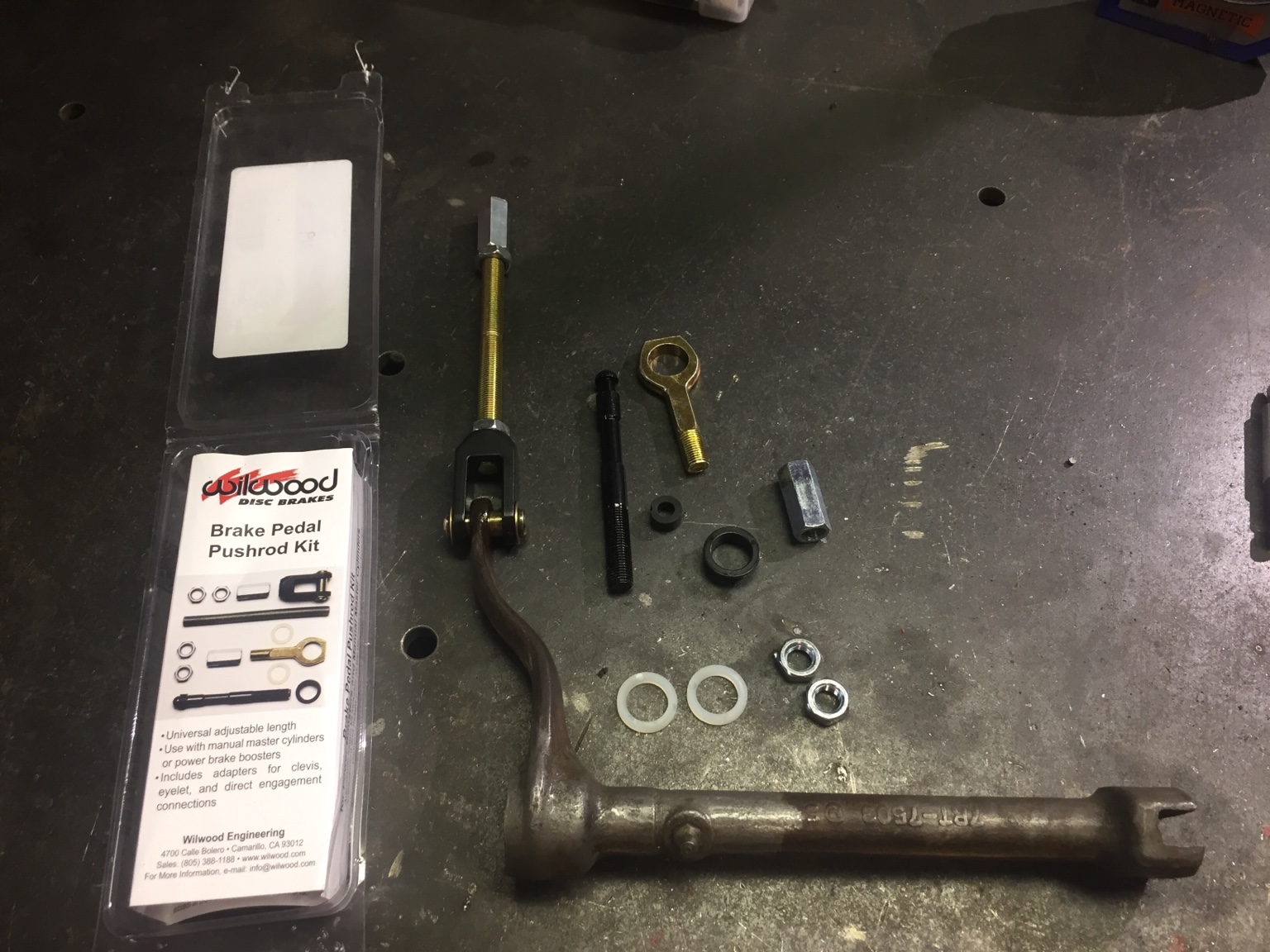

    Spent some time tonight focusing on getting the pedals sorted... had/wanted to cut the lower portion off the pedal mount because I didn't like the way it hung down past the crossmember, it was below about 1/4" but ehh. Didn't like it. [​IMG]
    So why I did that was because I thought I had F1 pedals.
    However I think they're 39 pedals maybe. I don't know...doesn't really matter I suppose.
    With the mount cut I positioned it and re drilled the crossmember for it.
    I'll fill the other holes when I tear things down.
    Then moved on to the clutch linkage.

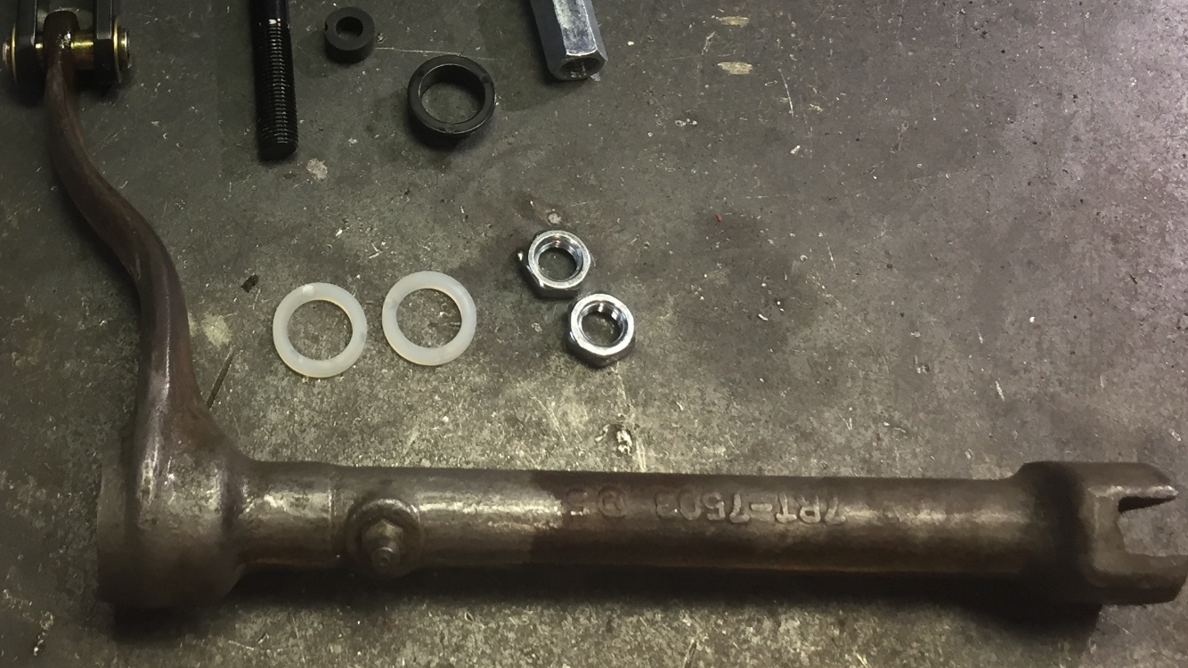

    Doesn't seem like there's a real set way people set up the linkage or a hot set up from what I can tell.
    So this is what I've got and I like it.
    I used the clutch actuator shaft from an F1 because I thought everything else was F1 and it just made sense.
    I purchased a Wilwood brake Master Cylinder push rod kit for my brakes.
    But when I ordered my Master it came with everything I needed so the Wilwood kit was "Spare parts"
    I had to modify the linkage loop on the pedal side by fabricating my own using the thread portion of the piece in the kit.
    After some fine tuning it bolted right up and fit like a glove.
    The bolt is temporary just to hold it in place.
    I'm going to use a pin with cotter pin for final. [​IMG][​IMG]
    Inside the frame rail from the steering box. [​IMG]
    I need to fabricate the carrier mount that the clutch shaft will rotate on. It will be welded to the underside of the frame rail ...going to go hunt for bearings tomorrow...then get to work.

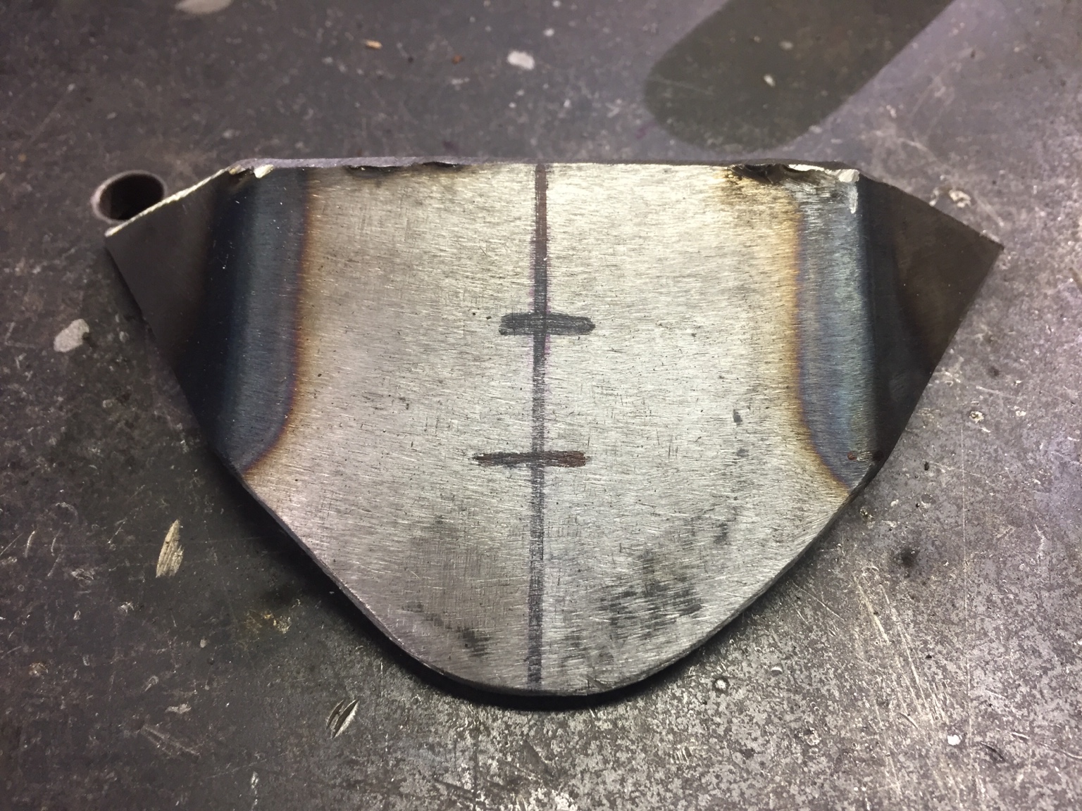

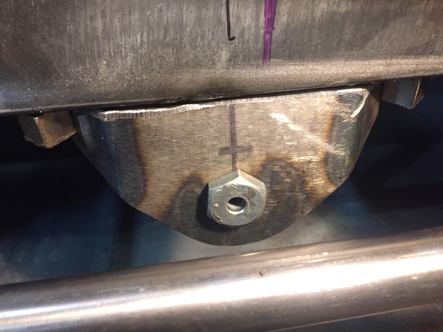

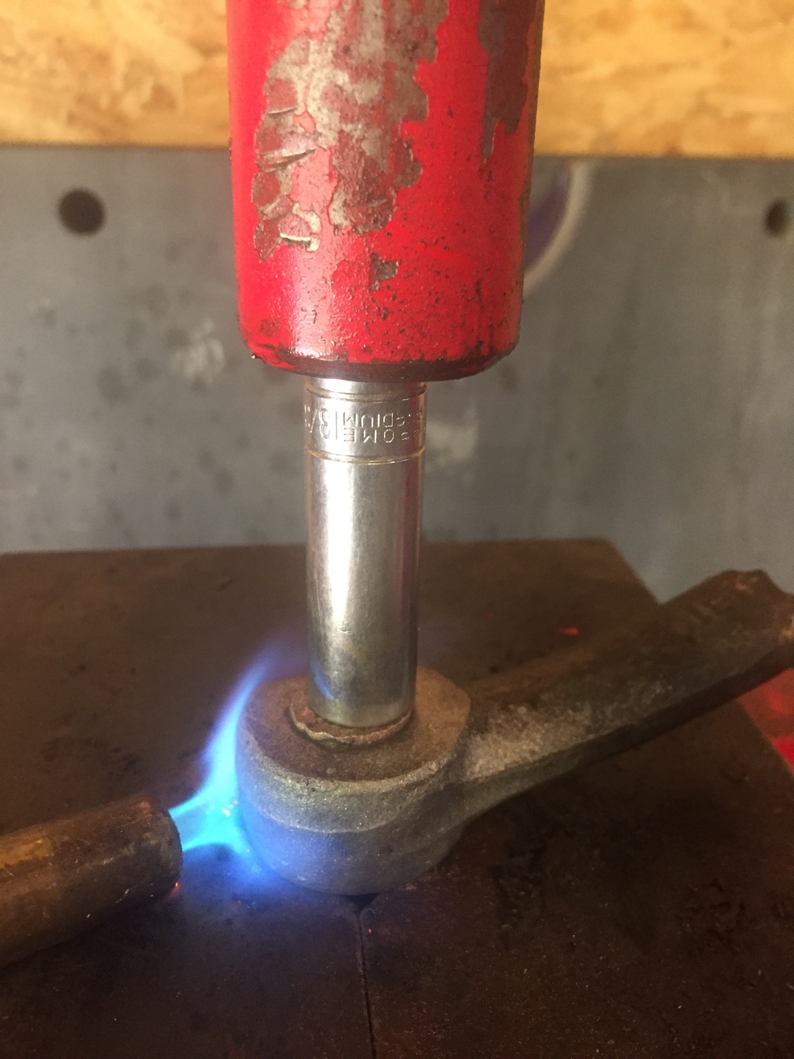

    After Mommas day was all said and done I got to spend some time in the Garage.
    Wanted to finish up the clutch rod mount.
    So that's what I did and here's what I got.
    I wanted to mimic the hairpin mount so I made a smaller version of them.
    Then I spent hours figuring out how I was going to make it pivot smoothly on it. So I carefully opened up the ID on the shaft cup.
    I then pressed on a grease seal and bushing/spacer from a dirt bike rear shock linkage kit I had.
    Then used the bushings and bearings from the same kit. I had to cut them way down to make things work.
    I fabricated up a spacer/seat for the bearings to sit in for the mount itself. I made it from an 1-1/4" Dom tube with a 1"ID (same as the OD of the bearing)
    I drilled out the 5/8" pivot pin hole in the mount and pressed in the bearing and grease seal on the mount. [​IMG]
    Things fit together great
    Got things fine tuned and fitted up.
    Clamped on the frame and used my clutch tonight.
    That thing moves like "****ah" as we say in M***.
    I need to add a small stop for the pivot pin so it won't back out of the mount. So I won't weld it to the frame until that's done.
    But I and extremely happy with the finished product.
    [​IMG][​IMG]

  25. NashRodMan
    Joined: Jul 8, 2004
    Posts: 1,989
    NashRodMan
    Keep on truckin" Mike!! What are those square things on the bottom of the frame in that last picture?
    Mikel50 likes this.

  27. Mikel50
    Joined: Mar 30, 2015
    Posts: 1,113
    Mikel50
    Those are 1/2" square strong *** magnets.
    brEad likes this.

    tb33anda3rd
    is there enough movement in the shaft/bearing, to allow the motor/****** to roll when under torque?
    Mikel50 likes this.
  29. Mikel50
    Posts: 1,113
    Mikel50
    Ya know that's a really good question.
    Now you've got me thinking.
    Where the shaft meets the clutch arm on the trans it has a 3/8" long slot for the pin or bolt to go through. It oscillates and moves in and out pretty good. The shaft will float in and out about 1/4" with the room it would have if I weld the mount flush with the outside of the frame. (That's the plan)
    I guess I should jack up the motor to see rotation under load.
  30. Mikel50
    Posts: 1,113
    Mikel50
    I have an option to replace the needle bearing with a rubber bushing. All I need to do is find a rubber bushing [emoji16]
