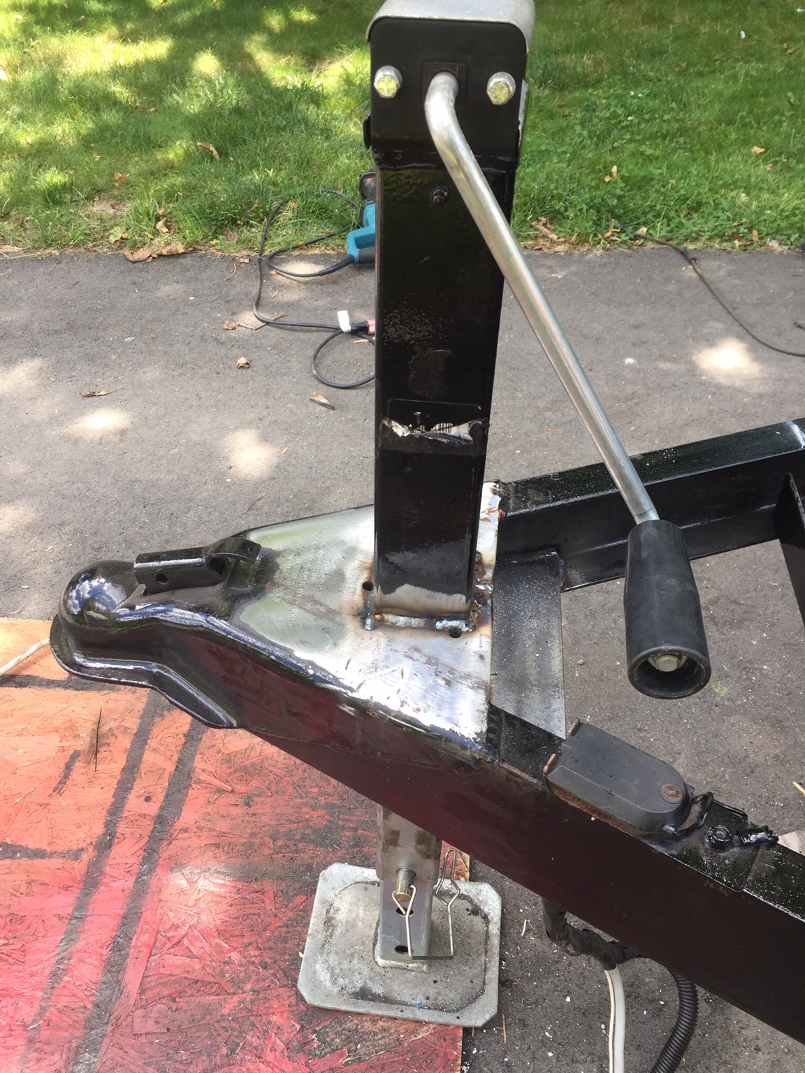

    Sold a bunch of my possessions lately and have been workin my butt off to buy a car trailer ... so I've been working on that rebuilding all the halfass work the previous owner did.
    [​IMG][​IMG][​IMG]
    New jack, chain/strap basket (made from a small dump trailer mesh gate/dumpster find) rewiring the entire trailer from tip to tail. New paint, reflector tape and all new lights blah blah.
    Wanted to have a trailer in the event I found "my next project" at the VT Auction this past Saturday.

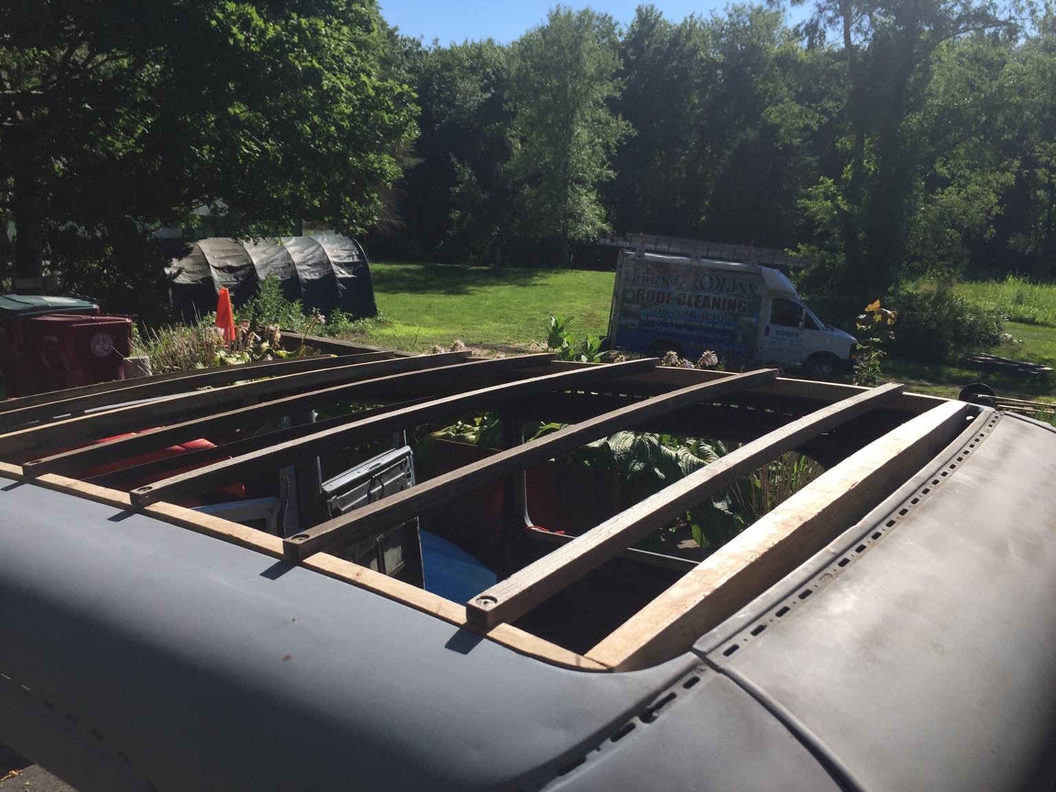

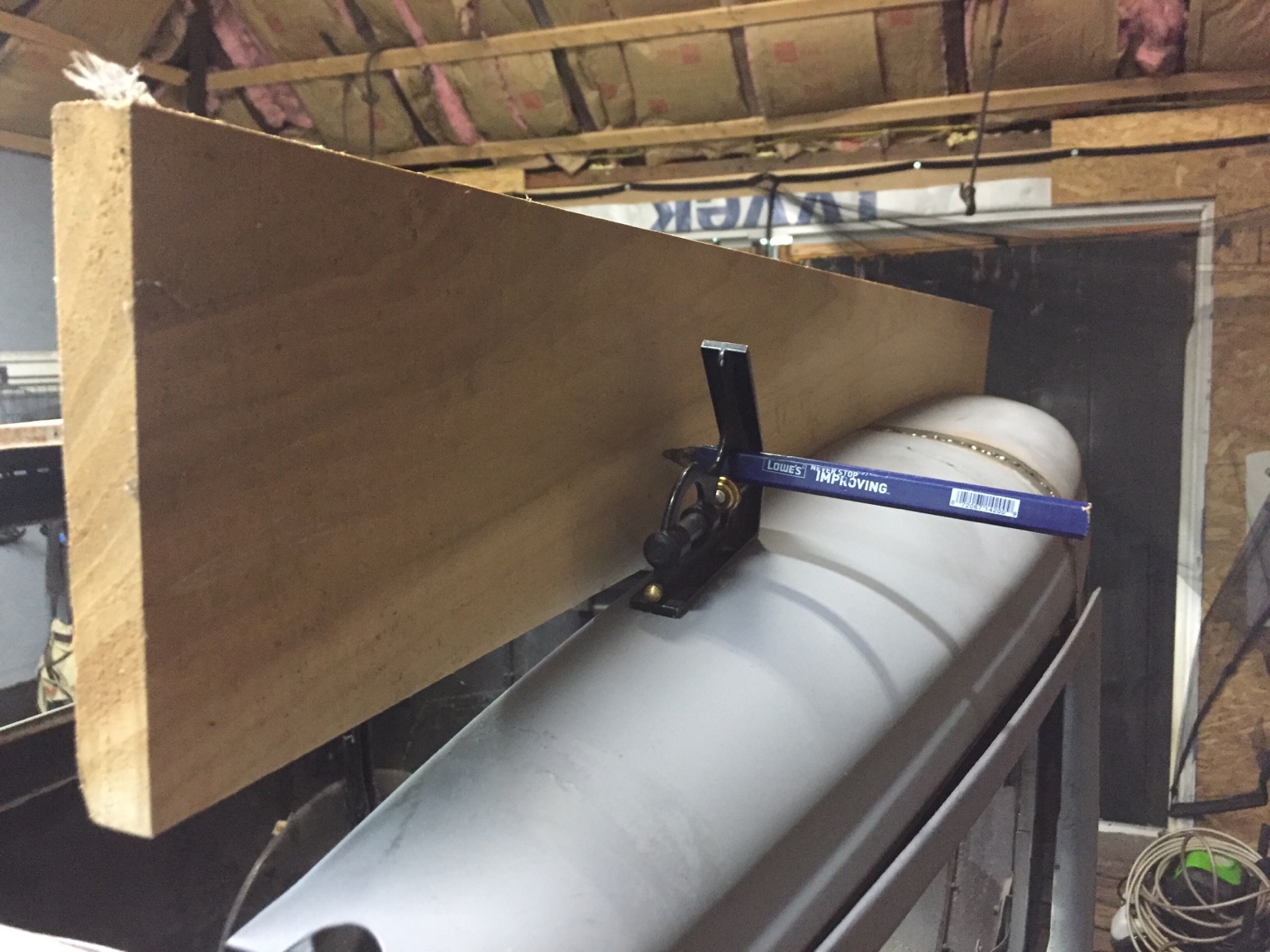

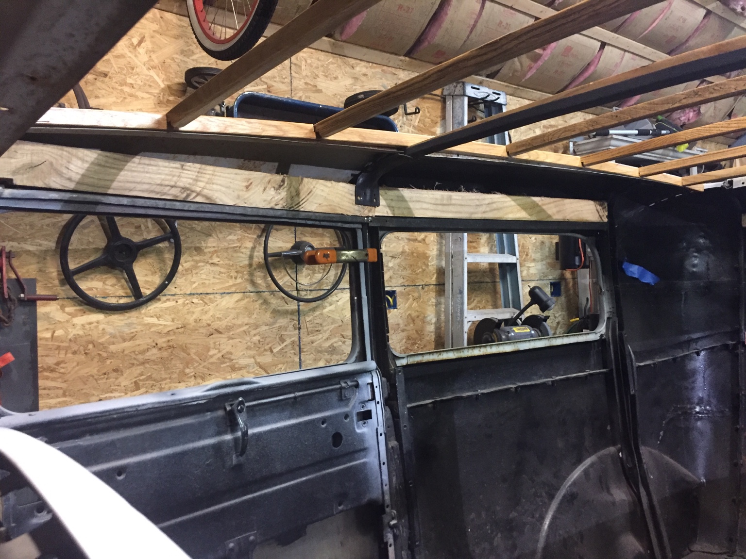

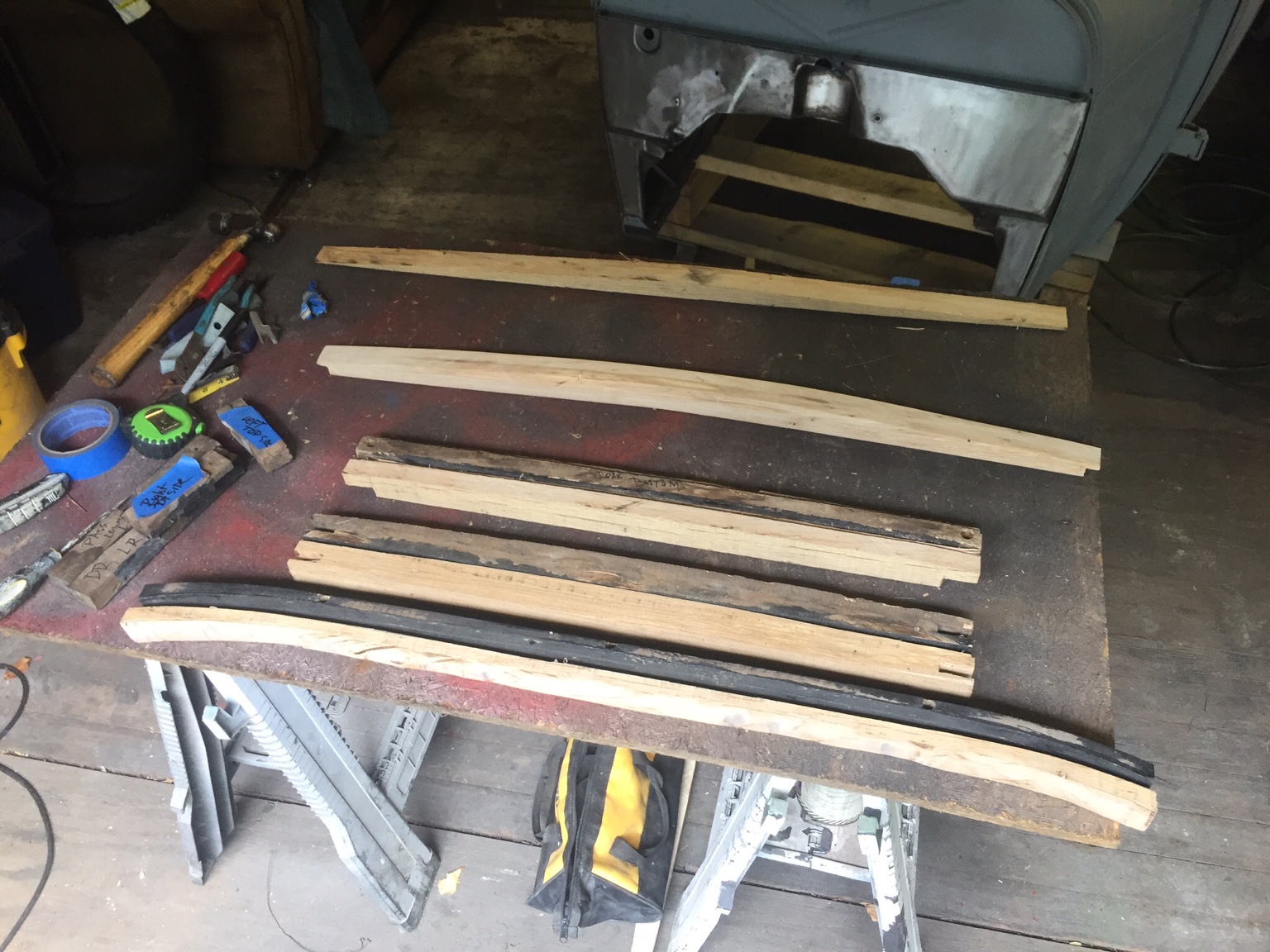

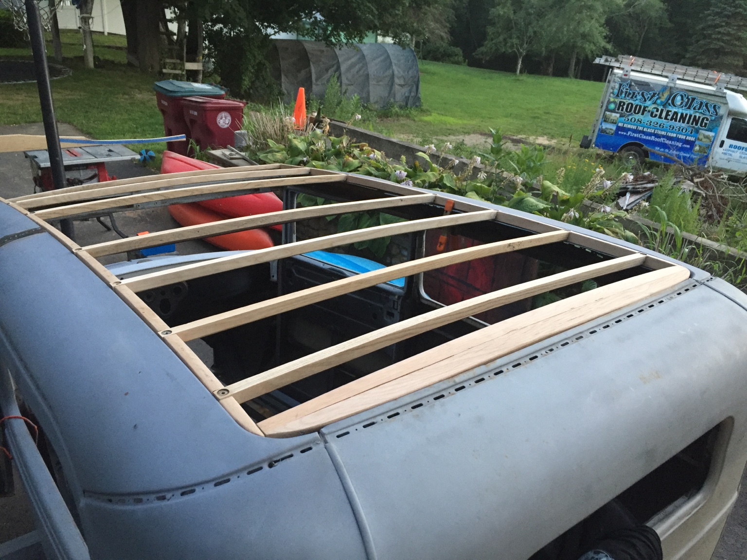

    Past week or so I spent a small amount of time on the car.
    Yesterday I decided today I wanted to get something done with the roof
    So I picked up a rough sawn piece of 2"X6" Oak from my neighbor who reclaims old beams from homes.
    I took a piece of poplar 1 X 6 stock and made up a template from my drivers side roof.
    It's the "good" side.
    The pass side was pretty out of shape and I wanted to get them so they were similar.
    Pass side
    [​IMG][​IMG][​IMG][​IMG]

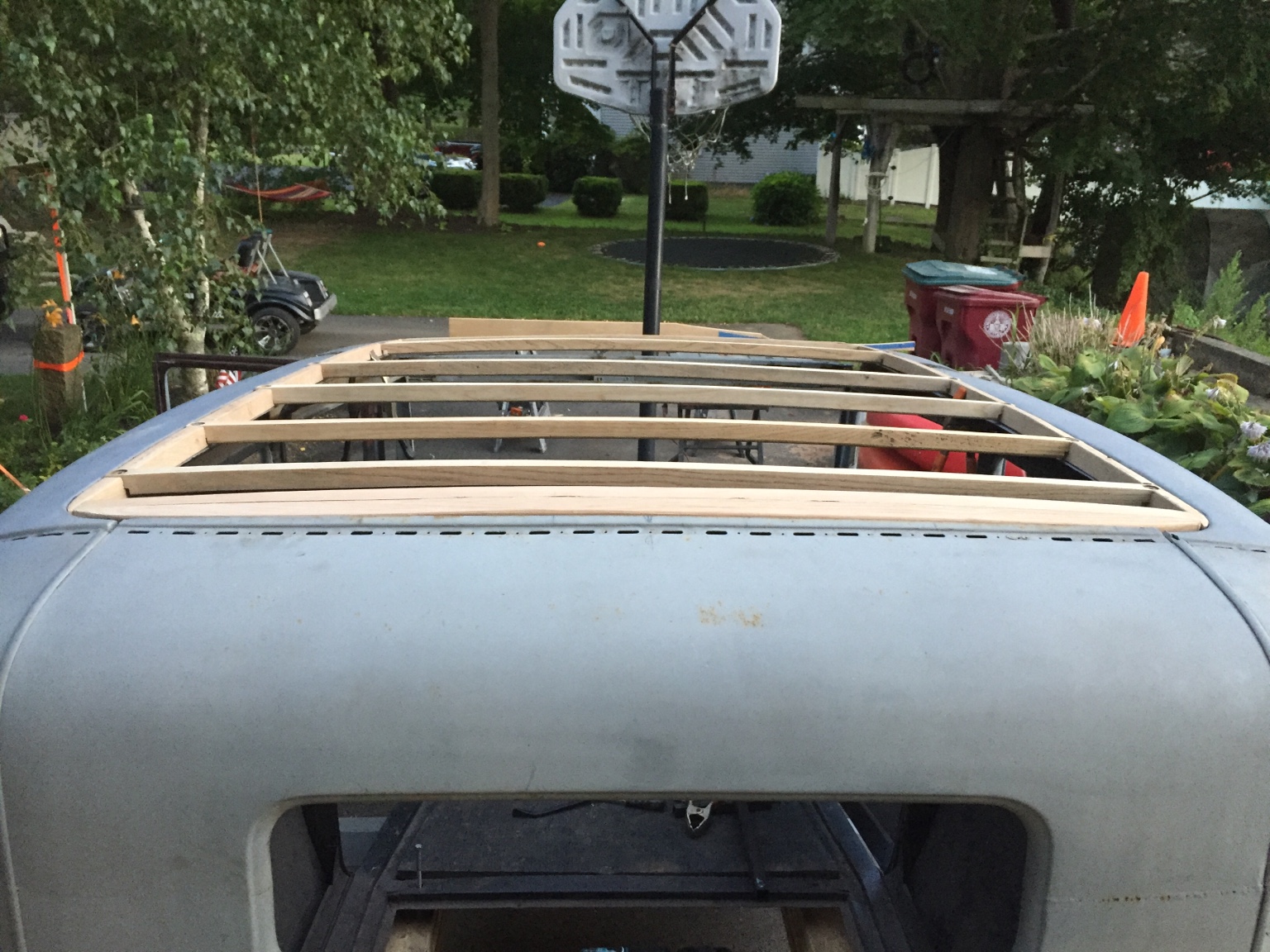

    I transferred my template over to the pass side secured it with screws and worked the roof panels with a mallet.
    It actually worked.

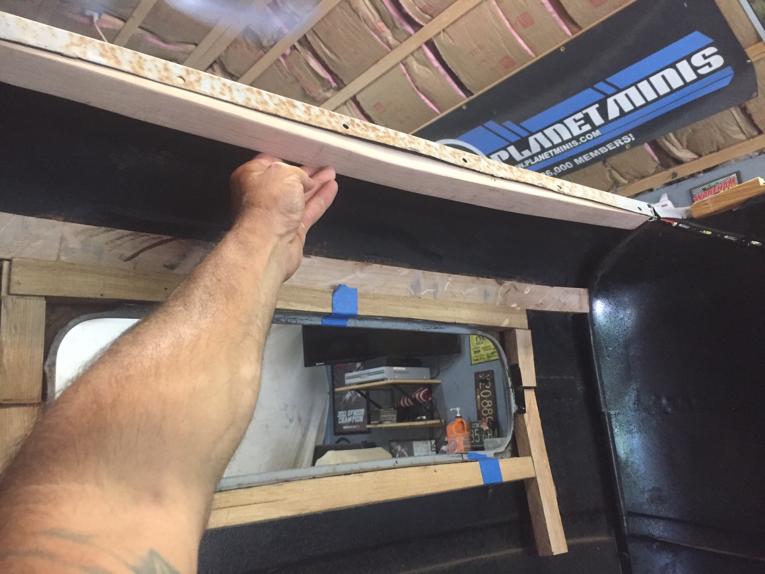

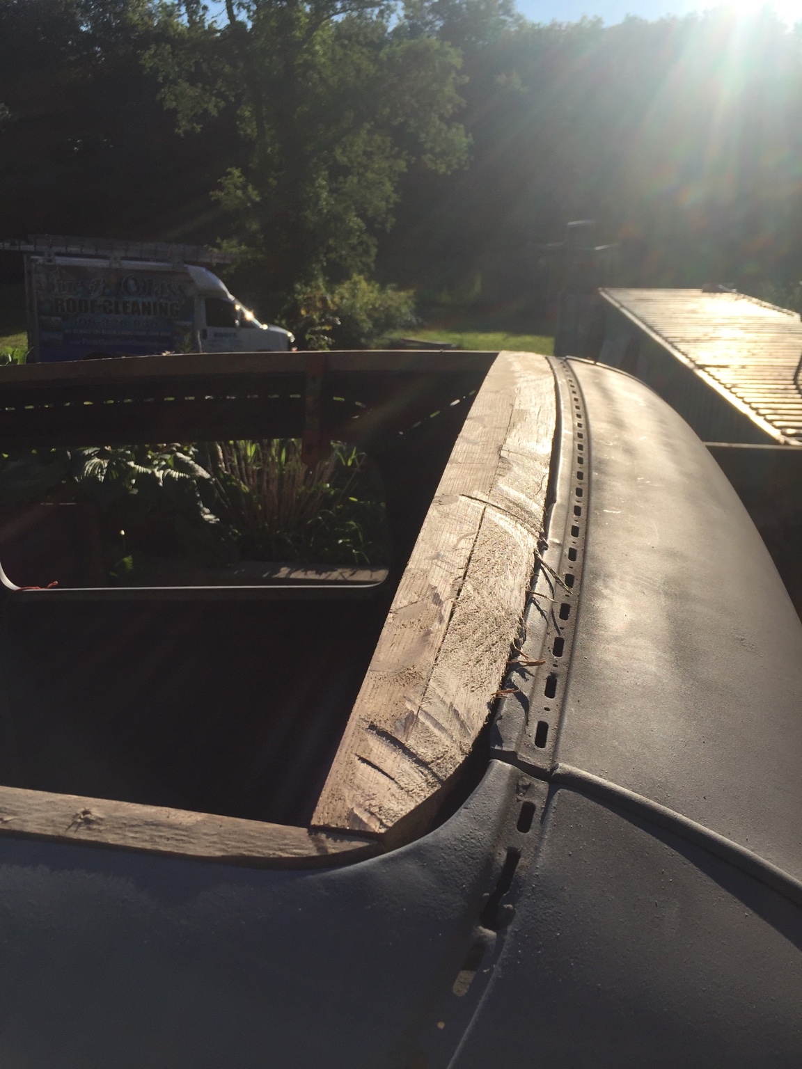

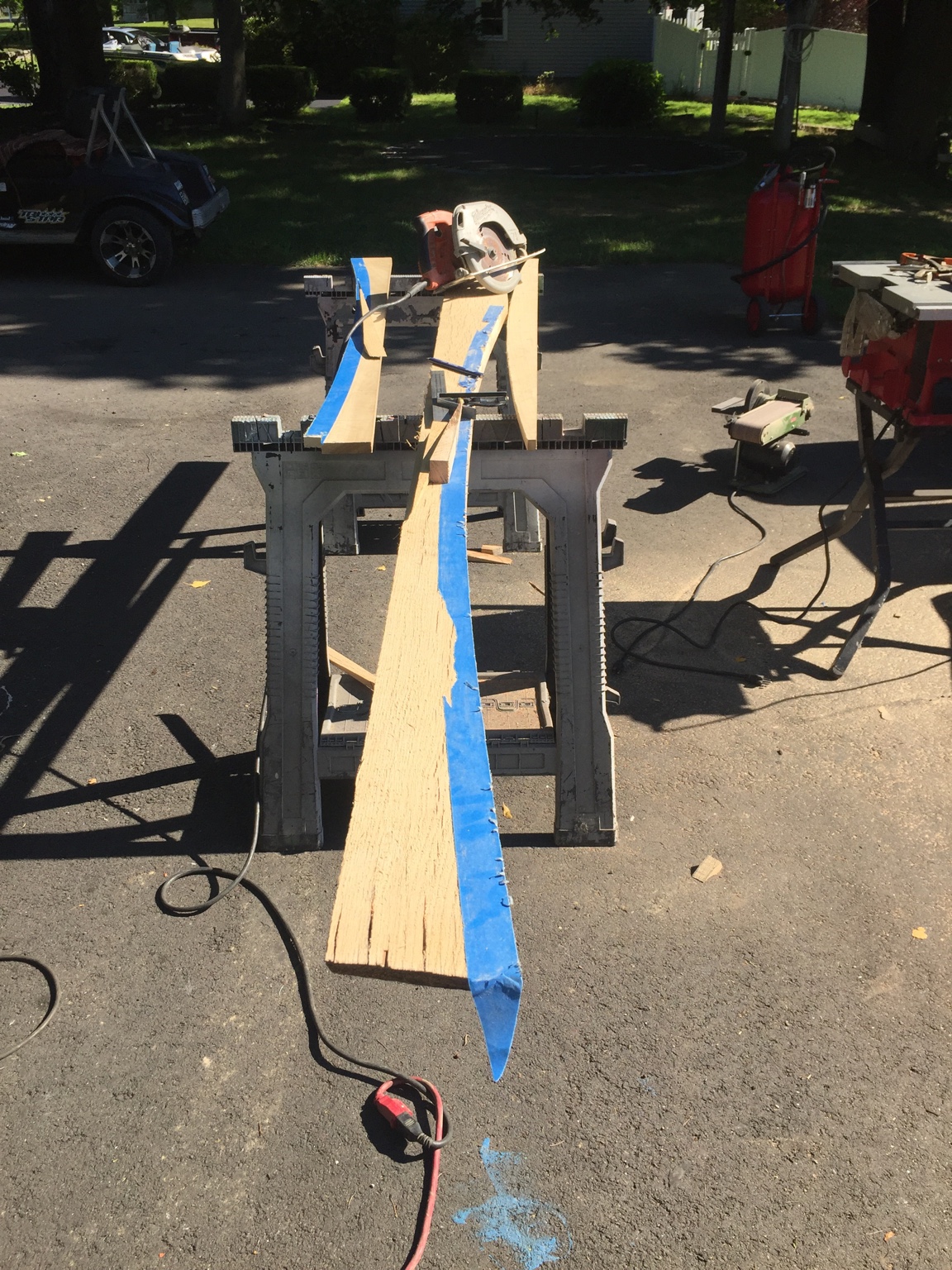

    Here the Rough sawn Oak from my neighbor.
    I have already transferred my template and cut what I needed.
    I had the roof bows but did not have any other pieces.
    So I took my templates and cut two runners from front to back for the bows to sit into.
    (Still have to recess the areas)
    I also created a piece for the rear of the roof to tie it together across the back.
    I used two pieces of oak and man it took a while.
    But again it will be worth it.
    It's just rough cut on a table saw.
    But you can see what I'm trying to achieve
    This pic shows the additional filler I glued and screwed to the other 2" rear wood.
    This piece took forever.
    So many curves in every direction and on all sides.
    Still need to sand it and drill the holes for mounting.
    But it's progress.
    It's nice to see the car tightening up with every step.
    It's been a wobbly mess until now.
    Supervisor showed up today ...
    48fordnut, brEad, biggeorge and 3 others like this.

    Hey ,you got a Union card to do that woodworking? HaHa

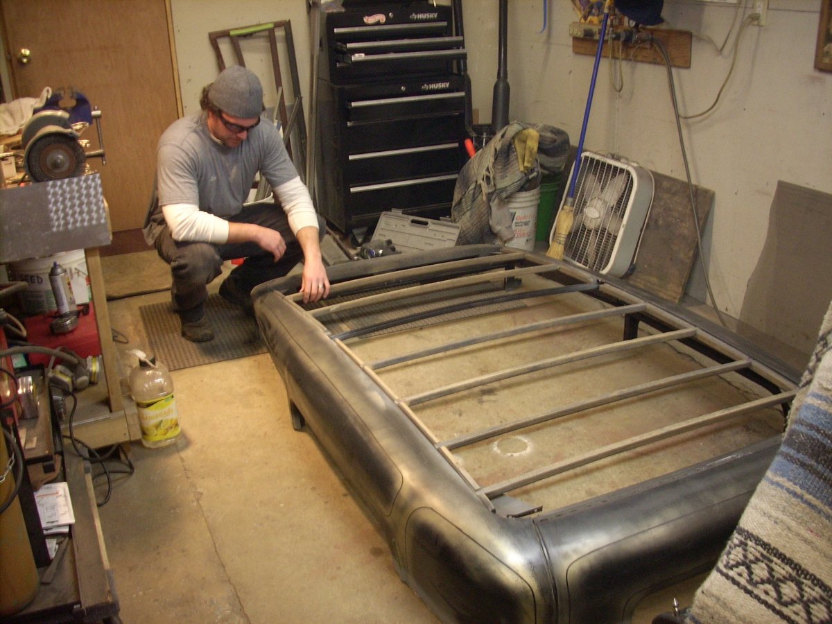

    Good job; make sure wood goes under the metal edge for nailing. My '30/31 Sedan had a metal bar that went side to side too , probably for extra support, not sure about the '28/29's.
    What are you doing to finish the roof? Metal, or material of some sort? ( Juliano's has top kits that used to be really reasonable and came with good install info.)
    Best pic of mine was during a 3" haircut! Anytime you think you're not making progress, go back to page one of your thread...............

  17. sloppy jalopies
    Joined: Jun 29, 2015
    Posts: 5,256
    sloppy jalopies
    mike, the tudor steel cross channel is upside down [shaped like a u not an n]...
    what I did was drill [5] 1/8" holes going through both sides, evenly spaced across the channel, this lets me add a rib in front or in back of it later if needed [once the insert is in drilling holes will be tough]...
    also let me punch the holes to put the dome lite where I want it... HIH...
    Mikel50 likes this.

  19. sloppy jalopies
    Posts: 5,256
    sloppy jalopies
    memory says it did not have a rib inside it but it's been 27 years since I messed with a '29 tudor...
    it may sit slightly lower in the car than the ribs...
  20. Mikel50

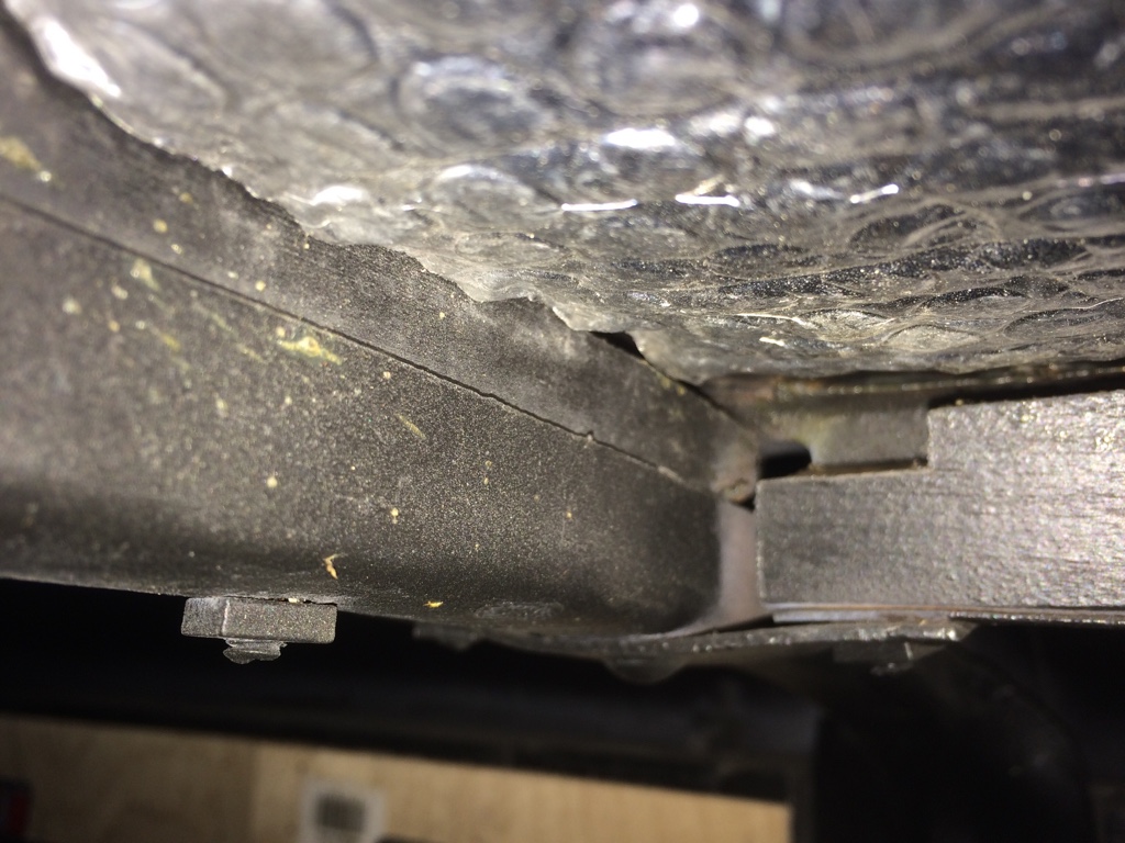

  21. Mikel50
    Joined: Mar 30, 2015
    Posts: 1,113
    Mikel50
    Comparing my last picture and mikes "little off the top" his metal rib is the 3rd bow back from front. It is just underneath the roof wood.
    Mine is not.
    So I guess that is my homework tonight.
    [emoji137]‍♂️thanks !
  22. Mikel50
    Posts: 1,113
    Mikel50
    It appears after looking at my car. If I put the body wood above the door to the back of the car to tack the top into. That rail may screw into that wood.
    It makes sense now why there is the void/relief in the metal flange where he roof wood sits at the B pillar. I'll start to template those pieces tomorrow.
    Thanks for the help guys.

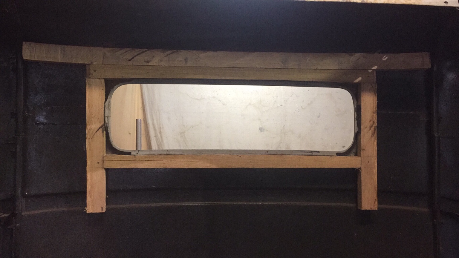

    [​IMG] I'm sure that isn't how Henry did it ...next is the windshield header and the body wood.
    [​IMG][​IMG] did not cut a relief for the 4th bow in the event the metal brace is to be there.
    I think I added one too many.
    I'll have 8. Oh well

    Hi Mikel, I went out and looked at my 28 Tudor. There is wood on the top of the brace. I have the header and two bows, then the brace. The brace sits into a dado in the side body wood.
    Mikel50 likes this.

  30. Mikel50
    Posts: 1,113
    Mikel50

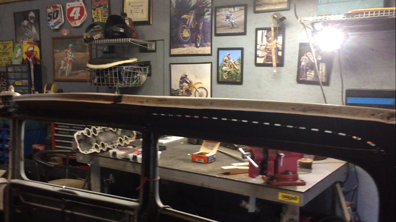

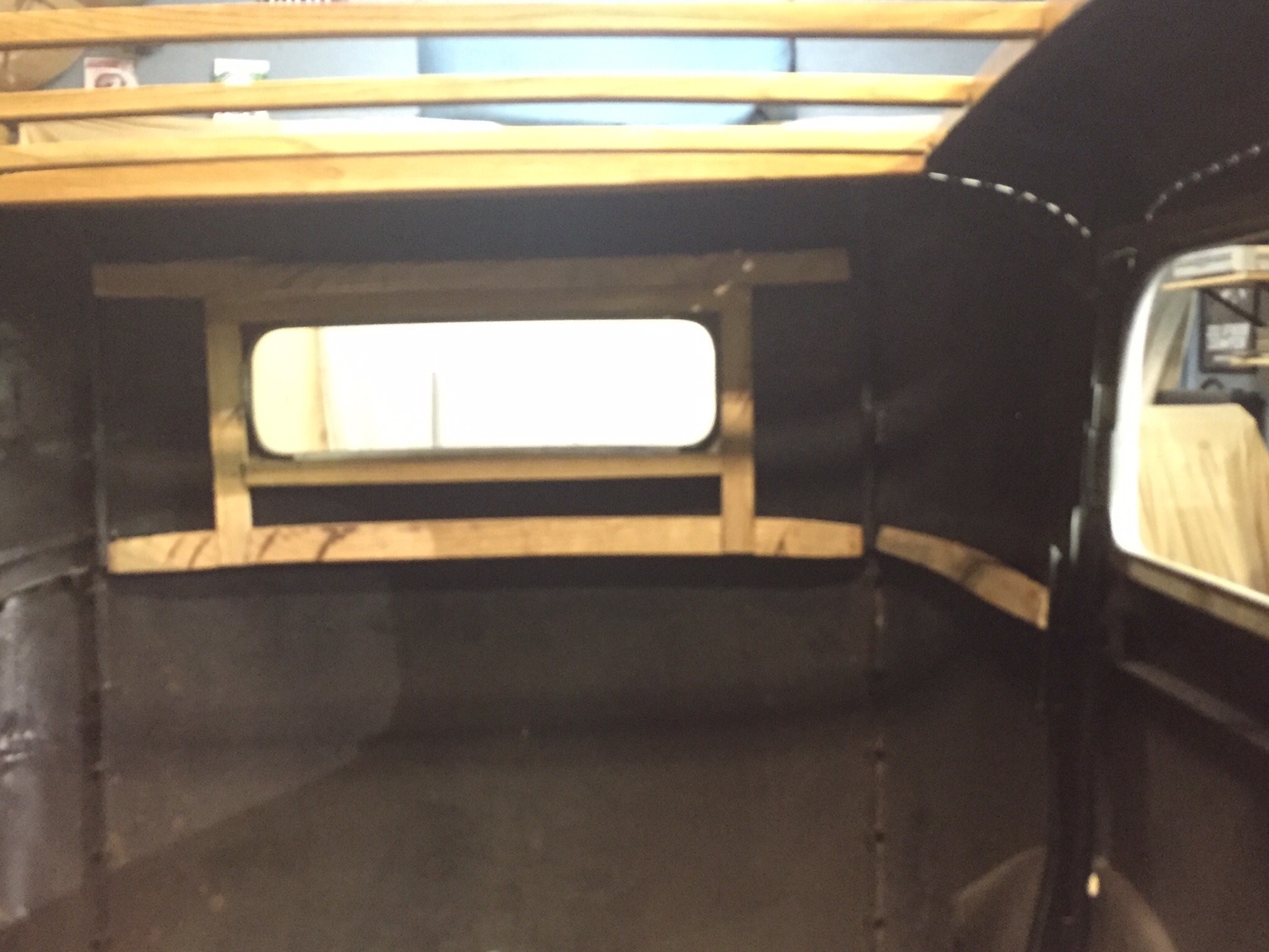

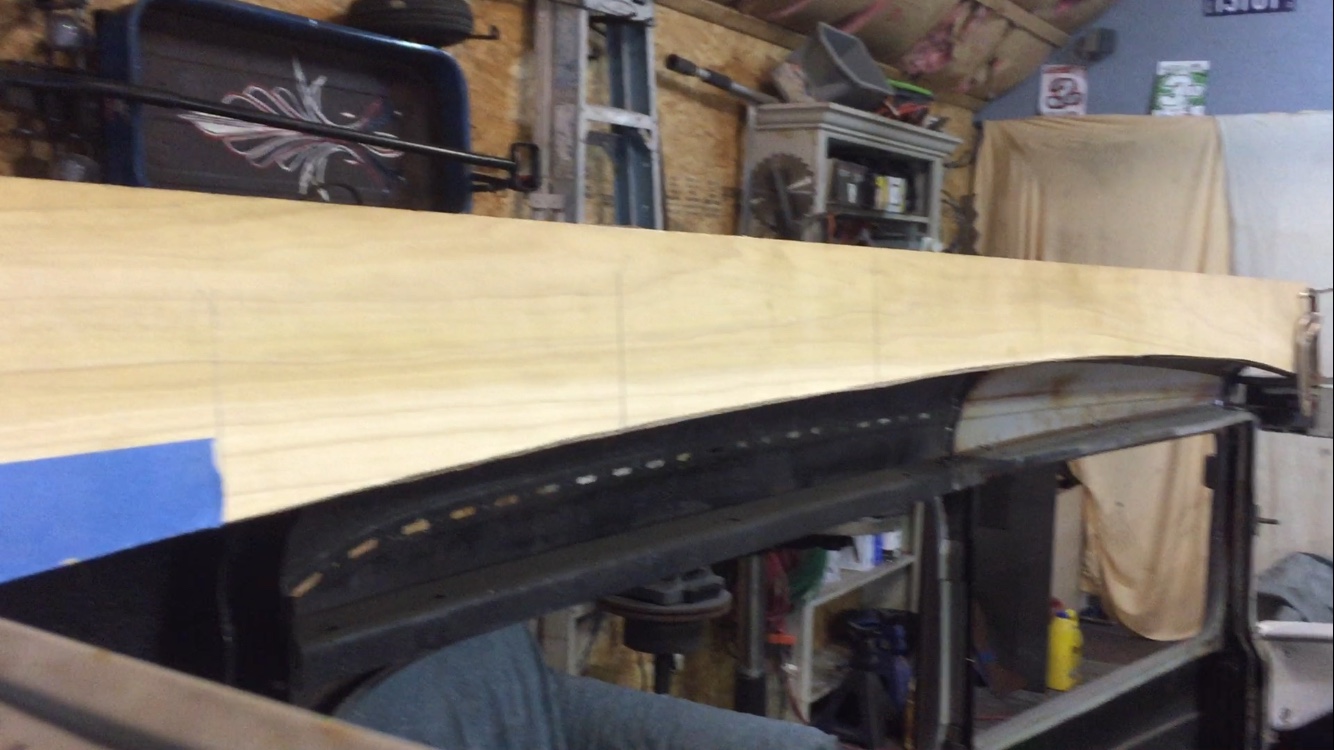

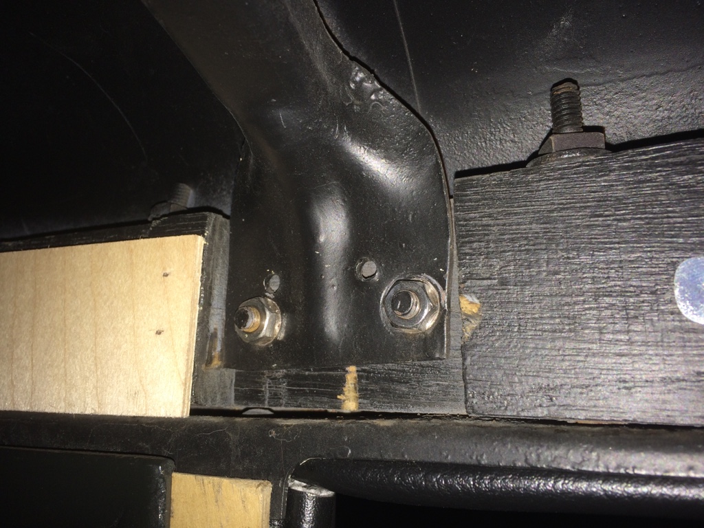

    Been trying to move forward with the body wood the last few days. It's not as simple as I had hoped it would be.
    But I should know better by now
    [​IMG][​IMG]
    [​IMG][​IMG]
    Since temporarily screwing the wood into the body my doors have aligned to damn near perfection.
    (Must be doing something right) or it's just dumb luck. [​IMG][​IMG]
