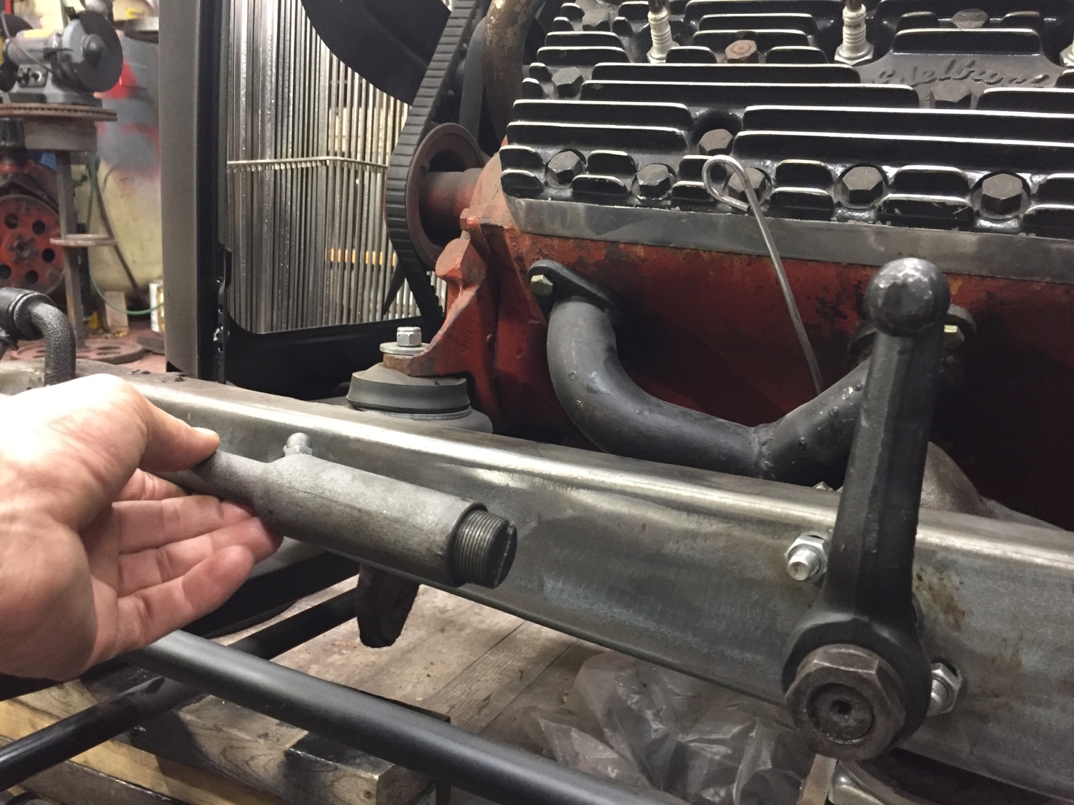

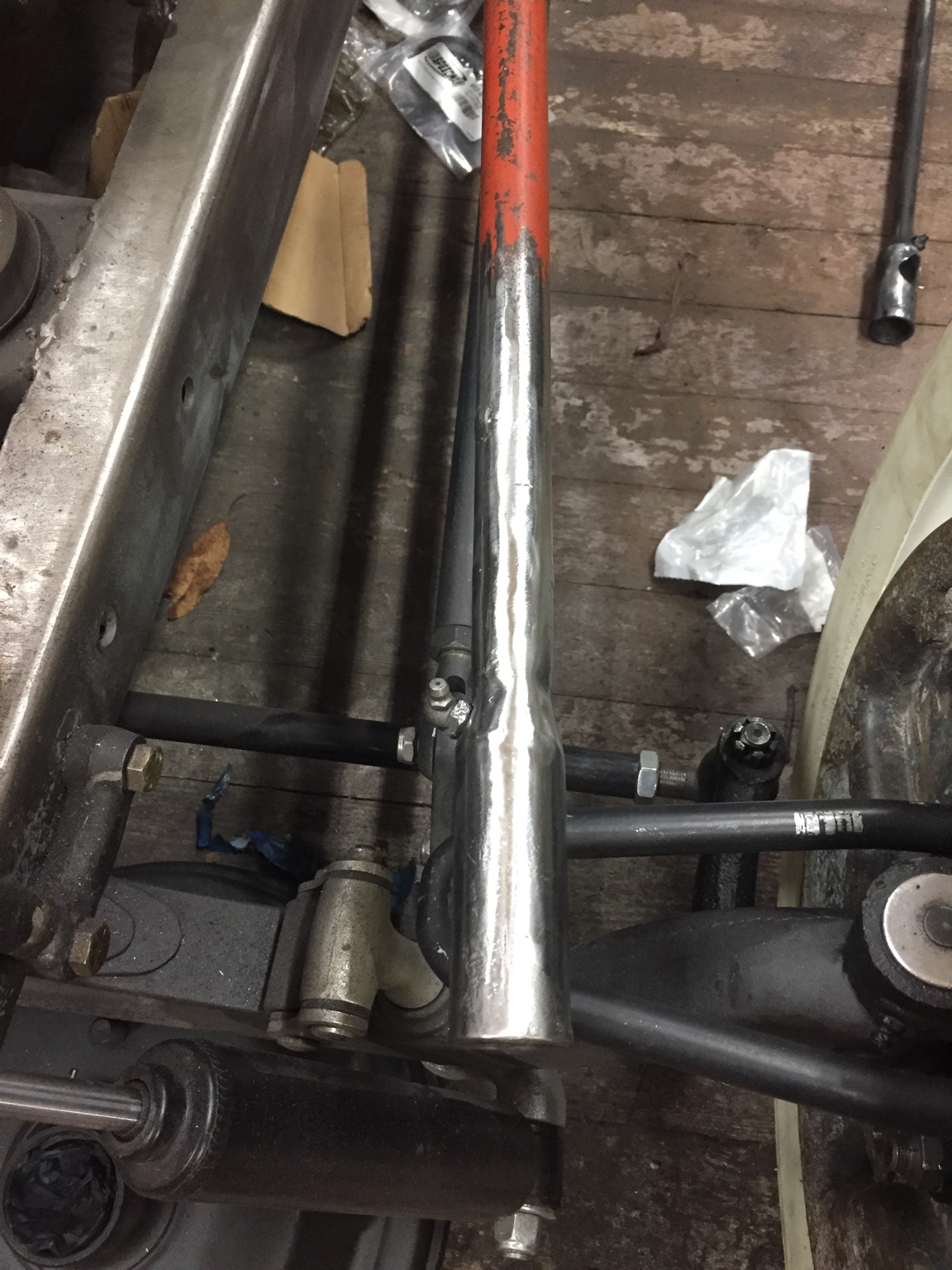

    Fitted the steering box and started getting things figured out for my draglink.
    Have what I believe is a solution ... stay tuned [​IMG][​IMG]

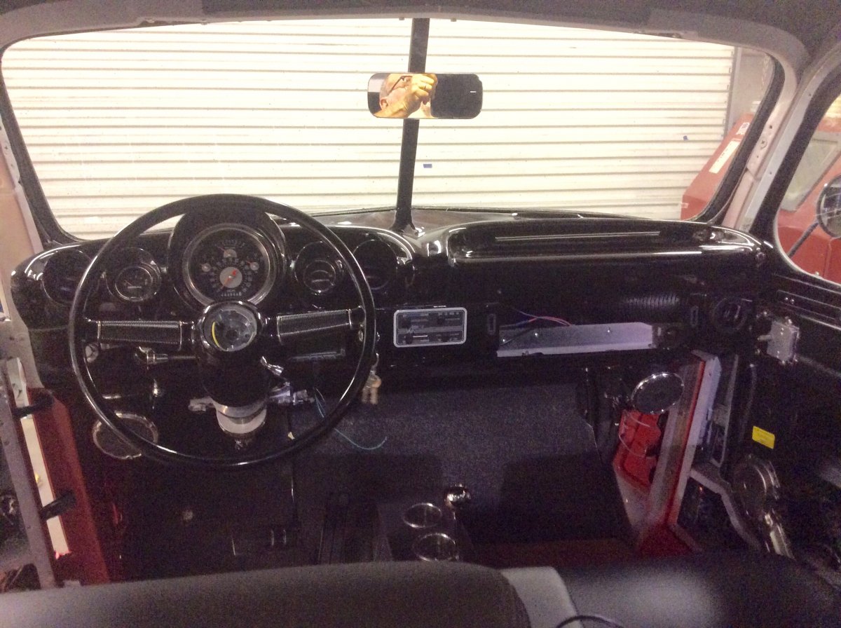

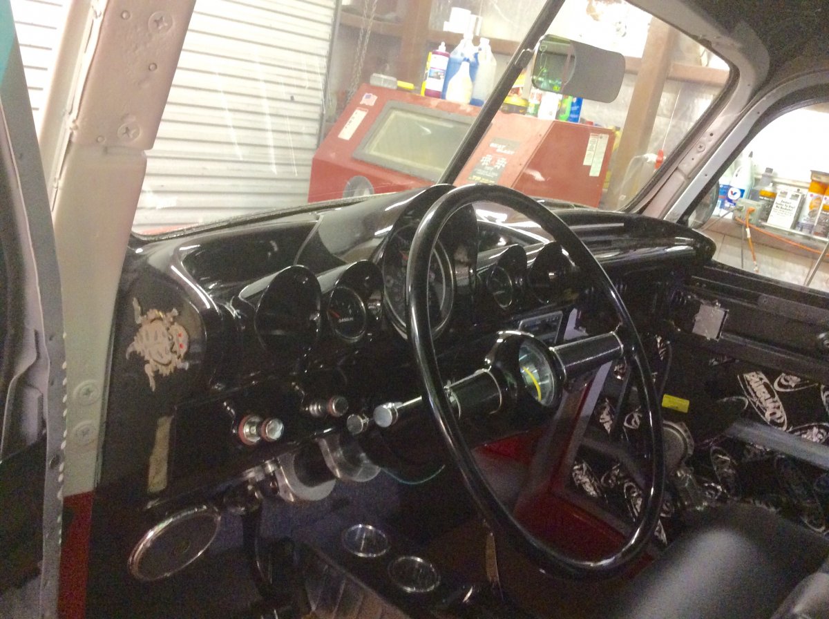

  12. I can’t believe I haven’t seen this build before!
    Your A has come a long way , you too have come a long way . Do you fill like you need a bigger hat for all that knowledge you’ve picked up ? I’m doing an Tudor at this time also .
    I’ll be watching and keep up the good work .you did a great job on the dash . Guys just don’t know how much work goes into one . Did this one for my 42 COE . Plan is to build one for the Tudor. Have fun . Blue

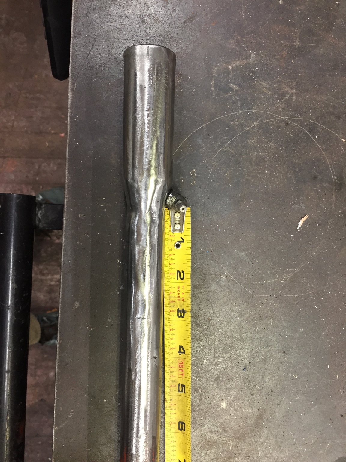

  13. Idk if you took a look at what I have on my car, but I have a drag link end on the steering arm of the spindle and a tie rod end on the pitman arm side. TIG welded and drilled and pinned due to the forged nature of the piece.
    I had to buy a piece of dom tubing from speedway to do it, I believe it was 11/16. I mention this because I was told that the stock arm is nowhere near strong enough even in stock form, never mind if it has a bend. Supposedly bent drag links due to poor roads were common.
    I have no idea of what you were thinking, but just wanted to mention everything I learned for reference

    The draglink in the pictures is an F1 link. It's quite a bit larger in diameter than the stock A. My plan is to use that with the tubing. Hopefully make some progress tomorrow with it.
    Fingers crossed.

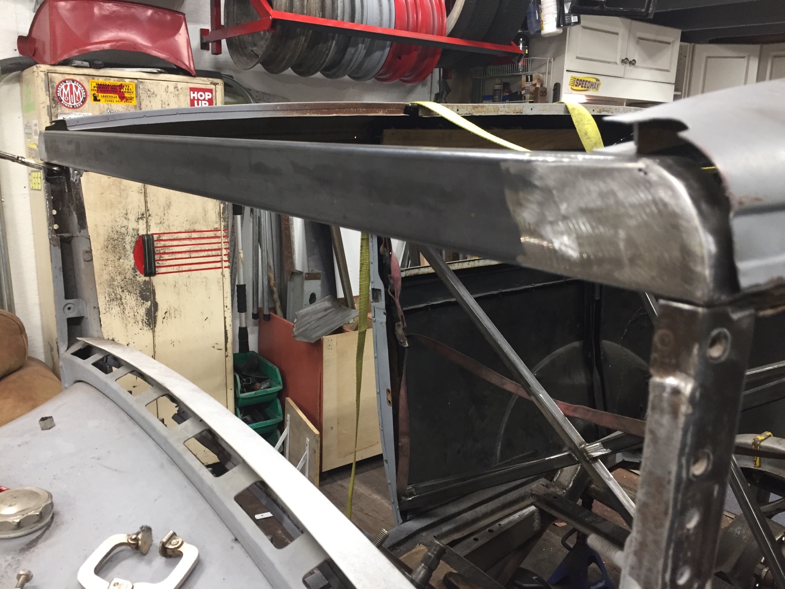

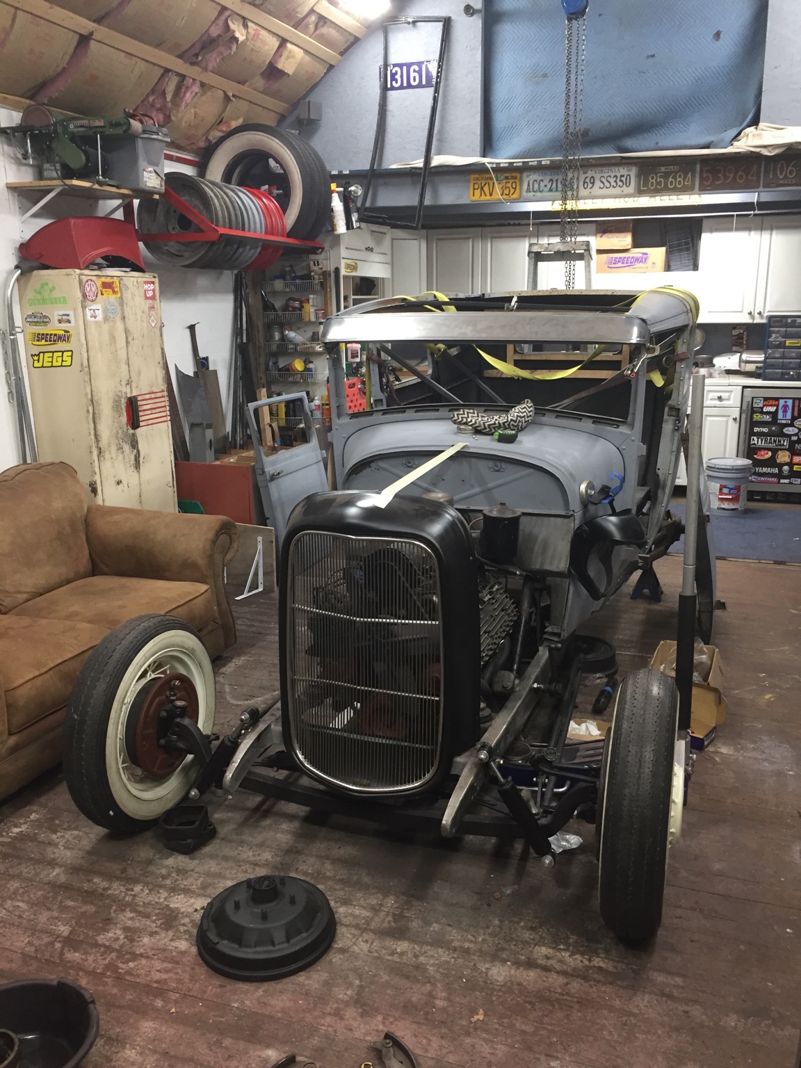

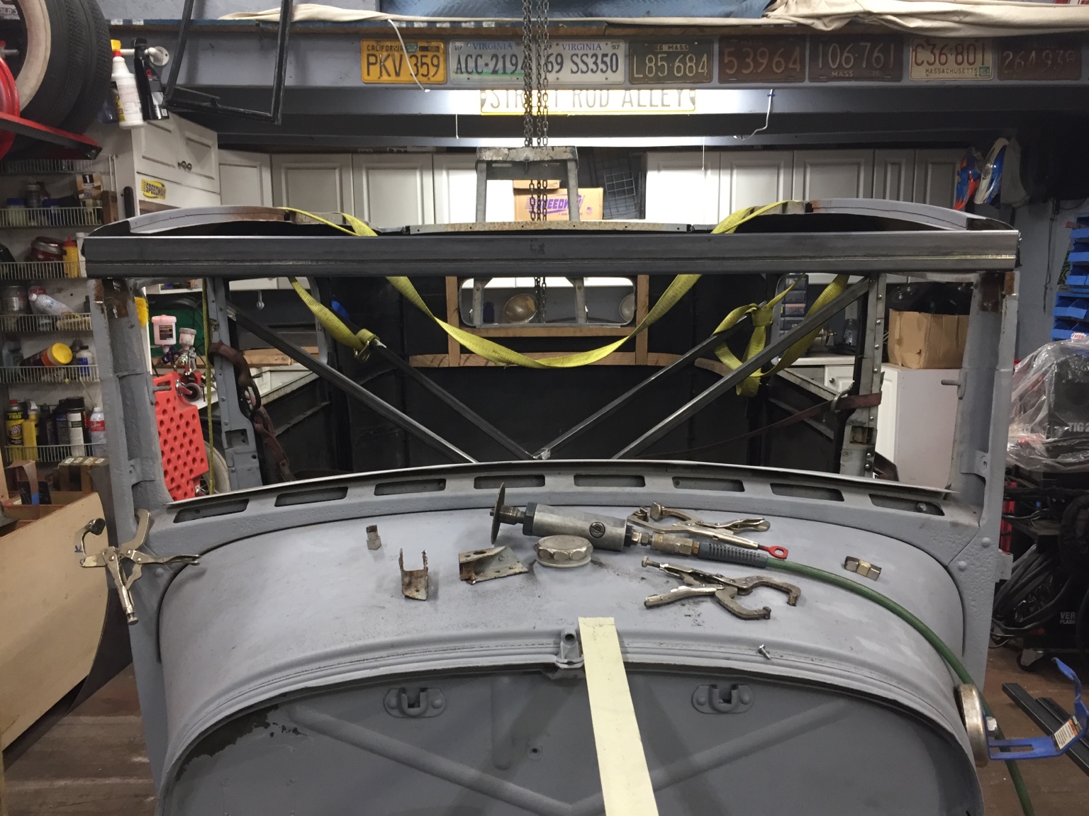

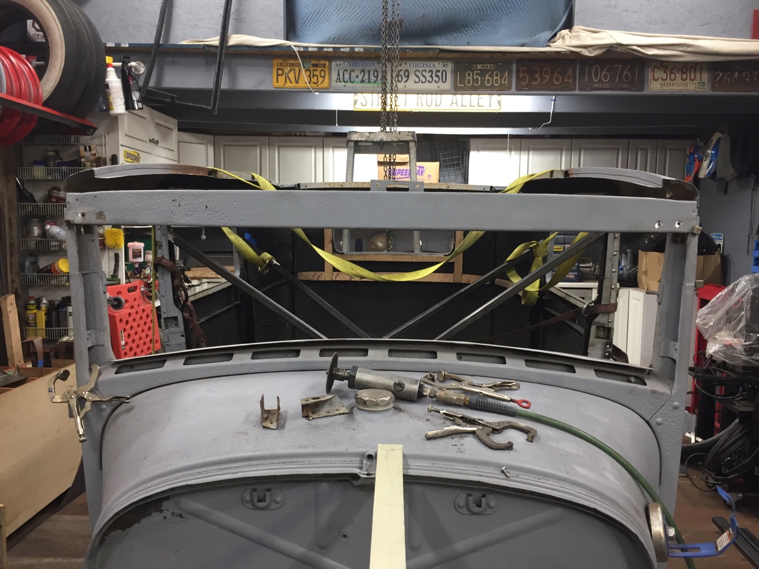

    Got the new header in tonight.
    14ga 1x2 box tube cut to length then scribed on the ends and boxed in.
    Removed the old one and made some changes to allow me to run a taller windshield.
    II know I spent a ton of money this year on tools and equipment for the garage. However it is amazing how smooth things go with the proper tools.
    It’s just positioned there. I’ll tack it on in the am. (Have a few small pinholes to fill in)
    Before
    During
    Far as I got tonight
    [​IMG][​IMG]
    Hope everyone has a great turkey day !

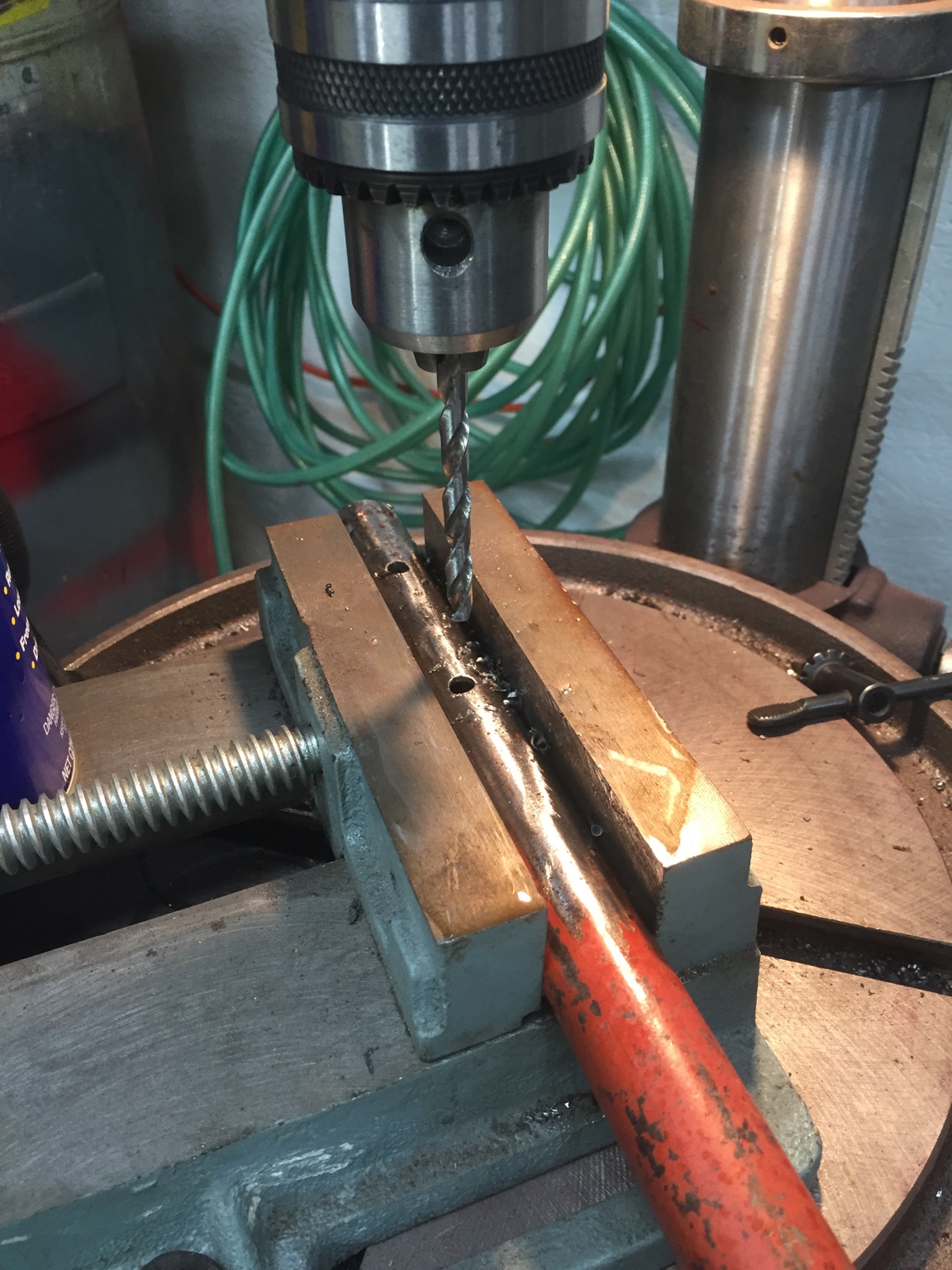

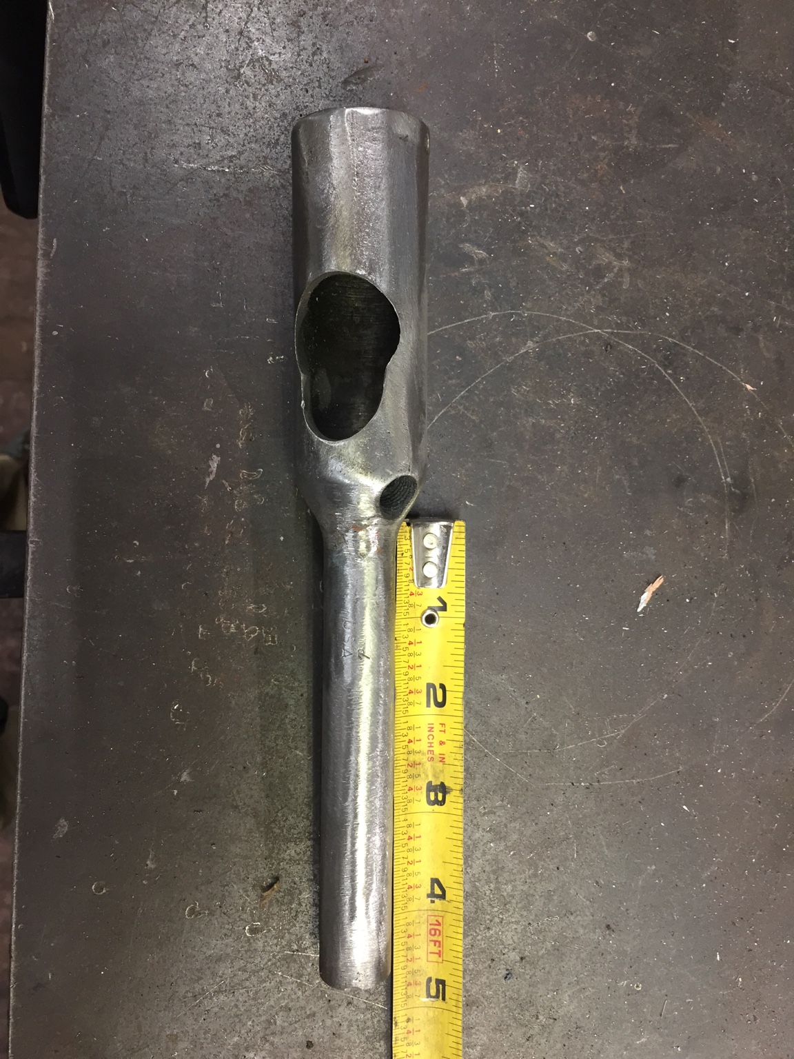

    Used a piece of 11/16 Dom rube and had 4-1/2“ of real estate to get 8 holes drilled for plug welds plus the end weld at the taper.
