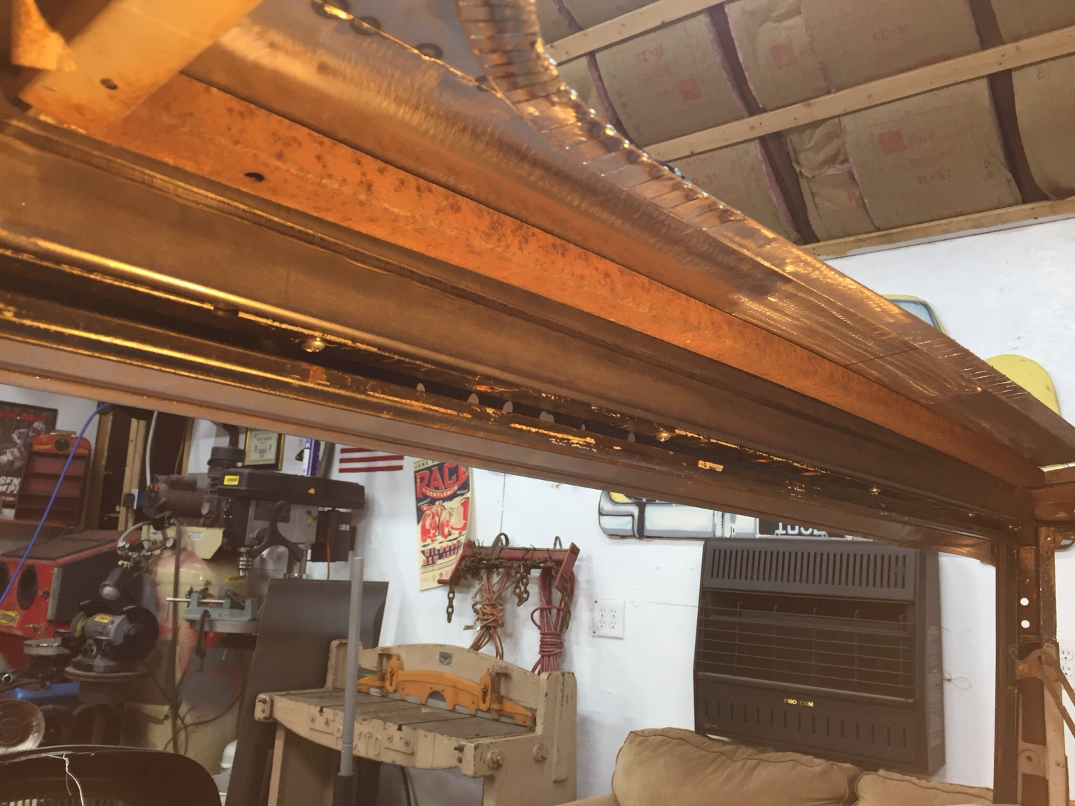

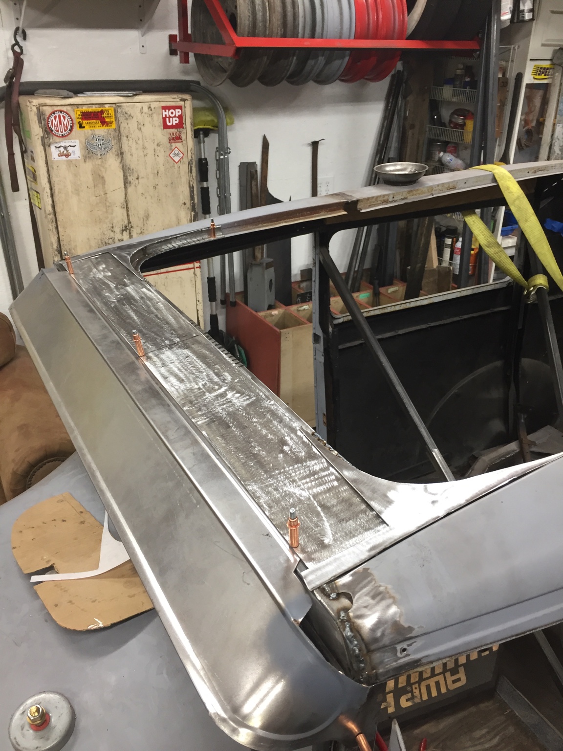

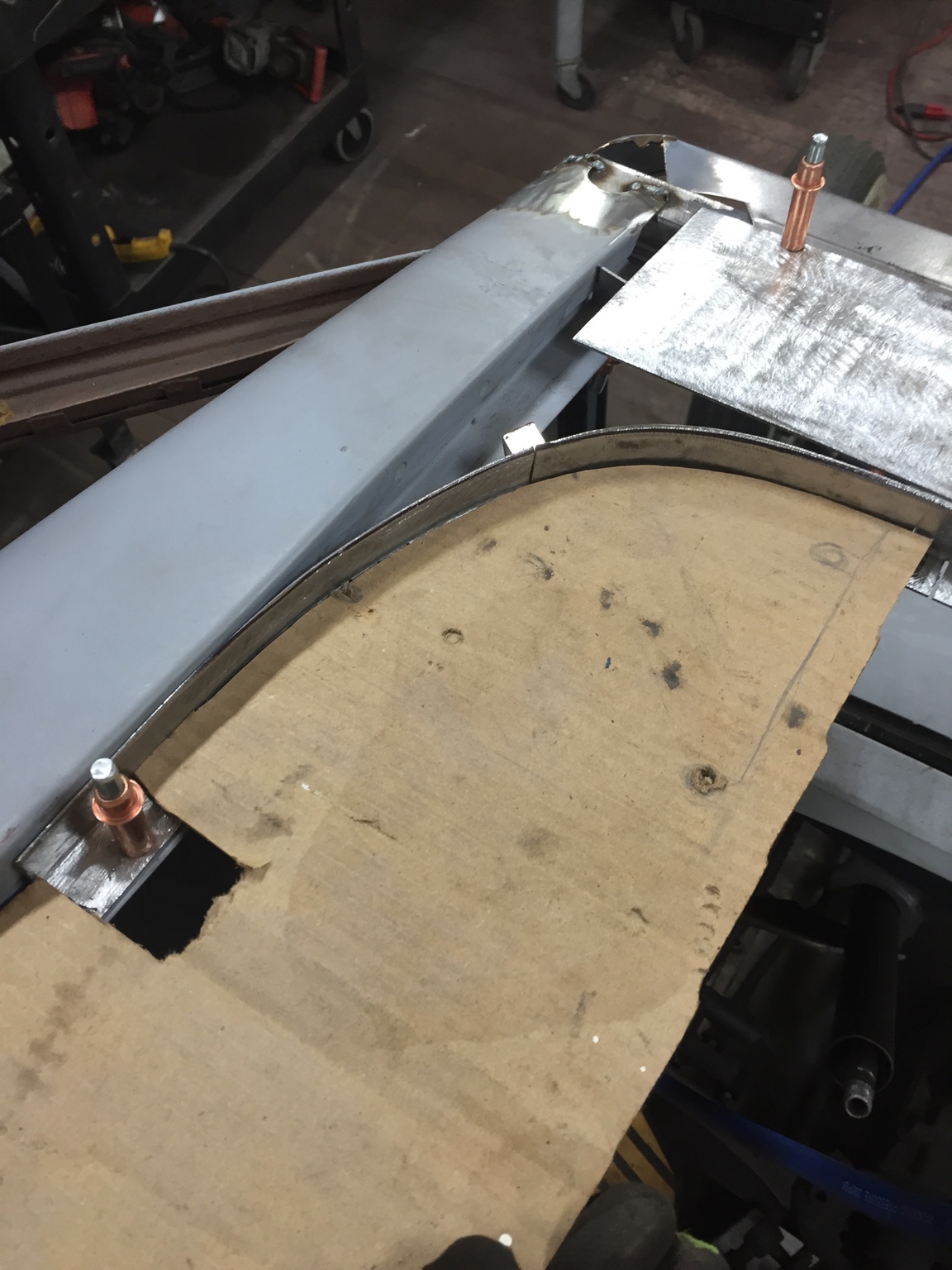

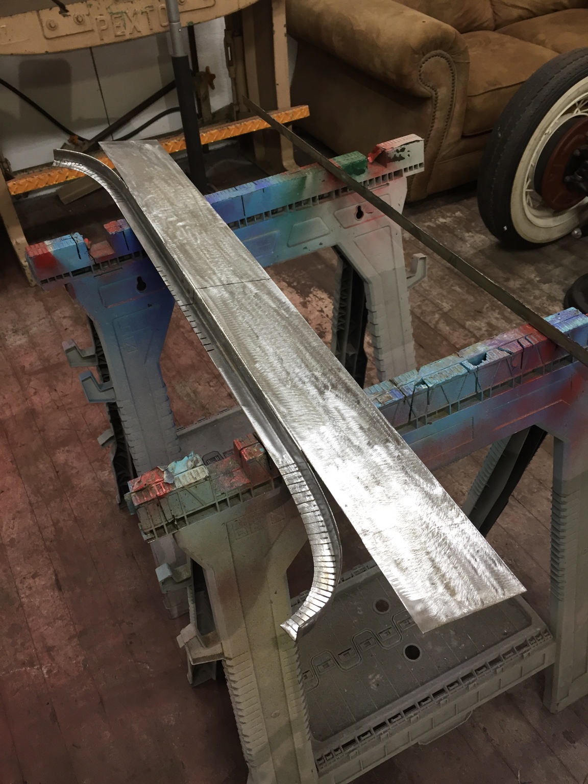

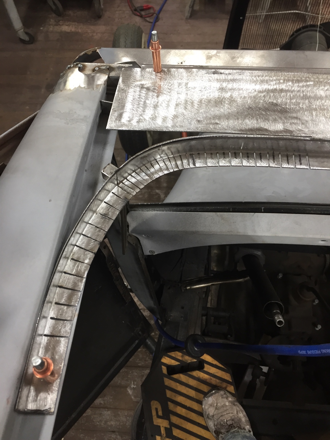

    In my brain I saw something smoother and rounded behind the new header.
    This is it, just in metal.

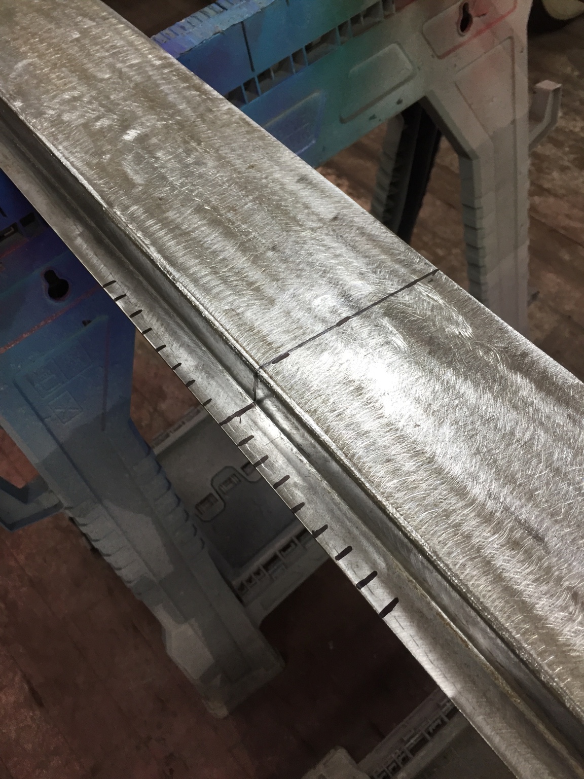

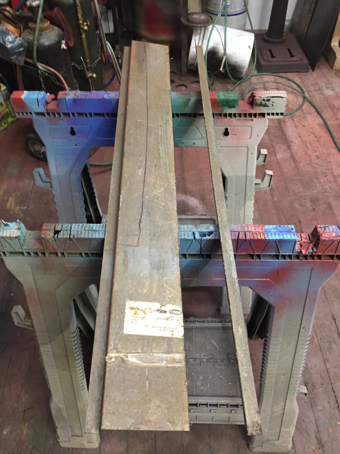

    I used a sub rail section I bought from a guy a few years back.
    Been hanging onto it not wanting to cut it up. Until now. It worked perfectly as the height of it fit the channel for the wooden roof rails.
    Lot of cuts to make the sweep I needed
    [​IMG][​IMG]

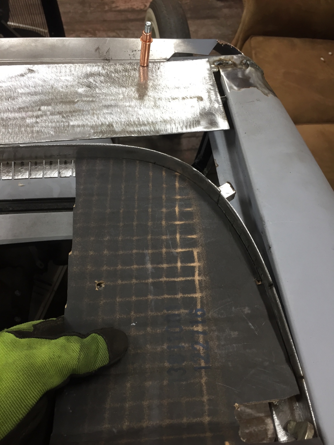

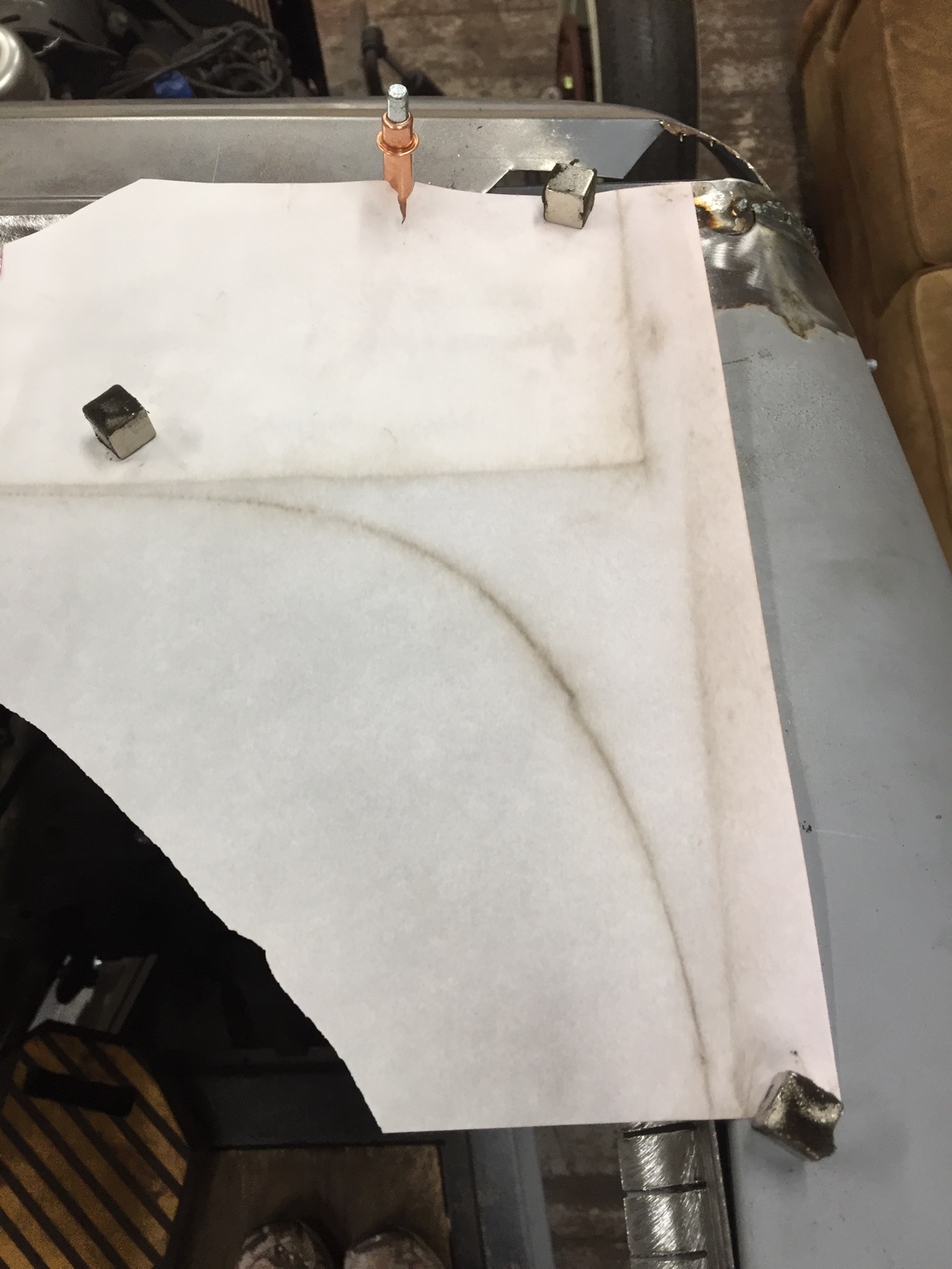

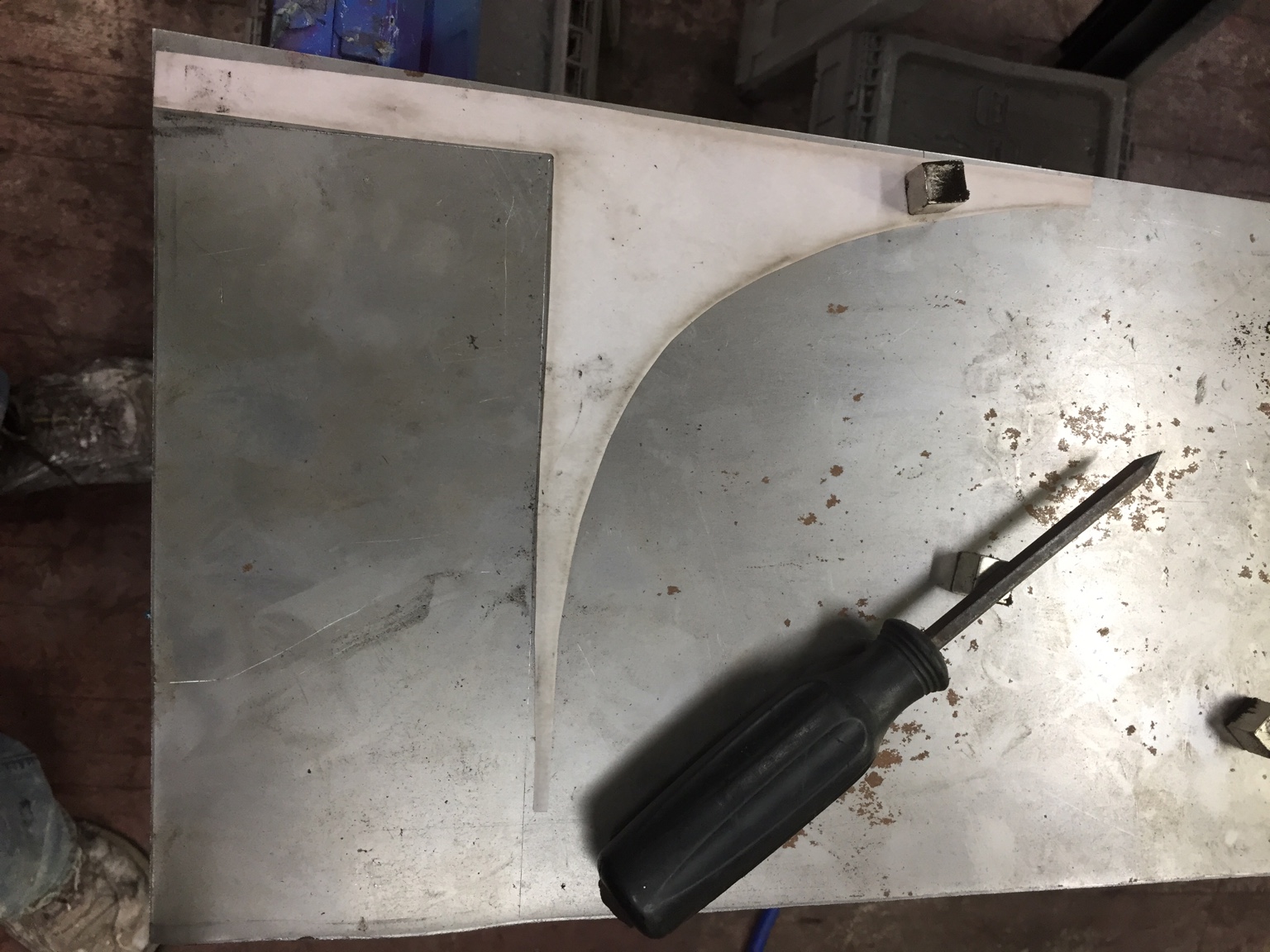

    I made this pattern off the back panel of the sedan roof.
    I couldn’t get the right sweep it had so I had to open the radius up a bit.
    Made it work then flipped it for the p*** side
    [​IMG][​IMG]
    Dirty glove trick
    Transferred it to sheetmetal. I tacked two pieces together and cut them the same time to make life easy.
    I now have some protection for the dash if I ever get caught in the rain w no roof.
    I plan to run a removable panel for the hot days.
    Fillers are sitting in place, I’ll get them fitted soon then attach everything together.

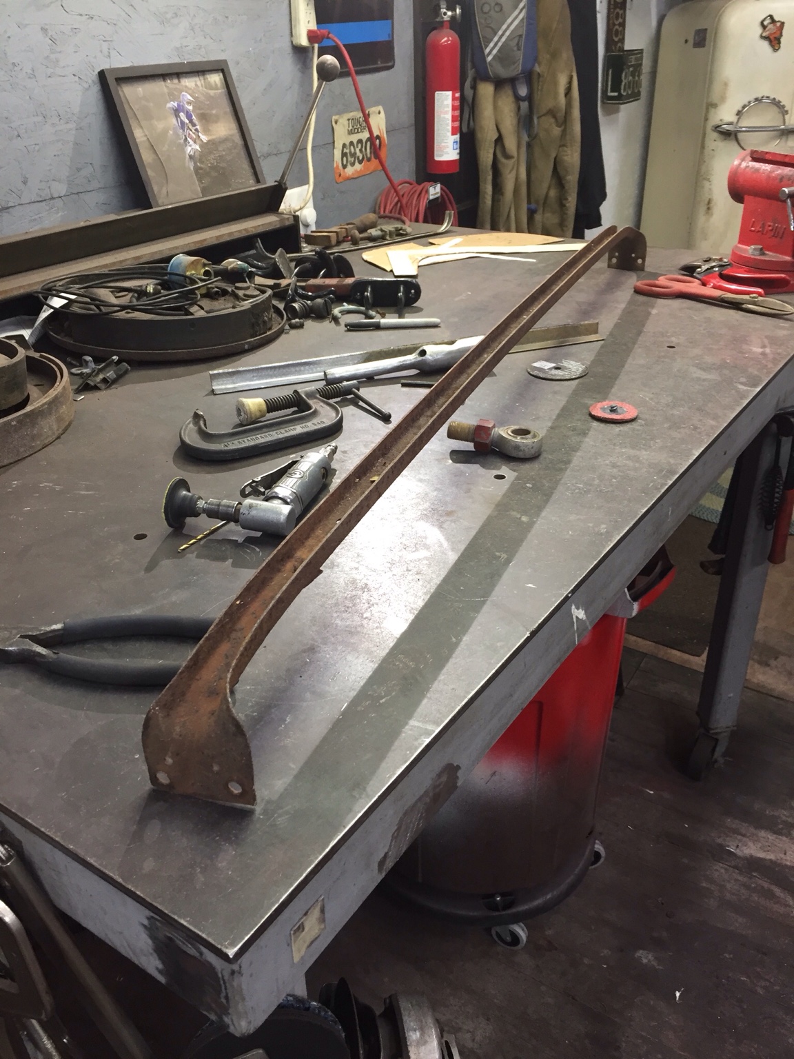

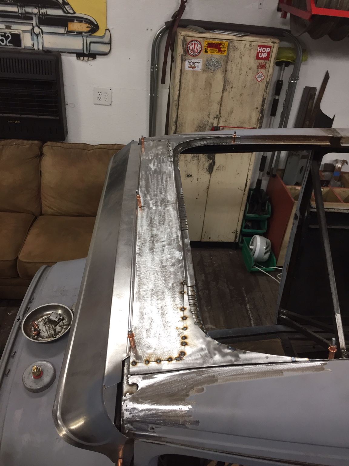

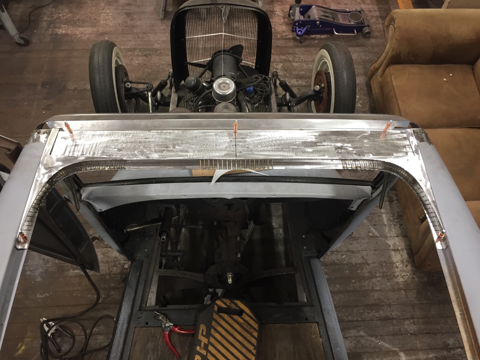

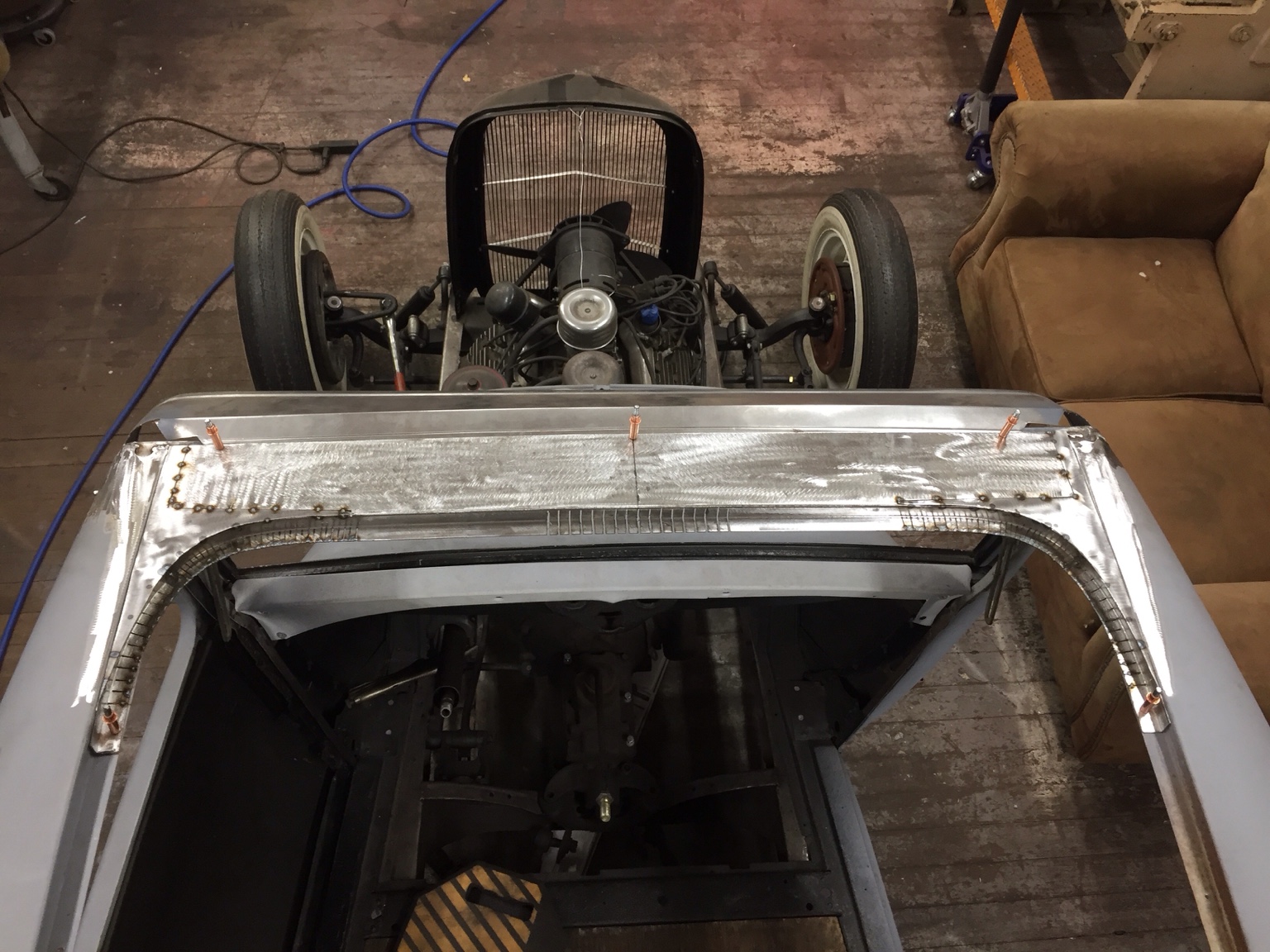

    Wasn't sure how to get the right shape to the visor/new roof panel. I remembered I had an extra metal roof bow in my parts pile. Cut it to fit inside under the new panel just behind the header. Gave me the exact shape I needed then got everything clamped/cleco'ed in place and tacked everything together.
    I like it.

    You’re saying this before you weld and grind and then blend all those slices, correct?
    Just giving you a hard time- it looks great! Reminds me of B***’ car but he had the front section filled because he grafted in a 34 (I think) front windshield. I love the look as well as the execution of what you are doing though- pretty much defines ‘hotrodding’!
    BTW, someone does make a ‘easy grind’ mig wire. I’ve been meaning to check it out. Would make your job easier if it worked.
    biggeorge and Mikel50 like this.

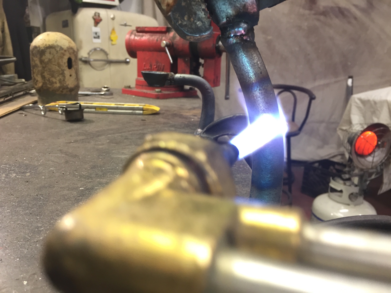

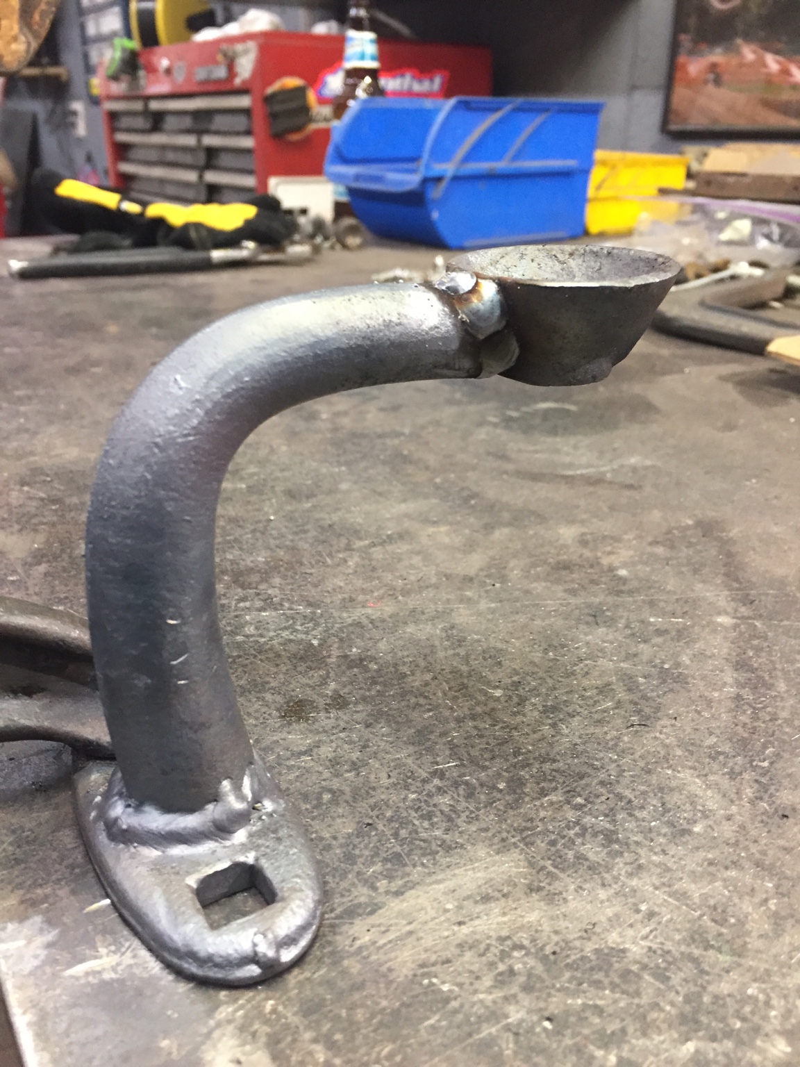

    I messed around with a set of torches from my father for almost an entire week. For the life of me I could not get them to work right, so I finally put them to the side borrowed a brand new set from my brother cut, welded, heated and bent up my headlight stands till I was happy.
    [​IMG][​IMG][​IMG]

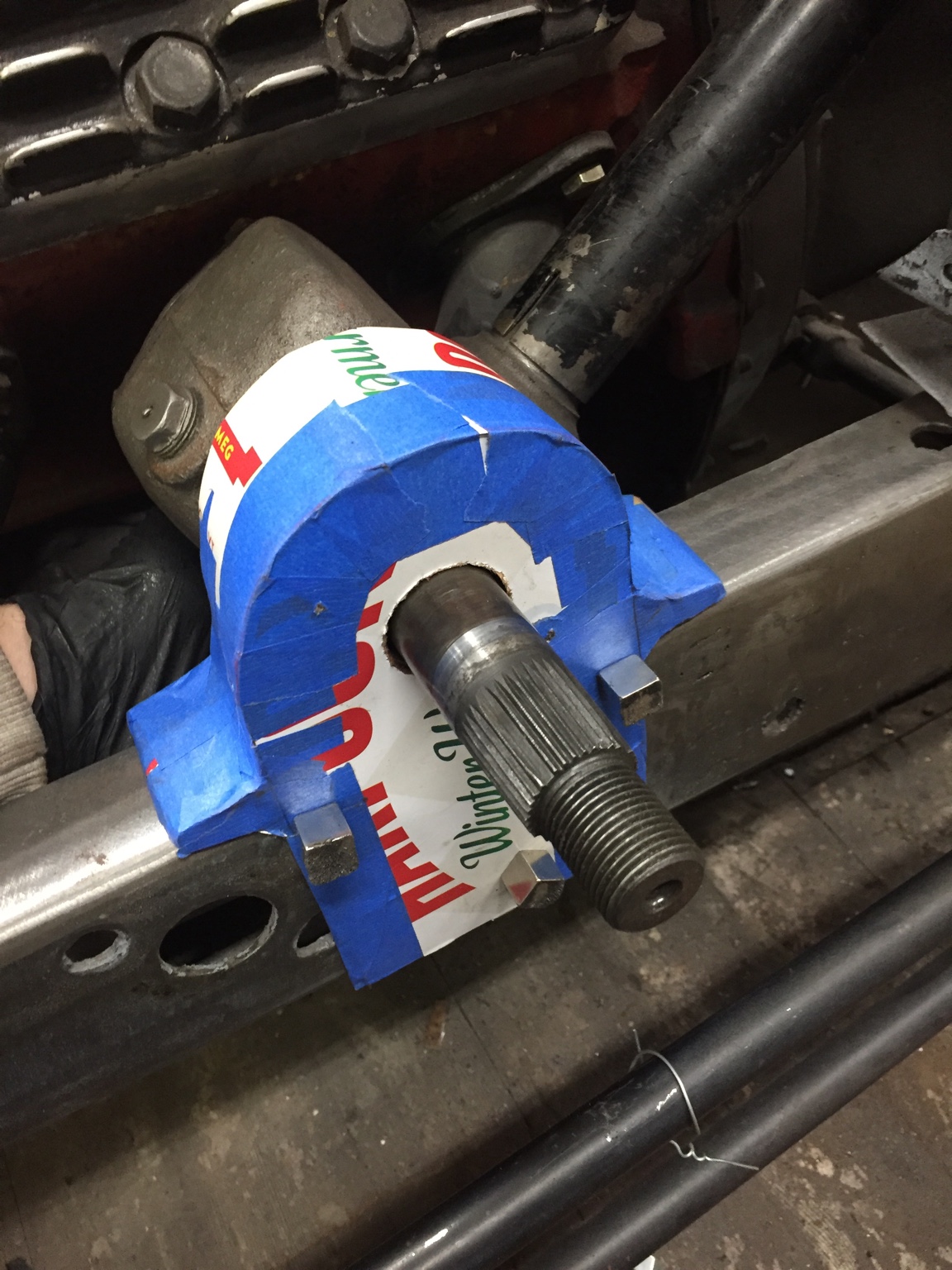

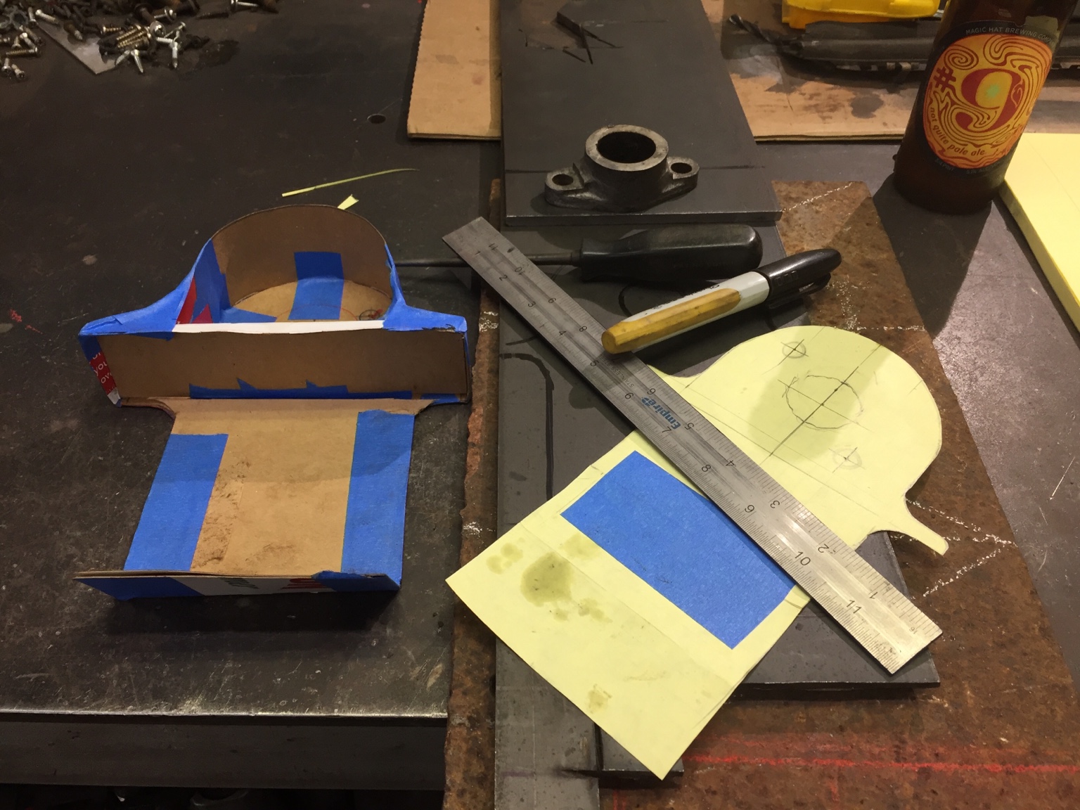

    I’m now getting the steering box mounted, not exactly the way I had planned however. The hairpins I’m running are long and they’re interfering with the Pitman arm and drag link location.
    So this is my answer to that ...
    [​IMG][​IMG][​IMG]
    It makes everything fit with almost zero modifications.
    Minus actually building the mount.
    After staring at this all last night I decided to change the final design and eliminate the plate going down the outside of the frame.
    I’m going to make it mount to the top and inside of the frame instead.
    I want it to have that clean look I’m going for.
    To be continued ...
