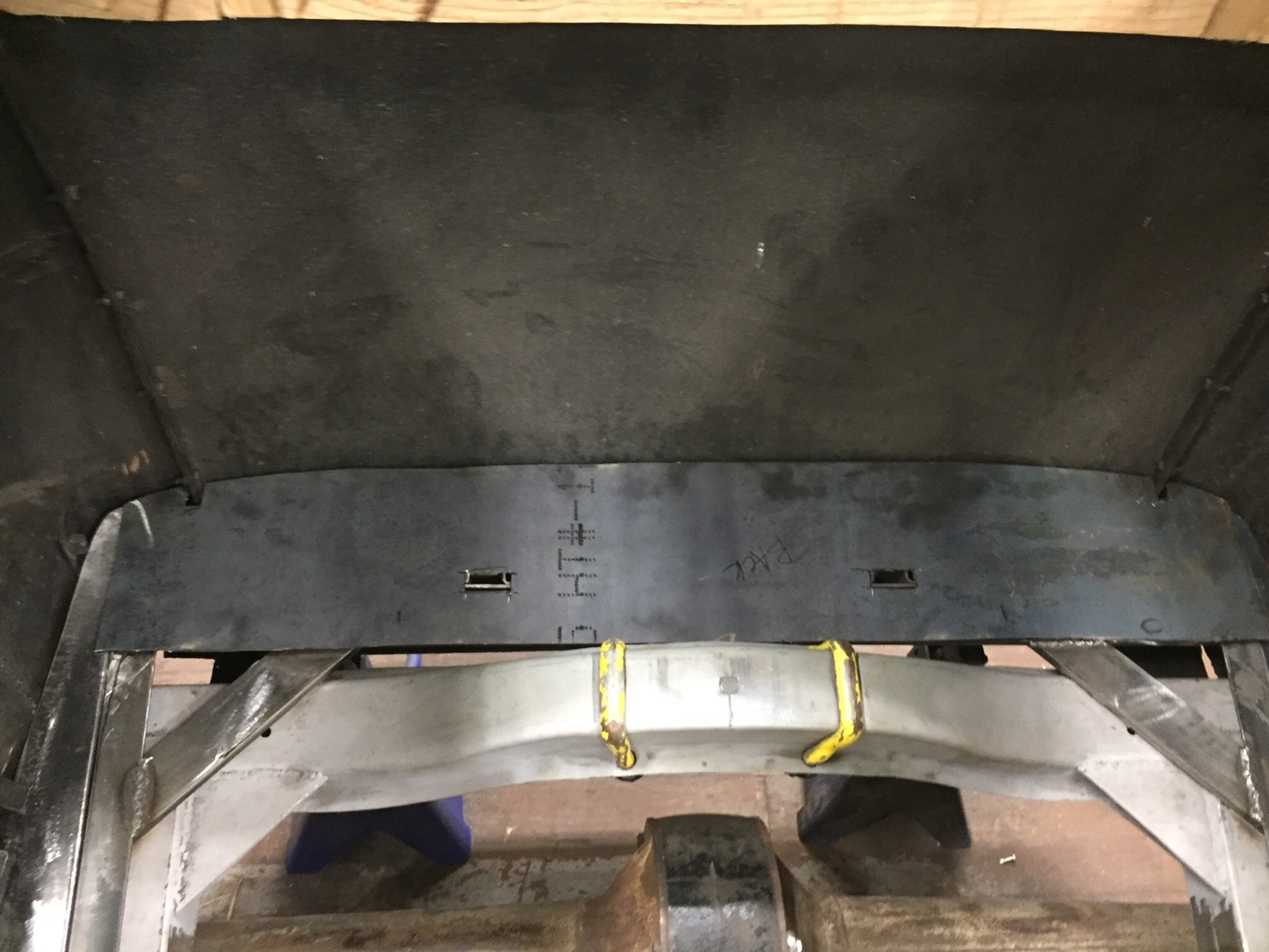

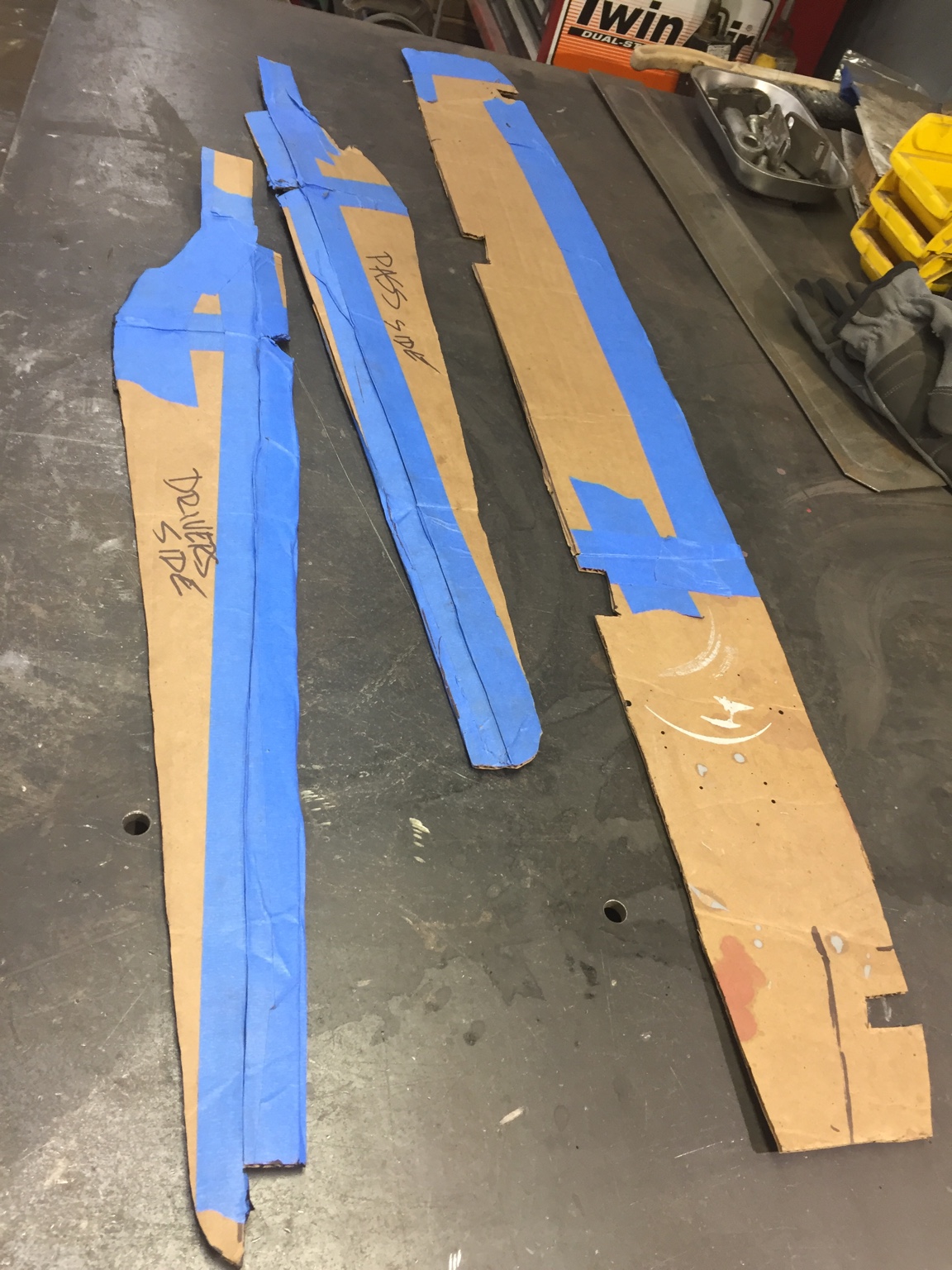

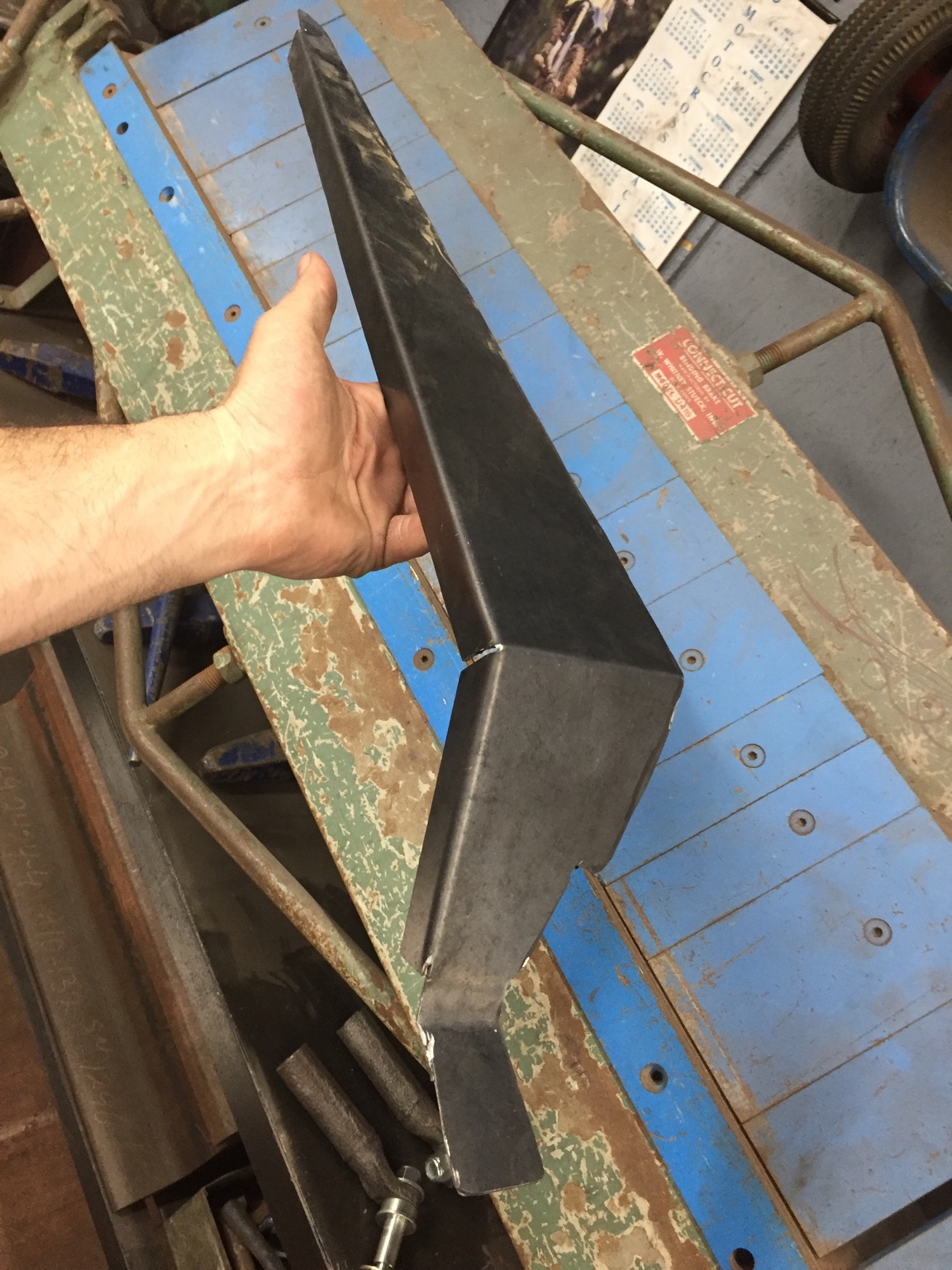

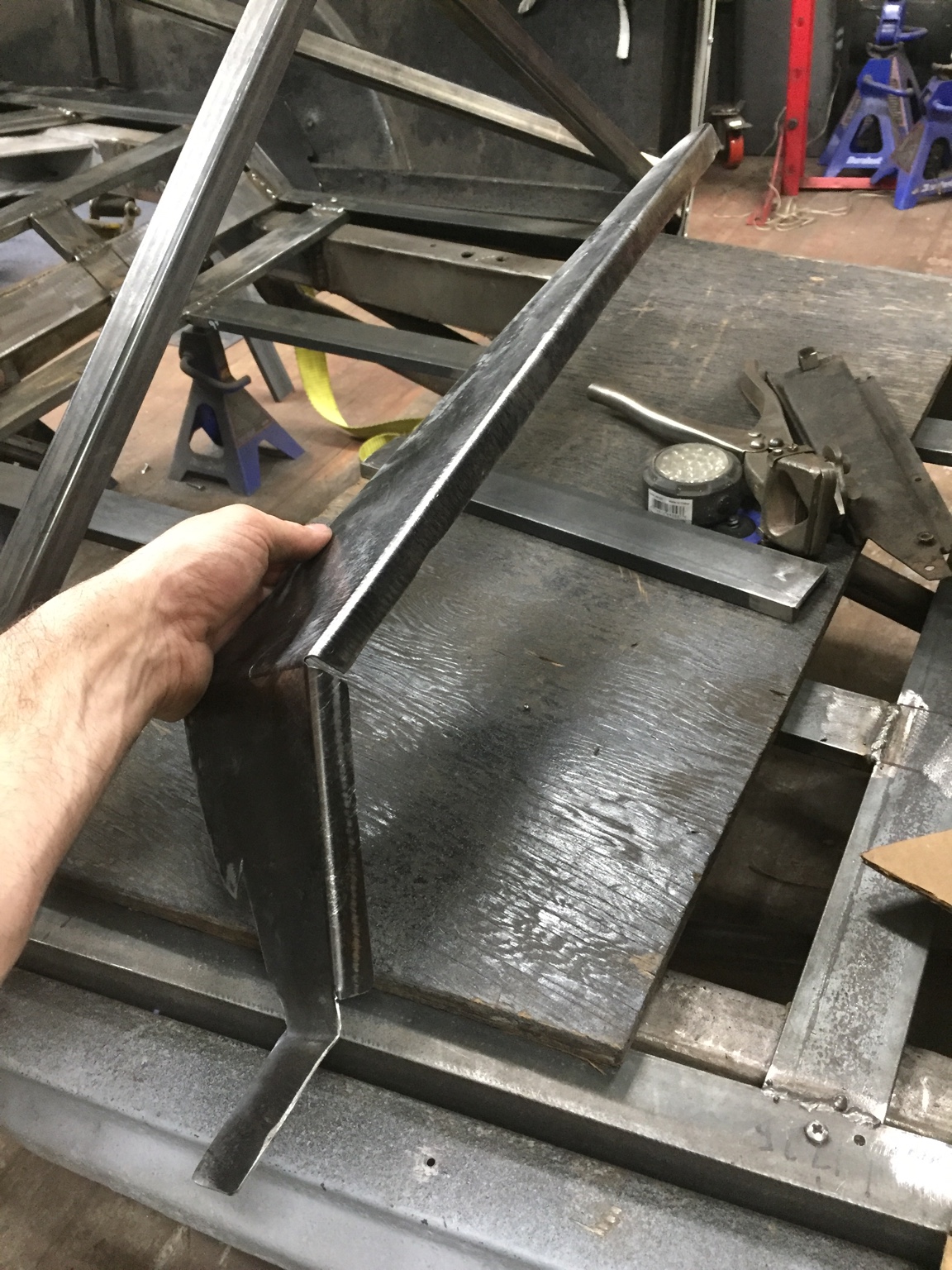

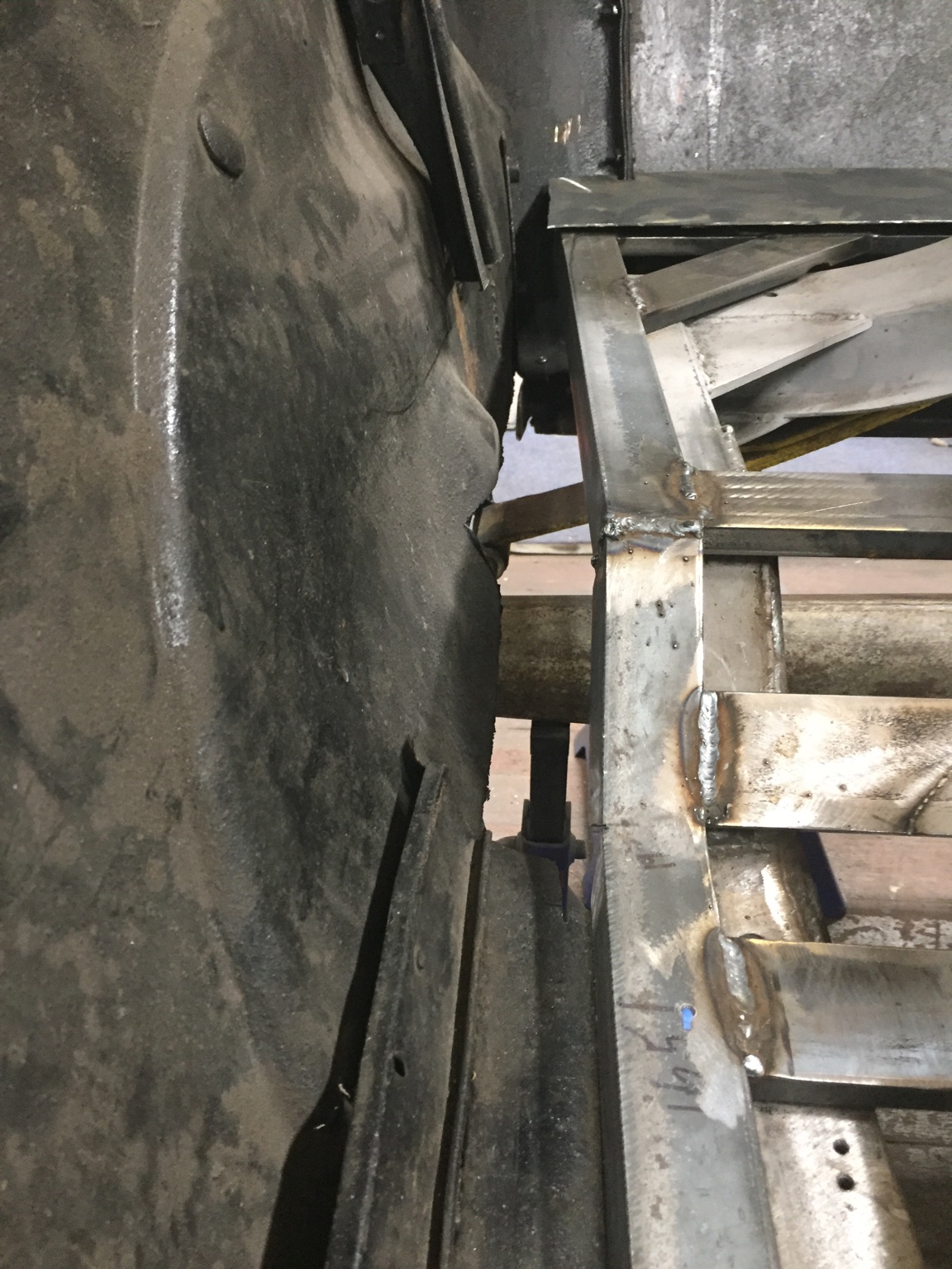

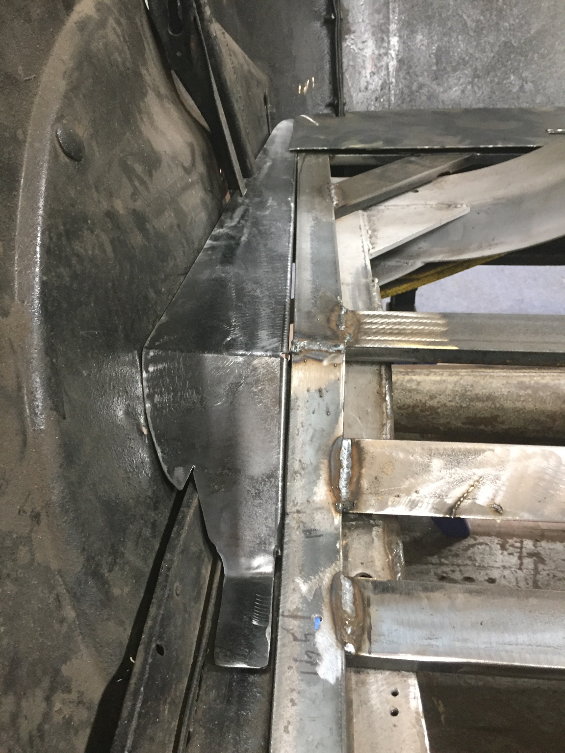

    Got some work done on my SubRail section at the rear frame step.
    These pieces are essentially the new rear section of my subrail that will connect directly to the inside of the rear quarters.
    I will seam seal the once they’re installed and be able to self tap screw or weld them to the new floor structure once everything is mated.
    Amazing what good tools will allow you to accomplish in short time.
    My templates
    Drivers side filler
    P***enger side filler
    Removed Drivers side subrail filler section
    Removed P***enger side subrail filler section
    Drivers side subrail filler dry fit [​IMG]
    P***enger side filler dry fit [​IMG]
    The rear filler just dry fit also, this will be the base/floor for my fuel tank. I relieved the areas of the gussets to act as possible chases for wiring or anything else I may need them for.
    I cannot mount this until the floor structure is installed and I proceed with the floor itself.
    I read about two years ago on a thread (I wish I could remember which one) a H.A.M.B. member said
    “Remember this, If you can make something out of cardboard, you can make it out of metal.”
    That has resinated with me and I often find myself repeating it in my mind while working on my car.
    Thank you to whoever spoke those words ![emoji1360]

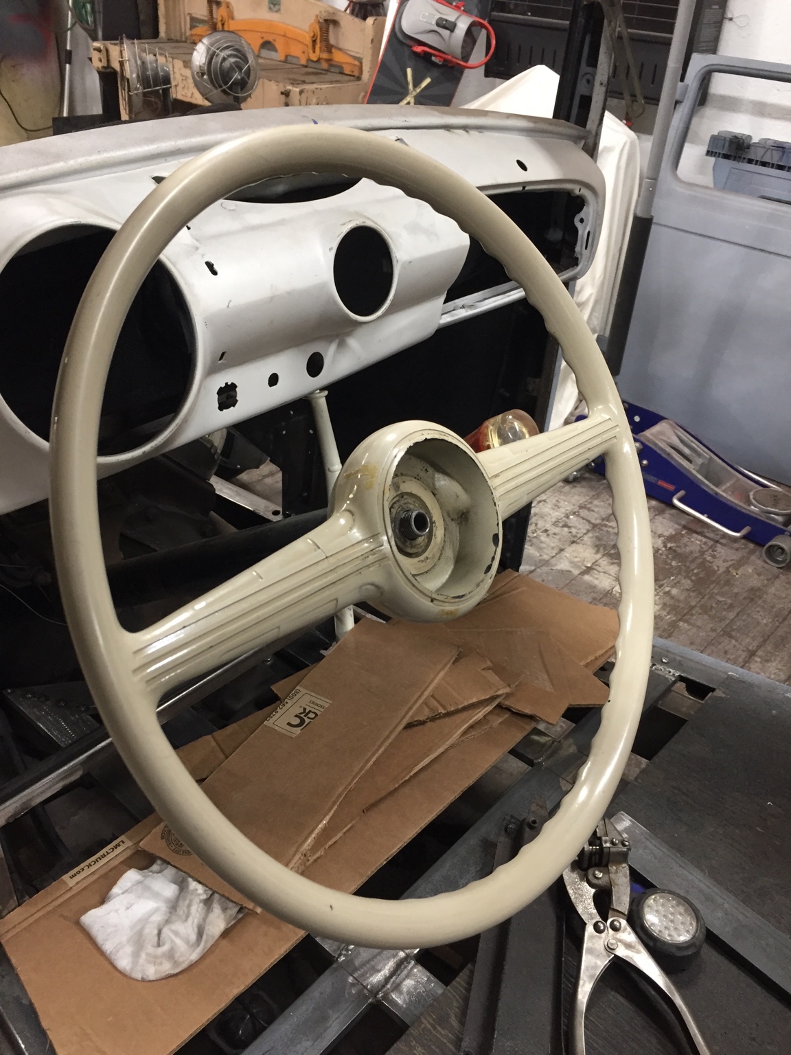

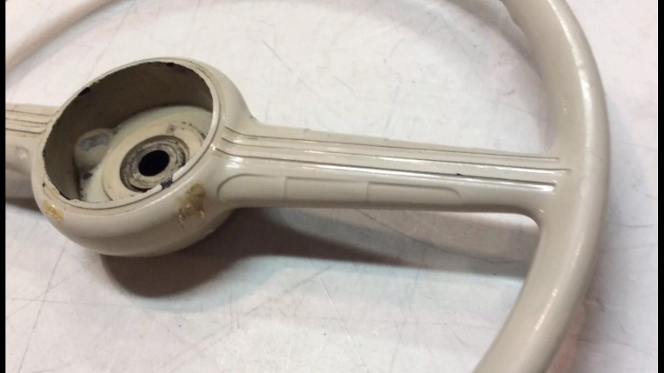

    Out of Curiosity, anyone keen on what this wheel belonged too ?
    It’s 17” and has a 3/4” splined mount.
    Fit perfectly on my F1 Steering shaft. [emoji1362]
    Makes no difference really, because I like it.
    Just curious.
    Thanks.
    Mike L.

  7. Duellym
    Joined: Feb 28, 2016
    Posts: 358
    Duellym
    Lincoln wheel maybe?

    I’ve looked but haven’t found anything similar
    Here’s an additional photo [​IMG]
    Mike L.

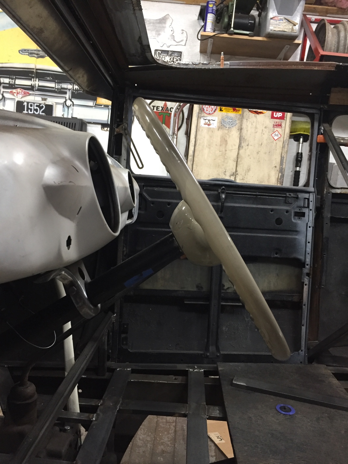

    Got the steering shaft cut down and welded true today. Shortened the column and got the wheel in place with the modified F1 drop.
    Wheel is 3” from the dash.
    Looks like I’ll have a good view of the gauges with the way it lined up.
    Hopefully the seat position will also fall into place.
    Mike L.

    Wheel looks great! How close is it to the door?
    Mikel50 and JOYFLEA like this.
  14. Mikel50
    Joined: Mar 30, 2015
    Posts: 1,113
    Mikel50
    Outer edge of the wheel is 5” from the inside panel of the door.
    Mike L.

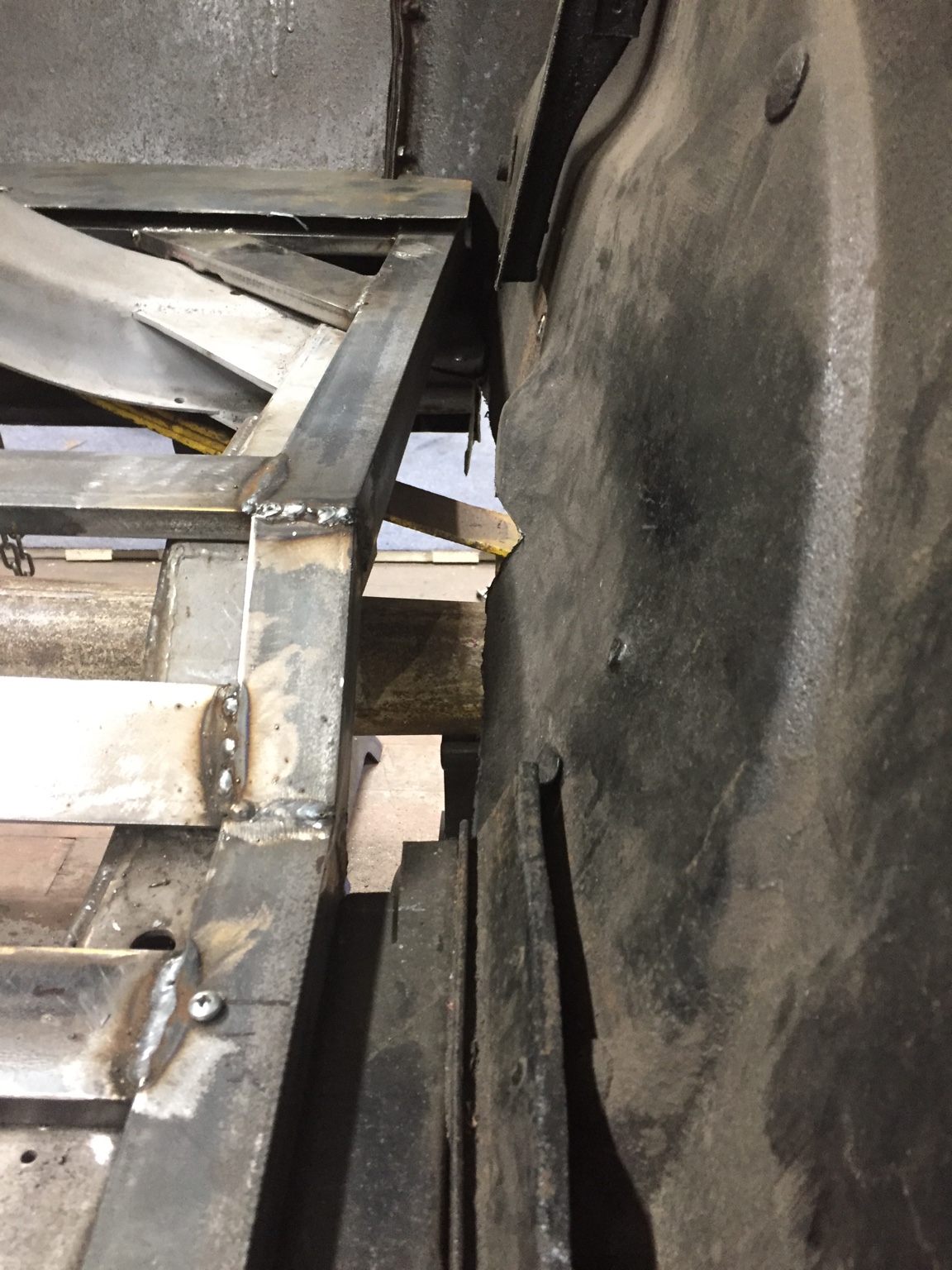

    Reworked the cowl feet after I wrapped up the wheel.
    Had to make them work with the channeled floor so I cut them in a few spots and added some pieces to make them work with the original rivet holes in the firewall and mount to the new floor structure.
    Now I can get to work on the toe panel area.
    Onward [emoji1371]

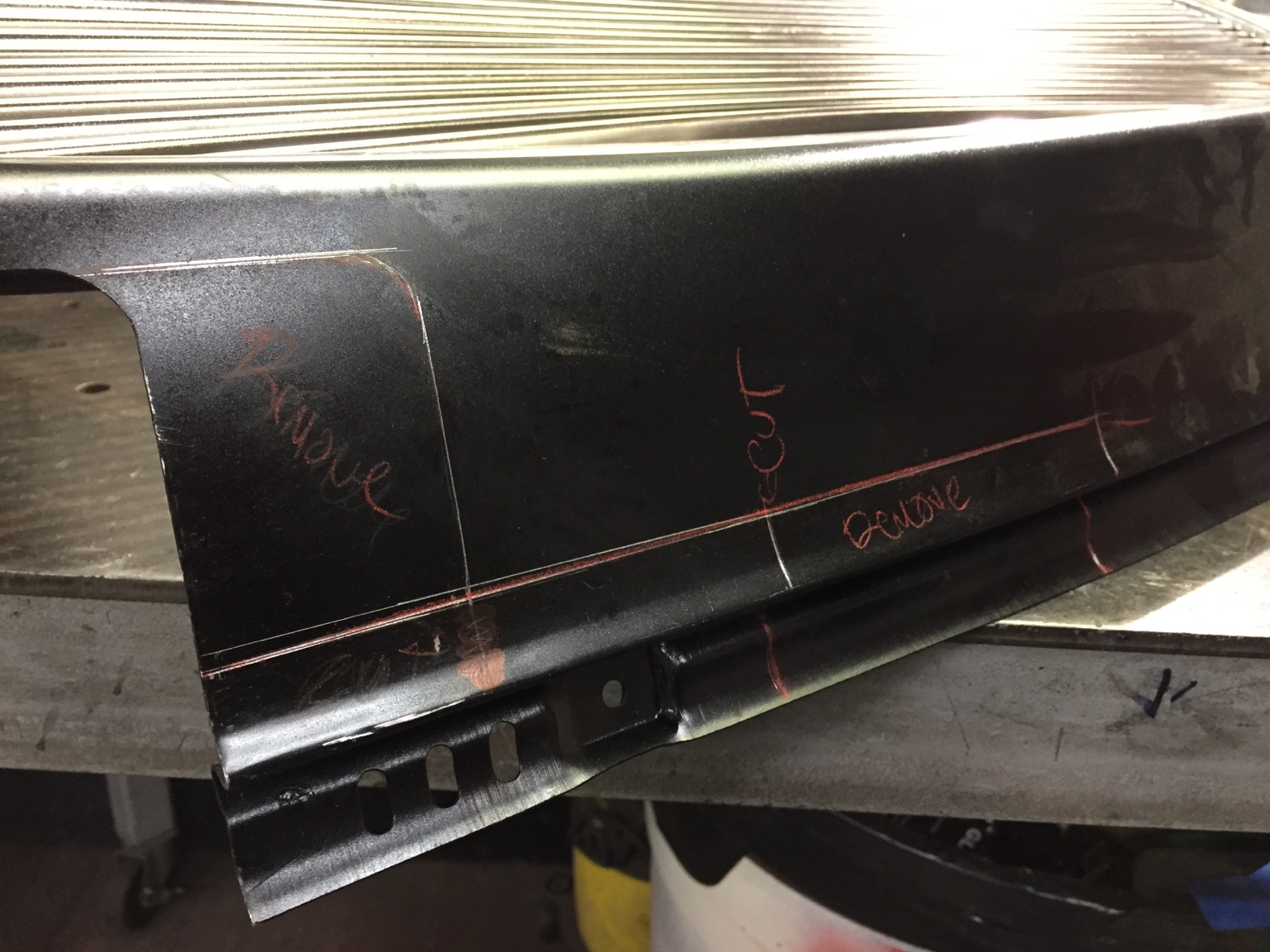

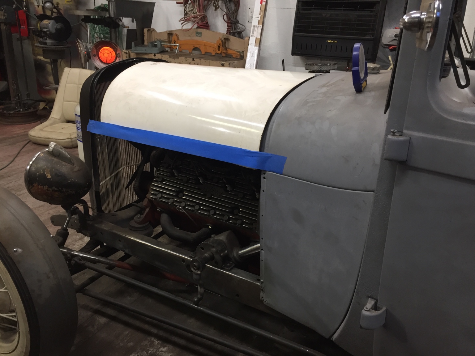

    Back at it ... cut down my Repop 32 shell to work with the 2” channel.
    According to my angle finder my hood as it sits would be at 3° which is what my frame is at at ride height.
    To me that makes sense ... anyone have any input on that number ?
    [​IMG][​IMG]
    Seems to flow smooth but not having a hood on it it’s kinda hard to tell.
    Thanks
    Mike L.
    brEad and JOYFLEA like this.
  19. sloppy jalopies
    Joined: Jun 29, 2015
    Posts: 5,256
    sloppy jalopies
    The hood will have a little more rake than the beltline...
    the test ;
    Set a stock hood on a big table, block it so the rear top looks right L TO R, and the bottom edge flat on the table...
    with even blocking under the F and R hinge rod you should see how much rake is built into the hood... decrease the front blocking till the top looks right....
    the difference in the F and R blocking is how much rake is needed...HIH...

  21. tb33anda3rd
    Joined: Oct 8, 2010
    Posts: 17,583
    tb33anda3rd
    if you are doing it without a hood, err on the low side. you can always shim up.
    Mikel50 likes this.
  22. Dick Stevens
    Joined: Aug 7, 2012
    Posts: 4,123
    Dick Stevens
    It is always better to be a little low than a little high with the grille shell!
    Mikel50 and tb33anda3rd like this.
  23. Mikel50
    Posts: 1,113
    Mikel50
    Thanks guys.
    Makes perfect sense.
    I’ll hold off fitting the lower sections for the lower bolts to the radiator and shell band until I have the radiator.
    I want to get the chopped 32 radiator on order so I wanted to get the grill shell where it needs to be.
    Hoping the standard 2” chopped radiator fits as it comes.
    I’m prepared to have one modified if needed.
    Mike L.

  25. Mikel50
    Posts: 1,113
    Mikel50
    I forget sometimes the things I have kicking around ... forgot I had a fibergl*** hood that came with my car.
    [​IMG]at this position the shell has to come down 1/2”
    Not sure the length of the stock hood but looks like I may need to extend it a few inches.
    Onward [emoji1371]
    Mike L.
    JOYFLEA likes this.

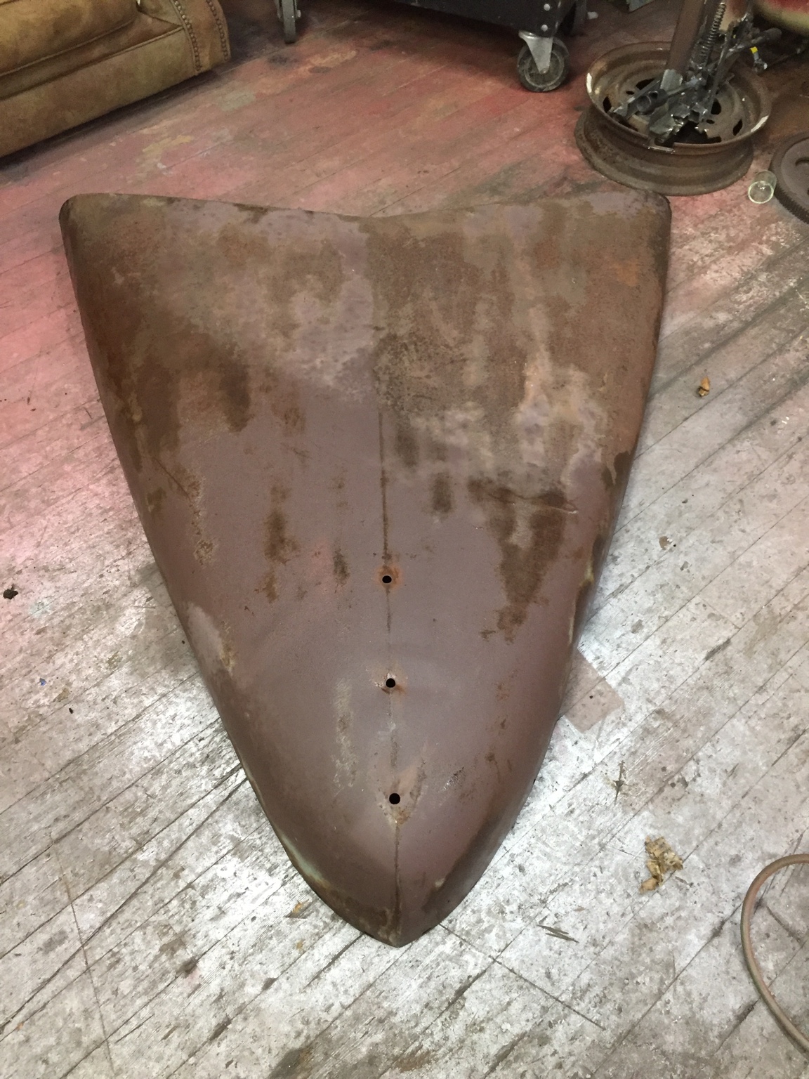

    Wonder what I can do with this ... feeebie hood from a friend. He thought it was from a Nash. It’s for a Model A. [emoji1362][emoji16][​IMG]

  29. patmanta
    Joined: May 10, 2011
    Posts: 3,882
    patmanta
    from Woburn, MA
    You can trade it to me so I can hoard it for years and eventually build another salt nosed car around it.
    tb33anda3rd and Mikel50 like this.
  30. Mikel50
    Posts: 1,113
    Mikel50
    Guess what I need ... I looked at it for 2 minutes and said nope. I don’t need another huge project. I’ll buy one. It’s all yours Pat.
