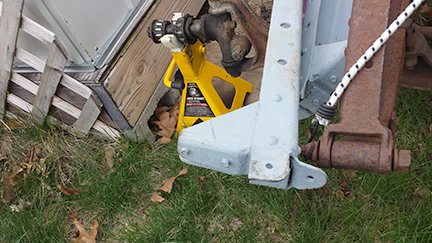

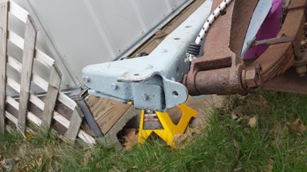

    I also took these photos to show the "twist" as I called it in the center portion of the frame rails.
    The frame is dead level and the square is plumb according to the level bubble
    This is what I've got ImageUploadedByH.A.M.B.1429742859.347675.jpg P*** side
    Drivers side.

    This picture is more accurate I took two because I moved the first time (the 1st pic of the p*** side)

    I would try fixing the kink in the frame, and fix up the rear crossmember.
    The rest ain't that bad, because there are frames that are even worse out and driving on the road. Measurement more out of wag the 1/2 inch, I would fix. Less then that would I leave alone, and just make sure that the alignments of wheels/hubs/axels/track are with in best possible tolerances.

    Ok, I think the twist is from the plates that are acting as your center crossmembers. I suspect that if you grind those welds out from the rails, your top rail will be able to come in line with the bottom of the rail again. It looks like they are tacked to the X member; I'd leave them connected to do this unless I was damn sure they would need to be removed completely or replaced with something else like a sectioned stock center crossmember.
    If it does, weld those plates back in once you get it squared back up (if they will fit).

    I have looked at it closely a few times and it appears they intended to squeeze the top of the rail in for whatever reason.
    Both top sides are exactly 1/2" in and there is plenty of stock past the weld on both plates on both sides (tucked under the top rail ) to weld to if I were to put the top rails back in square.
    I intend on leaving the plates welded to the X member because they look really good and see no reason to change them. The real sketchy welds are at the 4 corners of the X member at the frame so I'll address those after I get the twist out of the frame.
    Other than that it comes down to cleaning up the ream crossmember and sending it out to the blaster.
    I'll post pictures as I go.
    Thank you for helping solidify my decision.

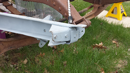

    The welds on the tops of the X member look fine, but the underside raises an eyebrow. I'd have trouble leaving that alone. I think I'd need to fabricate some pieces to clean that up personally.
    I am not sure I know what's going on there of if that janky looking piece is providing any structure.
    As for your rear crossmember, I think I'd be inclined to add a gusset from the top rail to it. I don't think those stick welds are going anywhere but a gusset would provide some structure it's missing with the way it was flame cut or stick blasted out. I'd add at least one to each side. You could also go so far as to square up the ends and make a plate to close the ends in and extend out onto the rail to tie the back of the crossmember in. From that you could run a horizontal gusset back in to mirror the stock brackets that it's now welded to the top of. I think this is how I'd do it.

    Exactly what you said about the X member were my thoughts. The tops look great but the underside is where the issues lie.
    The gussets at the rear member are a great idea and are definitely the way I'm going to go about it.

    I snapped some pictures of the back of a Model A rail I've got for reference. I figured it might help getting a good look at how the rear crossmember was attached at the factory. 7 rivets.

    Wow, that's what it's supposed to look like huh.
    I wish the rear section on my frame was that clean.
    Thank you for the reference pics.

    That's what it looks like with the crossmember removed entirely. I'd be cautious about breaking it down too much. Go slow and don't take too much off. Stop and think before and after each thing that comes off.

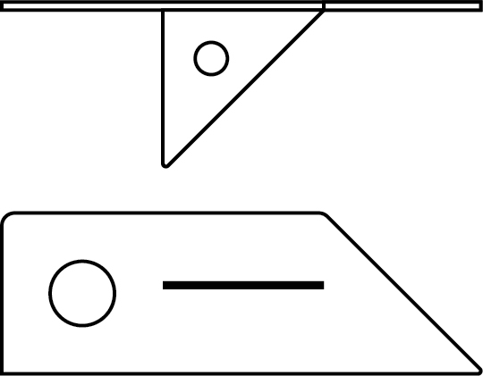

    I sketched up what I think the bracket to reinforce the rear crossmember should look like. I'm not sure if my redline and description really conveyed it (the holes are just a suggestion).

    I can't see where you wanna put it?

    Look at the bottom pic in #74

    Okay but is that two sides of the same item? Or two items, and the upper one goes on like the one from the post 74 pic
    And the lower one goes on with the small hole centered in the the big one, and welded all the way around?
    Because it should be possible to do a plate with a big hole that is centered over the big hole (on the x), and all the way up to rear cross member and has a top edge there raises 30*(ish) and goes to the cross member.
    Than make a plate like yours, that closes the end of the crossmember, and goes 30* down and ends up flat on the rail. And then you set a flat and square plate over the gap. And weld it on all four sides.
    Nice and flat, and easy to adapt to the body.
    Can you paint that in the pic, with red lines and some solid color?

    That is a side and top view of one piece.
    Ignore the holes, they're not part of the function.
    This is just a simple plate that would box up the open ends of the cut crossmember and connect it better to the remaining crossmember and to the frame.
