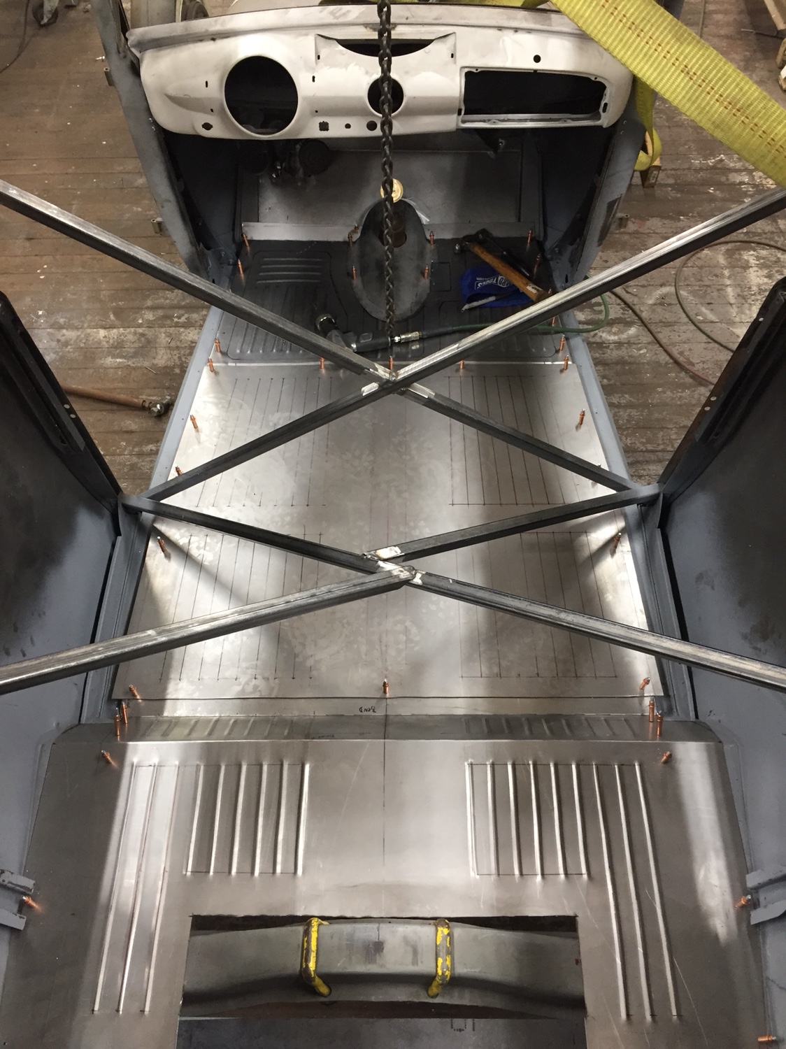

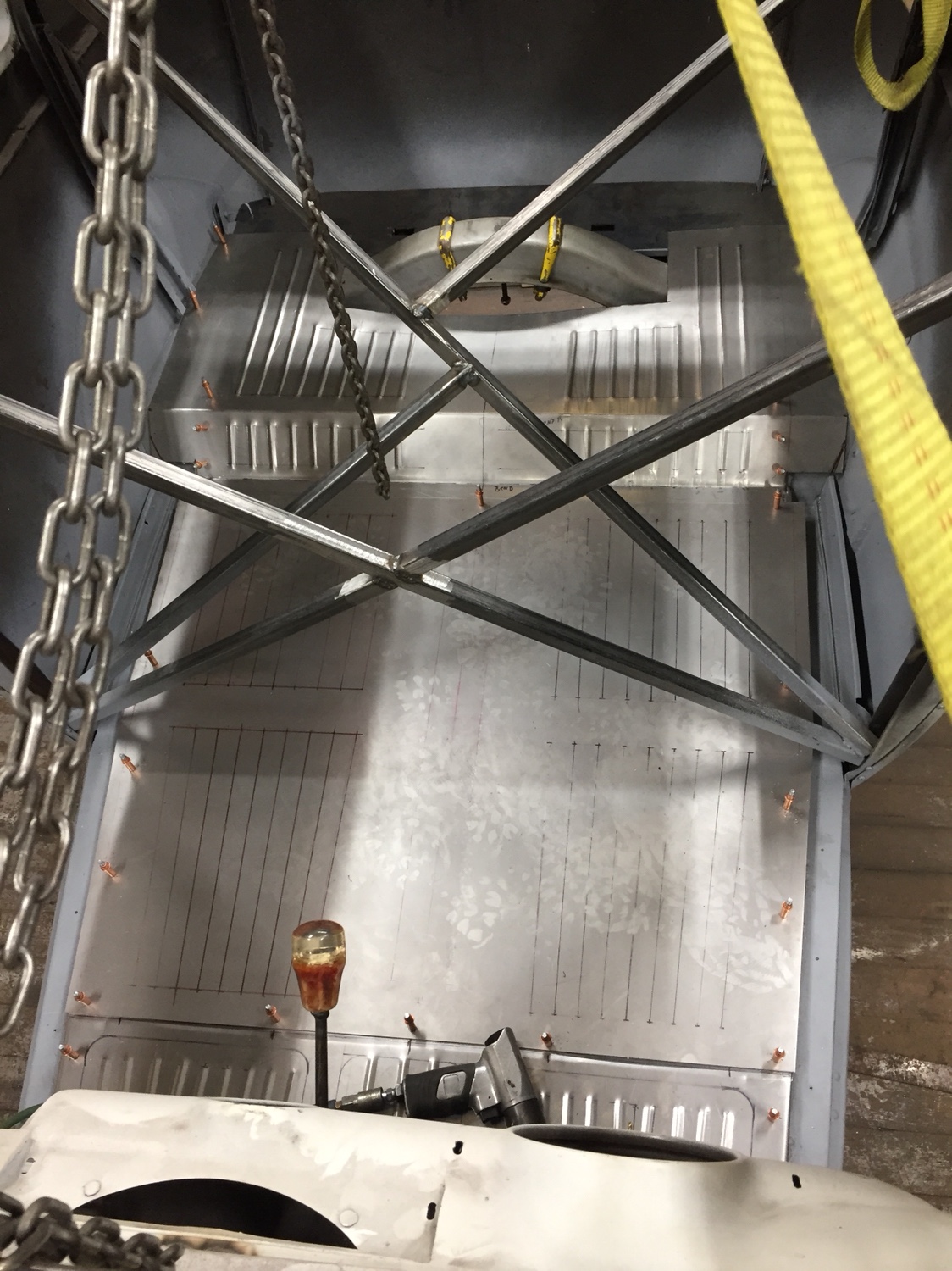

    Thursday Nights mission was to remove what I needed to get the body off and access the subrails.
    When I built it the way I did, in my brain I figured it would work ... it did. Perfectly !!
    Up it went with no issues. It’s really tight to the orig subrail sections I left. I had to pry it apart while hoisting the body off.
    So I’m hoping it welds together as good as it came apart.
    It should.
    Added some additional supports under the channel to stiffen up the floor in the seating areas.
    Made a huge difference and it doesn’t affect anything regarding the height of the floor.
    All cleaned up and welded completely.
    Started cleaning the inside of the body to get the subrails attached to it at the rear kick.
    I’m going to fabricate mounting brackets at the rearest most fender holes on the quarters. It should work great as the fillers fit perfectly between them.
    Feel like this is a big step. Hoping to have the subrails and inside the body in sealer by the end of the weekend to avoid rusting up.

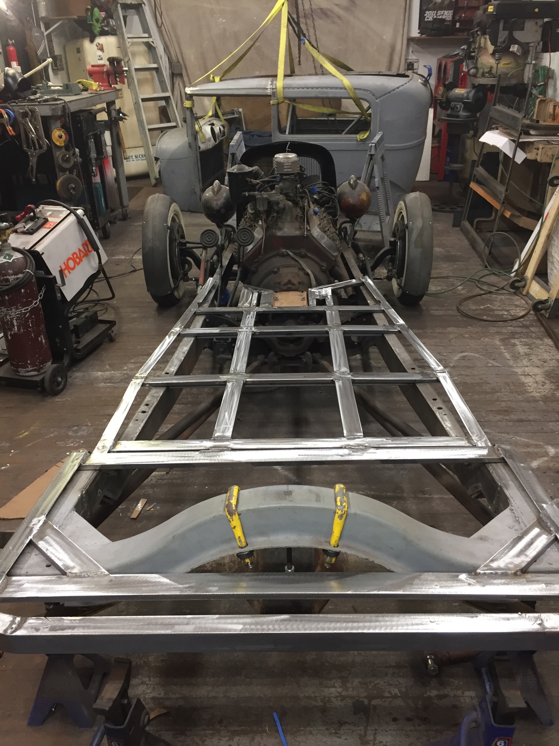

    Short work day equals time in the garage today.
    Cleaned up the remainder of the sub rail still connected to the body of the car, got everything in line back on the ch***is and welded the new floor and the body together.
    Once it was all set I hoisted it back off to make life easier.
    Feel pretty good about it. It went back together perfectly. I got to work on my rear subrail mount to get things ****oned up before sealer. [emoji16][emoji1360]
    Onward [emoji1371]

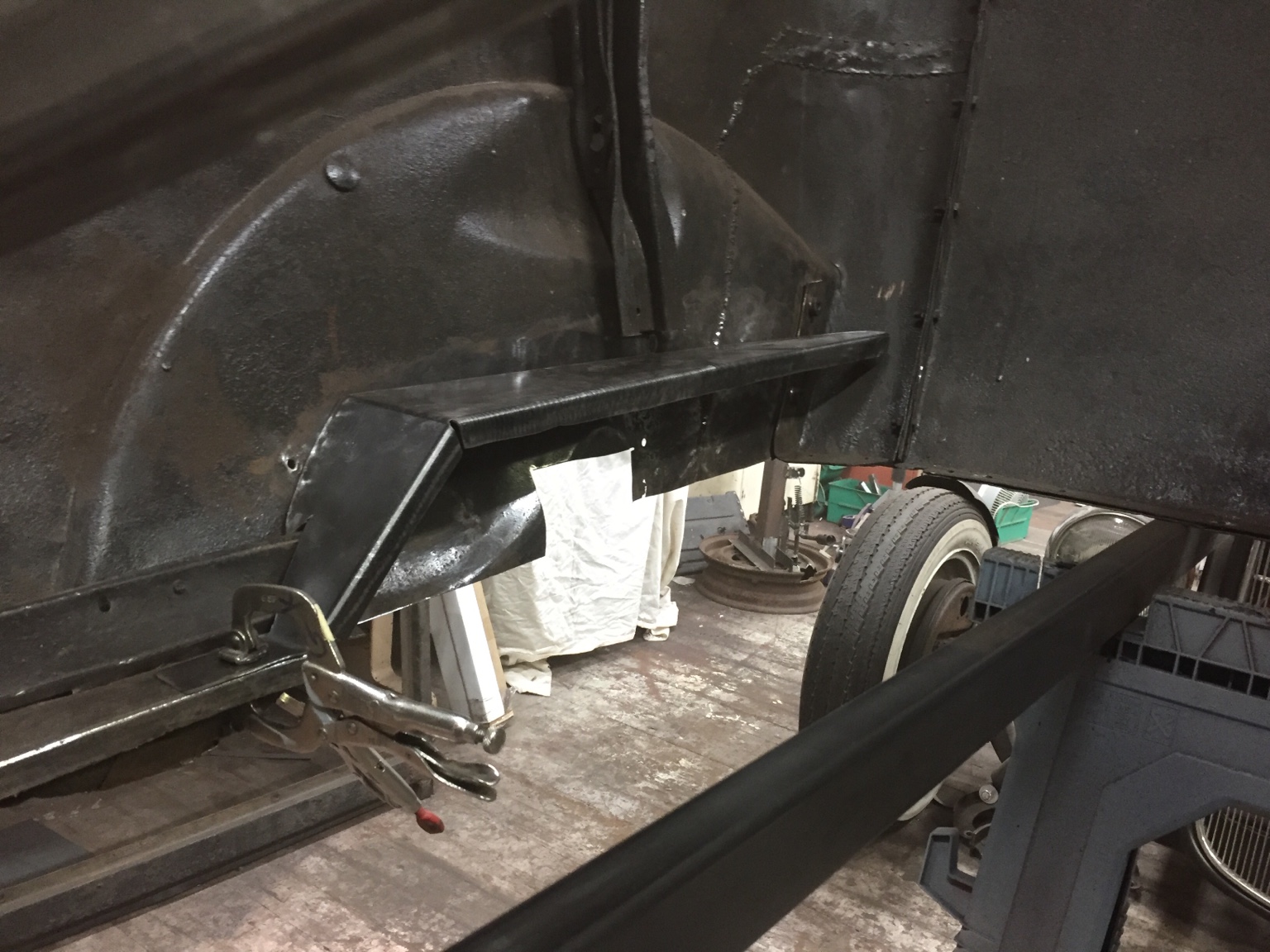

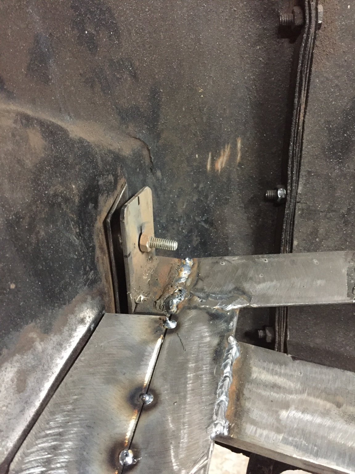

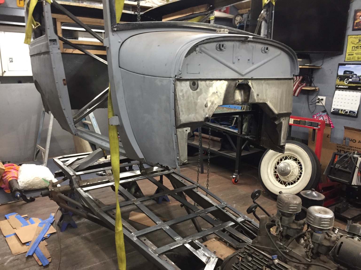

    Hoped to get a bit more accomplished today however dad duties and responsibilities won as they should.
    Did get my sub rail mounts fabricated and welded to the subrails in the rear corners.
    I used the fender mount holes as it was a perfect location.
    Once those were done I had to trim the new subrail fillers I made. Just had to trim the back few inches to clear the new brackets.
    [​IMG][​IMG]
    Tomorrow’s plan is to get everything cleaned up Seam sealed and sprayed in epoxy sealer.
    Things will be at idle till next weekend because I’m leaving for the week on Monday, so I don’t want things to rust up.
    Short but productive day ...
    Onward [emoji1371]
    Mike L.

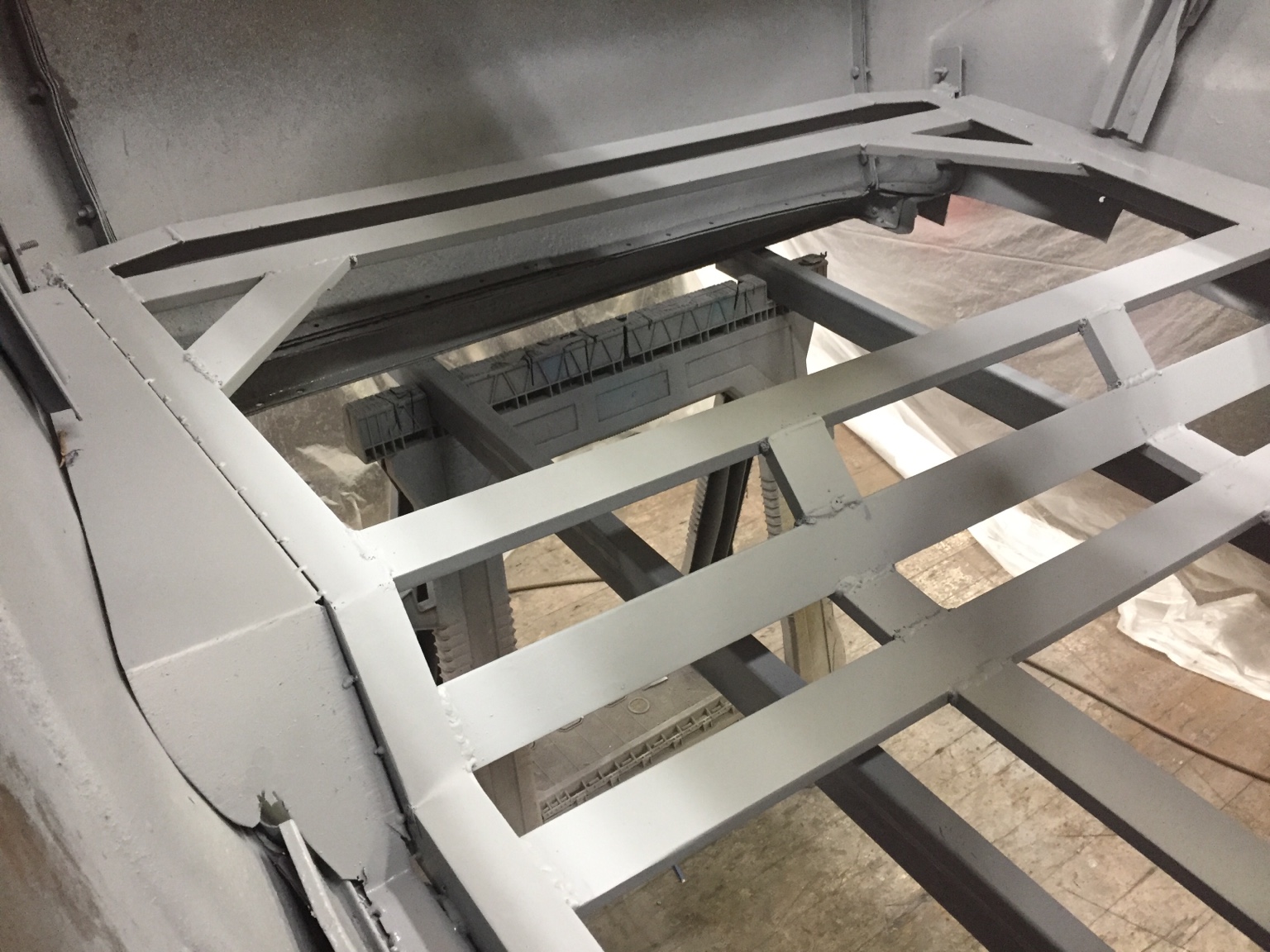

    Last update until I return from NJ next week.
    Got the new floor structure and all the bare metal sealed with a few good coats of epoxy sealer.
    [​IMG][​IMG]
    I was hugely overwhelmed reading how guys channel cars, I decided to simplify it in my head and I’m happy with the results...goal accomplished.

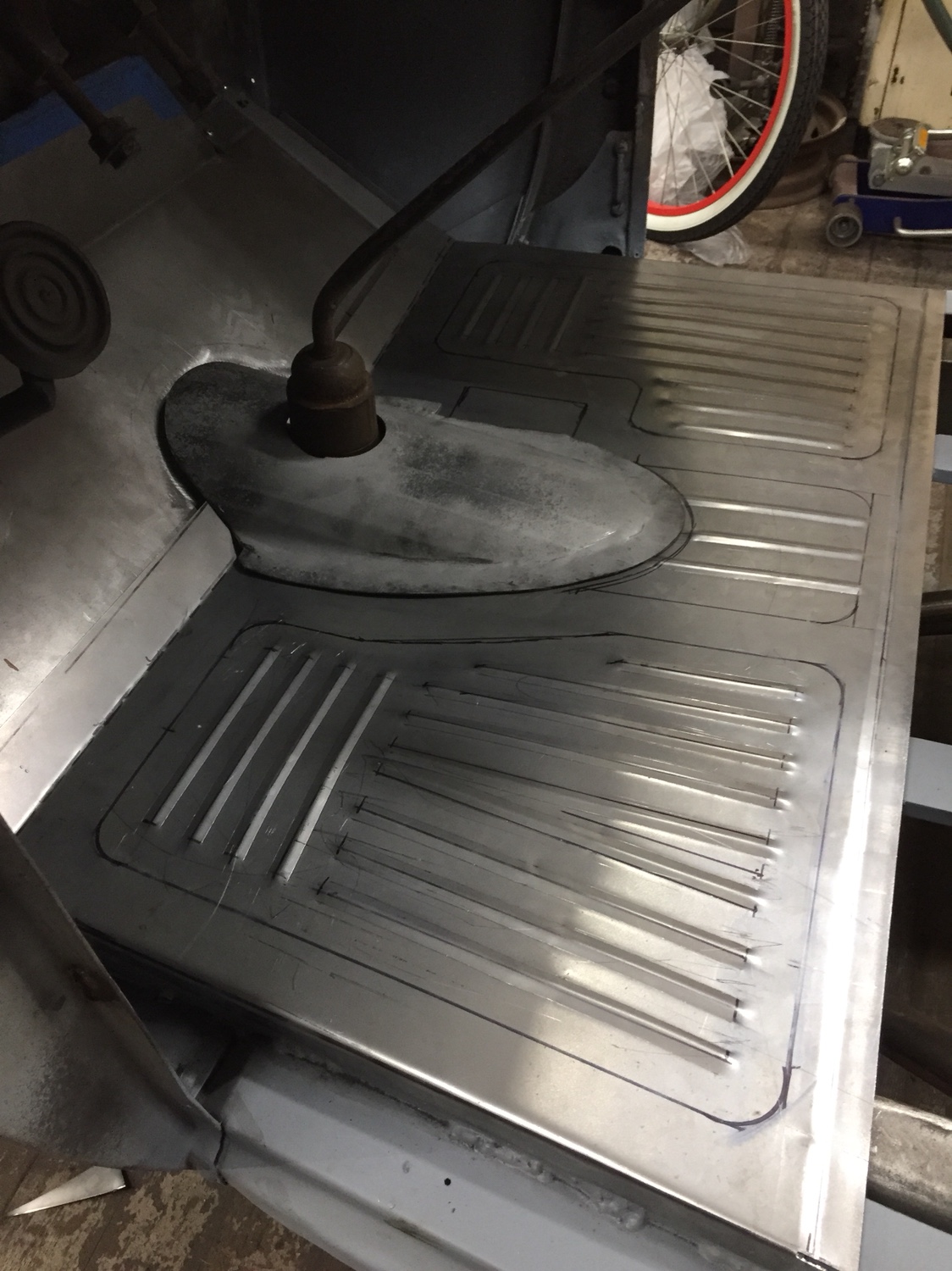

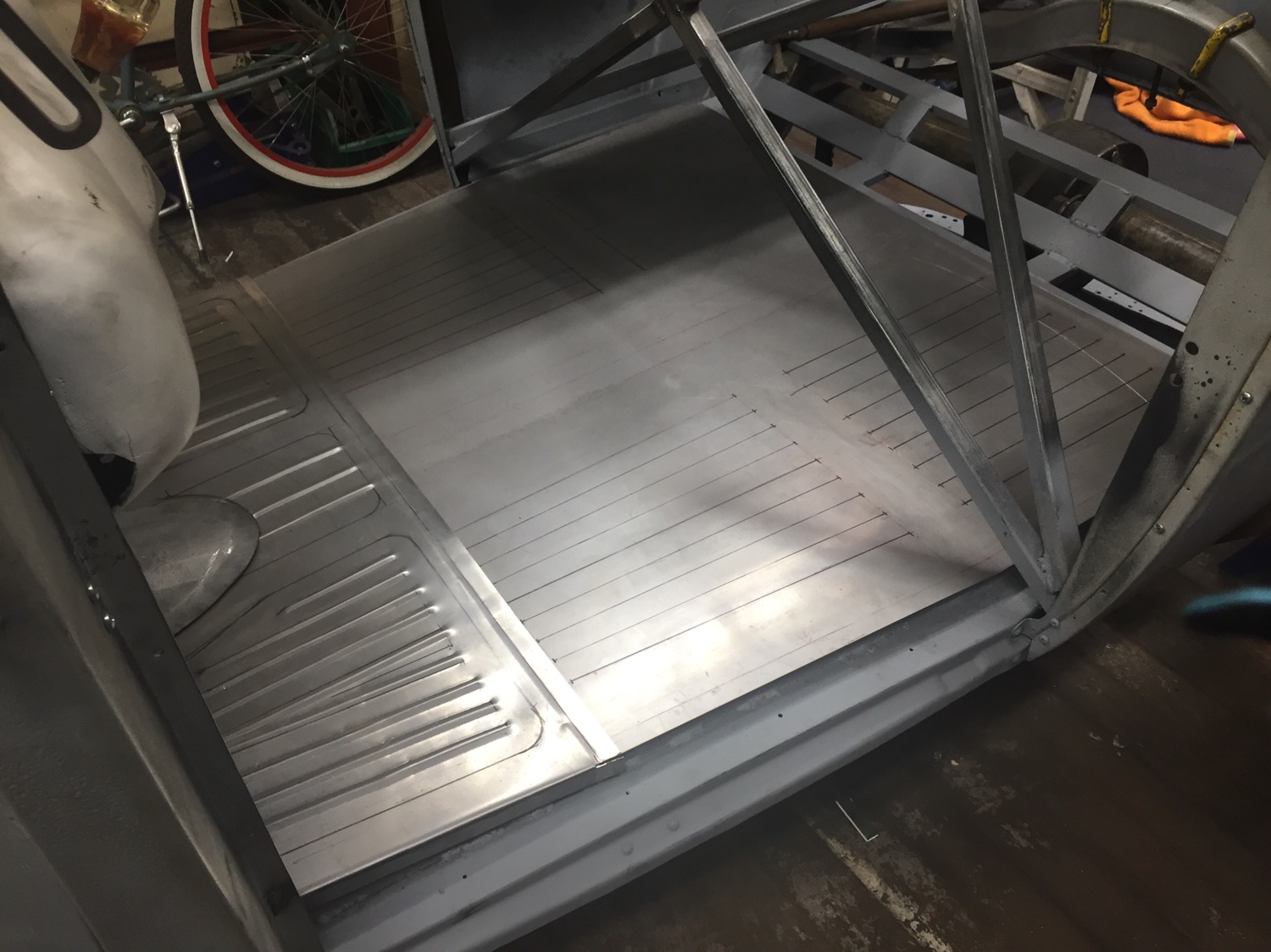

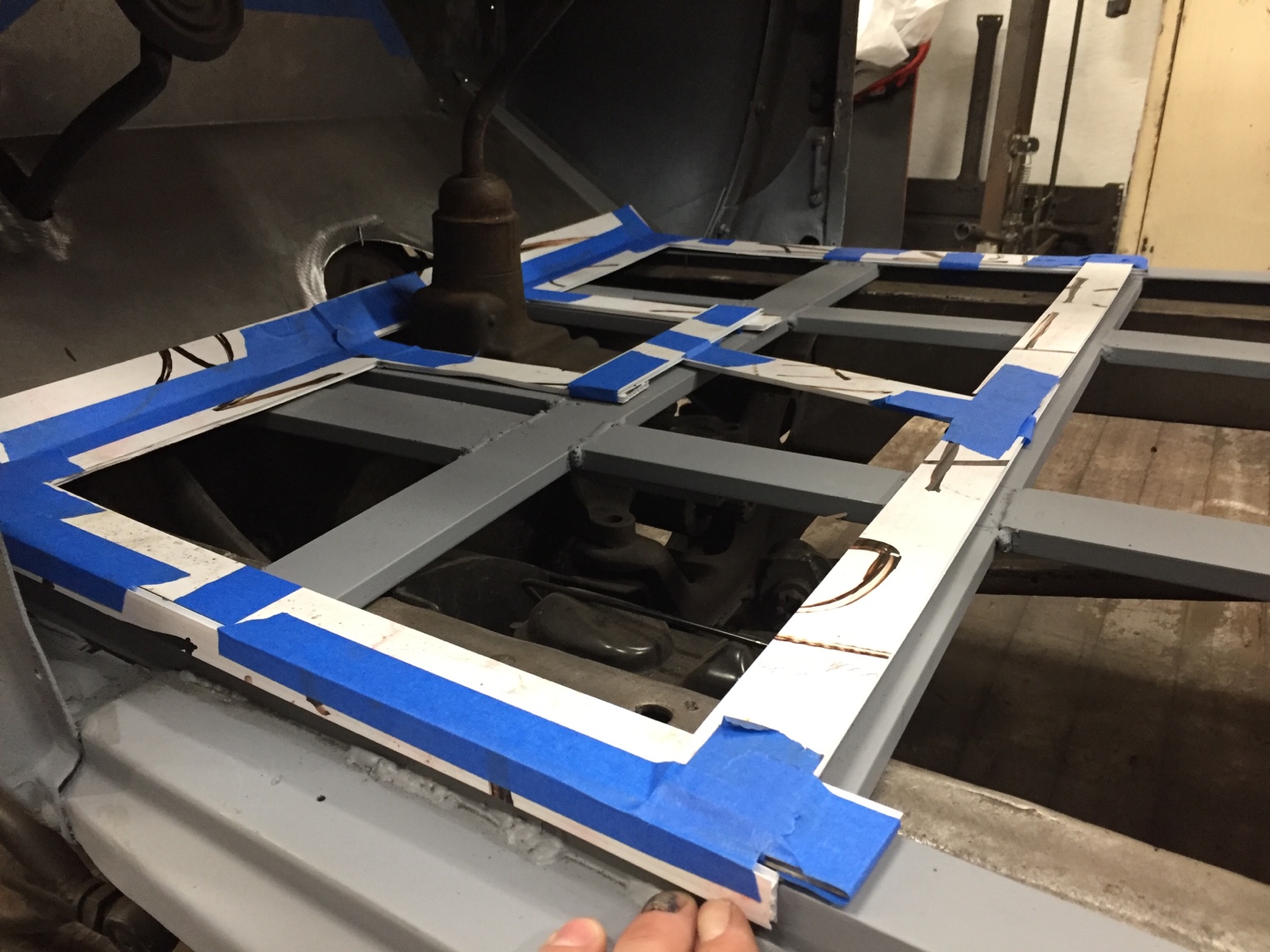

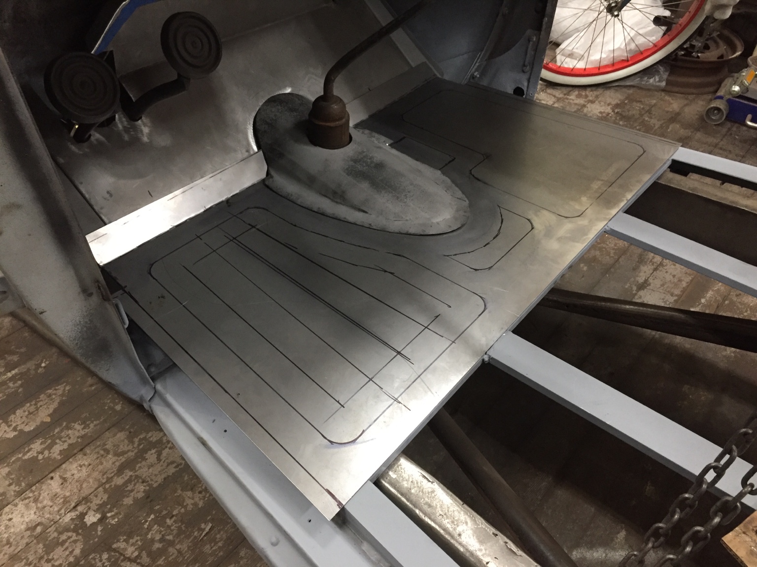

    8/9 days out of the garage and I’m missing the mojo ... spent some time blasting and sealing parts last night. Tonight I got the floor seam sealed, removed the stanchions I made to channel the body.
    Started templating the floor ...
    Naturally it’s about 1” too big for my damn bead roller [emoji30] Som-bich
    So back to the drawing board ... literally.

    Well, if it's too big, can you do 2 pieces? You could revise your pattern down the middle behind the hump and make a flanged overlap there so you can put it back together once you've done your thing.
  14. Mikel50
    Joined: Mar 30, 2015
    Posts: 1,113
    Mikel50
    If I move the beads in 1” near the door sill on either side it should spin through the throat of the roller frame. “Should”
    Looking to avoid having to cut it in 1/2.
    I’m learning as I go
  15. patmanta
    Joined: May 10, 2011
    Posts: 3,882
    patmanta
    from Woburn, MA
    Draw that plan out on some poster board and roll it as a test.
    Mikel50 likes this.

    I actually messed that up. It’s the other side I need to move. Either way. I’ll figure it out. Always do

    It’s a start [​IMG]
