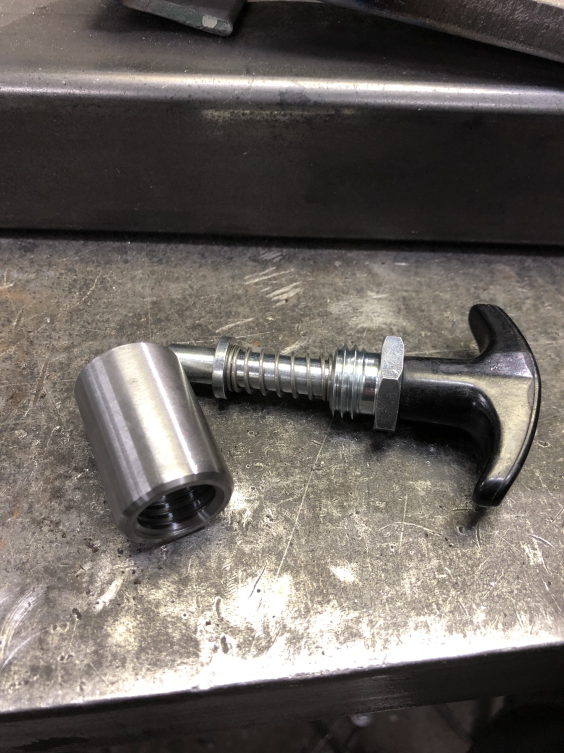

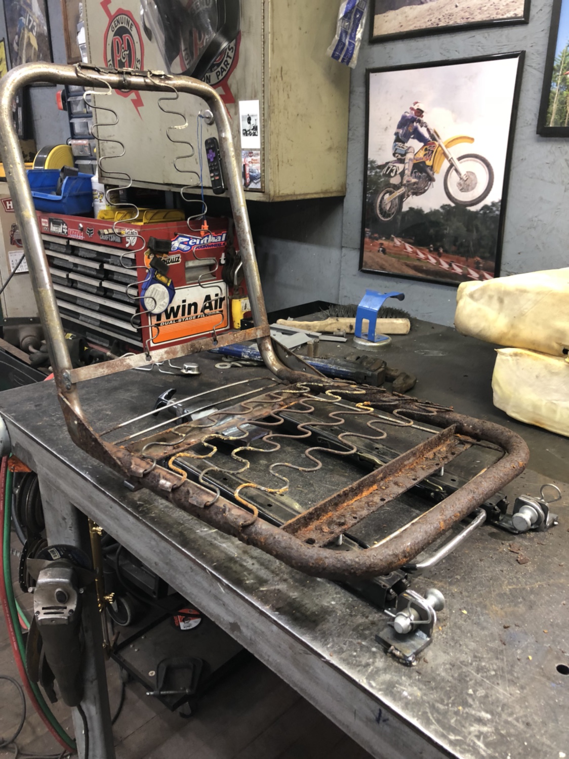

    Finished up my p*** seat mount.
    I made it so it hinges for the rear p***engers.
    Found a spring loaded pin on eBay they use for race car steering wheels and for aviation applications.
    That is the rear hold down that is attached to the seat.
    Added some feet to the rear of the adjusters.
    (The seat will not adjust now)
    Only tilt forward.
    Everything Works exactly as I had hoped it would.
    I tacked it to my welding table to make sure everything was aligned as I went.
    Lots of pics for anyone who wants to use the idea.
    Onward [emoji1371]
    [​IMG]seat bracket and floor tab tacked together for drilling hole for locking pin.
    Spring loaded locking pin
    These can be found on ebay in a number of variations on length/ pin diameter and material.
    Fitting the Location of pin prior to welding.
    [​IMG]the front pins are from a late 80’s to mid 90’s Ford Bronco rear bench seat.
    They’re used as front pivot pins. They came complete with nylon bushing/washers and pins.
    I sandblasted them to get an older look to them.
    I had to modify the original upholstery to fit around the rear latch mechanism.
    Drill some holes to mount to the floor and that’s that. Seats will be ready for upholstery.
