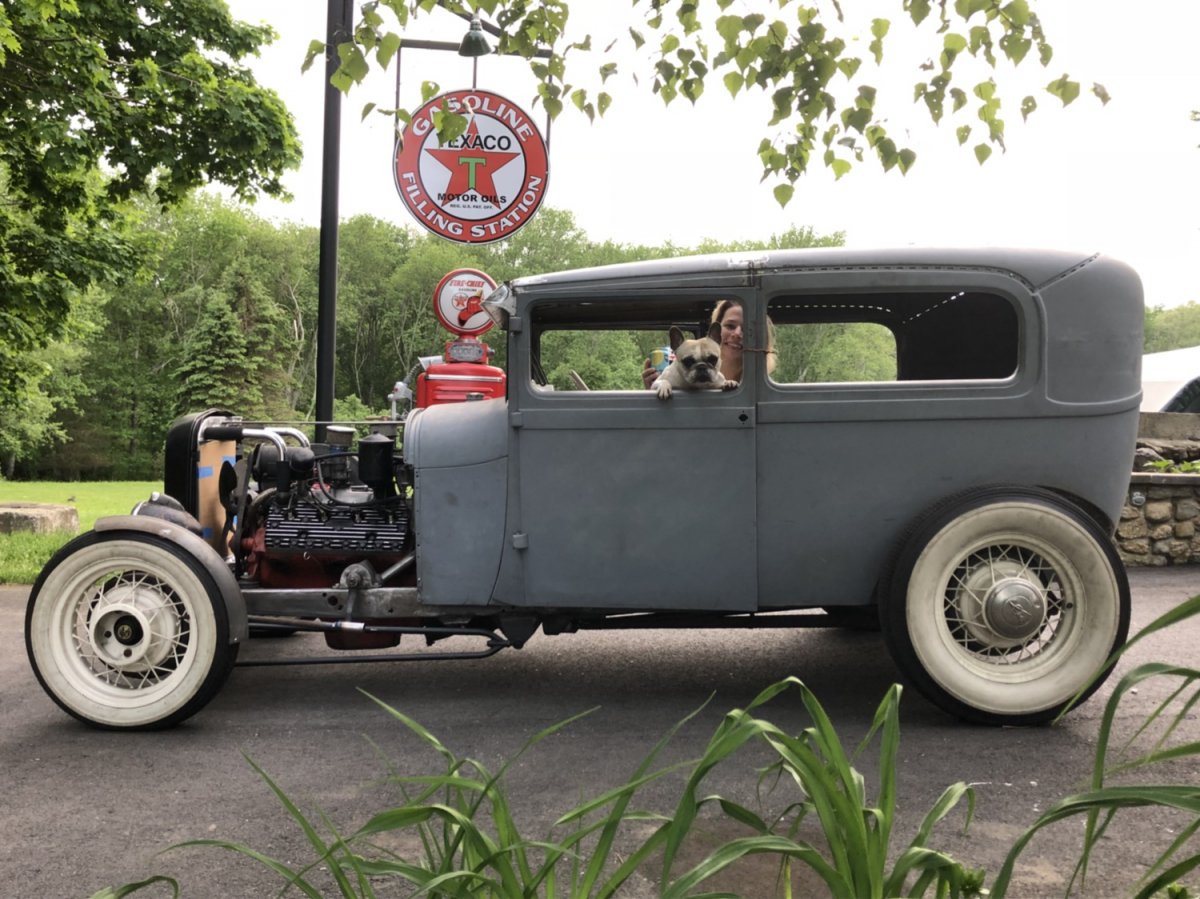

    Over a month of working long days, working in the yard, other off topic vehicles and just enjoying my family and being “okay” not working on the hotrod... I made a promise to myself last week that Sunday/Monday of Memorial Day weekend I would get some things off my plate.
    I went into the garage with a lot of enthusiasm and even more confidence this am and made some things happen.
    I removed the mock-up 39 rear axle and swapped the spring onto the freshly rebuilt 39 rear.
    Mounted my backing plates and wheels/tires
    Because of the stepped rear frame, 39 spring behind banjo and the channeled body I needed to Notch the frame to get suspension clearance.
    I used my Eastwood Versa cut plasma to cut the frame for the 4.5” section of pipe Joe (51Box) had given me a few weeks back.
    I decided to move the rear radius rods I built last year inward between the frame rails to make my life my easier.
    I purchased this really cool setup off Pinewoodflyer (Stephan Hokuf) on Instagram
    He makes them and they incorporate F1 front shock mounts
    Really slick setup (limited quan***y) if you like them and need a set reach out to him.
    He sells them with and without the f1 shock mount.
    I still need to bolt the f1 mounts and mount my shocks.
    After I cut the bungs off the front of my radius rods, I shortened them to the new length. I installed and new set of threaded bungs then heated and bent things to make the radius rods work inside the frame rails. After that I bolted everything together.
    I then rolled my car out of the garage for the first time ever.
    The car sits a little low in the ***... but I’m okay with it for now.
    I’ll be tweaking the height as I go.
    Wesley Approved
    Also ordered some new tires for the sedan
    7.50 -16’s and 6.00-16’s Firestone Whitewalls to be mounted on my set of 40 Ford Wheels.
    Was a good day.
