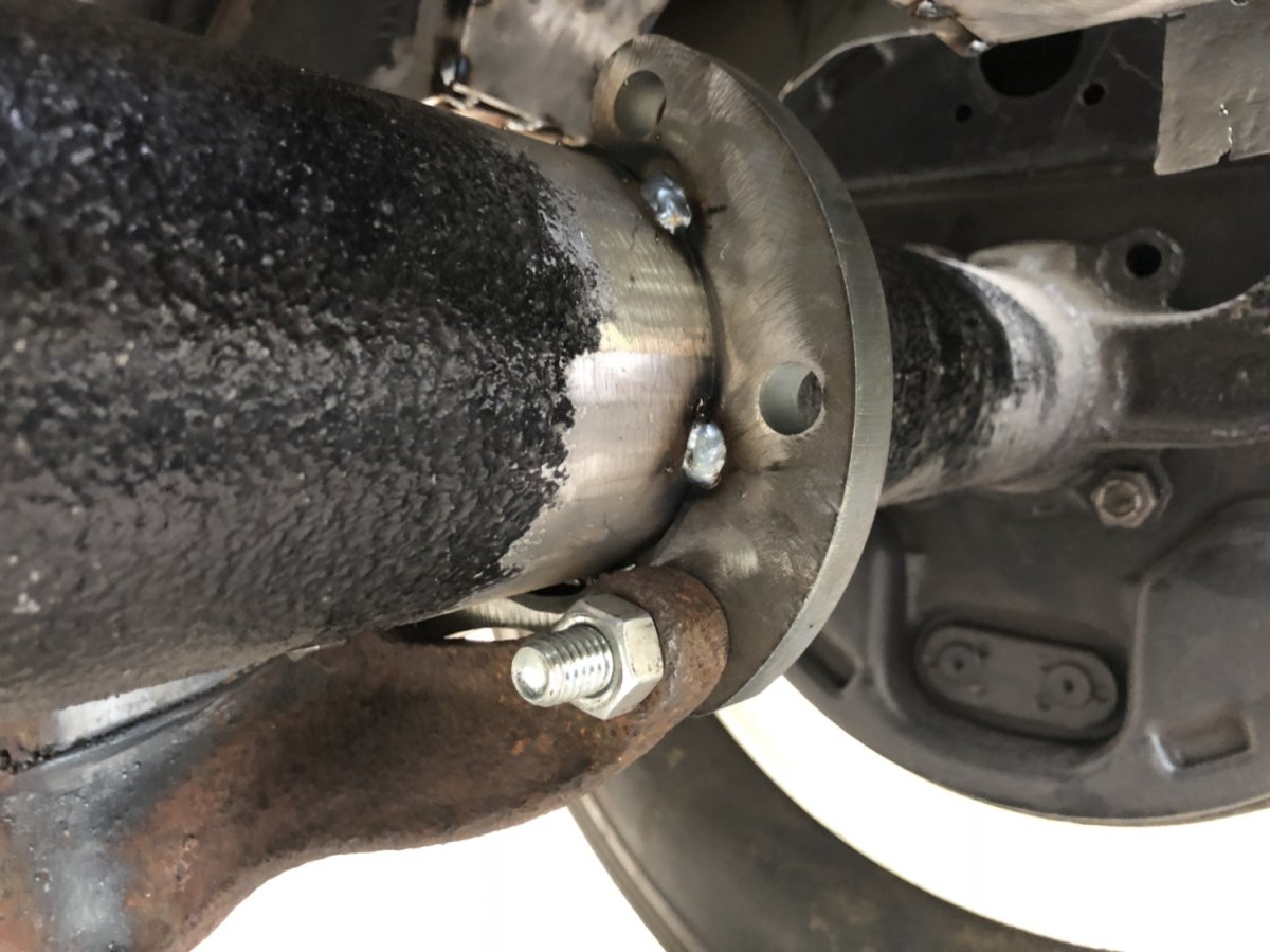

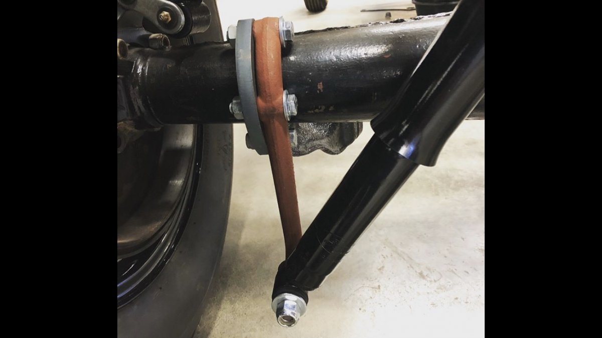

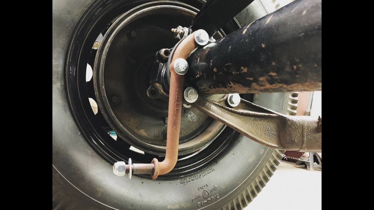

    Can you post more pics of the rear shock set up. I am trying to figure out how to set the shocks up on my project and your set up I think will work in my project. Thanks.
  7. Mikel50
    Joined: Mar 30, 2015
    Posts: 1,113
    Mikel50
    I’m not sure what additional pictures I can post that will help.
    Everything is pretty well shown in the pictures already.
    Please let me know.
  8. LSJUNIPER
    Joined: Aug 17, 2010
    Posts: 254
    LSJUNIPER
    from ct
    No problem, have it figured out now.

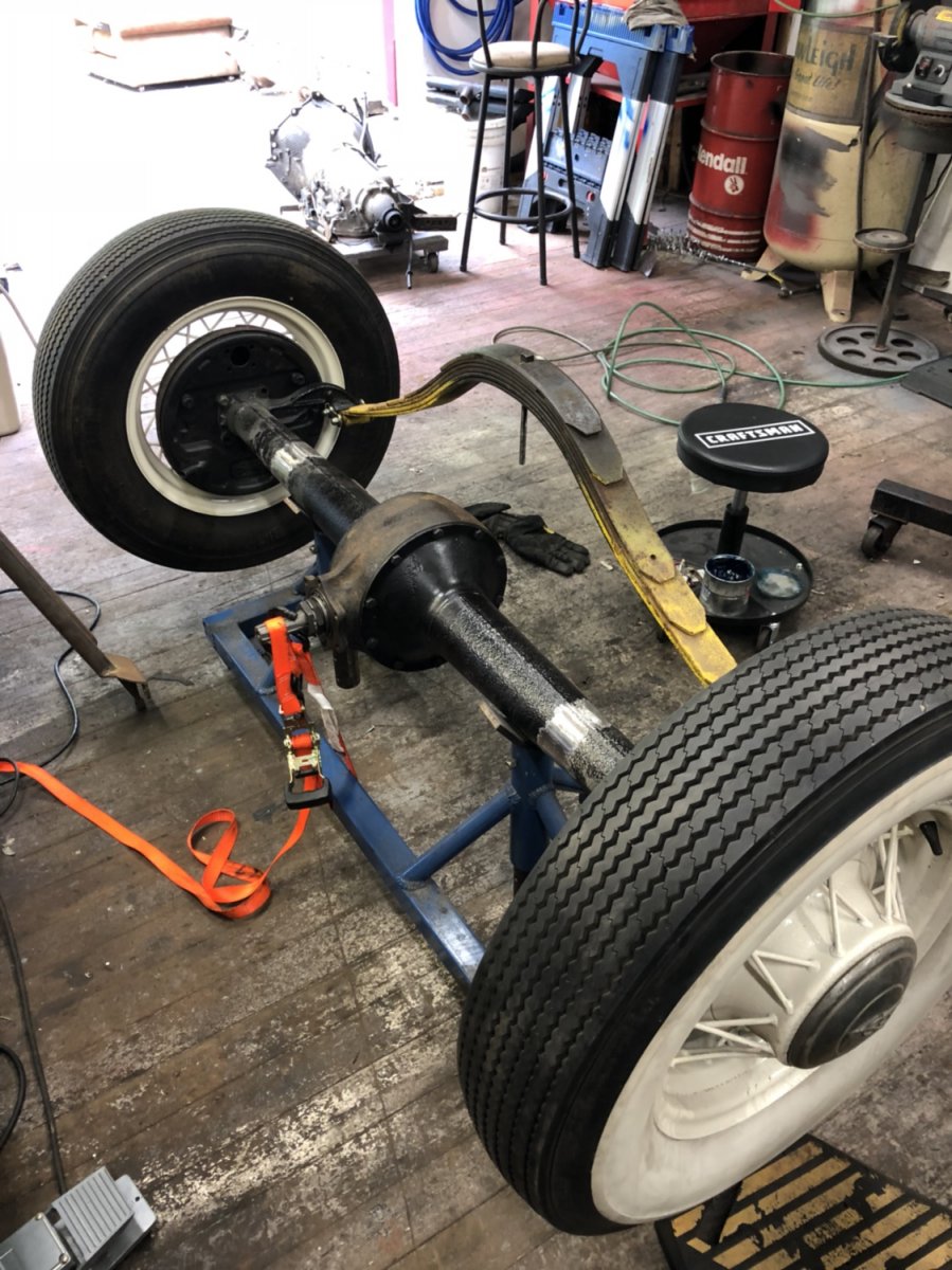

    Backwards and forwards we go ... I needed to correct the rear axle / wheel placement in the fender line.
    Had to slice and dice the subrails and floor a bit.
    Doing this forced me to adjust the steering column angle slightly upwards. It helped greatly with dash clearance and leg clearance between the steering wheel and seat.
    It resulted in having to remake a new recess on the firewall and transmission hump/ tunnel.
    (I cut the toe board a had previously made. Cut it in half due to needing additional material where the bell housing now sits.
    Reworked the toeboard with an English wheel to get the clearance I needed for the bell housing.
    I made a new transmission tunnel and capped of the back between the seats with an old headlight bucket.
    It mimics the points on the 49 dash
    [​IMG][​IMG]
    I still have to make the firewall recess at this point but it’s coming back together much nicer the 2nd 3rd 4th time around [emoji52]

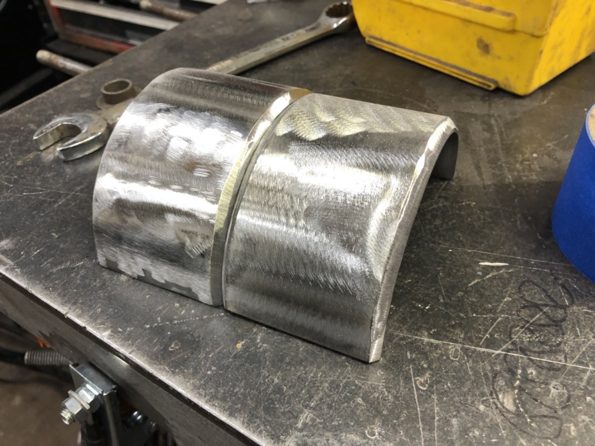

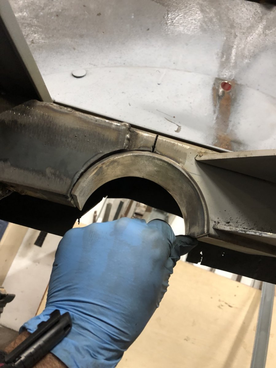

    Mounting 49 shoebox taillights was more involved than just bolting them to the rear panel.
    No matter how you set them they have a greater arch on the mounting surface than the body.
    So I ended up basically making “frenching buckets” but instead of inserting the lights into the buckets, I spun them around and the light sits on the back of the bucket as it is contoured to the light itself.
    It is then recessed into the rear panel and the body contours to the outside of the mount.
    Worked out pretty slick ...
    Took most of the day and a few other attempts, but I settled on this way.
    I’m happy with it.
    [​IMG][​IMG]
    [​IMG][​IMG][​IMG][​IMG][​IMG][​IMG][​IMG]
    [​IMG][​IMG][​IMG]
    Now they will mount flush and be able to use a factory gasket between the bucket and body.
    That was the reasoning behind the whole process.
    Trying to keep things weather tight.
    Love this shit !!!
    Ahhh....it was a good day [emoji481]
