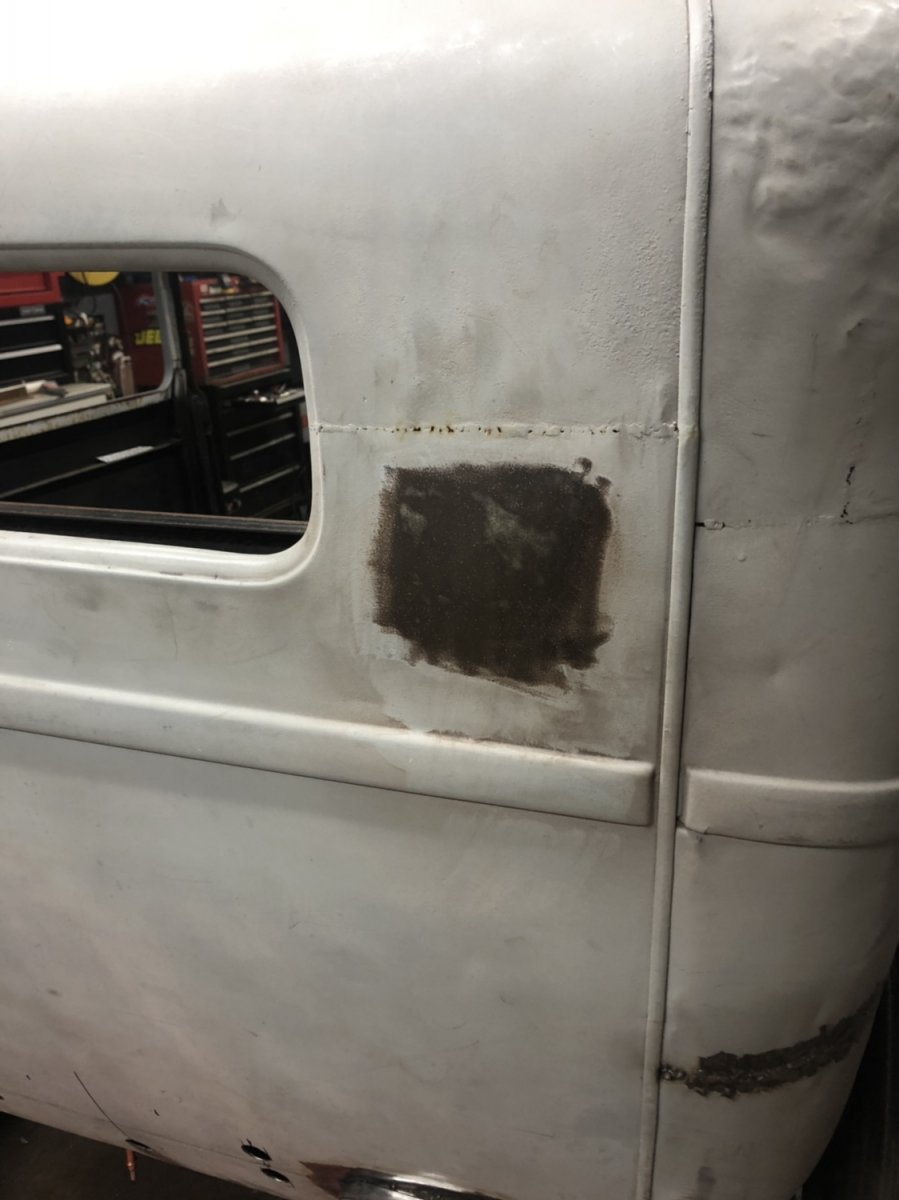

    Also got the gas filler hole located and drilled.
    Grommet for the body is on order.
    For those who may go this route.
    The Mopar 68-69-70 GTX & Road Runner gas tank grommet is the size that fits the TANKS INC filler tube.
    It has the correct ID and OD for the body and the tube.
    I’m not thrilled of how the filler and cap protrude the way they do.
    I may recess it slightly

    Moving right along, kiddo! Looks good too- that inch sure had an interesting effect. IMG_0720.JPG
