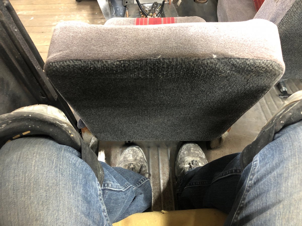

    Here is the final placement of all interior components.
    Considering what I’m attempting the final result is (to me) acceptable. I can comfortably sit in the back seat with my feet on the floor.
    Chopped, Channeled hotrod with a Z’d frame, a 14 gal fuel tank and a backseat.
    Give me a minute... I need to pat myself on the back. [emoji16]
