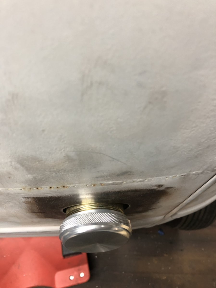

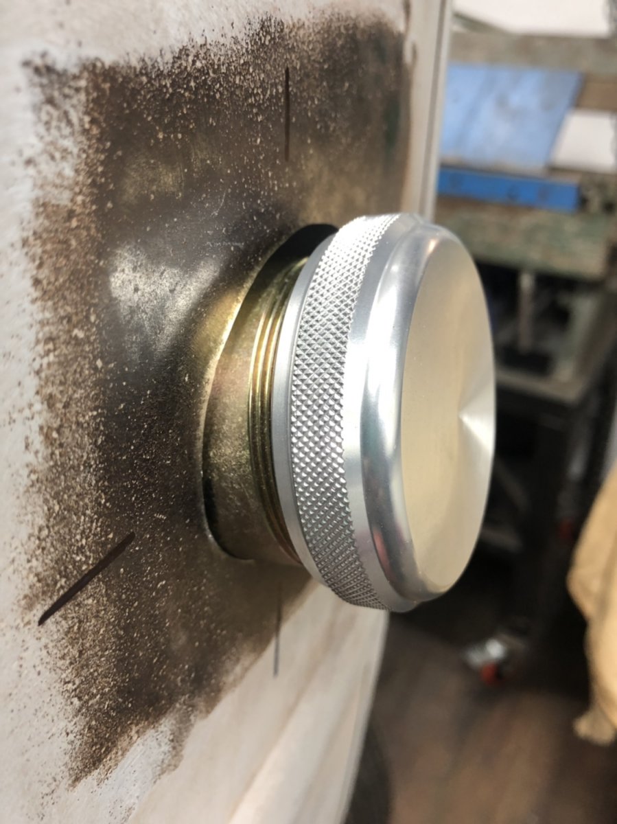

    Good looking gas cap, any idea if it’s vented or not?
  2. Are there any houses for sale on your block?
    Looks Perfect!
    loudbang and Mikel50 like this.
  3. Mikel50
    Joined: Mar 30, 2015
    Posts: 1,113
    Mikel50
    Negative. The tank itself will be

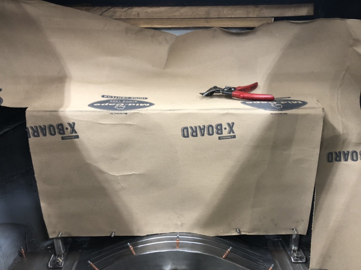

    This afternoons project was in the Arts and Crafts type.
    Now that I’ve got things ****oned up on the frame and filler. It was time to start laying out the sheetmetal templates.
    It was a long afternoon of cutting heavy floor protection for templates.
    Started out laying out the main structure panels first
    After staring at the tank enclosure I decided it didn’t look as finished as I would like.
    So I added “wings” to the enclosure
    They will be mounted after the main tank enclosure will be mounted and will finish off the look and seal the entire rear of the car from the p***enger cabin.
    It has to work ... I see I’m in my brain
    Like the rest of this thing I call a hotrod.
    I’m adding a ton of work to my plate but it’ll be how I want it to be in the end.

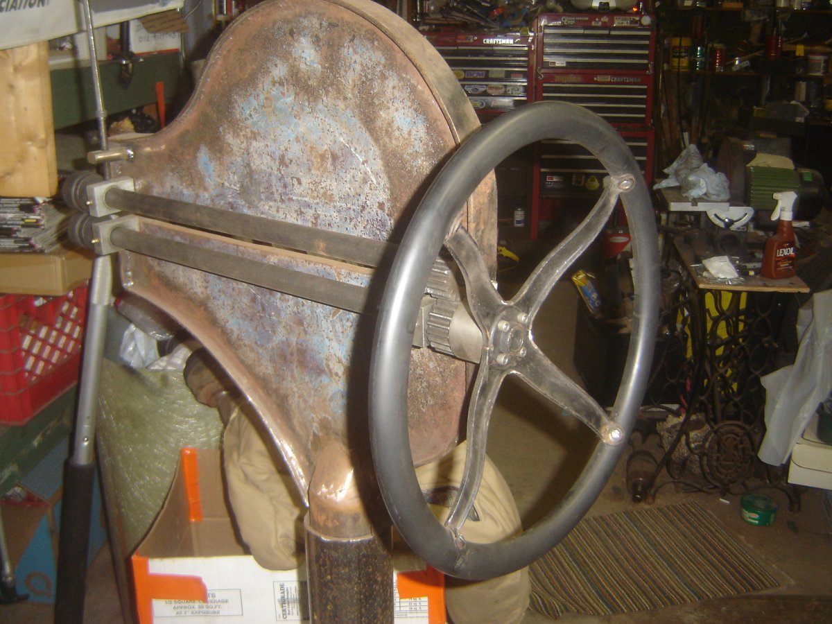

    Quick modification to my Woodward Fab Bead roller this am.
    Purchased a 20” Boat Stainless Steel steering wheel off Facebook Marketplace early this week for $20
    The supplied crank is 10” and create a 20” throw. So I figured the 20” wheel would be just right.
    Took some time to modify it, about 30 minutes of work will make a world of difference in my bead rolling game [emoji16][emoji1360]
    Added a 3/8” spacer made from DOM tubing behind the wheel
    Took a 1/8” spacer welded a flat washer to it.
    Drilled and tapped the lower shaft to accept the bolt.
    The outside spacer / collar and the inside spacer pinch the wheel onto the shaft.
    Also added a set bolt to hold the wheel from spinning on the shaft.

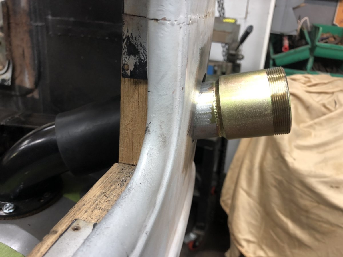

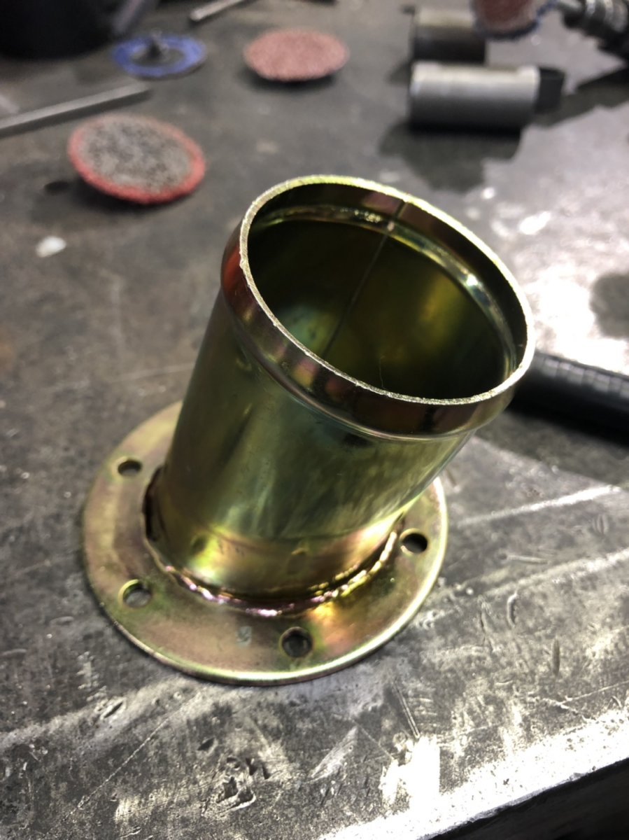

    Those magnets are nice, it's hard to find any that are strong enough to hold anything. Good job on the fuel neck, I got the stuff to do mine today.
  23. 42˚18'N 83˚09'W
    Joined: Jul 29, 2008
    Posts: 168
    42˚18'N 83˚09'W
    Kinda the same thing I did. Great minds think alike...
