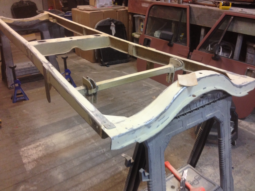

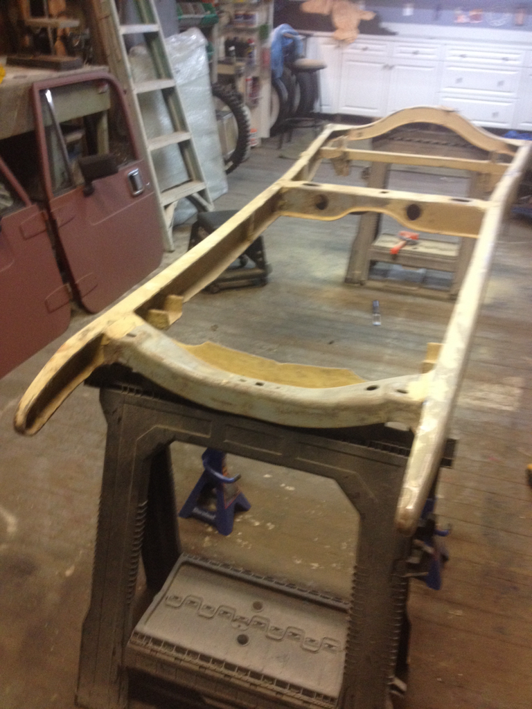

    I thought you guys would enjoy some pics while you're sipping your morning coffee.
    Haha ... Finally after all my ups and downs and 2 sand blasting guys, I got my frame back last week.
    It's in the garage on stands and I'm moving forward.
    ImageUploadedByH.A.M.B.1446987328.231606.jpg ImageUploadedByH.A.M.B.1446987353.022044.jpg ImageUploadedByH.A.M.B.1446987367.095422.jpg ImageUploadedByH.A.M.B.1446987382.653545.jpg ImageUploadedByH.A.M.B.1446987401.246040.jpg ImageUploadedByH.A.M.B.1446987420.189179.jpg

    Not wanting to torch cut the garbage off the frame I took a chance with a hammer and a few light hits to the motor mounts ... And to my surprise !
    ImageUploadedByH.A.M.B.1446987612.621178.jpg ImageUploadedByH.A.M.B.1446987623.841971.jpg ImageUploadedByH.A.M.B.1446987638.266719.jpg ImageUploadedByH.A.M.B.1446987653.823112.jpg ImageUploadedByH.A.M.B.1446987669.798513.jpg ImageUploadedByH.A.M.B.1446987701.047294.jpg
    Then came the "4 link bar"
    Whoever built this frame intended on totaling themselves and this car.
    Holy smoke ... It's 2mm thick steel sq tubing.
    ImageUploadedByH.A.M.B.1446987786.990662.jpg ImageUploadedByH.A.M.B.1446987803.065243.jpg ImageUploadedByH.A.M.B.1446987827.994442.jpg
    But hey they added a plate for strength. [emoji102][emoji603]
    gonzo and volvobrynk like this.

    I thought you guys would get a kick out of these pics and like to know I'm moving forward finally.
    I'm working on carefully removing the plates inside the rails. It's a perfect place for moisture / salt and ultimately rot.
    I'll be ordering the steel to box the frame properly, once it's cleaned up primed and ready.

    mike bowling
    Holy ****- I thought I ****ed at welding!
    Hate to say it , but you might want to look for a better frame- or invest in $100 bucks worth of grinding discs (and some new lungs!)

    It looks like they just threw bird **** at everything !
    This frame isn't bad...I'm in good shape over here !
    The welds on the plates inside the rails are as bad as the rest.
    I've already removed one w/ almost no effort.

    The ch***is itself is in amazing shape, the welding that they did to add the brackets and the plating is horrible. As soon as I remove the bad stuff that they added I will have basically a perfectly good frame to start from.
    I'm not worried about it one bit
    It already looks a million times better !

    30 minutes in ...3.5 ft of plate off.
    ImageUploadedByH.A.M.B.1447023501.491426.jpg ImageUploadedByH.A.M.B.1447023511.942245.jpg
    Beautiful steel under it.

    My initial thought was T Bucket but I second guess myself...because I'm not versed in it.
    However I did manage to get both sides off from the crossmember forwards.
    Both sides are damn near perfect w no flaking or even pitting.
    The fact that this frame never saw use since it was plated or "Built" I use that term lightly...made the difference.
    They shaved the rivets flush on the outside and left the heads intact under the plates between the plate and the frame so there was a 1/4" gap. I think that might have allowed air into the pocket and actually helped.
