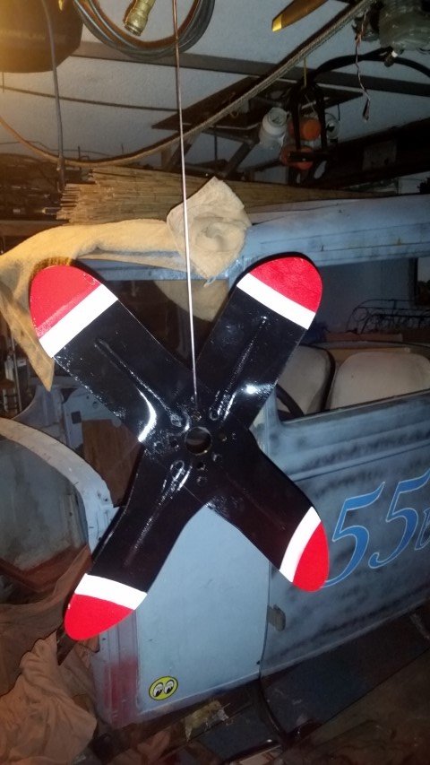

    Anyone knows the difference between the 2 blade and the 4 blade prop?
    Thanks for all your help Randy!

    4 blade prop and a different front motor mount... 20150809_141132 (Medium).jpg

    The new banger looks good. I hope you are still planning on using the 4 blade fan. If the 2 blade is an original one, they have been know to come apart and damage radiators etc.
