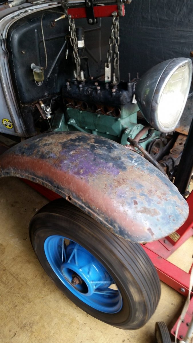

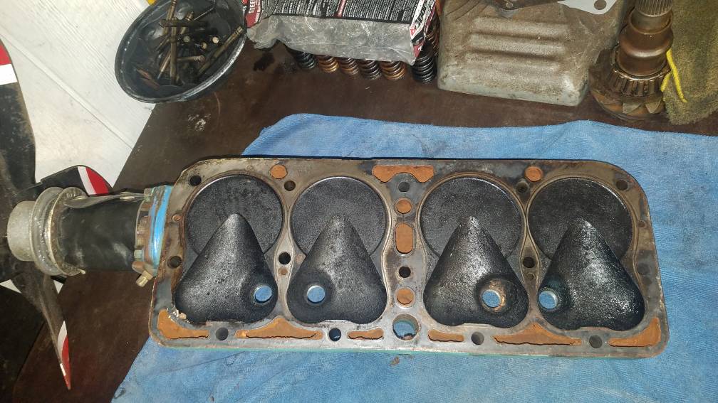

    I kinda s****ed the gasket out of there...I can see the valves!-------------------------------Broke a Stud--------------------V
    (luckily there's Enough meat to weld a nut on)
    Tomorrow I'll TIG the nuts to the studs and put out the Impact on it...
    If that doesn't work................................C4 or ..........Green Boat Anchor.................

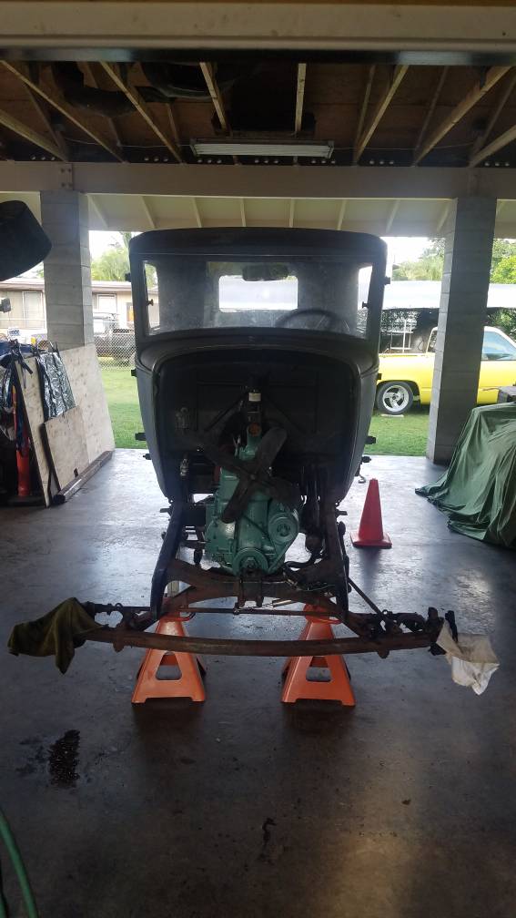

    Make Shift Surgery Room....(Crazy Storm winds outside...)
    2.jpg OK, Ready to go...
    Studs snap...tried impact gun, breakers bar + Sledge Hammer, Breaker bar + extension..
    Top - the one stud that came out + another snapped stud below!
    Houston, we have a Boat Anchor!

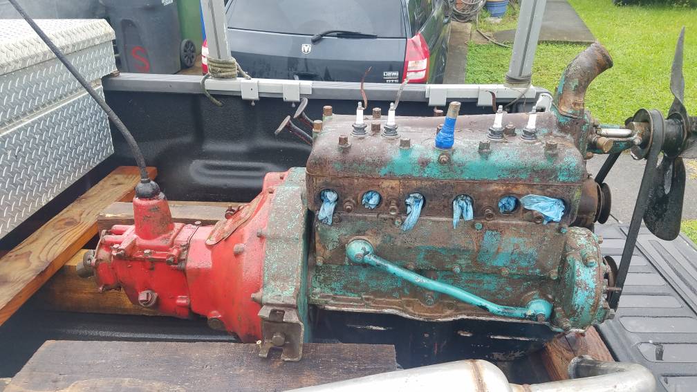

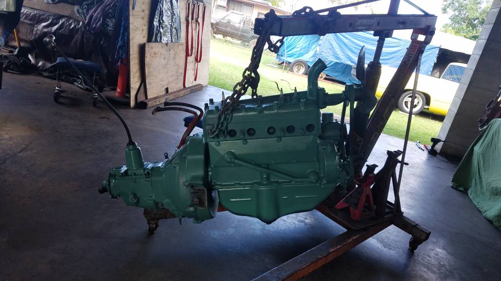

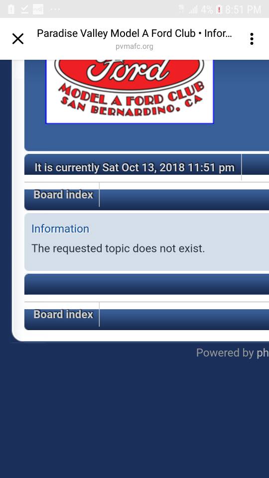

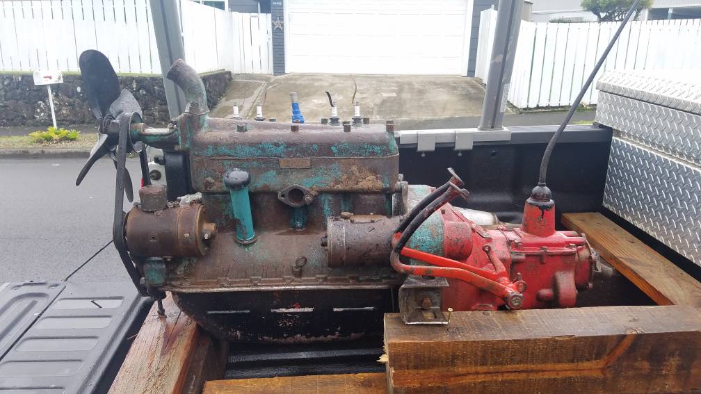

    Finally found a new heart for the sedan..

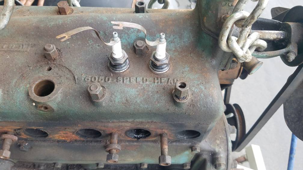

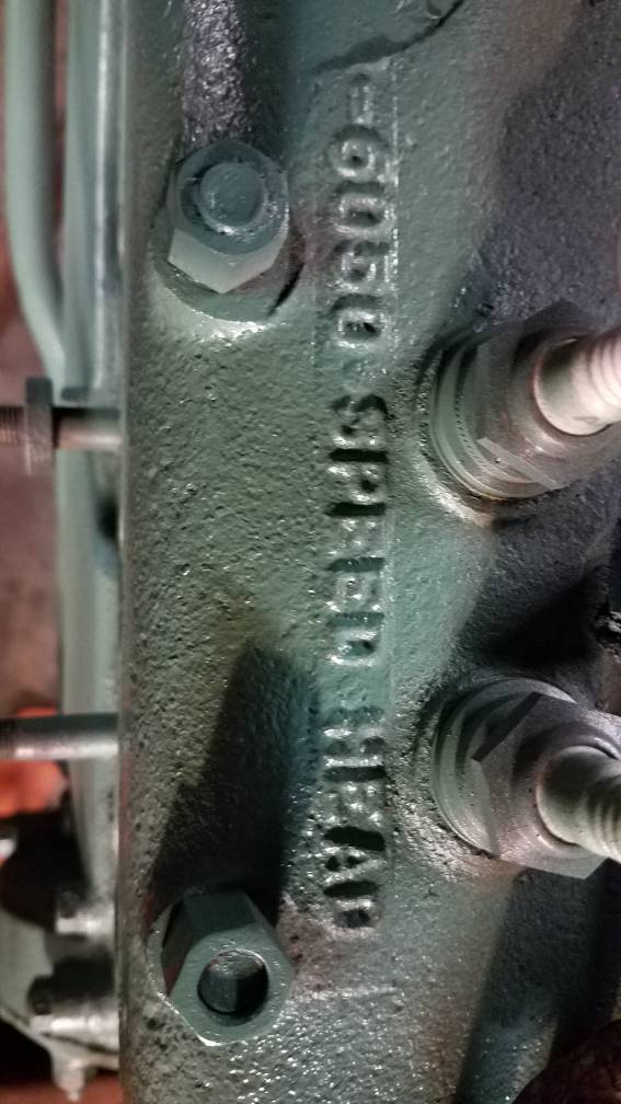

    Anyone knows what the deal is with the "speed head"? 20181013_143550.jpeg 20181013_143540.jpeg 20181013_092542.jpeg
    Sent from my SM-G930T using The H.A.M.B. mobile app
    Tim and Stogy like this.

    is it high compression... ?
    island police … ?
    Stogy likes this.

  17. 340HilbornDuster
    Joined: Nov 14, 2011
    Posts: 2,074
    340HilbornDuster
    Mine's Missing a B in the markings.
    B6050 Speed Head
    1930s aftermarket head
    Model A, 4 bolt water pump
    Inch 7/8-18 spark plugs, over intake valves
    Though marked "B6050 Speed Head" on top,
    Actually a copy of a standard Model A
    Ford combustion chamber,
    not an A-6050-B or B-6050 chamber
    Compression Ratio 4.2 :1
    B6050 Speed Head
    Early 1930s aftermarket head
    Marked "B6050 Speed Head" on top
    Copy of Model B Ford combustion chamber
    Compression Ratio 4.6 :1
    A6050B Speed Head
    Late 1930s aftermarket head
    Marked "A6050B Speed Head" and "S-S" on top
    Copy of Model A Ford "Police" head
    Compression Ratio 5.2 :1
    Stogy likes this.
  18. 340HilbornDuster
    Posts: 2,074
    340HilbornDuster
    Over to my buddy's house
    Cryptic message? (My "swedish keyboard on my phone translated for me....?)
    Motor and Juice Breaks .
    Originally Sent from my SM-G930T using The H.A.M.B. mobile app

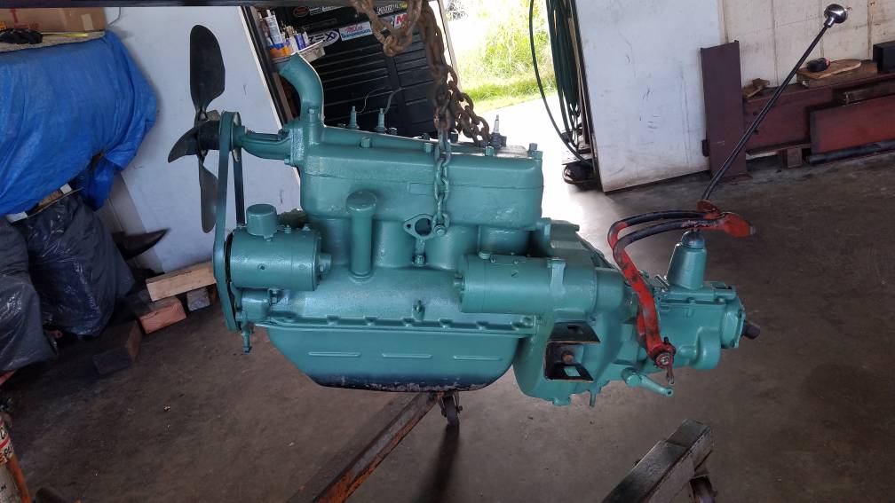

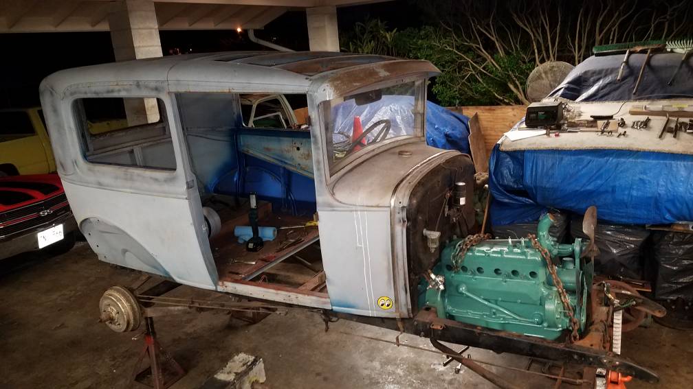

    Speed Head engine is in...
    (It's like kids putting stickers on their cars...
    It'll feel faster with that Speed Head...
    My buddys Austin Project... (Ansen wheels!) 20181016_183439.jpeg 20181016_183527.jpeg 20181016_183456.jpeg

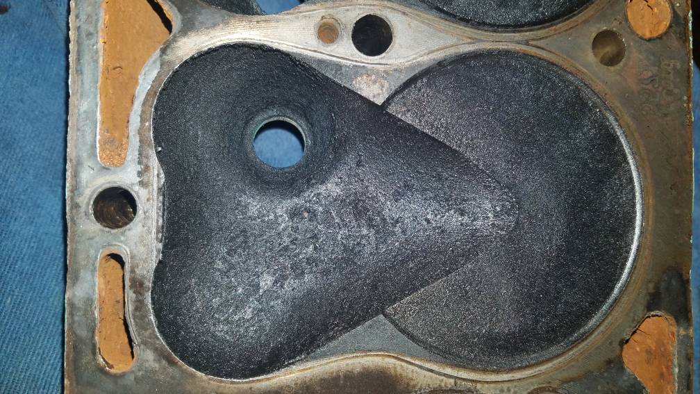

    S'more work today...torque the head bolts...one came right up...
    Positive? Head came off super easy!!
    Helicoil!!
    Anyone knows the compression of this chamber? 20181020_154804.jpeg 20181020_185819.jpeg 20181020_185830.jpeg

  26. 340HilbornDuster
    Posts: 2,074
    340HilbornDuster
    Thanks RWRJ - 5.2:1 Yeez!! - So They'er Speed Heads after all...Cool!
    - Glad I'm updating the Brakes with all that power....

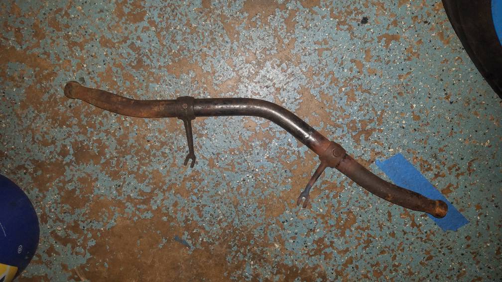

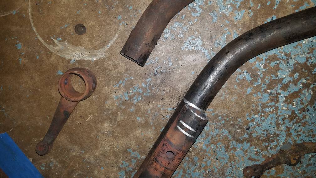

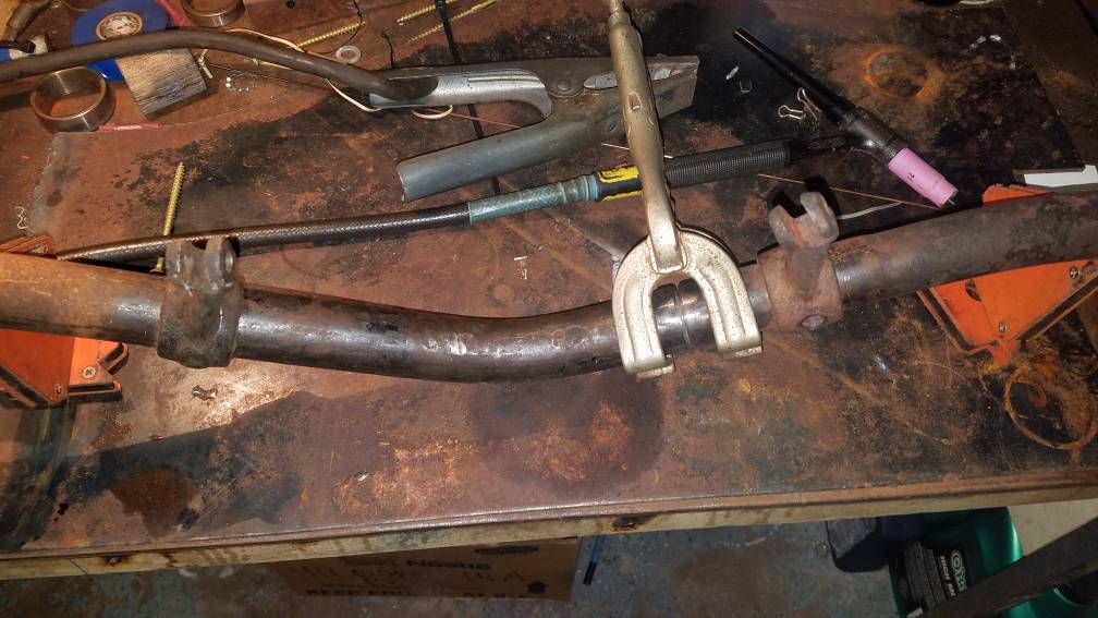

    Master cylinder on p***enger side
    Henry even punched a hole in x member...(Europe?)
    converts pull to push
    Using a 1" mustang 2circuit mastef 20181023_201122.jpeg 20181023_211211.jpeg 20181023_220154.jpeg
