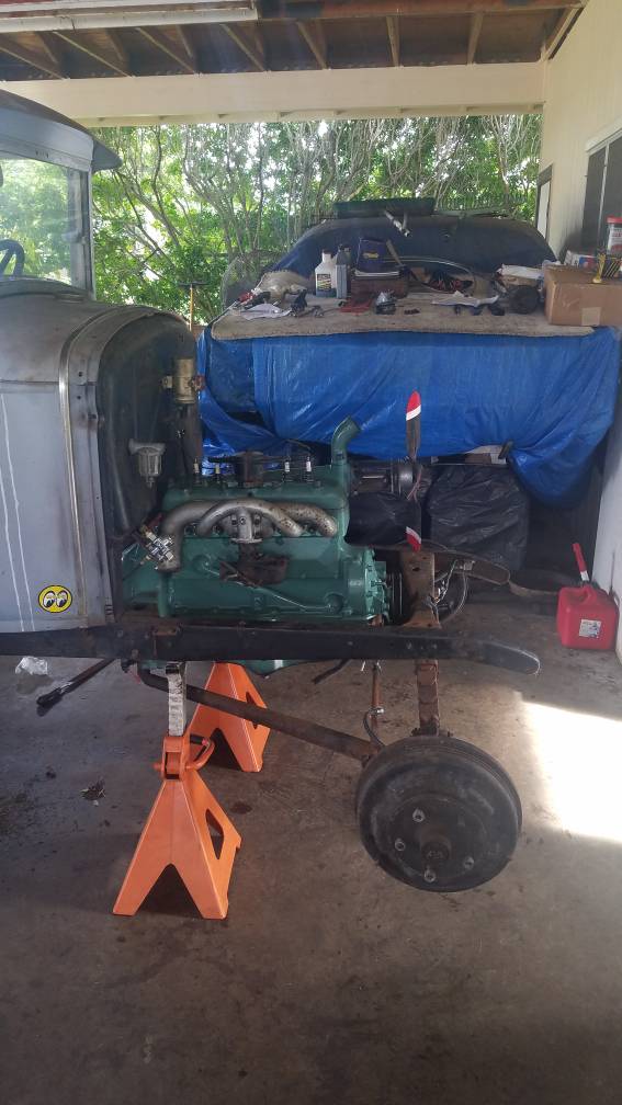

    Why another project.. ?
    Just Happened to find an Engine..!

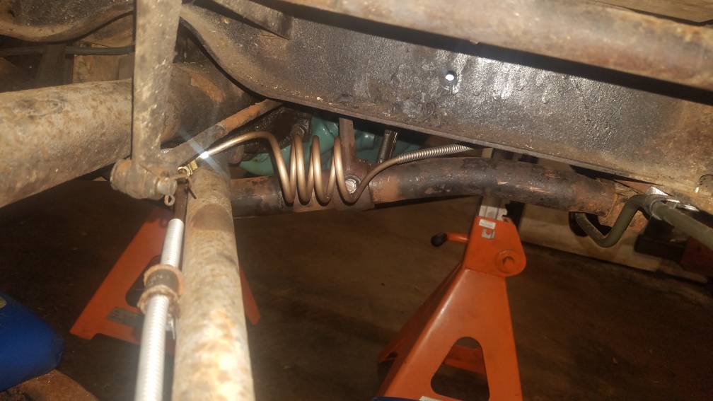

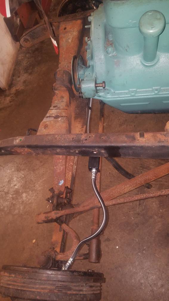

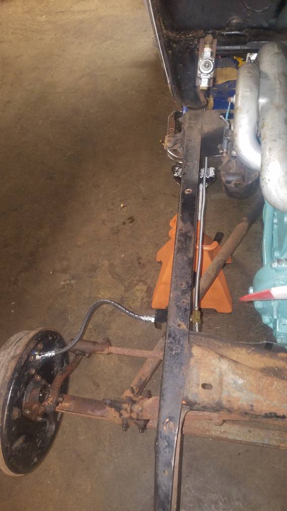

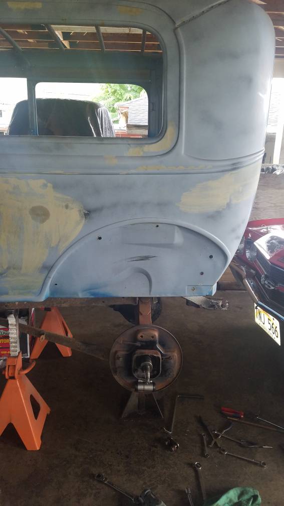

    "You know I got these 47 brakes lying around for a while" ..let's do it.

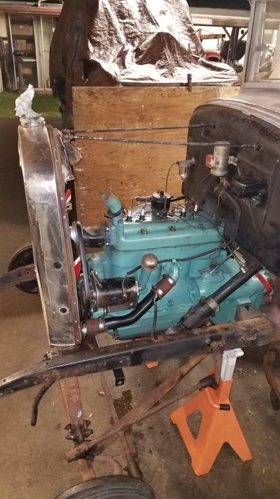

    (rear brake lines in)
    You're Correct - The Rears are up side down!...clears the spring.
    The Fronts are tilted back about 30° ish....
    AND we're going 12V --- using an Austin positive gnd. Generator...(looks cool)
    Original starter should be OK w. 12V...?

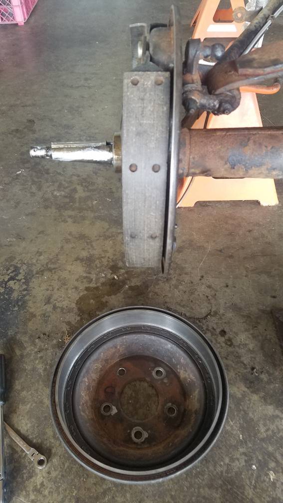

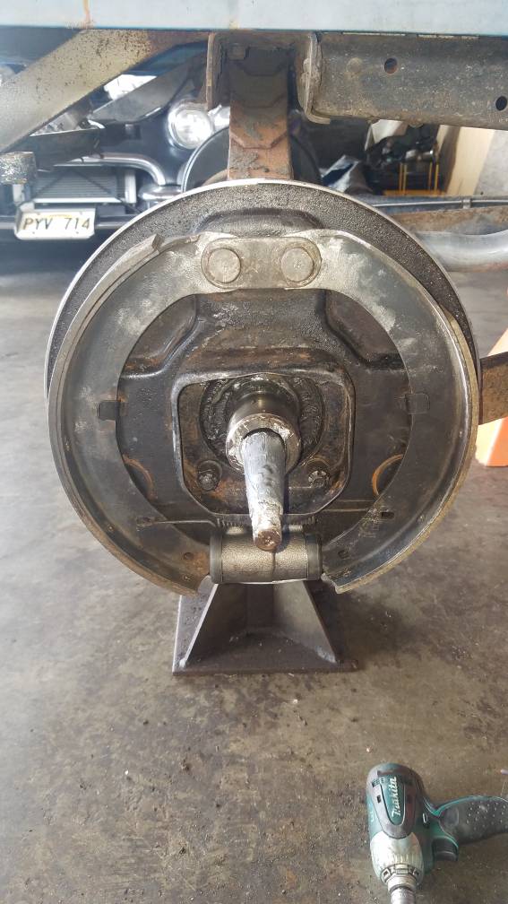

    Just found out that I have:
    1939 - 1942 backing plates in the rear.
    1946 - 1948 backing plates in the front.
    Wheel Cylinders, Springs, Drums = the same.
    Shoes & Hardware = Different.
    Learn something new every day!

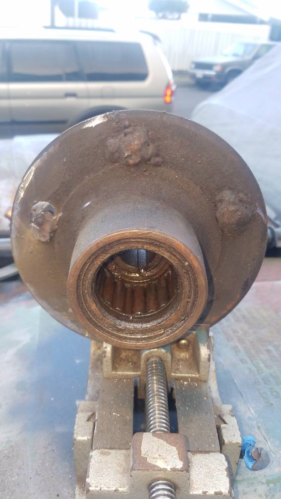

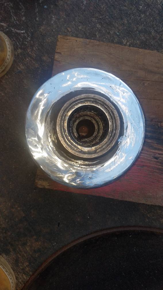

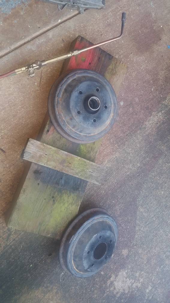

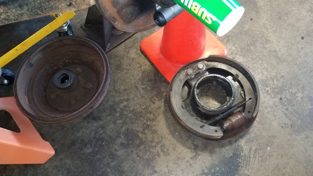

    Tried to order Drums for the rear....
    No one have 'em! ......Mac's "Maybe February".
    Luckily i found some on the rock...
    Front Setup - have to replace hubs...
    Thanks Lloyd!!..saved my okole Man!
    ...His cool rides.

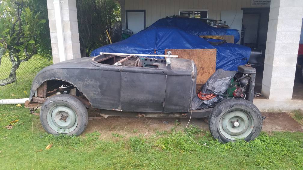

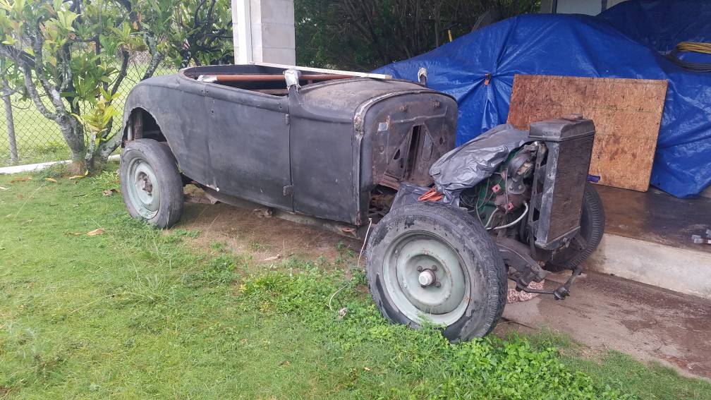

    My 30 Roadster on an Austin ch***is

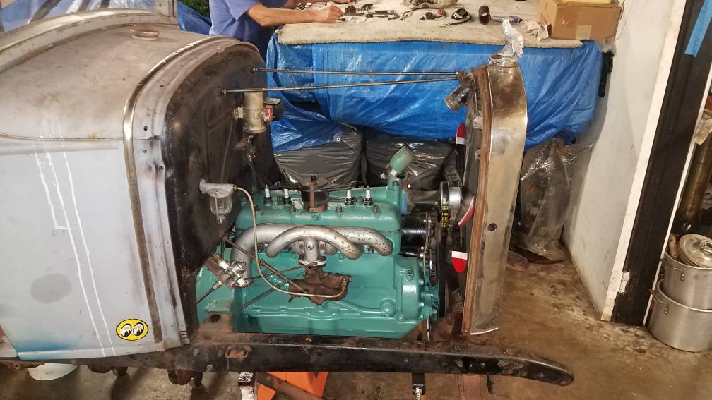

    12V + ground Austin Generator
    w. LUCAS bakelite voltage regulator. 20181107_203726.jpeg 20181107_203739.jpeg

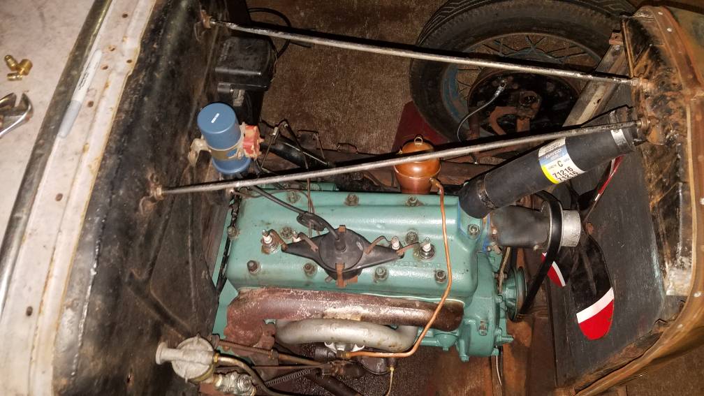

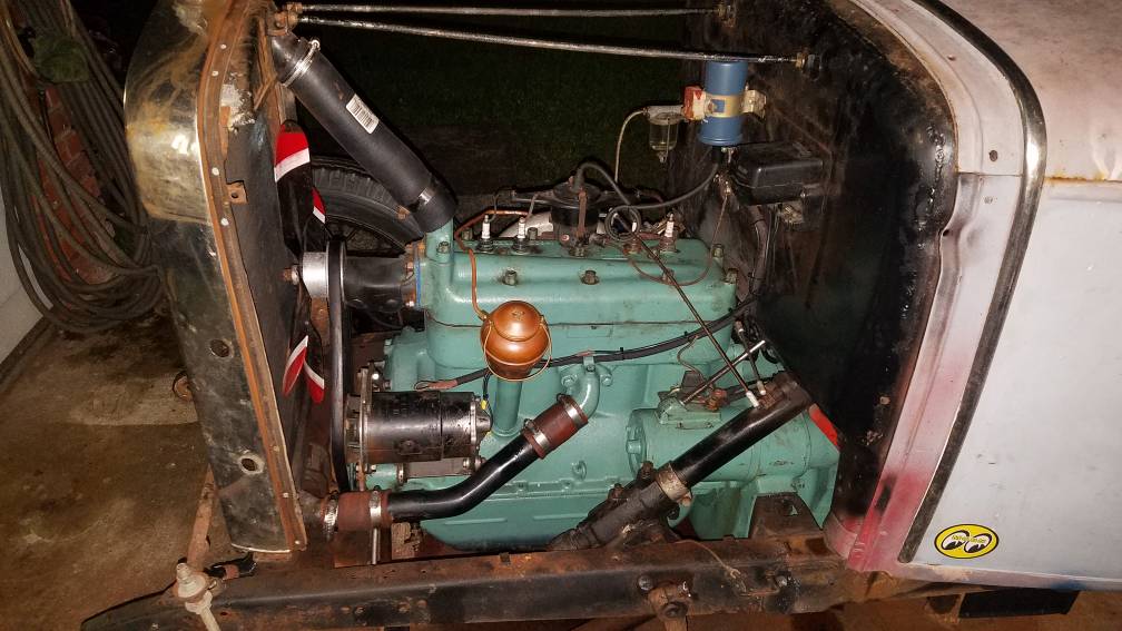

    first drive in a while...
    "New" Engine runs Great!
    Generator + LUCAS regulator 12.5 V... right on!
    New brakes stops on a dime!
    & mycket POS Dodge Magum started today....

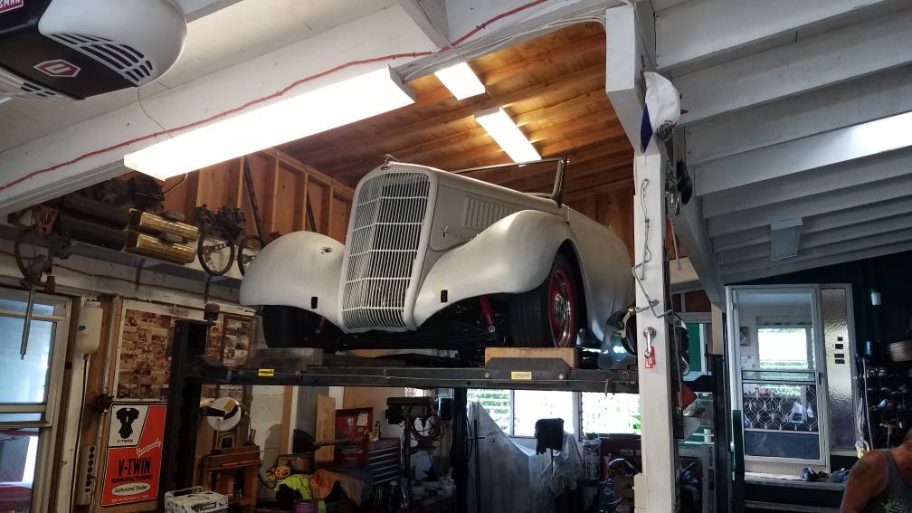

    Together:
    It fulfills two different styles, w. the same main idea..."Try No Buy Stuff - Use Old Stuff! Mo Bettah!"
    + One's a lot easier / faster to build!!!
    Different Fun!

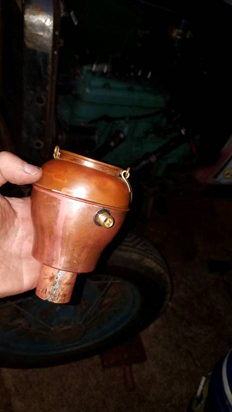

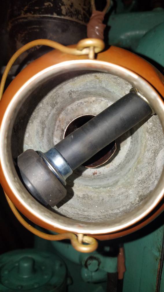

    BLOW BY...BUY BUY?
    Br*** Can from Svedala...
    But! It won't work without a PCV valve!

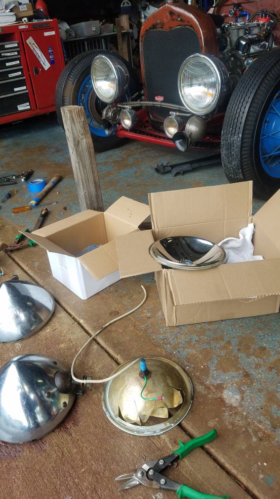

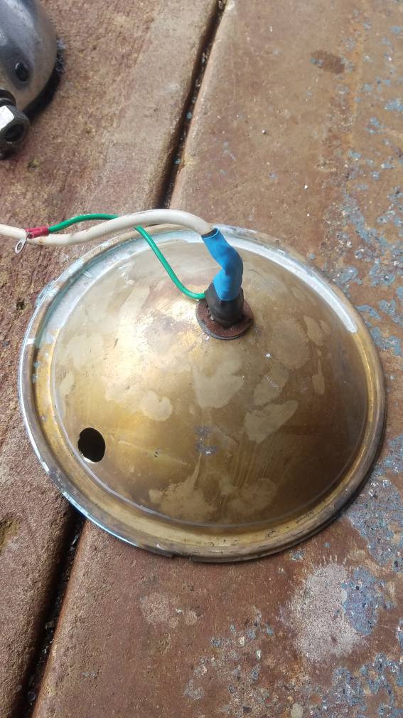

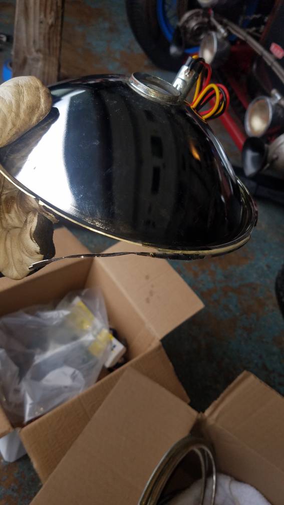

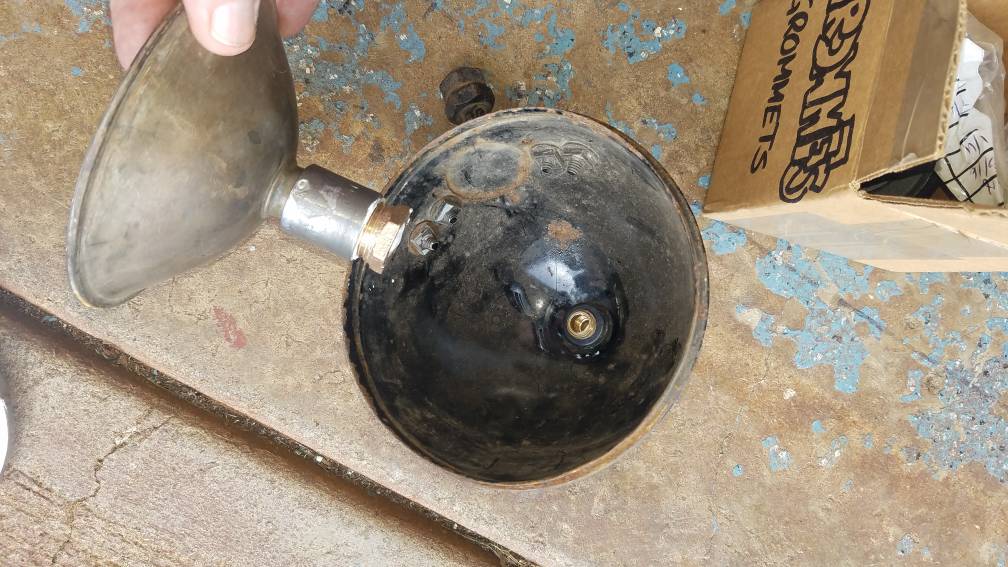

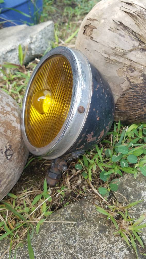

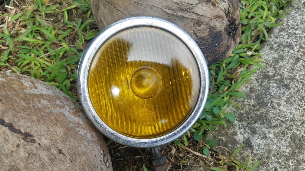

    Couldn't find a Halogen kit for 32 Es*** terraplane.
    Cut original lenses out and flanges on new lenses...
