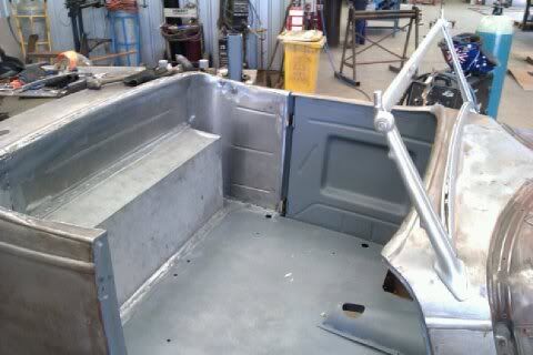

    benflathead
    Working on the panels in the rear and the base and back for the ****ie seat.

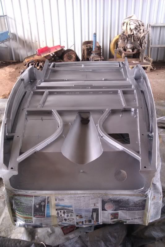

    benflathead
    Underside done. Etch primer seam sealer coupla coats of stone guard and a coat of 2k mettalic silver ish stuff....

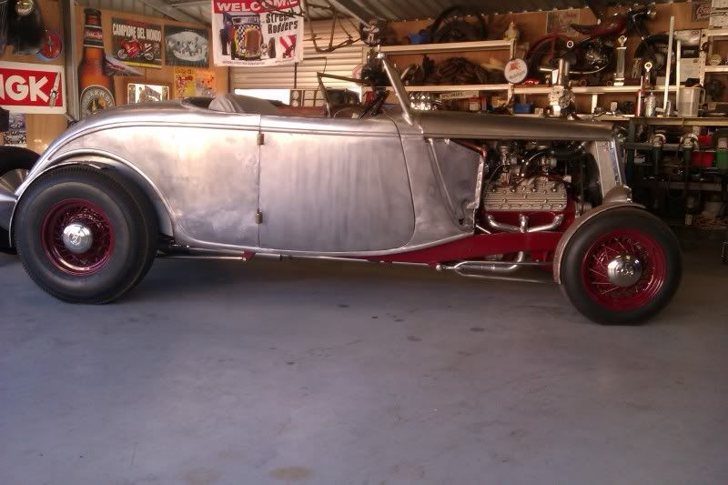

    benflathead
    Engine has had a bit of work:
    Ported
    Polished
    All fully sleeved,
    Relieved
    8BA Crank (gives us rope rear main seal instead of slinger
    Ground and balanced crank and rods
    New pistons
    New Valves guides and heavy duty valve springs
    Adjustable lifters
    Magento has been given the *** at this point due to issues so getting electronic Mallory instead for time being.
    Isky 400Jnr cam
    Navaro heads and racing manifold
    New 97 carbs
    8BA oil pump (higher flow)
    Powergen alternator to look like original Genny
    Hy Torque starter
    Now the cam caused a few dramas as when we sat the heads on and turned the ol girl over we found that the valves were lifting the heads about 3-4mm not a reall good thing. Had to take the heads back in and machine a bit more relief in em to clear the valves. Also created isssues with spark plugs and too long plugs have the spark gap reduced dramatically with the valves as well...... Just bolts in hey..........

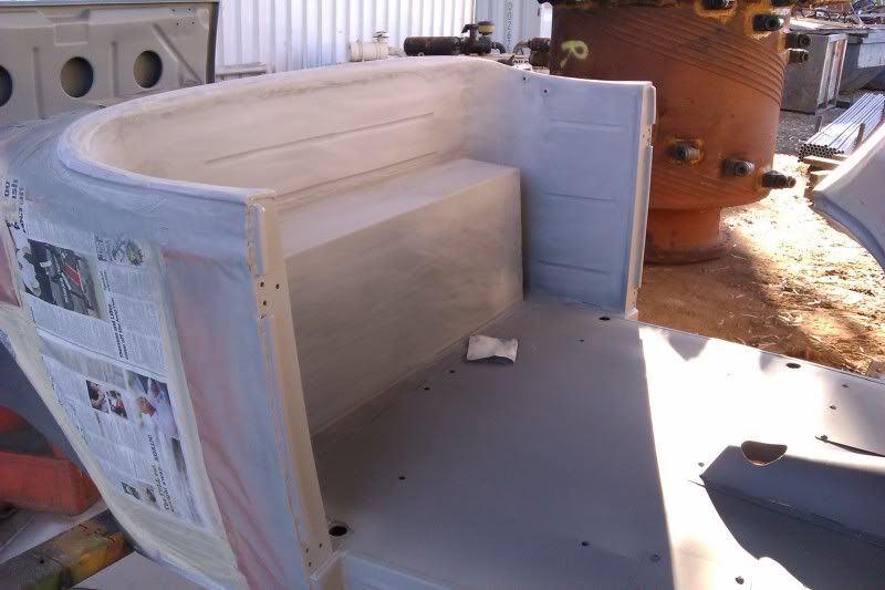

    benflathead
    Bit more getting the inside painted in 2 Pak metallic silver and the firewall sorted...

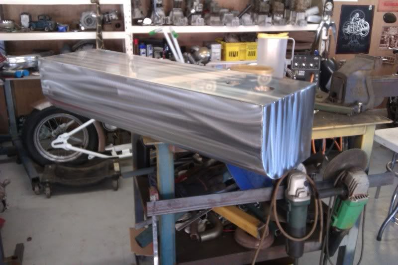

    HAve booked it for second inspection in Jan. Need to sort out mirrors cycle guards (flames I'm looking in your direction) and fuel tank...
    So fuel tank
    Pressed up one out of 2mm 304 Stainless Steel....
    Bit of a scotch brite and looks geed enough for us...
    Sender unit going in and filler point.
  17. benflathead

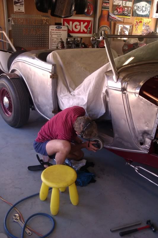

    benflathead

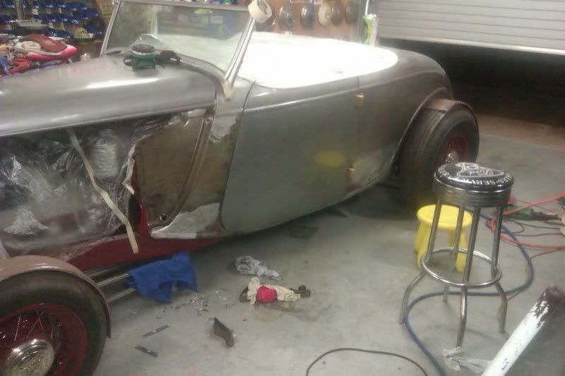

    Finally had a chance this weekend to get back to it. polishing and lead wiping....

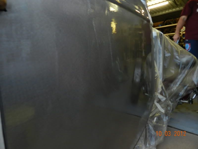

    had a couple of mate around last night to give me a hand (Drinkin) Al did a bit of mixing of the clear and we buzzed back the door and cowl side again and got a coat of clear on it. The brush strokes nearly make it look like Stainless steel...Nearly....
    Nearly....

    benflathead

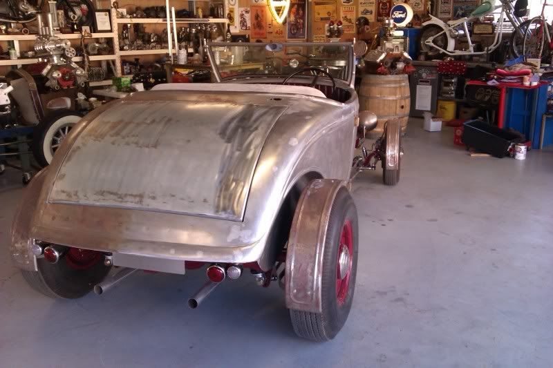

    Well have finished the R/H side and rear now working along the left. Got to finish it then sand the clear and apply a couple of more coats. NEVER AGAIN for a bare metal car. Have really enjoyed doing it its just so very slow. You get the lead on file it back to realise you didn't put wuite enough on. So you go back in again to put more on and the whole lot runs onto the floor and you get to start all over again. I must say the feeling of looking at it clear coated with all the little bitas of lead polished up is good. It is not perfect but very neat and dad loves it and its different......
    Last lot of lead hopefully in the car.....

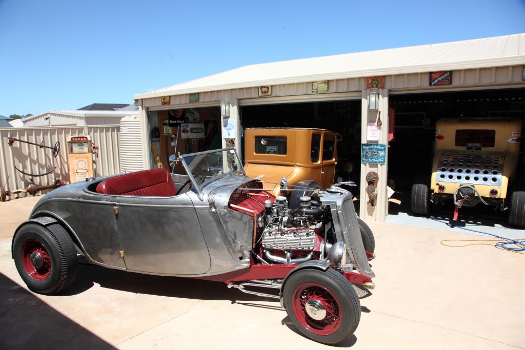

    after many many many ****** hours on the body we have given up an got her in clear. the left door still needs adjustment but at least it will stop ****** rusting everytime I look at it. Mt 6 year old and dad/owner of the car put the last of the clear on yesterday. just go the guards an brackets to paint and clear nad just about there. Aiming for rego inspection in MAY......
    Arty shot to finish...

    finished off the little bits. Off for liscenece plates this TUesday. So say dad's not a little excited is an understatement. Should be able to post pics up on Tuesday of the finished article. then on to the next project................

    The roadster is looking great, real nice work !
