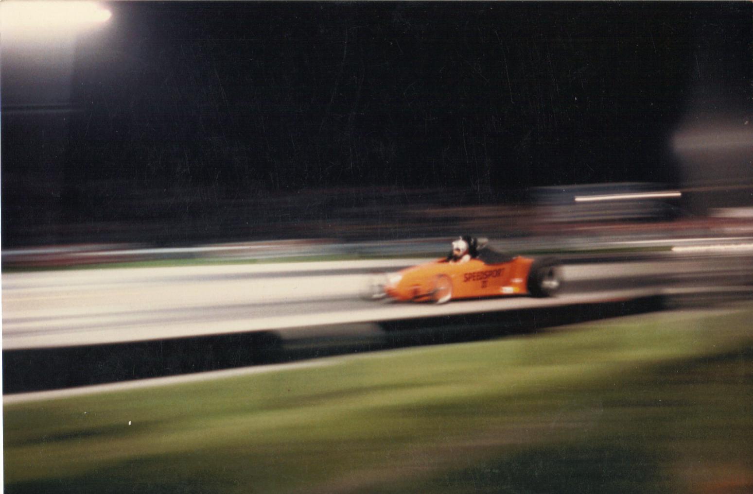

    Being outside give the car a whole new look, Looks fantastic , Dave, Here's a pic to keep you movtivated, If I remember right this was Rex Stevens replica of the Speed sport car , his First p*** at K C !987,,,,, Tim Jones

    I never seen that pic of the SpeedSport II................That car has a longer wheelbase than the original or mine.......and it should be longer !....My neighbor walked over soon after I pushed my car outside .....and only said '' Something really wrong w/ you''....then walked back to his yard....and the other neighbor walked over and just said ''Looks dangerous''.............and walked away........Littleman

    I shot that pic when they first took the car out, thought I had more but couldn't find them last nite,,, the neighbors out here said the same to me when I had the Comp coupe pushed outside for some pics:D,,,,, Tim Jones
