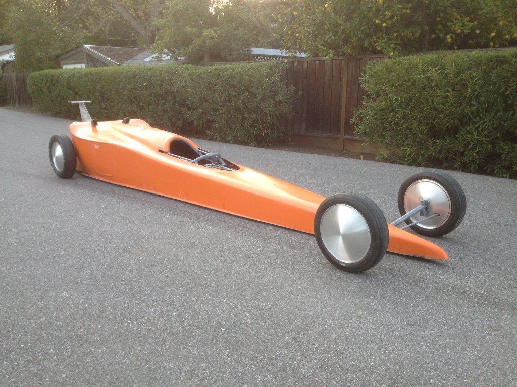

    In case you didn't see this one. Nearing completion.

    Thanks for posting the pic...it reminds me of some of the early attempts to full body a dragster....neat...and am I sure it is built real heavy for it to handle on the salt and or lake bed......Littleman
