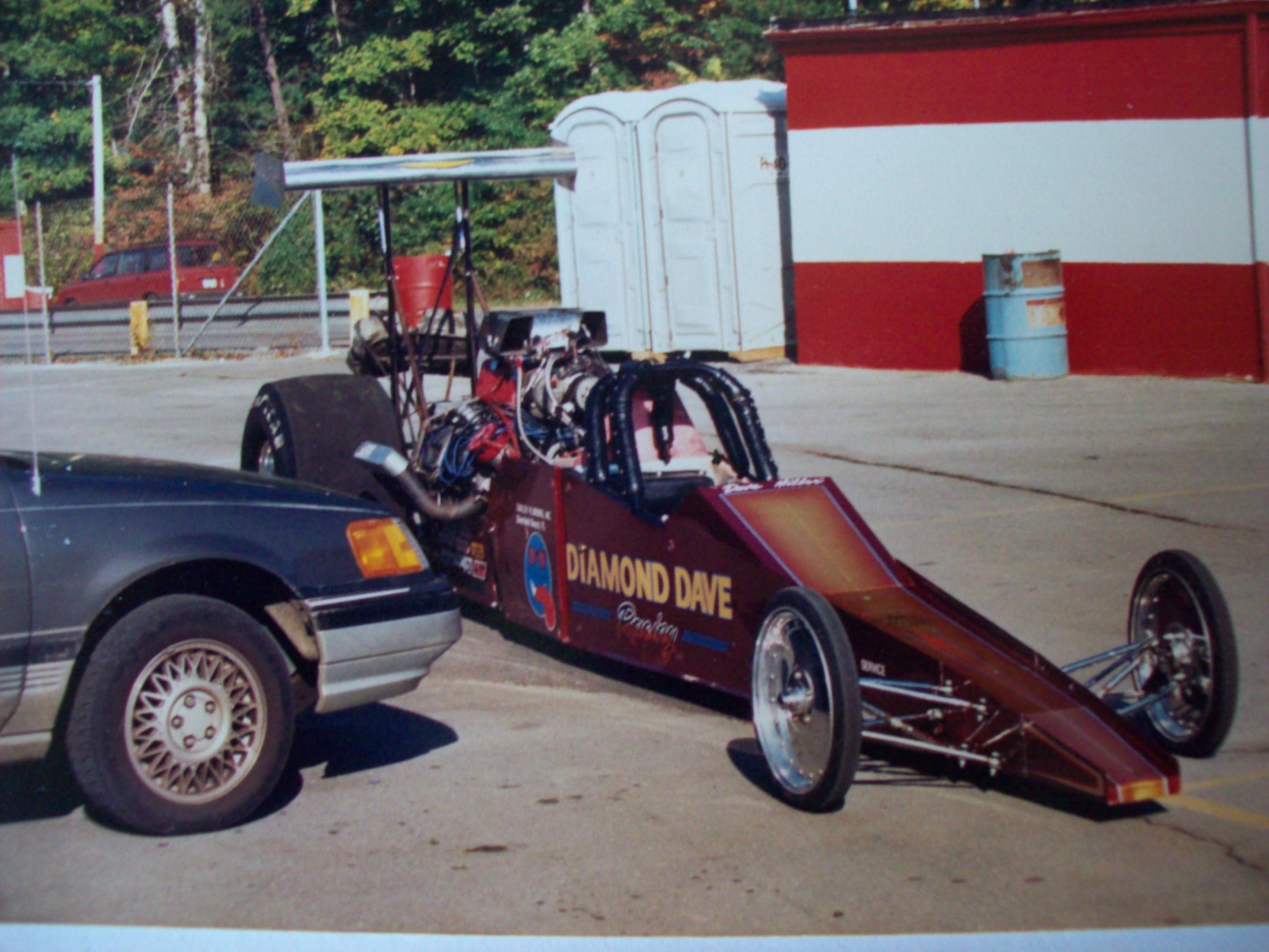

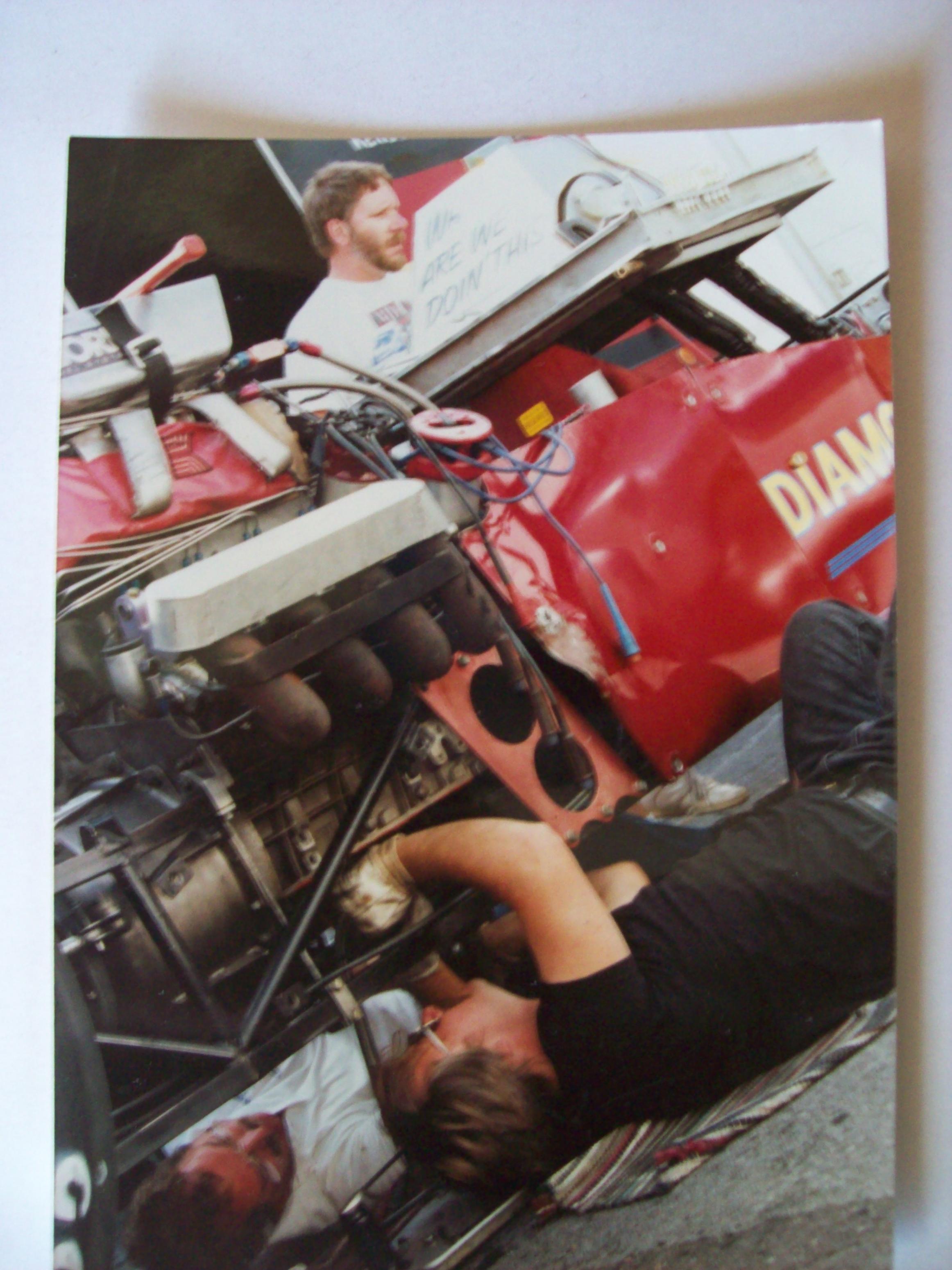

    you do some really nice work Dave, I worked Dave Miller's short Top Fuel car , Dave always told people that he drove by the seat of his pant's, If one ***cheek was up he steered the other way:D, BTW your drivers compartment looks a hell of alot safer than dave's Did :eek:, , Tim Jones

    That is a neat car...never seen that before......Do remember the wheelbase on it...just curious ? And what yrs did it run..How fast..looks on the short side for the era......Thanks for posting, Dave
    And yes...I am hoping to have a strong pilot compartment since I would be the first on scene to any head on smash-up....I am adding another diagonal on the sided in the leg area, still need to do this. Decided on this after a racer was killed @ our local track this summer from a guard rail that came thru the car during a wreck...May he rest in peace........

    Hi Dave the wheelbase was 200 most the other car were 300 back then, Ran in the late 80's , My daughter had a photo album that had a time and speed of 5.37 at 270 MPH ,I really don't remember where this was at, most of the time we ran in the 250, 260 MPH range, the car is at Garlits musuem now, Glad to hear your adding some more bars in the drivers area, I remember seeing the pics of the car you spoke of Very sad deal, Tim Jones

    Diamond Dave Millers shorty top fuel car was awsome. Got to see it run in Spokane Wa.
