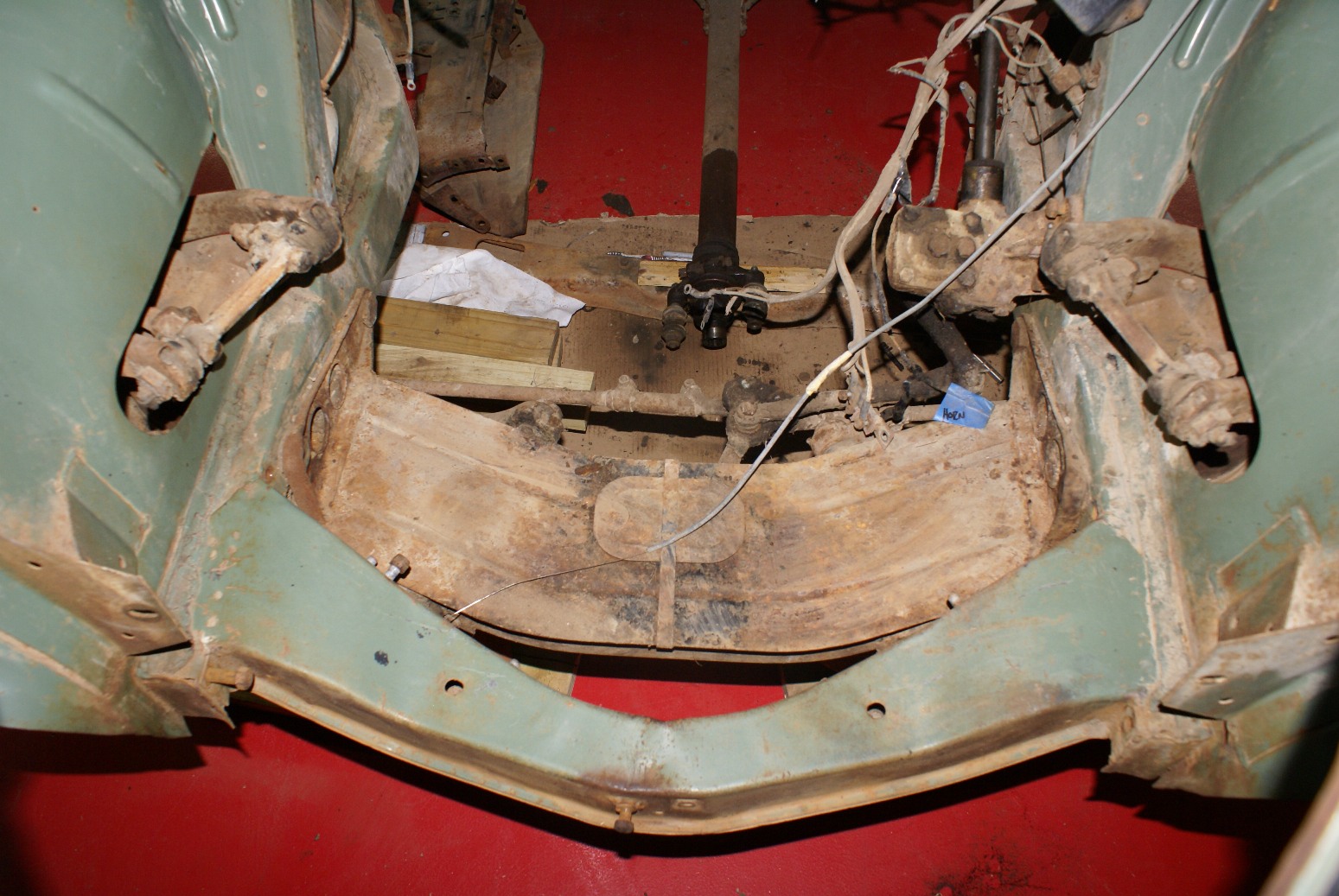

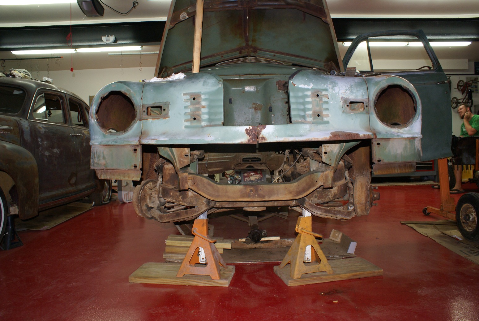

    Oddly enough our outer rockers and ch***is are fine. Cosmetically you can't see any thru rust on the whole car. Our inner subframe up front by the crossmember is poor. Once the front floorboards rusted through, water fell into the subframe and ate away a substantial portion. You'd never know from looking at the car. You need to crawl underneath to see. I'm sure its a byproduct of the car sitting out in a Kansas field for decades.

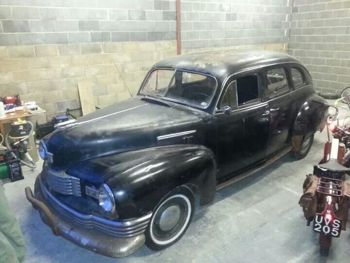

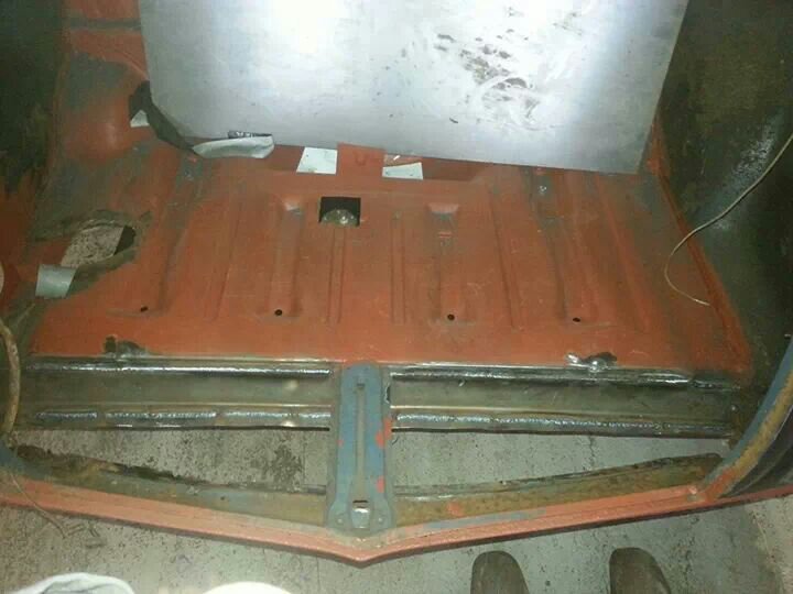

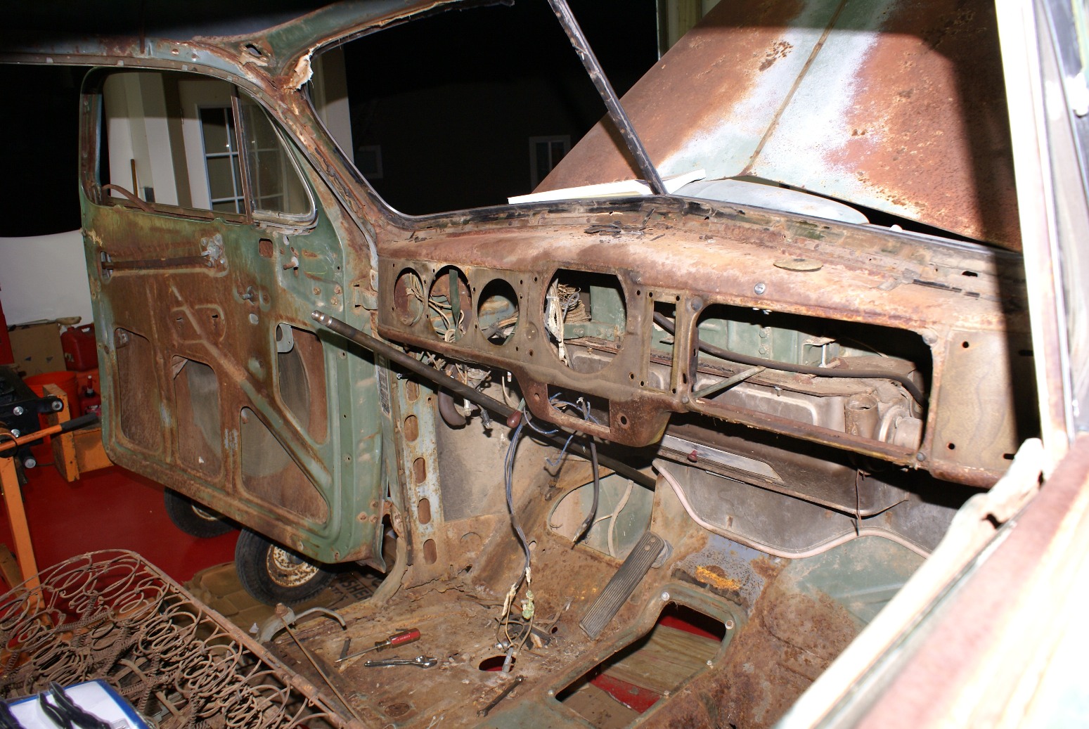

  9. v8spence
    Joined: Jul 27, 2004
    Posts: 137
    v8spence

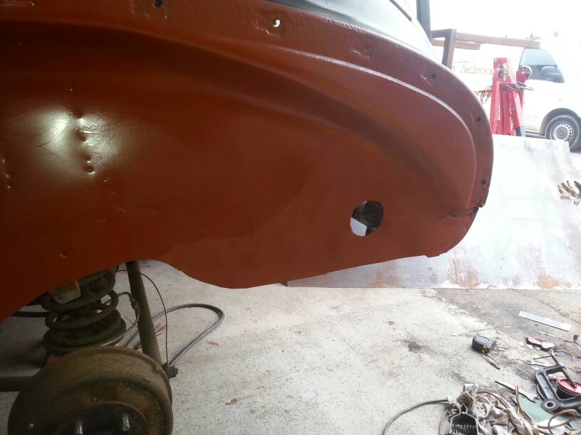

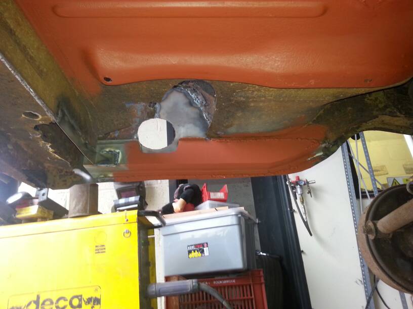

    The first 2 pics are from when I picked it up, the next pic is after blasting the wheels, painting and laquering and then polishing the trims, fitting beauty rings and fitting whitewalls and the last 2 pics are of the rear left inner wing which was badly rotted away so I had to make a new ch***is leg and outer section. This has been moved as we made a new fuel tank which has moved the filler neck further back a little. 1389791491785.jpg 1389791511274.jpg 1389791558091.jpg 1389791605981.jpg 1389791618051.jpg

    Old girl looks great Spence! Nice treatment on the wheels. You're not hijacking the thread at all. There doesn't seem to be a whole lot of Nash info here on the Hamb, so the more the merrier.
    You don't want to come over here and do some welding on mine, do you? :)

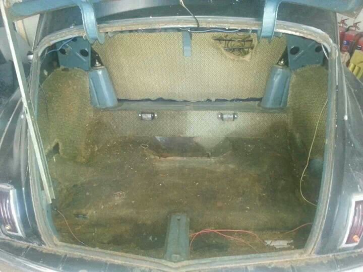

  15. v8spence
    Posts: 137
    v8spence

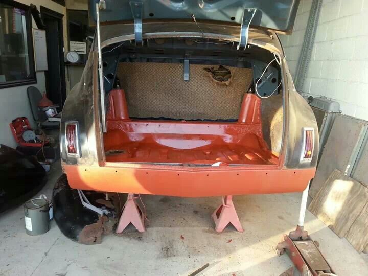

    Some more pics of the rear rebuild.
    Stripping out the trunk, cleaning up and removing the rust, bending new steel to fit, making a new fuel tank, modifying the tyre well (oops, tank was a bit bigger than I measured) and then sealed with lead paint.

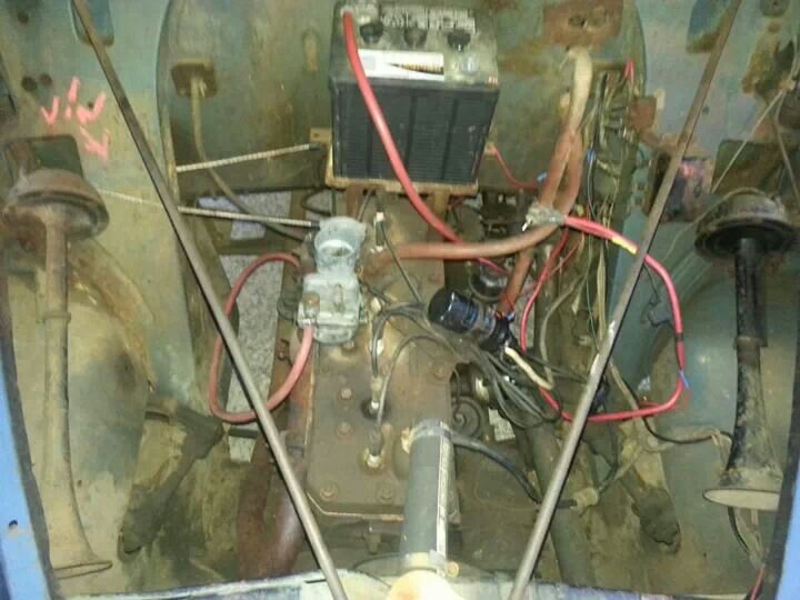

    Under the hood, this is a bit messy, home made battery tray bolted to the head! Original 54,000 mile motor? A bit of tidying needed very soon I think.

    Looks to be the same as ours Spence. Different air cleaners, and our battery is located under the drivers floor if memory serves. Your tray probably corroded and the battery moved to its current location. Ours is intact but will need to be replaced.

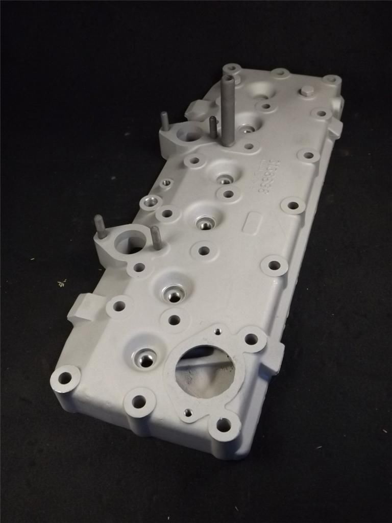

    Not sure if this is the exact unit, but we were looking at the statesman dual carb L head.

    Now that looks trick. What would that set you back $?

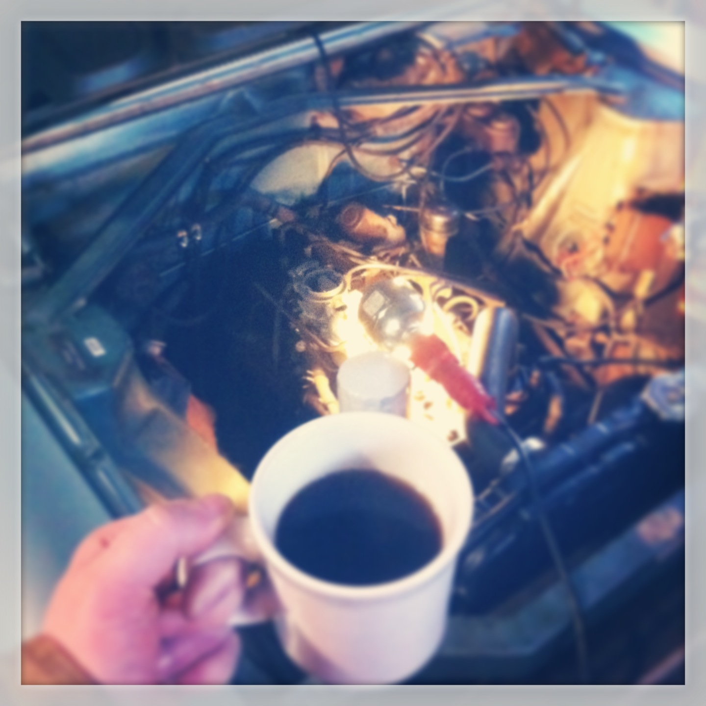

    Joined: Sep 16, 2001
    Posts: 6,741
    Bigcheese327
    This is where that Rambler connection may come in handy: The oil filter from something like my '64 American would work (seen just above my coffee cup in the only picture I have handy). Or you could use one of those remote, beehive-style filters sold by the likes of Speedway.
    That Statesman head is a beauty. I've only ever seen the Edmunds ones before.
