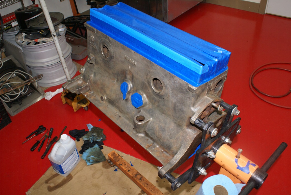

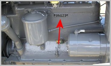

    Here's our color match (after a bit of research). Tractor supply sells Majic Brand enamel farm implement paint. Their gray is about as close as we expect to find for our block. $4 for a can so this job isn't going to break the bank.
    this weekend maybe? When the weather warms up a bit in central Texas.

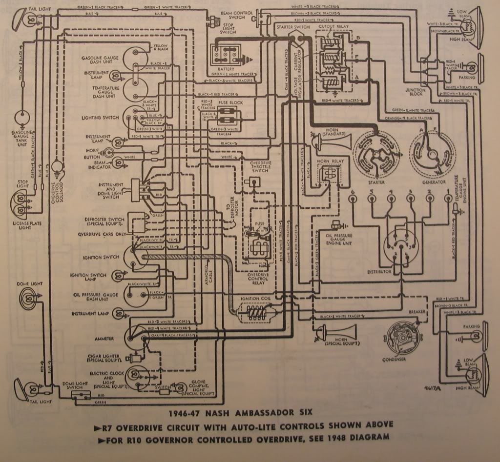

    ok, having a mega long weekend this weekend on the Nash so hope to get more of the wiring done, carb sorted, paint on the dash (i know, I work backwards) but what I need right now is....
    A wiring diagram for the Nash, anyone have one they can scan and send to me please?

    Here's one we pulled from a 46. I think gmpenn posted one in his galleries as well. Hopt this helps spence!

    great cheers, just ordered some 30Amp cable for the lights and charging circuit.
    Also, found a company in the UK that sells a regulator box you connect to a 6V dynamo to give you 12V charging at 22Amps. that may be a good option.
    Only £49 too so cheaper than getting the dynamo off and rewound.
    just waiting to see if I can use it or if I have to stay at 6V.
    cabling designed for 6V anyway so 12V is a breeze.

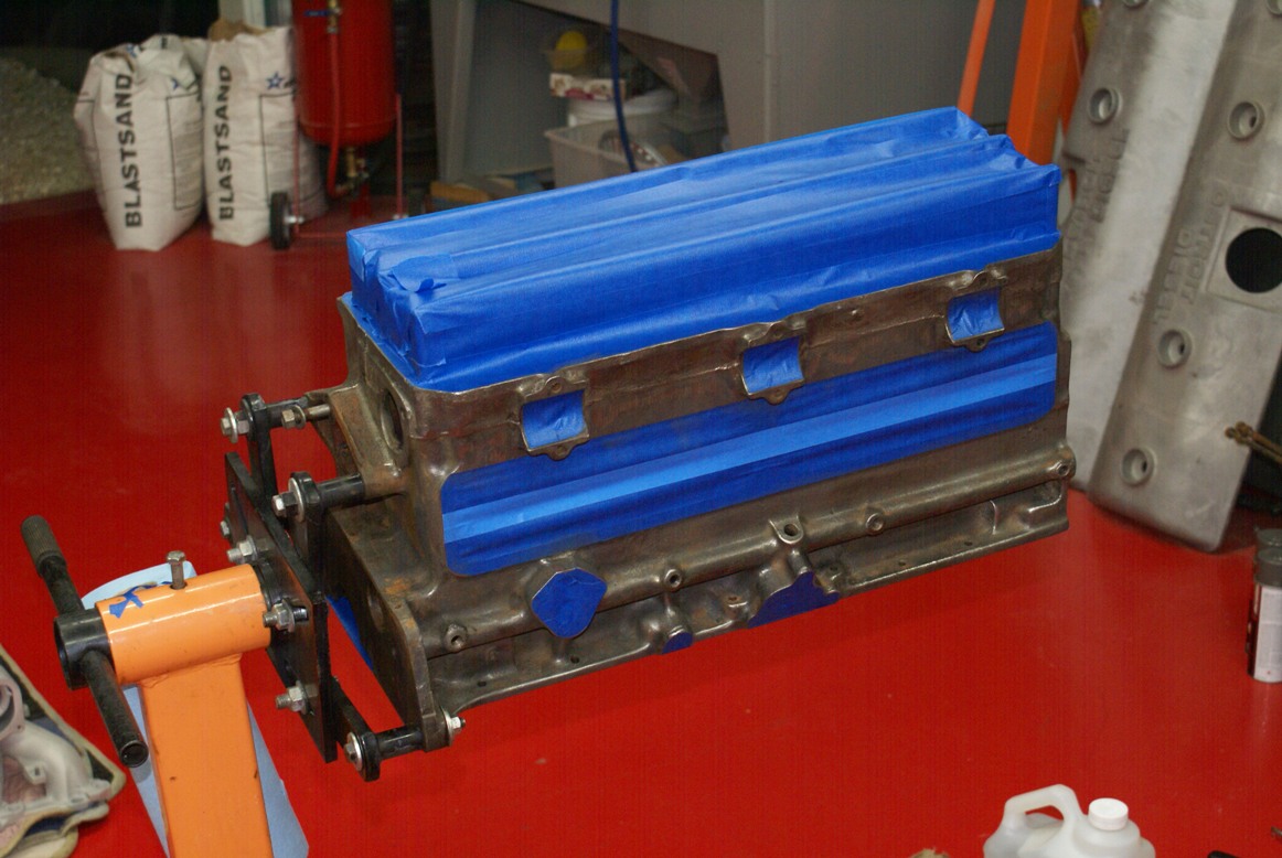

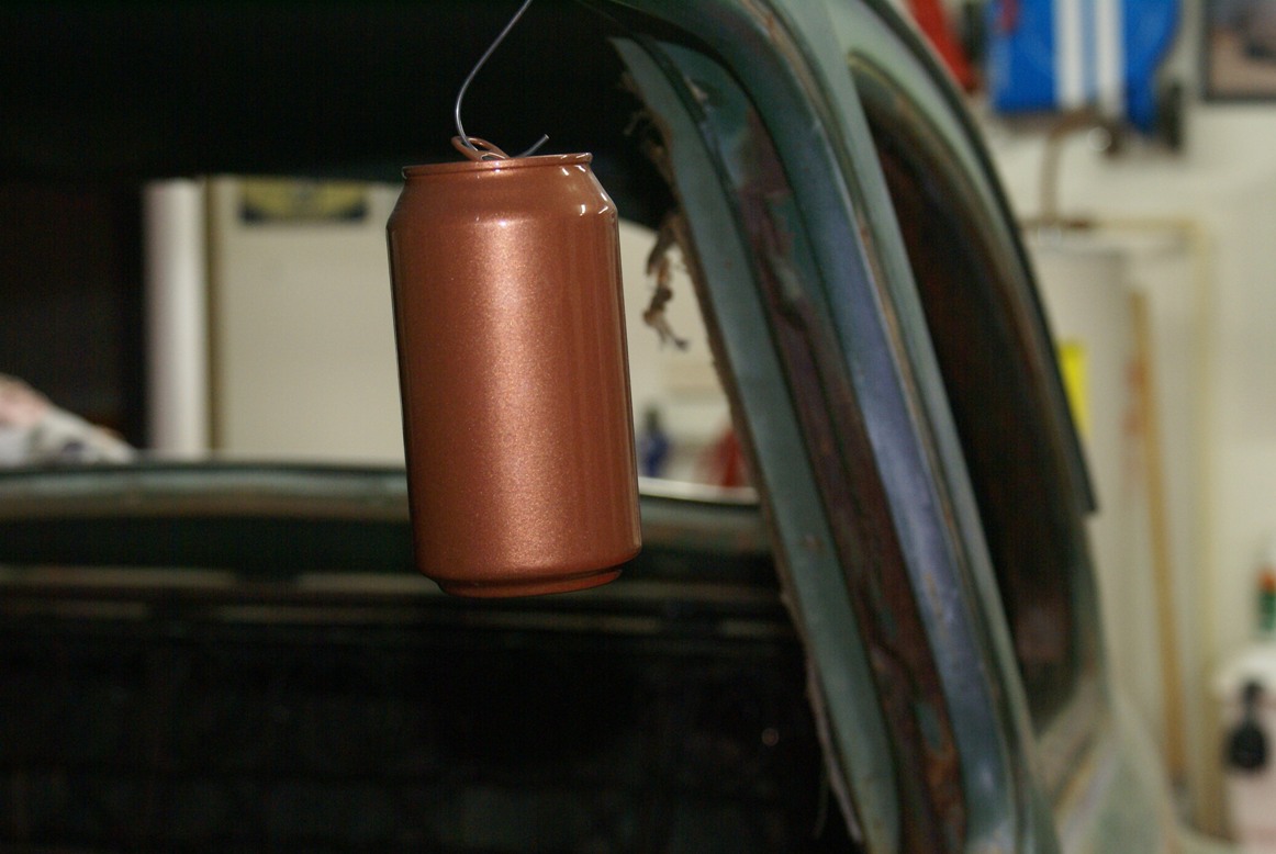

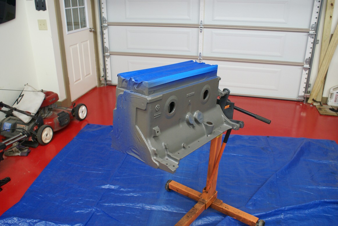

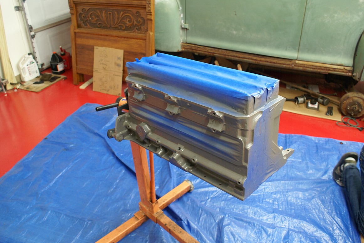

    Finally got our block painted last night. Needs another coat or two, but looking great. Moving along to ***embly next week. This is the Tractor Supply farm implement paint I talked about earlier. Good, thick stuff that takes forever to dry. Hopefully pretty close to what it would have been originally. Close enough for us anyhow.
    Something interesting we noticed. The casting date on the block is '47 while the head is '49. Mm.. Something happened to the original head in the distant past and she received a new one. Too bad we'll never know.
    And, a few other misc pics because they're fun. The pop can is a powdercoat fine bronze metallic. We'll be using it for our steering column, heater box ***membly, metal window trim and other interior accent pieces. We've decided on a white dash, but haven't nailed down the hue yet.

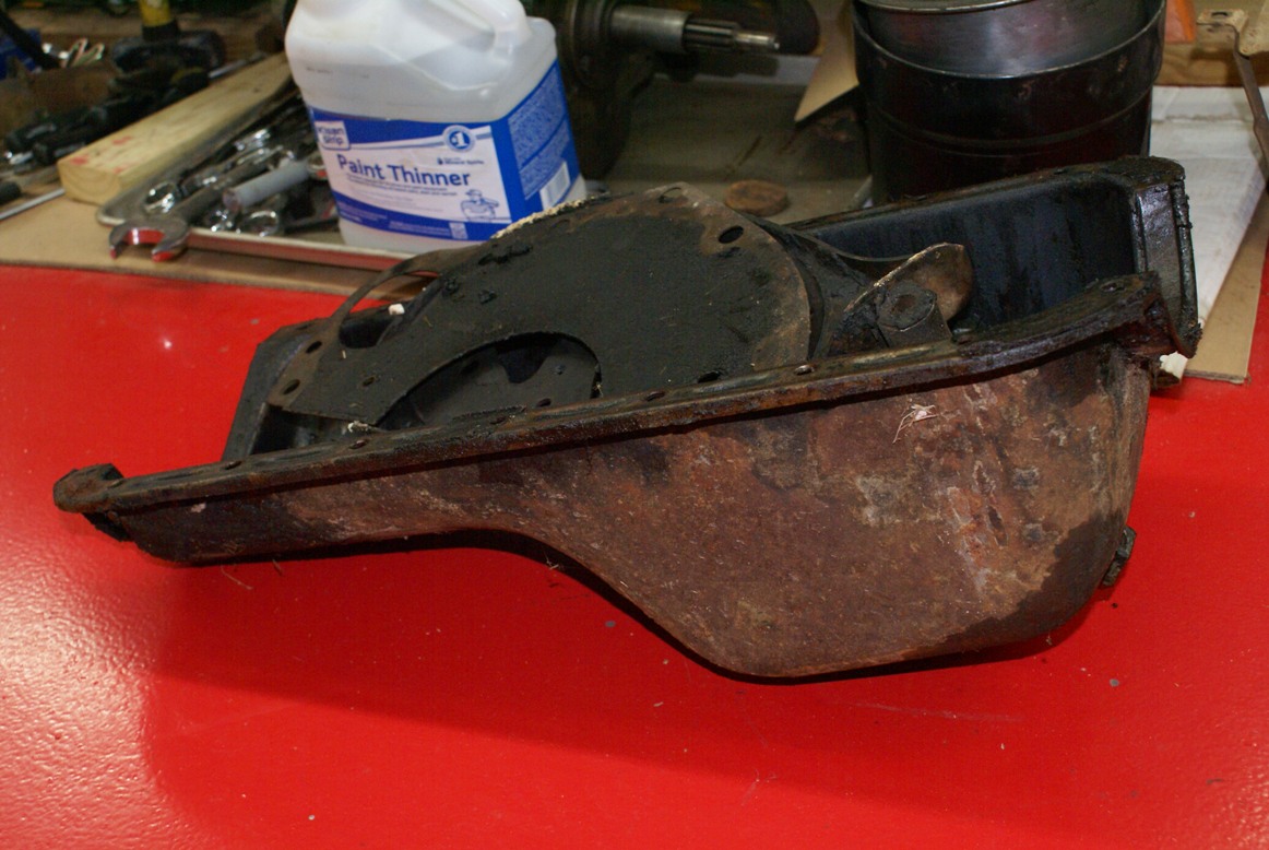

    And, some other bits like our oil pan still need to be cleaned, prepped and refinished. Lots done, lots to do still. But, getting the block in paint feels good.

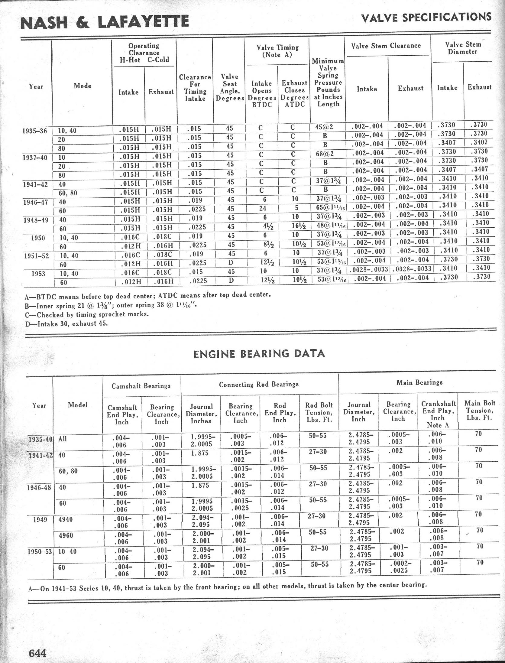

    I have been trying to upload a few docs hop it works

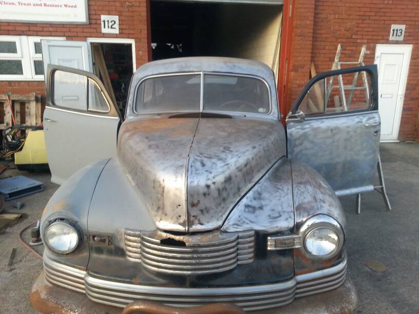

    A few pictures of mine. I am stripping it down to the metal where I can. So far 100% solid in the panels. 1393183085836.jpg 1393183107272.jpg 1393183121505.jpg 1393183157550.jpg 1393183190561.jpg

    A bit more paint stripping today....
    I am also very tempted not to put the lady back on. It makes him look wider and lower in my opinion.
