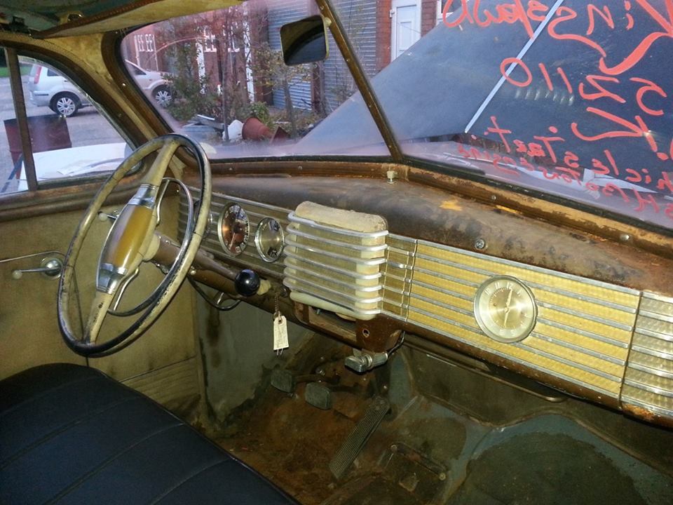

    I needed to remove the dash as the wiring loom was cracking and causing problems and when I removed the dash the windshield had leaked causing rusty patches.
    So, I rubbed them down and zinc primed the dash.
    The parts of the dash I took off, I rubbed them down and painted them gloss black and polished the raised edges.
    I then found a couple of tins of old copper paint (god knows why I had them!) and experimented by spraying the dash!
    I was impressed so I chucked a couple of coats of lacquer over the top and tested the alloy cover out.
    I have to say, I love it!

    Spence, that is COOL man! Your copper looks surprisingly close to our trim color in post #108. Our dash will be white though. Keep the progress coming. :) The black ribs look great! We were able to save our heringbone pattern by scrubbing with a toothbrush and some toothpaste. They won't ever look new again, but we're attempting to keep the dash original best we can.

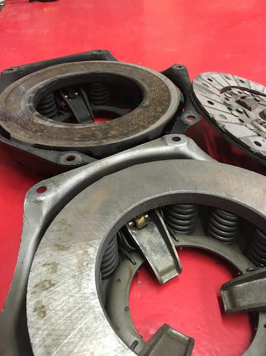

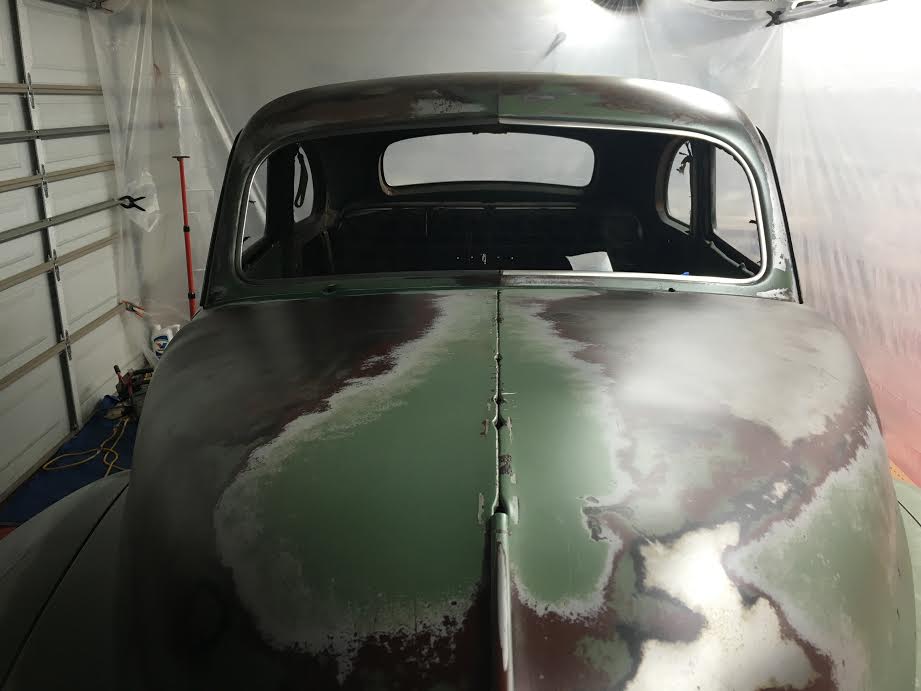

    well.. we're back... I think its been a year or more? The ol' Nash is still in the garage, but not forgotten. We're getting ready for our low-gloss clear. Hoping to apply either this weekend or next. We've also picked up a few bits and pieces over the past year off e-bay. NOS clutch and pressure plate and a few other things we'll need.

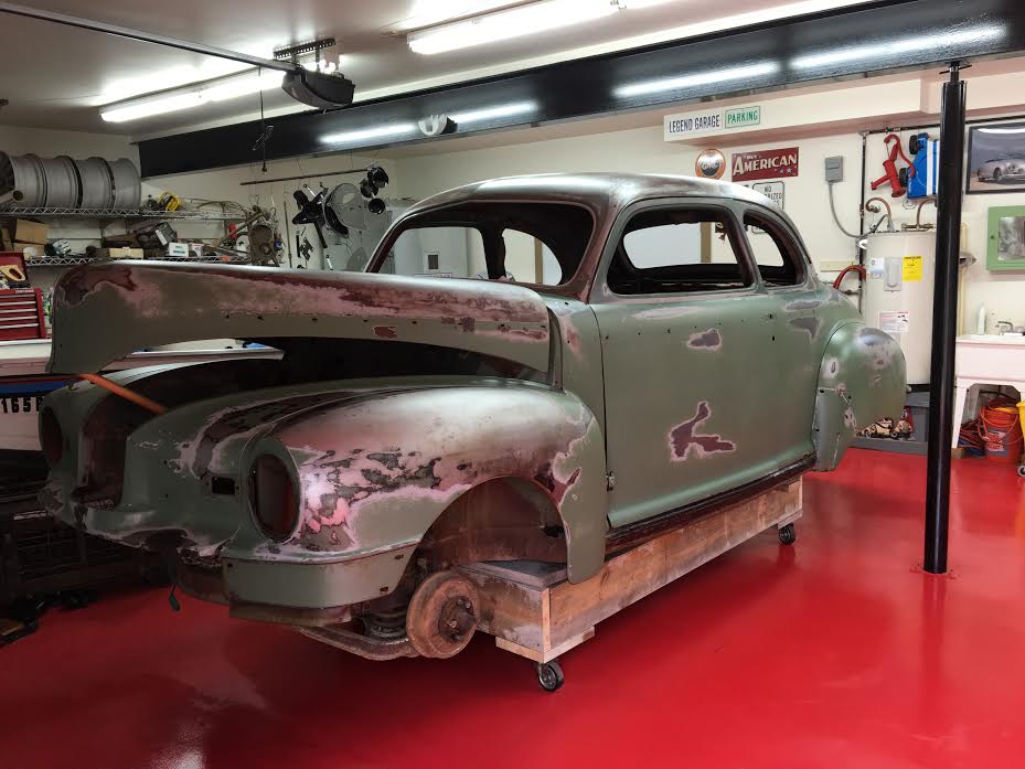

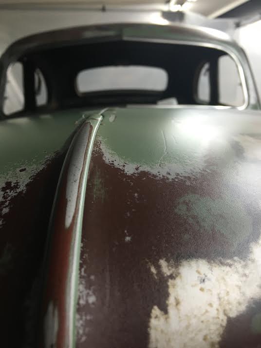

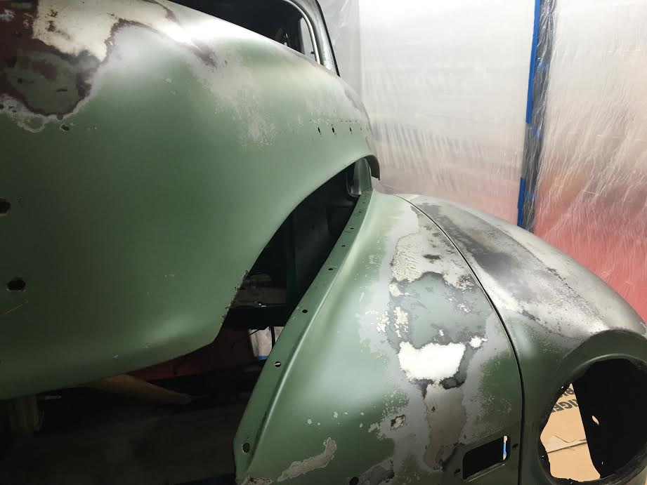

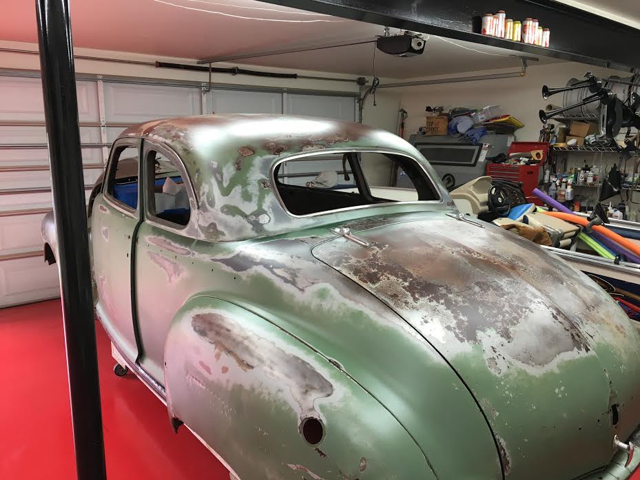

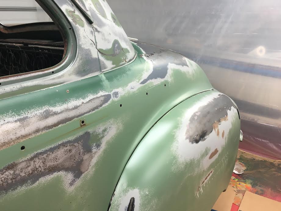

    Low gloss clear DONE. We had a great laugh once things started to dry. "hey Clay, looks like we didn't do anything now that its dry. Is there really clear on there?"
    "yes. yes there is."
    The low gloss did even out the finish quite a bit and it does have that silky, smooth, satin look and feel. Overall a huge improvement in the overall look as well as protecting our rust. We're extremely happy with this as a garage paintjob. Now, time to start polishing our chrome and reinstalling. This will really be the fun part. Putting her back together. :)
