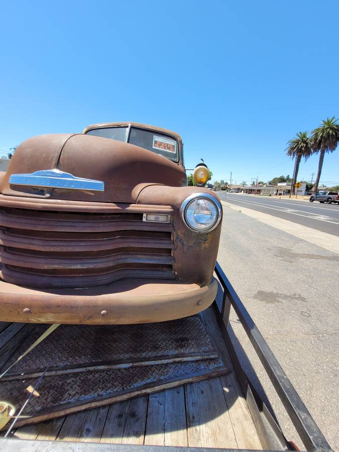

    Hey guys, I’m looking at a 52 Chevy 3100 truck for sale & can’t quite tell beside the cab corners being rotted what all is wrong with it.
    are there other common areas on these that tend to rust/other problems etc..
    Any advice is greatly appreciated.

    The lower front corners of the cab/firewall are bad spots on some as well. It's a truck that most everything is reproduced for so a little bit of rust isn't a big deal if you're capable of the sheet metal work or have a good shop that is.

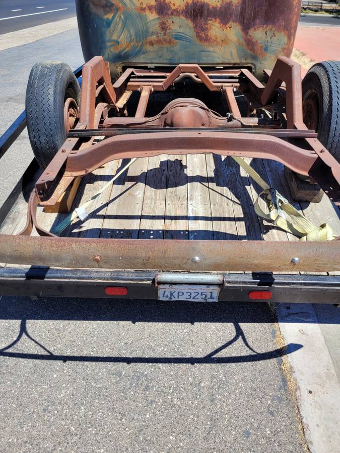

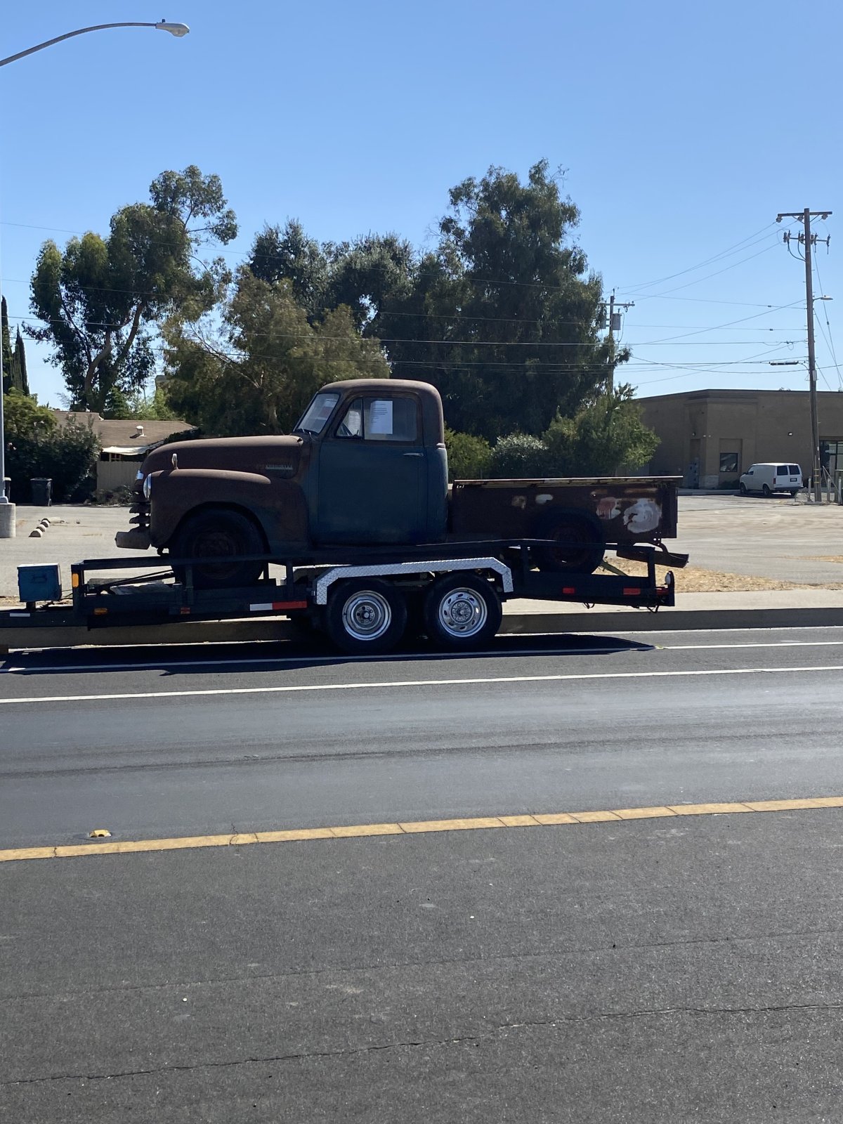

    5CBB2CE1-9EAC-4236-BE7B-4F9B09CBF30D.jpeg D602B995-62FD-4BF7-8113-4FE2BDFBEB46.jpeg 7839042D-AC6F-4D87-A410-903942DF9F48.jpeg 998CF15C-7B77-4B1E-B28B-7D5BEECCA517.jpeg 5CBB2CE1-9EAC-4236-BE7B-4F9B09CBF30D.jpeg 7839042D-AC6F-4D87-A410-903942DF9F48.jpeg 998CF15C-7B77-4B1E-B28B-7D5BEECCA517.jpeg

    6 lug. You mentioned Ford rear, so that’s why it 5 lug in the rear.

    Hey, I’ve been driving by that truck twice a day, M-F on the way to and from work.
    The bed must have been recently sat on there. Didn’t have it before just the big C Notch.

    Aside from the cab issues and no ***le, take a look at the rear frame. That tall c notch looks like it could be removed and the frame repaired as they haven’t cut out all of the original frame yet. Those rear bars running from their home made crossmember back to the rear end tells me that whoever was working on it didn’t know what they were doing. Can’t tell if they’ve removed the original spring hangers or not.

    That C-notch and rear suspension don't look like the person understood suspensions.

    the rear suspension is pretty messed up but being that it came with a good running 250 I think I’ll start by trying to get it running then work on the rear suspension.
