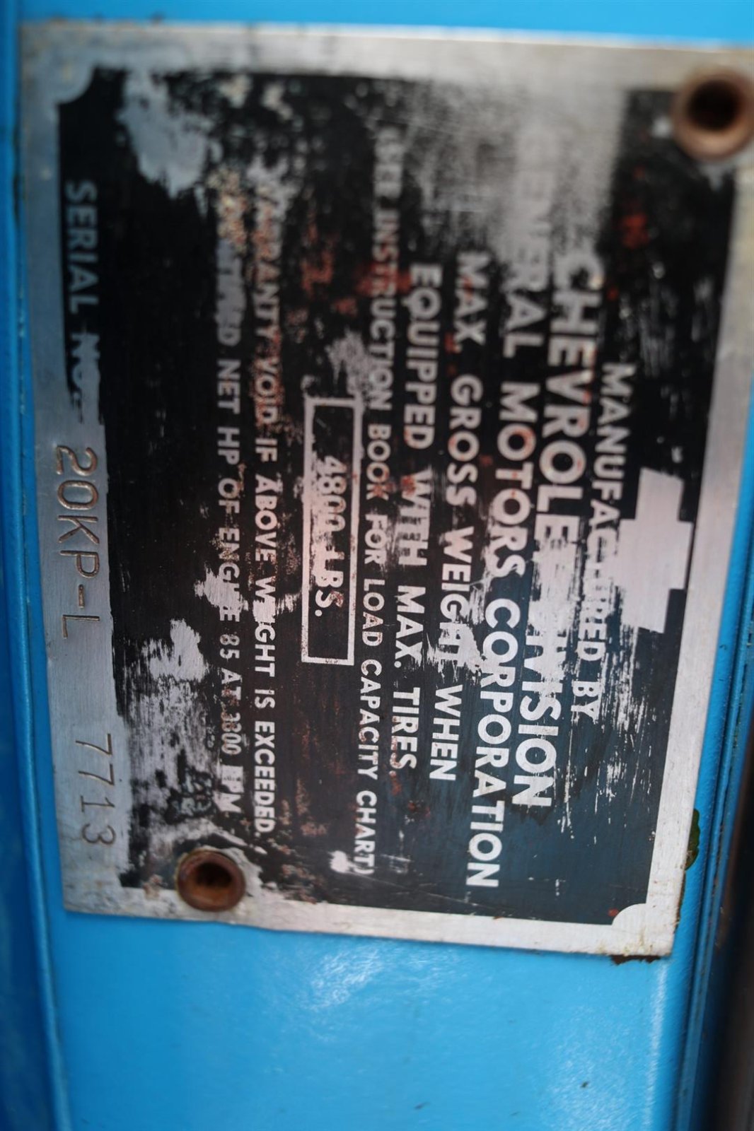

    Do not do a single thing with it until you have a ***le for the vehicle in-hand.
    Make sure that the tag on the driver's side door hinge post is present, and has visible numbers.
    Make sure that you have an actual DMV bill-of-sale form filled out by the seller.
    Go to the CA DMV website and find form REG31. Print out a copy.
    Find a local law enforcement officer and ask politely if they will verify the numbers on the truck.
    Cross your fingers that the DMV accepts the form when you go to register it. If they do not, you will need to trailer it there for them to do it. Cross your fingers that they accept what they see. If they don't, you will be referred to CHP, and they will verify it.
    None of this, contrary to popular unfounded belief is hard to do. You just need to follow the proper procedures, which include being cheerful, polite, open to suggestion, and treating the DMV workers with the utmost dignity and respect.

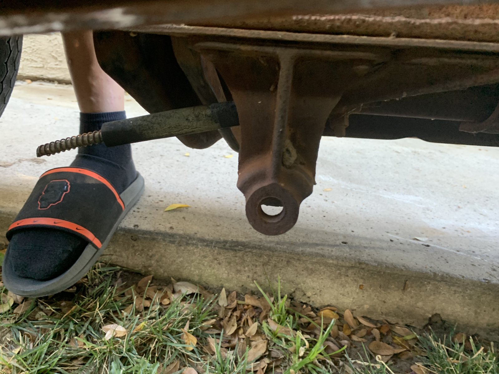

    Everything on the rear needs to be done over, but you can keep the axle.
    The design of that suspension is seriously and dangerously flawed.

    This is what the tag on the driver's door hinge post should look like. It is in this orientation, on its side, with the serial number line closer to the door.
    It has unique rivets that at NOT pop rivets or screws.
    If it goes to the DMV or CHP they know exactly what they are looking at, and if it is wrong, including the typeface and positions.
    Open your door and make sure that this tag is there. If it is not, then you don't own a truck. You own truck parts.

    Gimpyshotrods, would I need both the bill of sale completed by seller & the reg31 form? I made sure the tag is there. It’s weathered with most of the black paint having wore off but the thing is stamped in the same fashion as the one posted(Oakland,1952,3100,October & sequence numbers)& the two rivets one on corners opposite of each other. I Hope to God I don’t need to trailer it there cause I don’t have a trailer. I’ll be finding out this coming week.

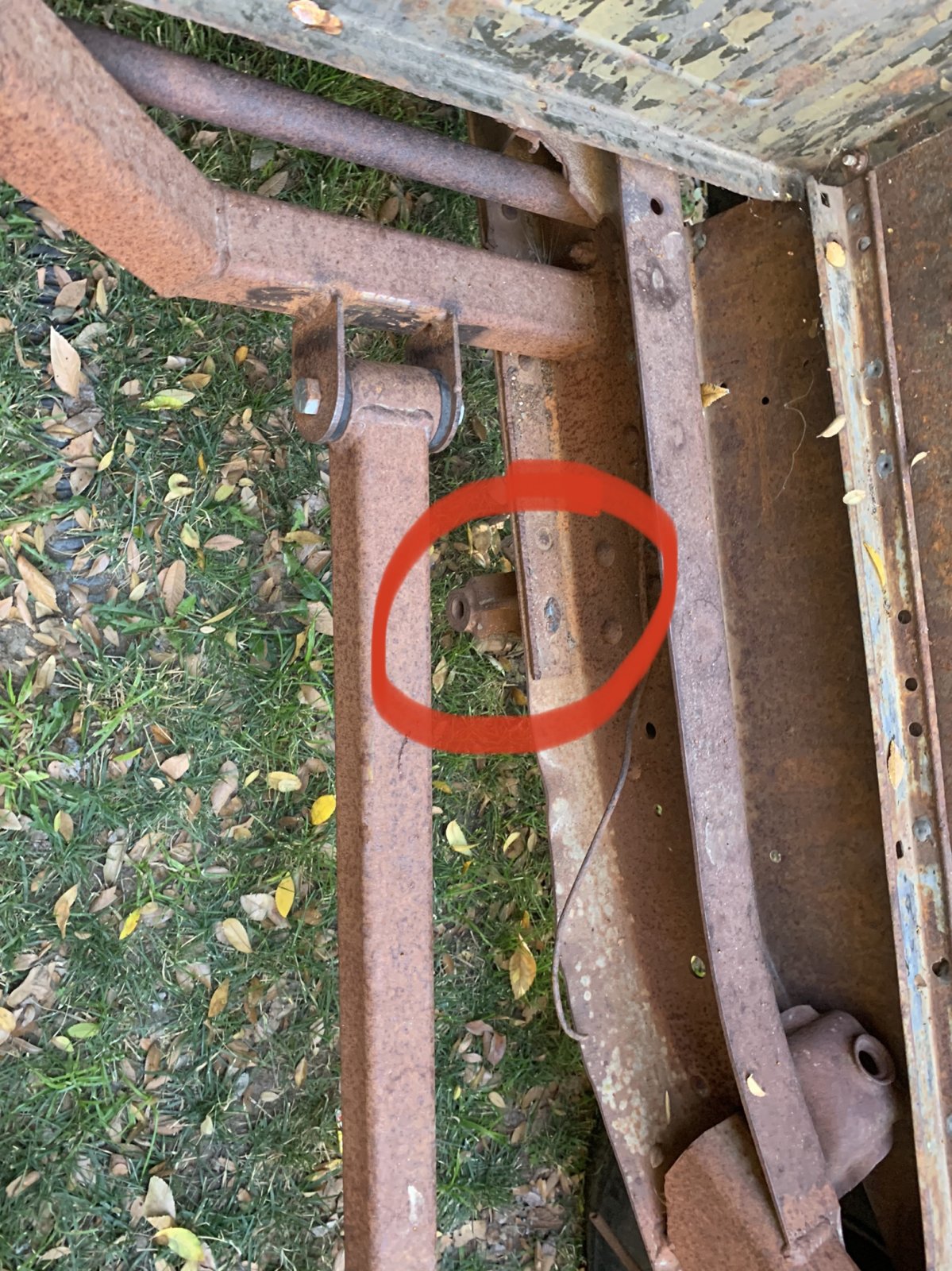

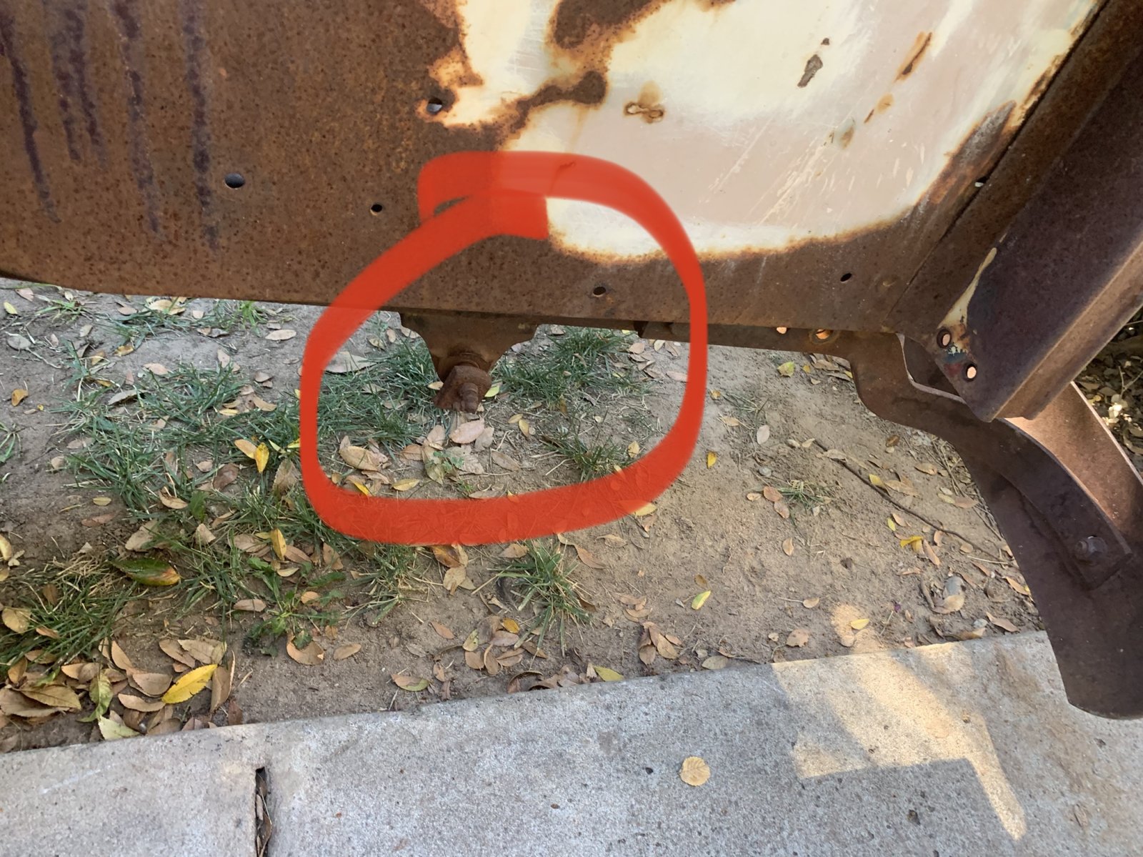

    56205DA8-7185-4A13-964A-EA82579EAA79.jpeg EB0117FF-A409-4F32-8463-D22C6C69922B.jpeg 9C24D63E-18B7-4340-A8E7-B269892DAFA4.jpeg Here’s what I think is for attaching the leafs but I may be wrong.

    You lucked out in that the spring hangers were not removed.
    You can put lowered springs back on there, with stock hardware (or stock replacements and some blocks. Just know that the leaf spring perches will need to have the hole for the spring pack bolt forward 1-1/2". Since this originally had a torque tube, and pivoting spring mounts. If you miss this, your tires will be 1-1/2" forward in the wheel openings, and that looks funny.
    You can make these out of rectangle tubing for pretty cheap.
    If you are clever, you can by wider rectangle tubing and build in your lowering without blocks!*
    As for frame repair.you can carefully remove the rectangle tubing, and replace the cut-outs with like thickness steel.
    On these, I the desire is to go fairly low, I will put in a mini-notch, and box in the top of the factory frame arches.
    If you are not going low enough to need that, I would still box the peak of the arches. These frames are a bit twisty.

  21. AD trucks were either ***led by ENGINE NUMBER OR Body Number depending on State. They did not have frame serial numbers. 20KP-L 7713 is the body code only. 20= Los Angeles plant, K=1952 body code P- 1/2 ton, L= December built and the 7713 is just the number of the body off the ***embly line.

    California uses the number on the door post.

  26. That is good for the OP to know. It varies, I am on the largest AD group on the planet run by a HAMBer and see every option happening depending on location
