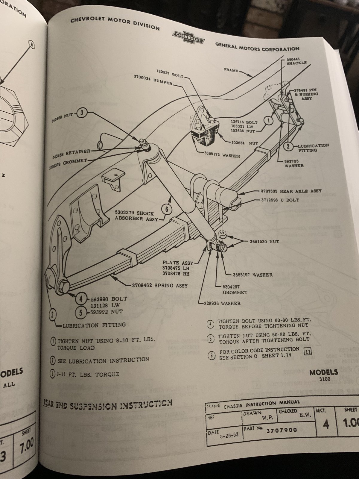

    The truck originally had a torque tube around the drive shaft, with picoting spring perches.
    This used square u-bolts. The whole ***embly pivoted on the tail of the transmission, like a big swingarm.
    Towards the ending years of the "Advanced Design" trucks, which were 1947-1954, and the first half of 1955, the torque tube disappeared. First on the automatic equipped trucks, and later on all of them.
    The diagram you posted is for those later years. It is the function that you will be working to duplicate with the Ford 9-inch axle that you have now.

    Ah, now i see why it’s shown with the different rear suspension parts, I think I read that this ***embly manual is originally for the 54 model year but because 47-55 1st series are all basically the same that’s what they printed for us all. I wish they’d of made an addendum to that part of the book.
    I will indeed be trying to replicate this setup with the ford rear. So far I’ve found sources for just about everything needed except the axle plate that the U bolts feed through which if I’m not mistaken, also a bracket attatches to for the lower end of the shocks. Do you know who might sell these axle/u bolt plates?
    Thanks for that link.

    All-together: https://www.americancl***ic.com/1934-54-Rear-Axle-Conversion-Kit/productinfo/93-311/
    -or-
    https://westernch***is.com/1947-54-..._nKl_S0ng2zMGnZee9aLabfkwYY1zI_Vll8f5cP2FFtrA
    -or-
    https://www.cl***icparts.com/1934-54-Rear-Axle-Conversion-Kit/productinfo/93-311/
    These may all be the same kit. They have provisions for modern shock absorbers, so that helps too.

    :) Exactly what I’ll need for the rear, much appreciated. I was stressing trying to locate the pieces individually.
