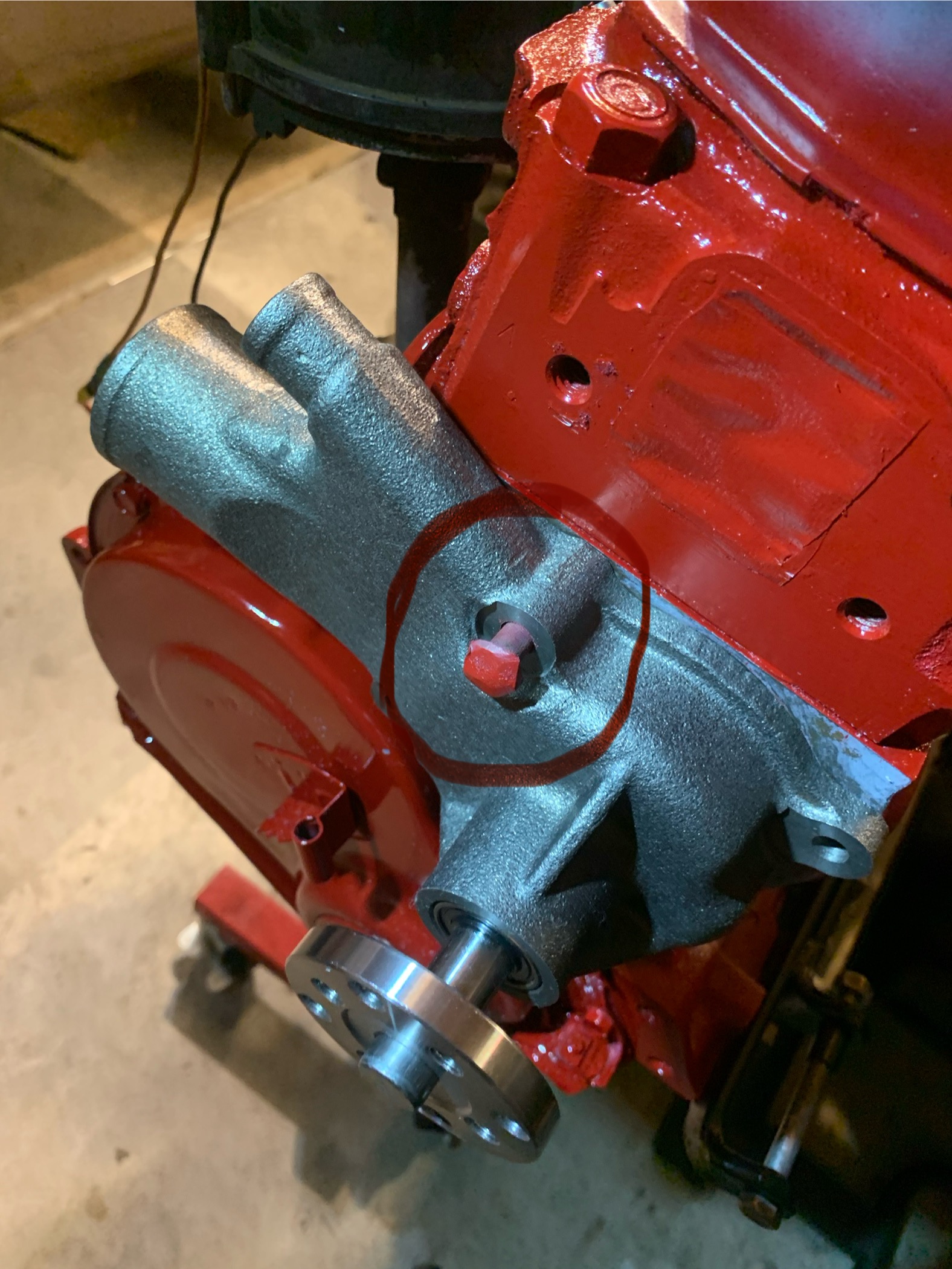

    Hey fellas,
    I dismounted most everything from my L6 250 to clean & paint. in the process I accidentally tossed my water pump & 2 of the bolts in the trash. I bought a replacement but not sure on bolts.
    Does anyone know if the bolts are all the same length? The water pump appears to be thicker in the two circled spots on my photo but they do thread into the block, just not sure if it requires more length.
    Ps are washers used on these bolts?

    Not sure of different sizes, been ages since I had a 235 WP off, but that bolt head looks kinda odd

    Good eye lol. It was damaged, like it had been rounded or snapped in the past. I needed to use a vice grip to get it off.

  30. Measure the thickness of the water pump bolt area then add 3/8 to half inch.
