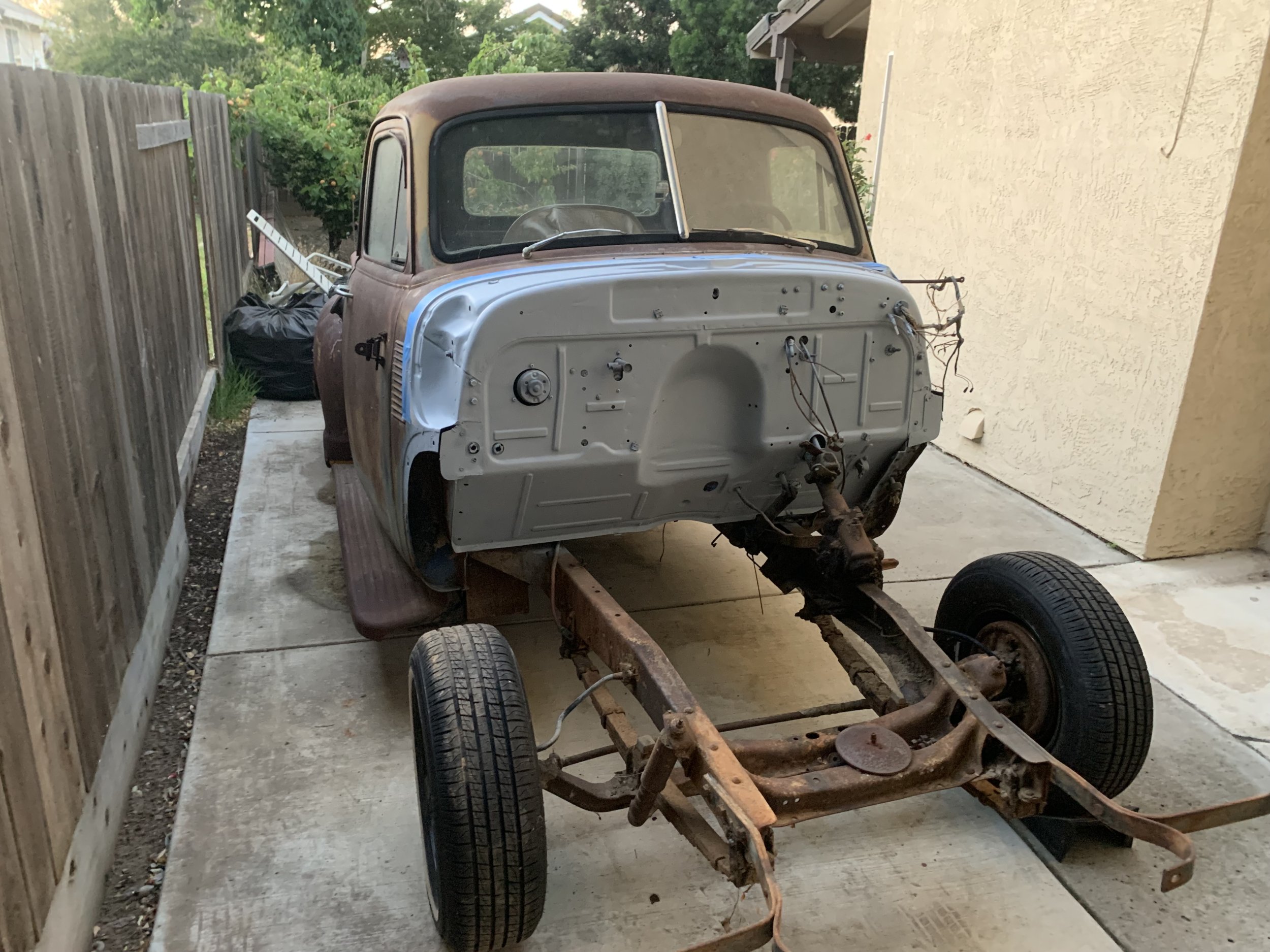

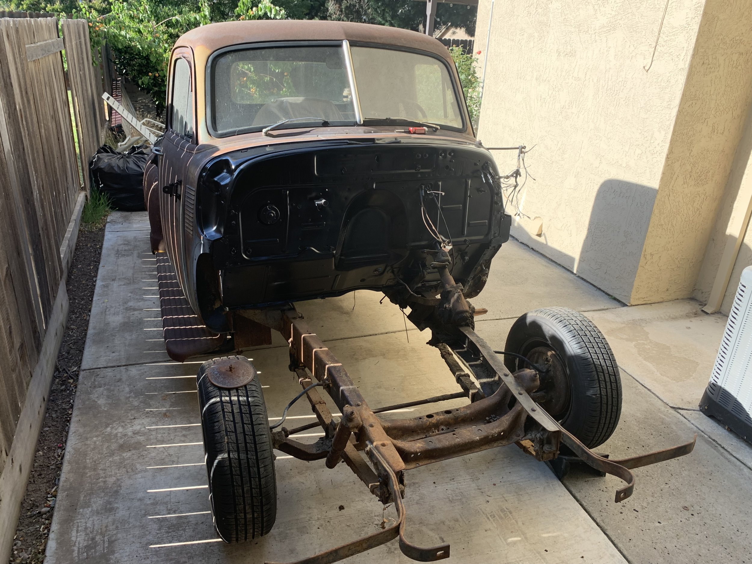

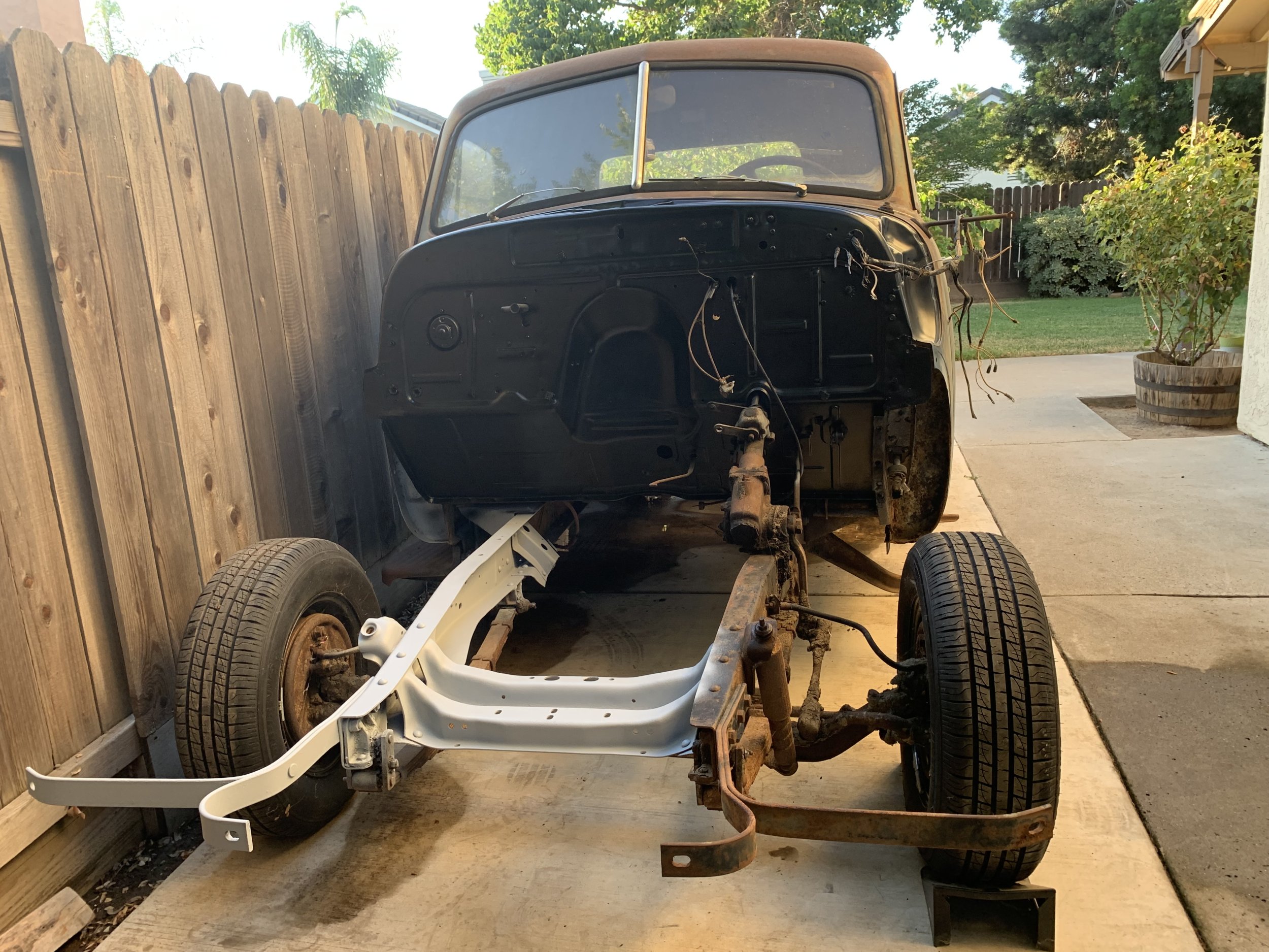

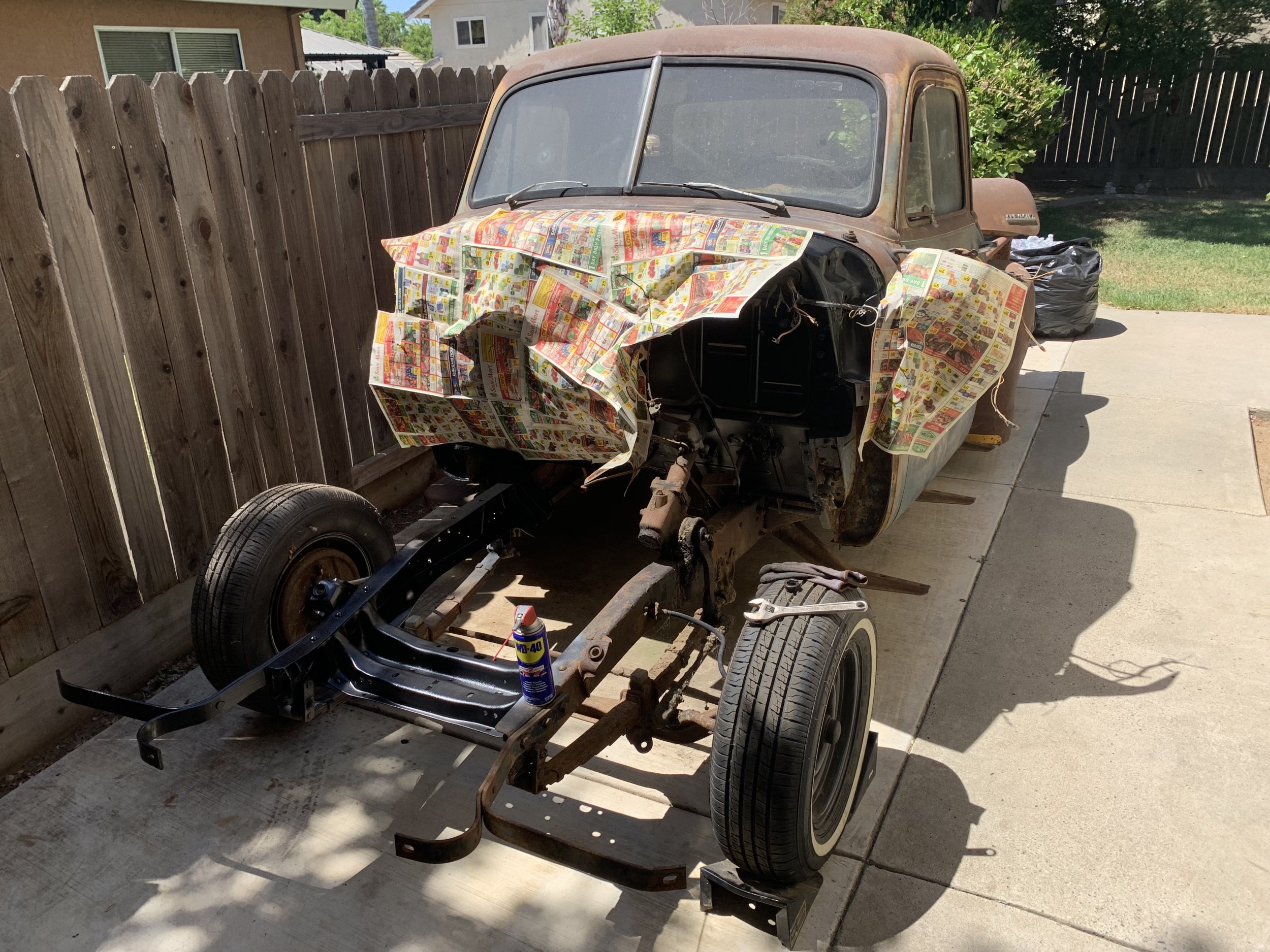

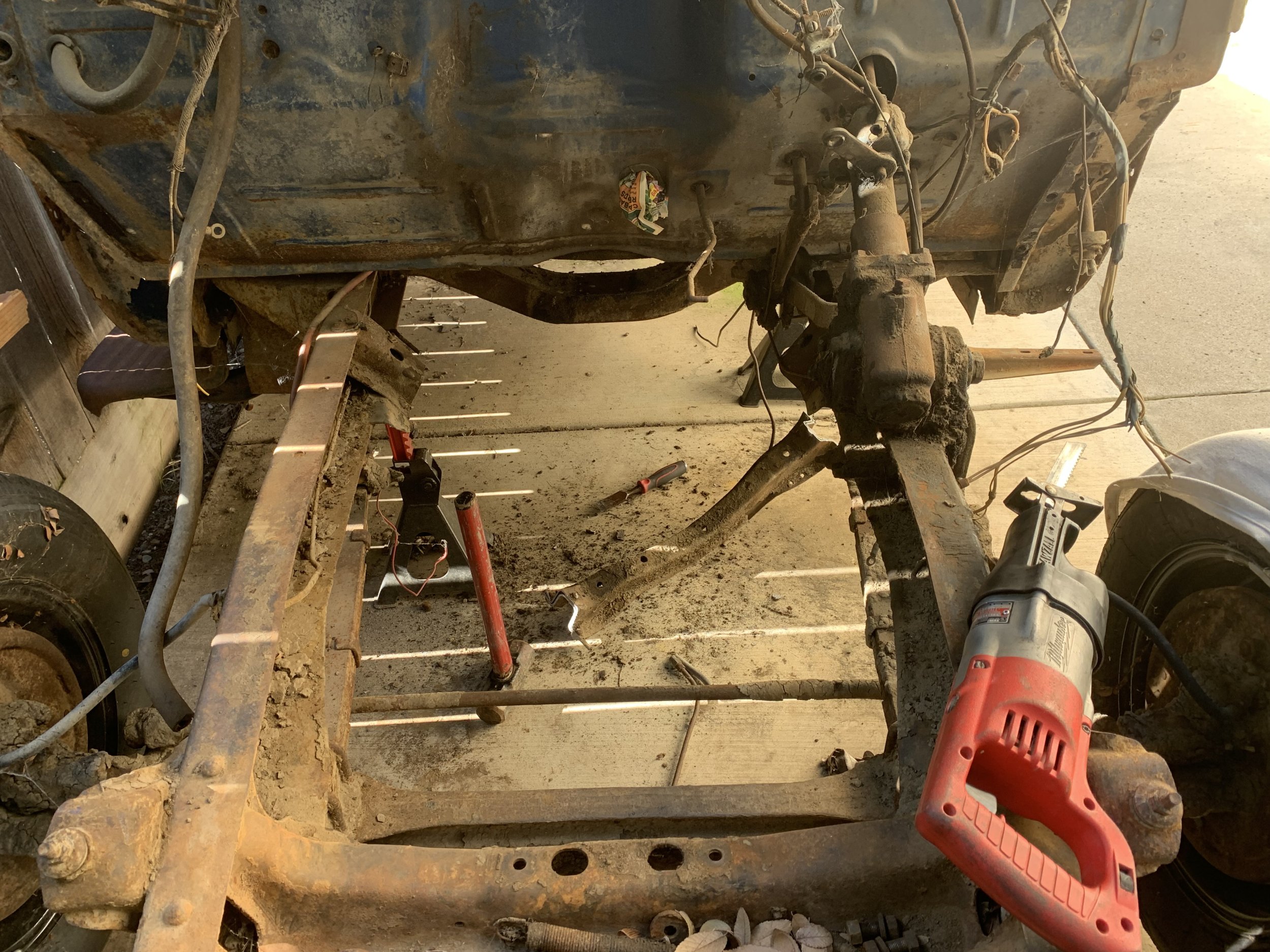

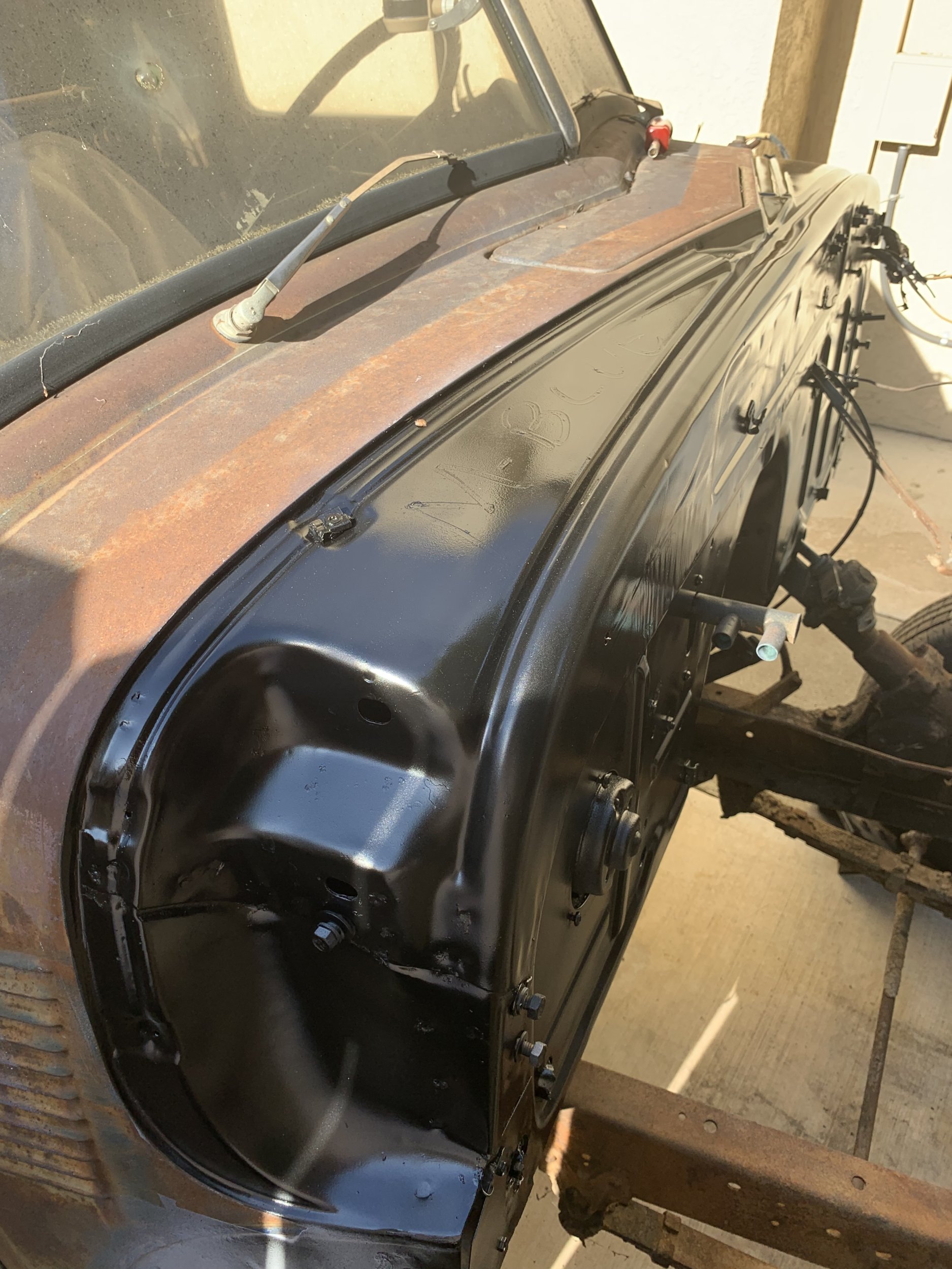

    Been away for a while, but it’s been slow progress. Here’s a few pics of what I’ve done so far I washed down the firewall and ch***is, degreased everything, scuffed with a wire wheel and painted. probably can’t tell from the pictures, but the firewall is semi gloss black and the ch***is is satin black.
